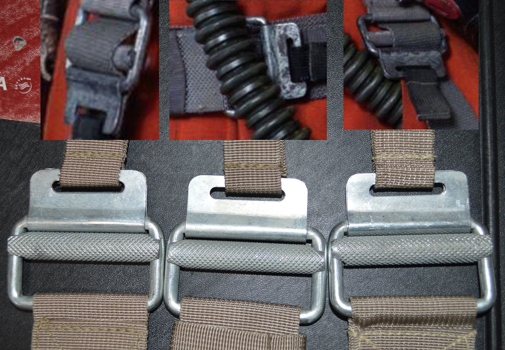

There's something that needs clarification: The roll-pin buckle. Like any surplus manufacturer, there are different sizes/shapes/patterns of hardware offered on the market. While I assumed that the buckle was initially the brassy color most of the base-belts use, the real one is in fact from a completely different source.
On the left is the "bare metal" buckle that's compared to images of Poe's harness. On the right is the incorrect, yet more plentiful buckle that we see on a lot of the belts being offered. There are some pretty distinct differences in the construction of the buckle, namely the size (bare is bigger), the lip (again, bigger), and how tightly they were stamped (bare has more of a gap)
Hooray for conveniently orange wall stripe! This shows the exact buckle when compared to the real deal. You'll notice both Poe's and mine have the open "lips", and the crease is much softer than the brass version.

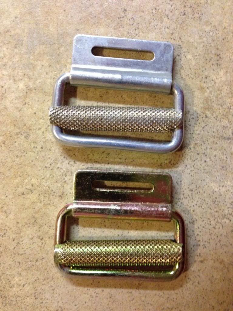

Here's what I mean (left is brass, right is bare)
You'll notice how tight the crease on the brass is compared to the correct bare buckle.
Well...had to get three; both side straps and center buckle.

I guessing that buckle is not brass nor brass plated. The brassy color is due to some sort of residue/tarnish during the manufacturing process.
I have run into this before as I have been acquiring and selling buckles like this for the X-Wing Pilot costumes.
To fix this issue, you need a mix of vinegar and salt. (if I remember correctly, 1/4 cup vinegar to 1 tsp of salt for 15 to 30 minutes). Rinse under cold water. You may need some sort of small brush to get the flakes out of the knurled areas.
Here is a picture. The buckle on top has been cleaned using this process. It used to look like the buckle below it.

"Brass" is the terminology I'm using for the tarnished buckle to differentiate it from the "Bare" buckle, but yes, it is definitely a tarnish and not an intended coating. As noted, there are inherent physical differences in thickness, dimensions, and how tightly the lips were stamped between the tarnished buckle and the non-tarnished. Most likely different manufacturing plants.
It's possible other Resistance Pilot harnesses might have the brass-tarnished buckle, as I'm sure they had to scoop up A LOT of webbing for the extras, but for this build, I definitely want to go the route of using the found buckle (the bare metal) since it adheres to the correct dimensions and construction of Poe's hero harness.
That looks to me like cheap zink-plating. Hardware such as screw, bolts and nuts are often plated that way for rust-proofing - and those tend to be much cheaper than the black-oxidized or stainless counterparts.
Re: Poe Dameron / Resistance Pilot Harness (Found parts, webbing, etc.)
Probably correct. It's definitely some sort of anti-rust treatment. It comes right off with the vinegar soak and scrubber pad. Heck, most of it came off with a finger rub.

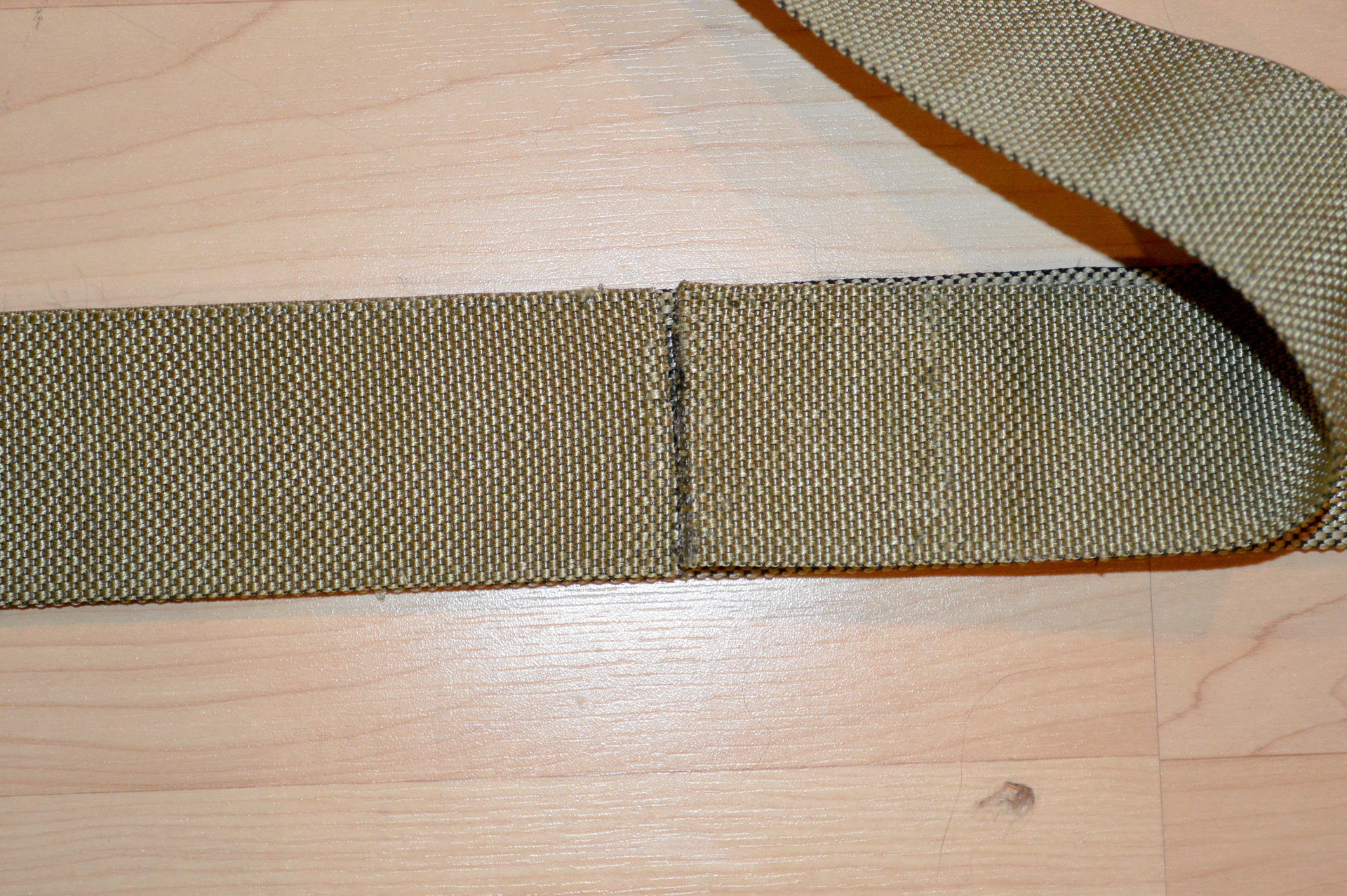

Finally got my base belts in the mail, and I have to say this part was THE most puzzling to figure out, but I think I've got it. While the current photos of Poe we have out in the public aren't the best, some of them definitely give us enough of a glimpse as to how the belt is not only put together, but how it's fastened as well. I needed TWO base belts in order to create the extension. Each belt has two layers: a main layer, and an inner layer. Both layers need to be separated and resewn together like the screen-used belt.
First things first: The way the buckles are sewn to this belt from the factory are NOT correct for Poe's rig (and they're the wrong buckle too). That section was removed and replaced with the inner belt layer and looped through the buckle and to the back of the belt as shown. You can tell by the difference in material that transitions from "main belt" to "inner belt". You'll also be getting rid of the original "connecting strap" that's sewn into the belt to originally go through the buckle, since it's not used on the props.
This is only placed temporarily, but when the inner belt is eventually sewn to the main belt, it'll only go so far. That's where the second inner belt comes in, and is sewn as an "extension" to the main belt. You'll see why next.
Bear with me on this one. Basically, the main belt AND inner belt are looped through the buckle and overlap the "buckle side" of the belt. You can clearly see the multiple layers of belt that are on his right past the buckle. My guess is that the main belt should have stopped where the buckle met, however, Oscar Isaac's waist is TINY (probably a 29 or 30), so he took the excess and fed it through the buckle.
As luck would have it, I was able to source the correct cotton webbing from a UK supplier that "sold to a production company in the hundreds of yards"....take what you will from that. It should be here by next week, and I'll be able to start working on the side straps.
