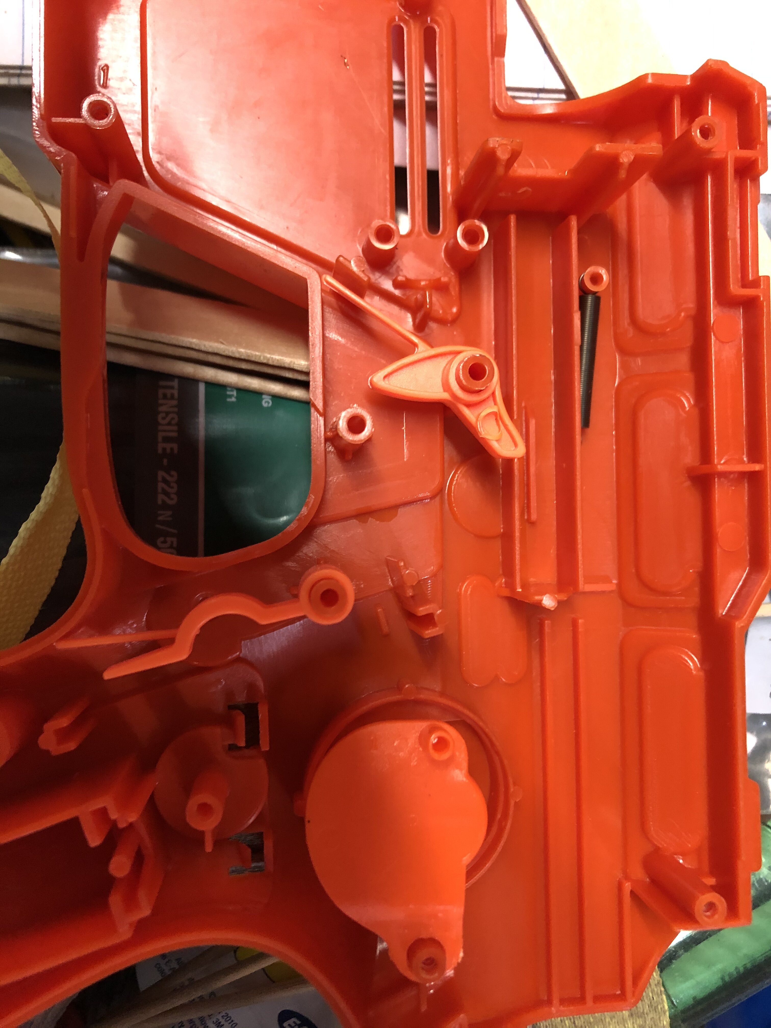

Earlier today, after surviving Walmart, I tore into the Nerf blaster. It came apart fairly simply but some bits put up a fight and I didn’t want to break anything.
First, a detail view so I can get the thing back together correctly.

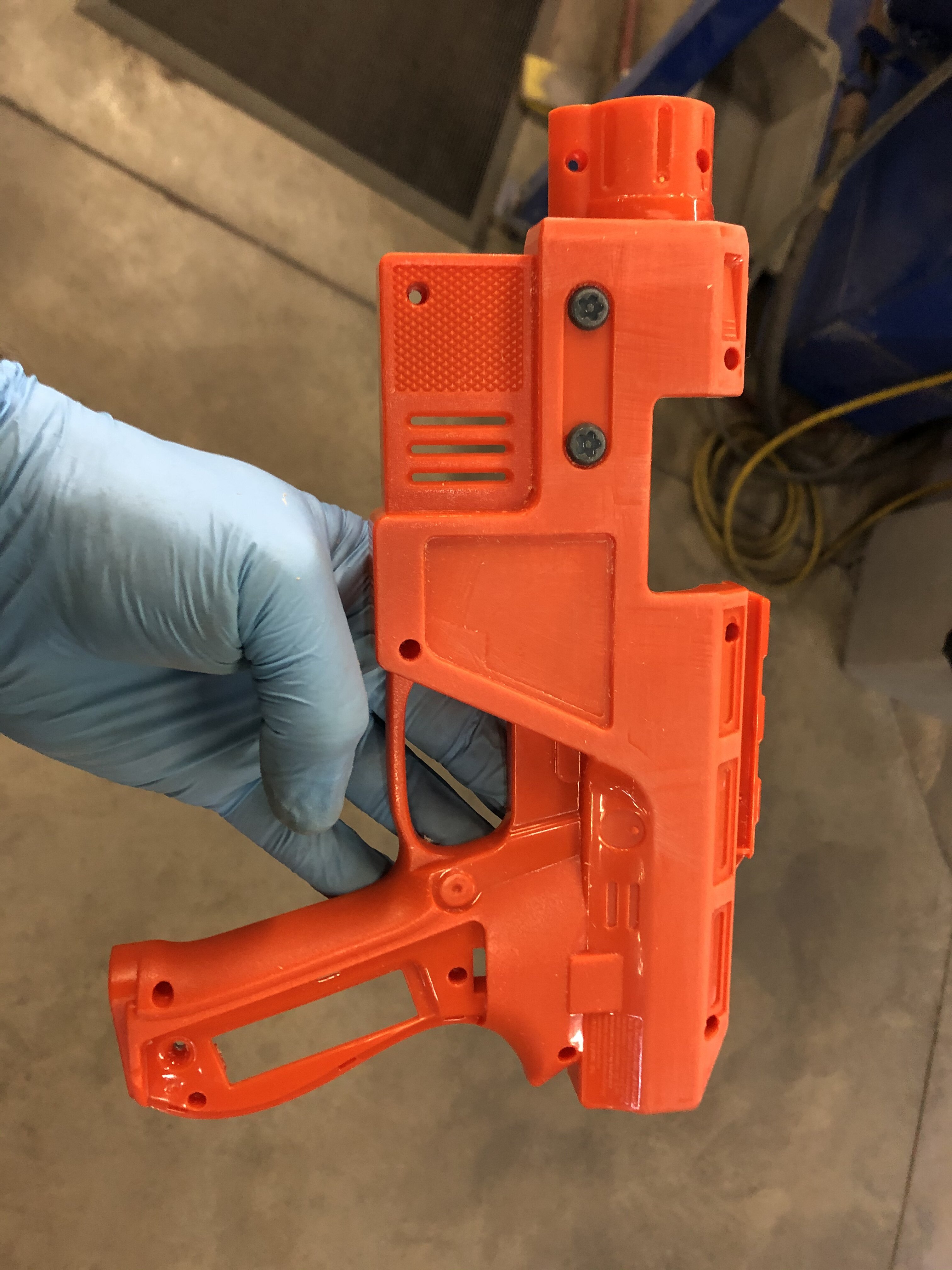

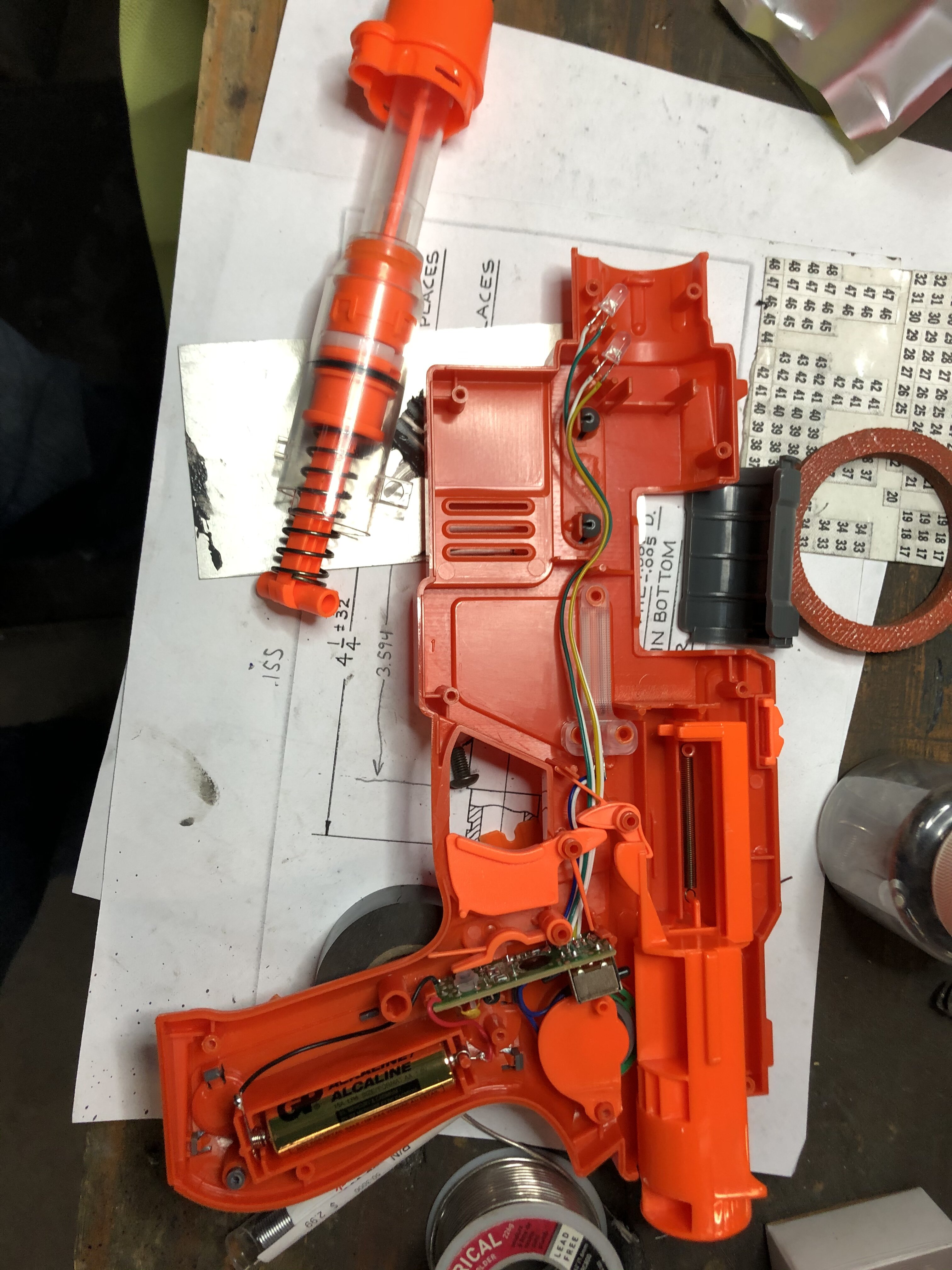

Here’s the “guts”. Not a lot to it. One switch on the trigger activated the sound and a second switch on the “bolt” activated the UV LEDs for charging the glowing darts. I trimmed a few bits of melted plastic used for retention, and was able to remove everything together. The clear plastic bit roughly centered is the “fiber optic” for the purple glow, which comes from a single LED on one end.

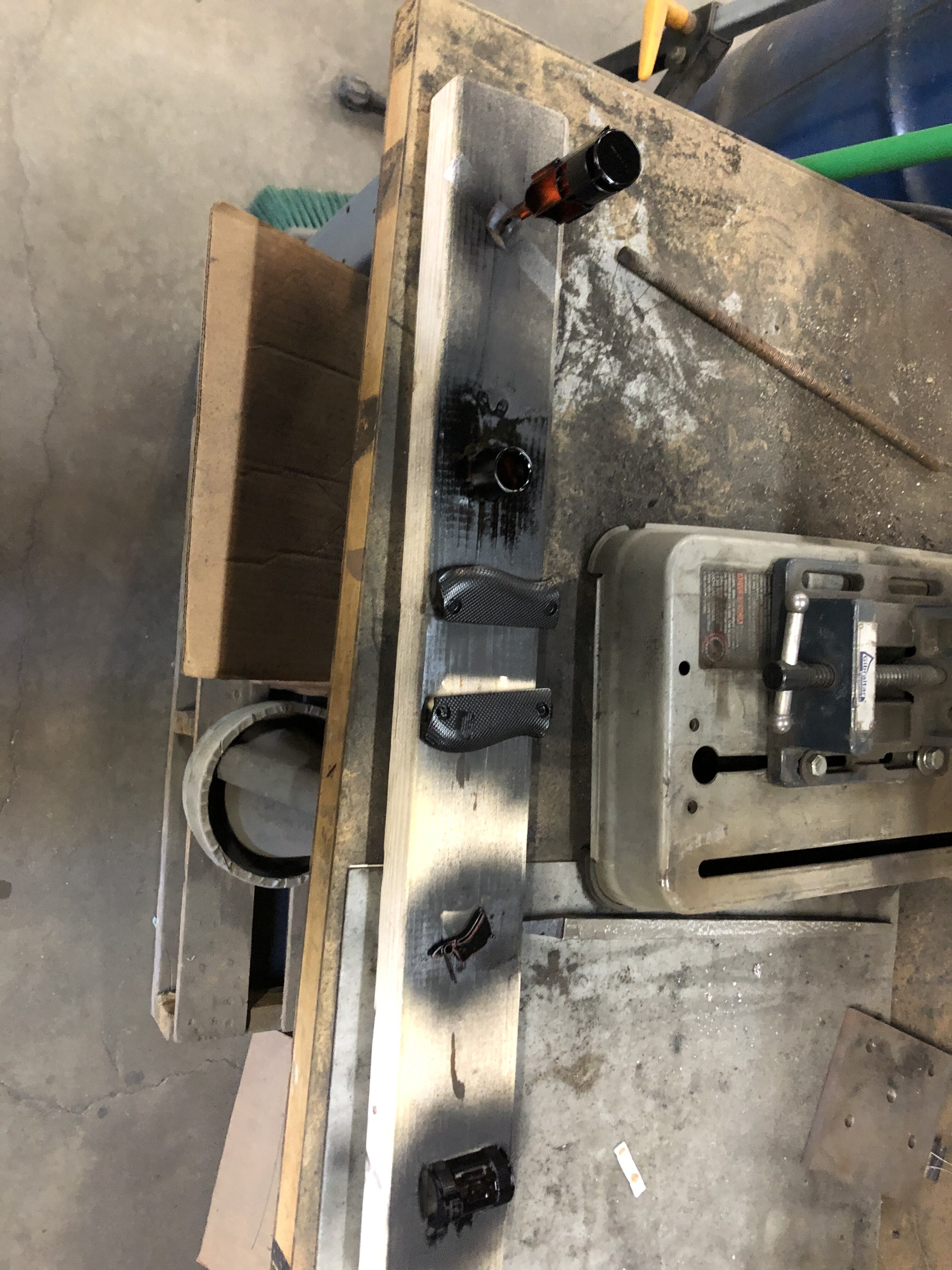

Then the mess started. I got a few bits in semi-gloss black right away (after an alcohol wipe)

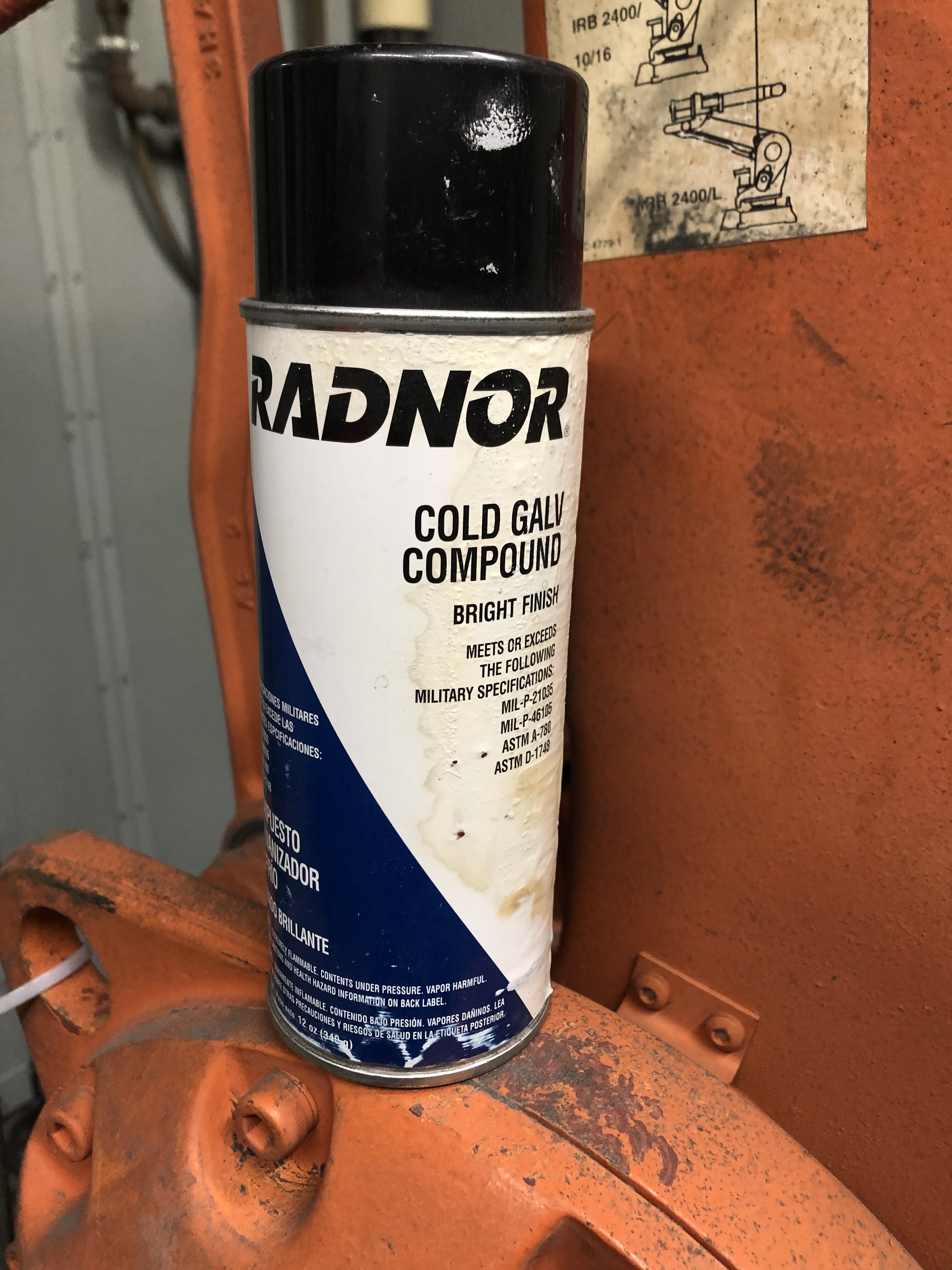

Then I tried a new idea for the silver: cold galvanizing paint. Never used it on plastic before. Might be a disaster, but I had no silver paint left. At least it’s metal.

This is what I’m using for silver: I’m certain it causes cancer in California, since plywood does.Good thing we’re safely across the country from that dangerous place.

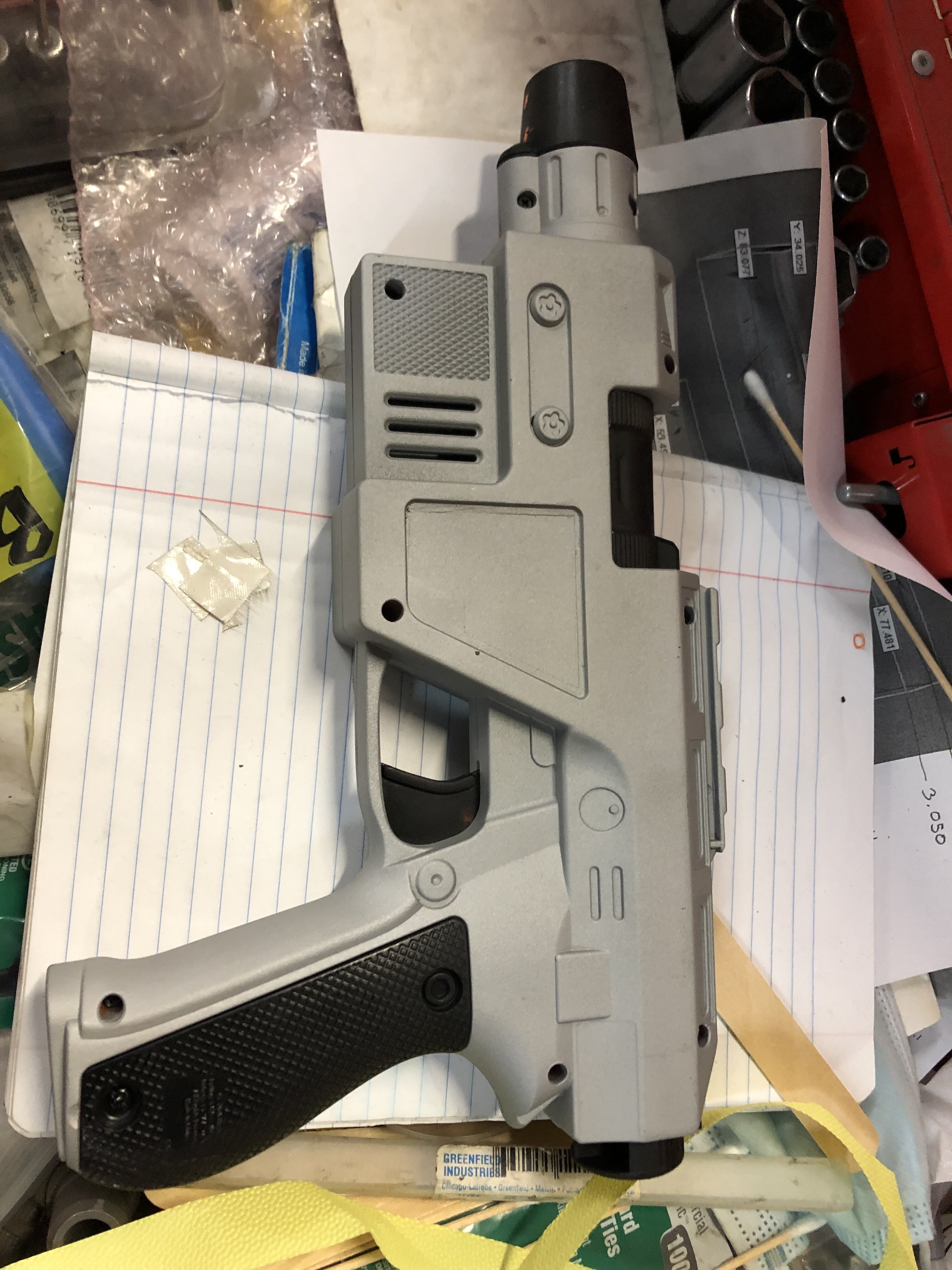

The frame after painting
During painting

Earlier today, after surviving Walmart, I tore into the Nerf blaster. It came apare fairly simply but some bits put up a fight and I didn’t want to break anything.
During painting

I think the zinc will either be really good, or really bad. But not “mediocre” at all.
I know from using this stuff on metal it’s somewhat soft (so I applied as thin as possible) and changed color when rubbed. So it should show shades of silver to gray, depending on how it’s rubbed. Combined with black mist and dry cloth, it might come out really good. Then I’ll add some brown here n there before clearing. Maybe some silver or bronze sharpie marker detail. That’s what I see in my mind anyway. I guess we find out tomorrow...

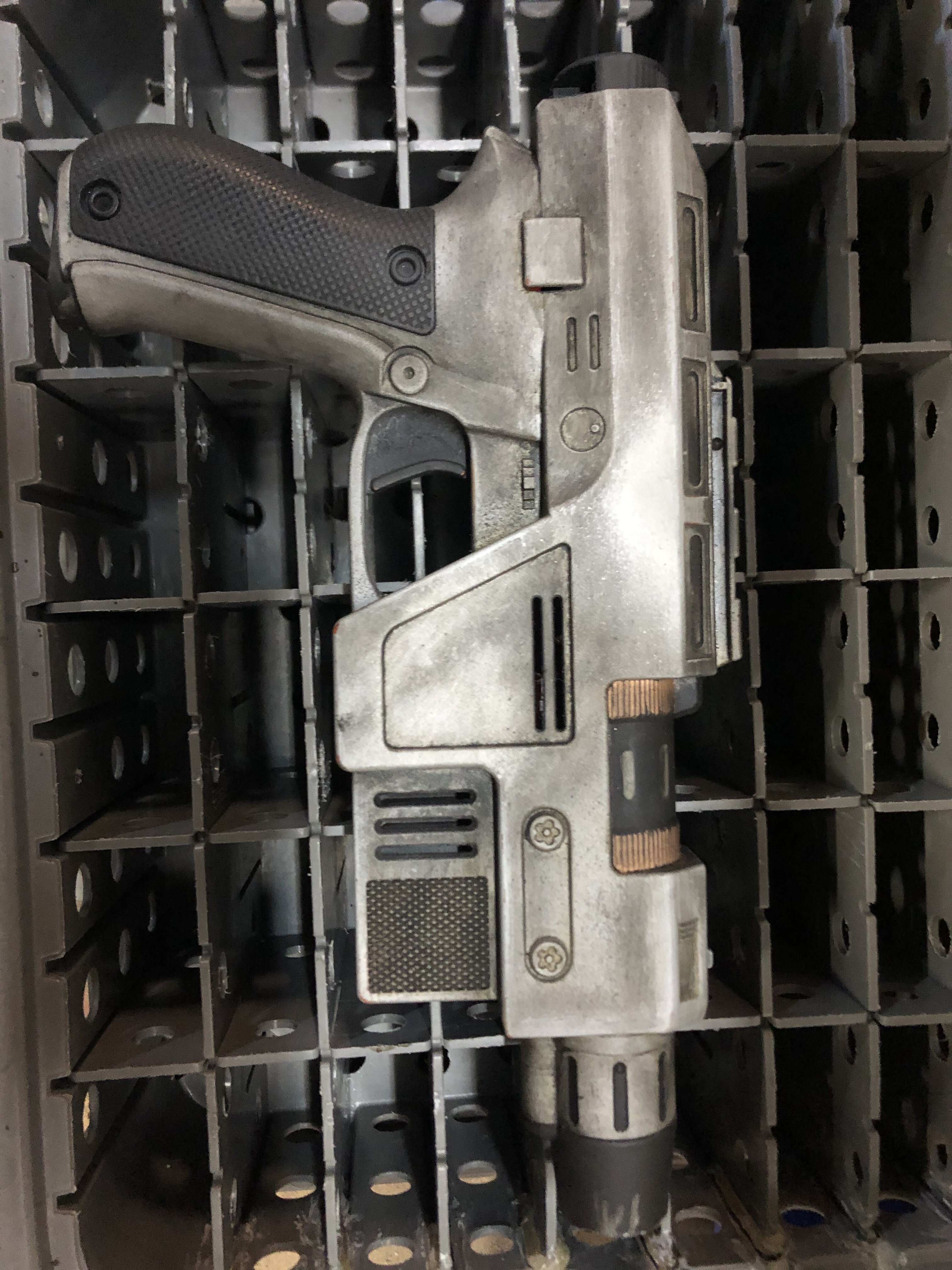

Latest (final?) photos. It looks OK from a safe distance...
And the tools used:
Satin clear over the top, after it got toasty warm in the oven.
Thank you!
Im not sure how well it shows, but I used scotch brite on the edges to take back the dirt and the zinc picks up a slightly different sheen as compared to as-sprayed. It’s still dull, but a different dull. I think there is potential for the zinc, but the carrier is weak and everything I put on top of it, softens it.

EDIT- the zinc will rub right off and make a mess if you don’t seal it. (This one anyway). So, get it how you want it and seal it down. I agree with your thought process, but it will make a mess of your holster etc.
