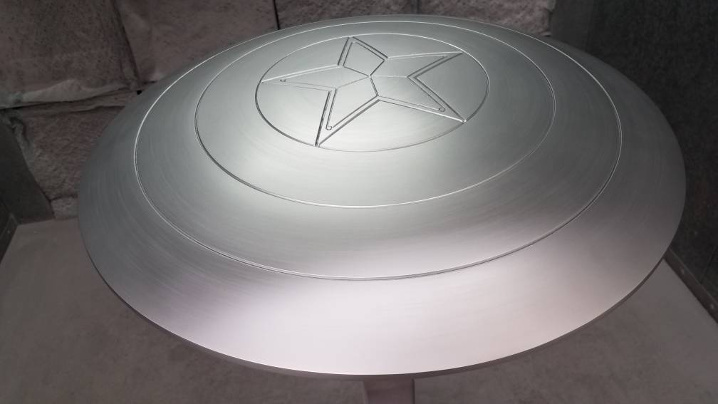

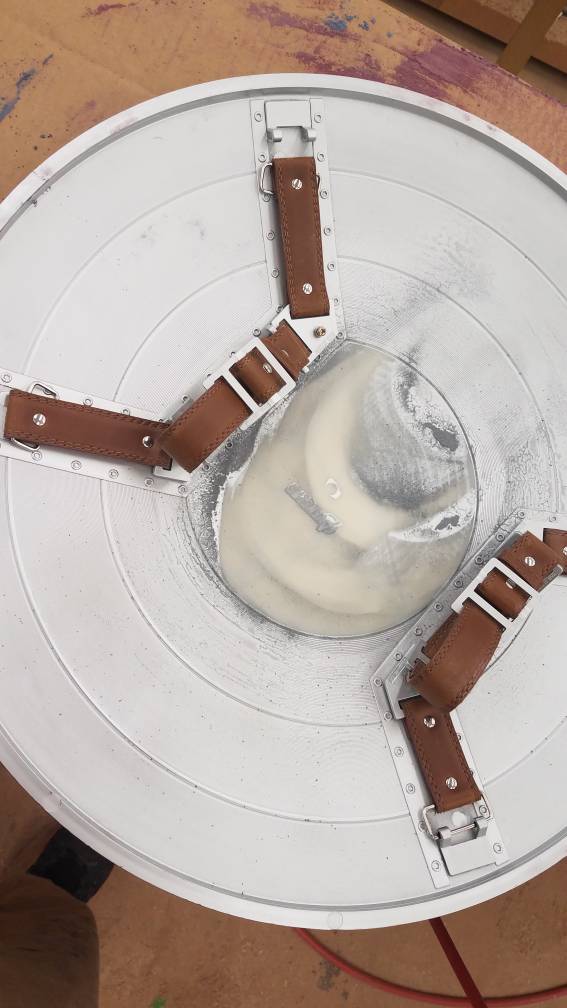

While looking for a Cap Shield that would serve as a sort of "stunt" version for cosplay and display, I found this option on ebay:
I own the Herobody Cap suit that's on a mannequin for display. My metal shield is too heavy to mount to the back, so I wanted something light weight that serves the purpose and looks reasonably good.

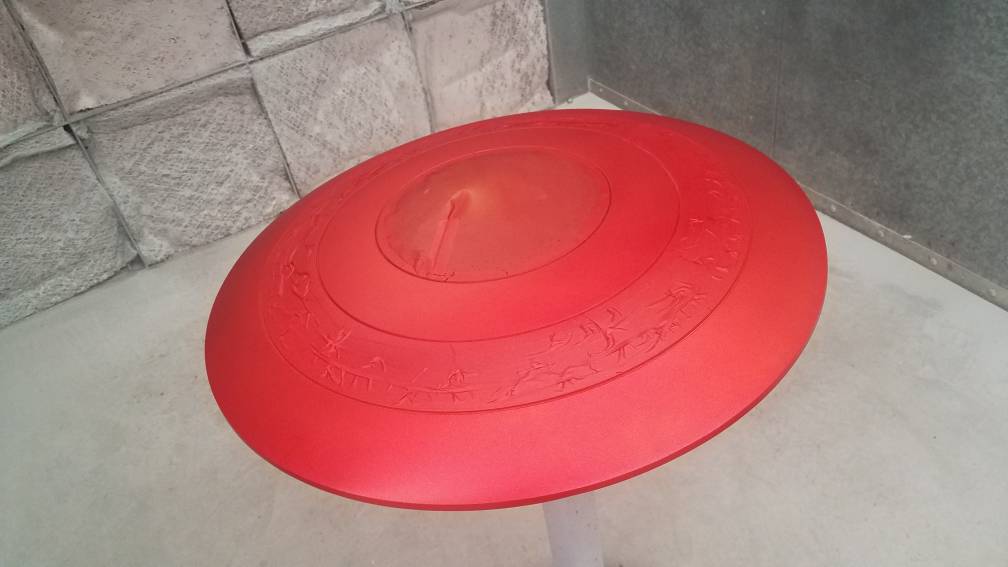

I knew I'd be making some modifications to this shield, specifically, resurfacing the entire thing to remove the vinyl record texture that the manufacturer added to presumably simulate brushed metal (a failed look btw). Luckily, the shield is made of ABS plastic and with some patience and effort, I was able to completely smooth out the surface front and back so I had a fresh foundation to start from for my repaint.

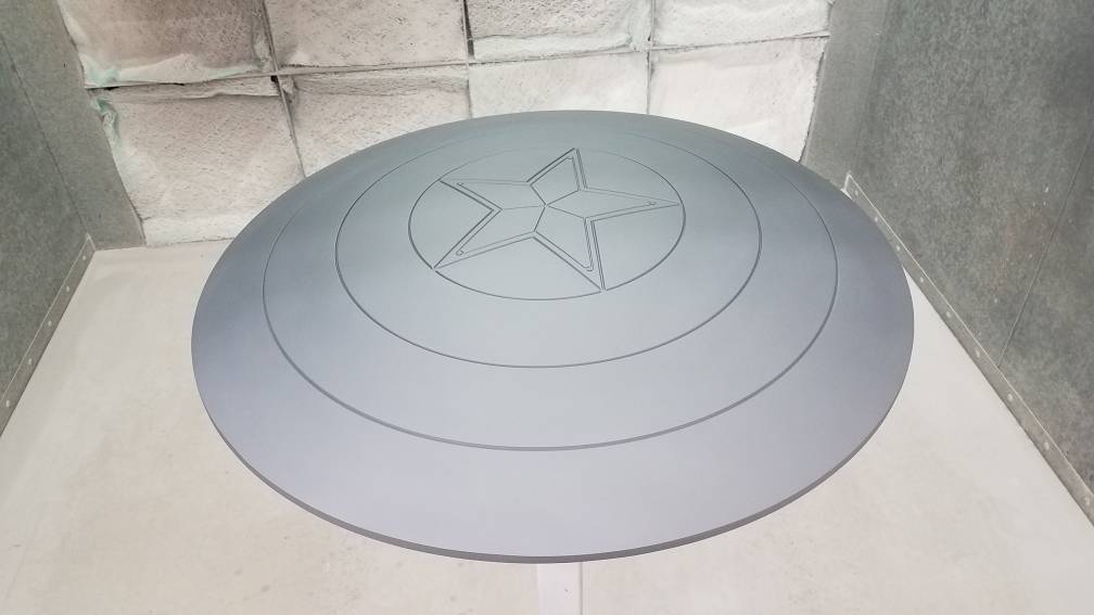

So far, I'm at the primer stage, but I have a series of procedures to follow that will really transform this cheap shield into something that'll look great on display and light weight enough to use as a cosplay accesory.

Which paints and sanding grits are you using for this if you don’t mind sharing?
I custom mix my paints from pigment powders, so they are a proprietary blend.
I used 220 grit with an air powered sander to remove the texture.

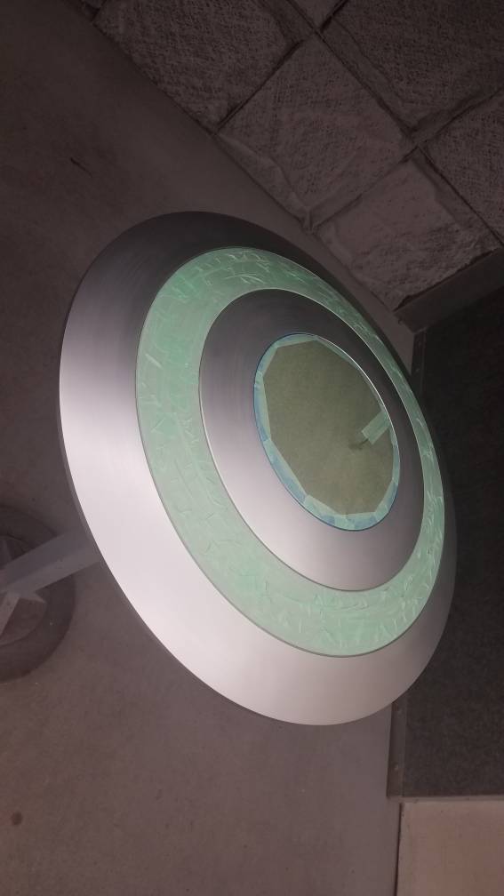

The primer coat was wet sanded and polished smooth prior to the silver base coat.

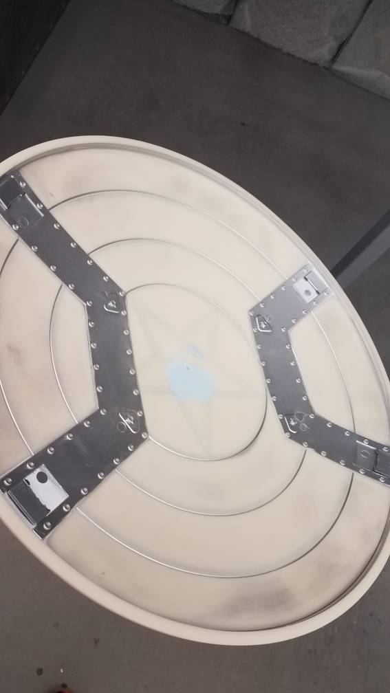

Nearing completion here. Finished off the backside today. Used still images from The Winter Soldier to guide my color scheme. I noticed that the backside wasnt a bright silver like on the front, so I mixed a little gunmetal gray into my base silver color.
The fun part was adding the weathering to the back, making it pop and look more interesting like it does on screen.
I just need to fabricate new clips for the leather straps that attach to the rim.

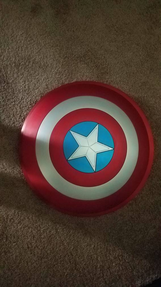

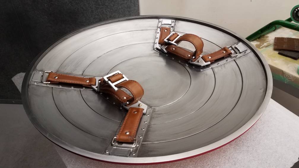

Comparison to my 25" metal shield. I actually prefer the overall look and size of the plastic one to be honest!
The metal shield pictured is due for a repaint as I've since updated and improved my paint formula and application process.
