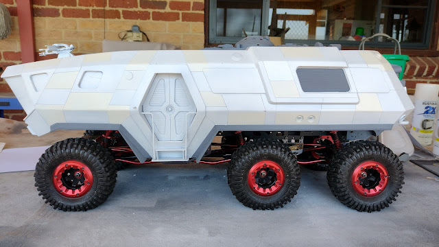

The primer grey model was sprayed with primer flat white and then random panels were masked up and sprayed with a satin off white colour and a satin white. All these paints are from spray cans of the Rustoleum 2X cover range.
I then took a photo at that stage and fiddled about in photoshop to determine a pleasing marking scheme.

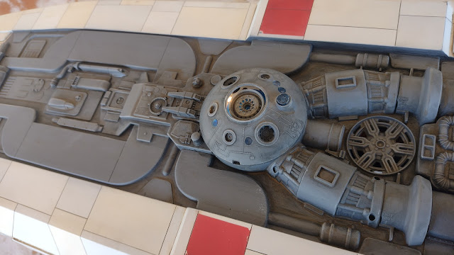

That was left to dry out for a week and then I began the weathering process by applying a brown wash of Tamiya flat black and red brown mix heavily diluted with metho into all the scribed panel lines and around the edges of any detail. The grey roof detail sections received a flat black wash to further accent the recesses. Then using a metho soaked rag the surface wash was wiped clean in the direction of any desired streaks. The grey parts were then drybrushed using white students acrylic paint
The Humbrol red paint even after drying can still be loosened with the metho rag so I had to be careful not to rub it all away. I do however like the effect it has on weathering the paint, making it look sun and rain damaged. One just has to be judicious in the application and wipe off the red residue on the white areas which are not effected.
Using an acrylic grey paint I then added some chipping to the exposed bits of the body that would be susceptible to any graze damage. I also used applied this treatment to any paint finish anomalies to cover them up.
