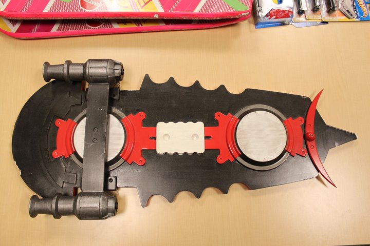

Best to base the design off of known measurements and pictures then to trust people on forums... I could help with some measurements as I helped determine the *somewhat* accurate sizes of some of the hoverboard parts for Clock88's board. Anyway, here is a good picture for the shape of the board... 419727_10150660490629844_1581414349_n.jpg

Best to base the design off of known measurements and pictures then to trust people on forums... I could help with some measurements as I helped determine the *somewhat* accurate sizes of some of the hoverboard parts for Clock88's board. Anyway, here is a good picture for the shape of the board... View attachment 439429
Awesome suggestion, formula388 !!! So, after getting some free time and using the 6" known measurement (I believe, but I might be wrong) of the magnet base, I got a length of 32" and a width of 12" ...Does this sound right? Also, if my measurements are off on the magnet, what are some of the measurements that are whole numbers? Thanks for the help so far guys!

The magnet base diameter that I have calculated is 6.45"... I haven't had time to do the math but 32" seems short.

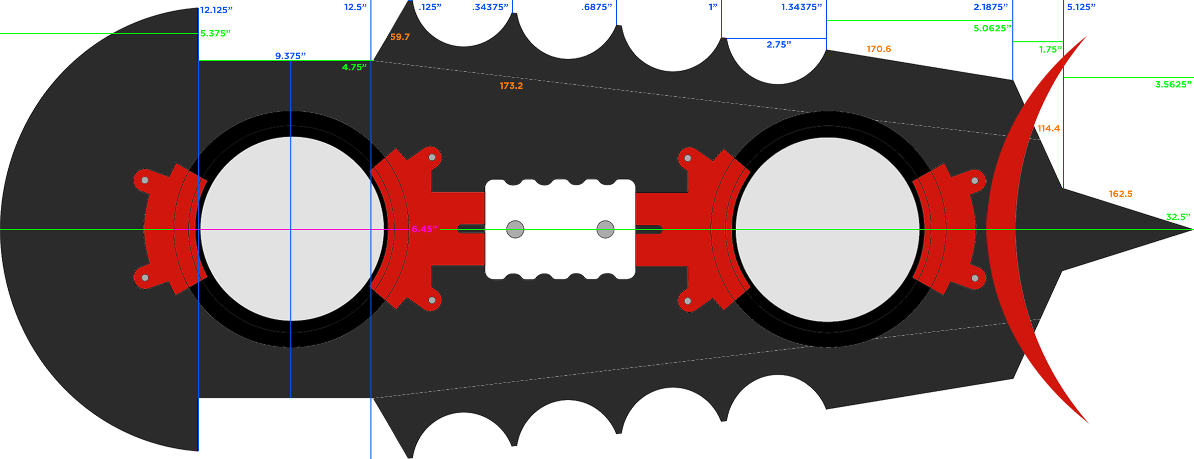

Okay, so I spent the weekend going through several threads and looking at tons of pictures. Using the measurements formula388 posted in regards to the magnet, I'm thinking the board is 32.5" long and 12.5" wide. Even using the photo posted above, if the Mattel board is roughly 28" long then it would make sense that the Pitbull is 4.5" longer in that picture. Here's the measurements I've come up with so far:
Still a work in progress, but I'm determined (with all of you guy's wonderful help) to make the most accurate Pitbull ever. Thanks for the help so far guys!

Alright, I updated my layout with some more dimensions:
Any thoughts or comments, please feel free to share!
I'm planning on picking up some foam board this weekend and cutting out a prototype so I can see these dimensions in hand.
