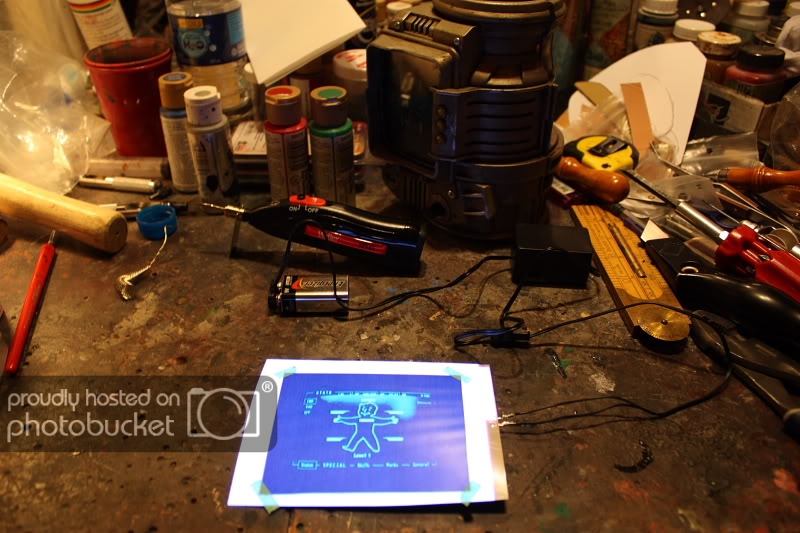

Finally got this finished up the other day! Been an in progress build for some time while I waited for some of the parts to come in, and figure out how to work with them LOL Bought the Pipboy body from Skruffy, could not be happier with it, beautiful casting, SUPER sharp details, and barely needed any work done, hard to ask for much more then that! I didn't go with one of his light packages, but should have, ended up spending more to get the pieces I needed for that mod after the fact. Oops. He did help me a bunch with tips on how to work with an EL sheet, and gave me the site where he gets his stuff from, sadly after I'd bought a package on ebay that turned out to not include the right inverter. Live and learn right? Anyways, long story short, his help, and fantastic body really let me bring to life a piece that makes me giggle with excitement to look at LOL HUGE HUGE fan of the games, it's so cool to have my own Pipboy!! Especially considering the accumulative time I've spent staring at one on my TV ;) On with the pics!

*massive time lapse to get EL sheet, and wrong inverter, figure out what the problem was, and order the right inverter*
EL sheet testing, DAMN these are fun! I gotta find more uses for these, I wanna slap em on everything now LOL Rave version Darth Vader? Hmmm...
IT WORKS!!! [Happy-Dance]

It's guts, EL sheet inverter, 9 volt battery, and wiring, plus independent status light LED control board with button switch.
