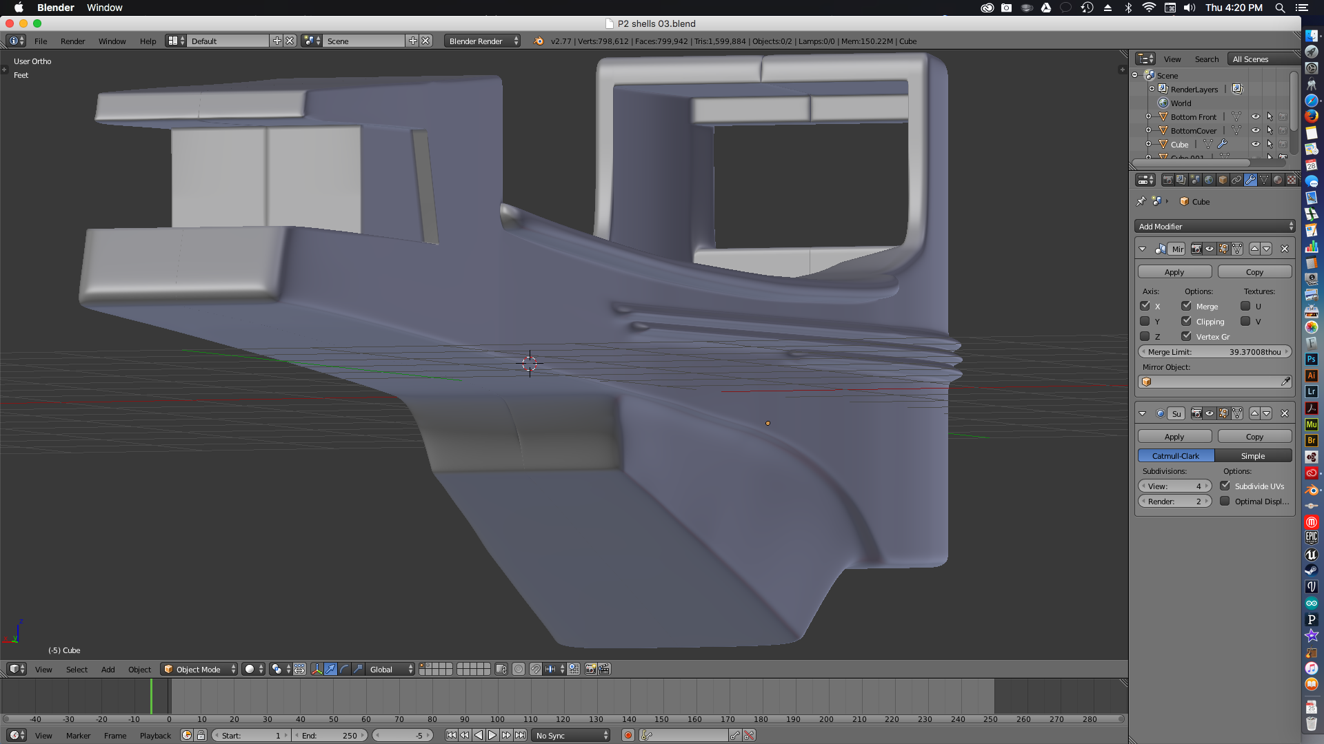

Whew! So close to sticking a fork in this!
The side ribs came together like buttah, but the cradle dingus needs just a little more tweaking. I'm knocking off for today, just to get my perspective back. My brain is turning to jello. No, you can't have any of my brain jello. :p

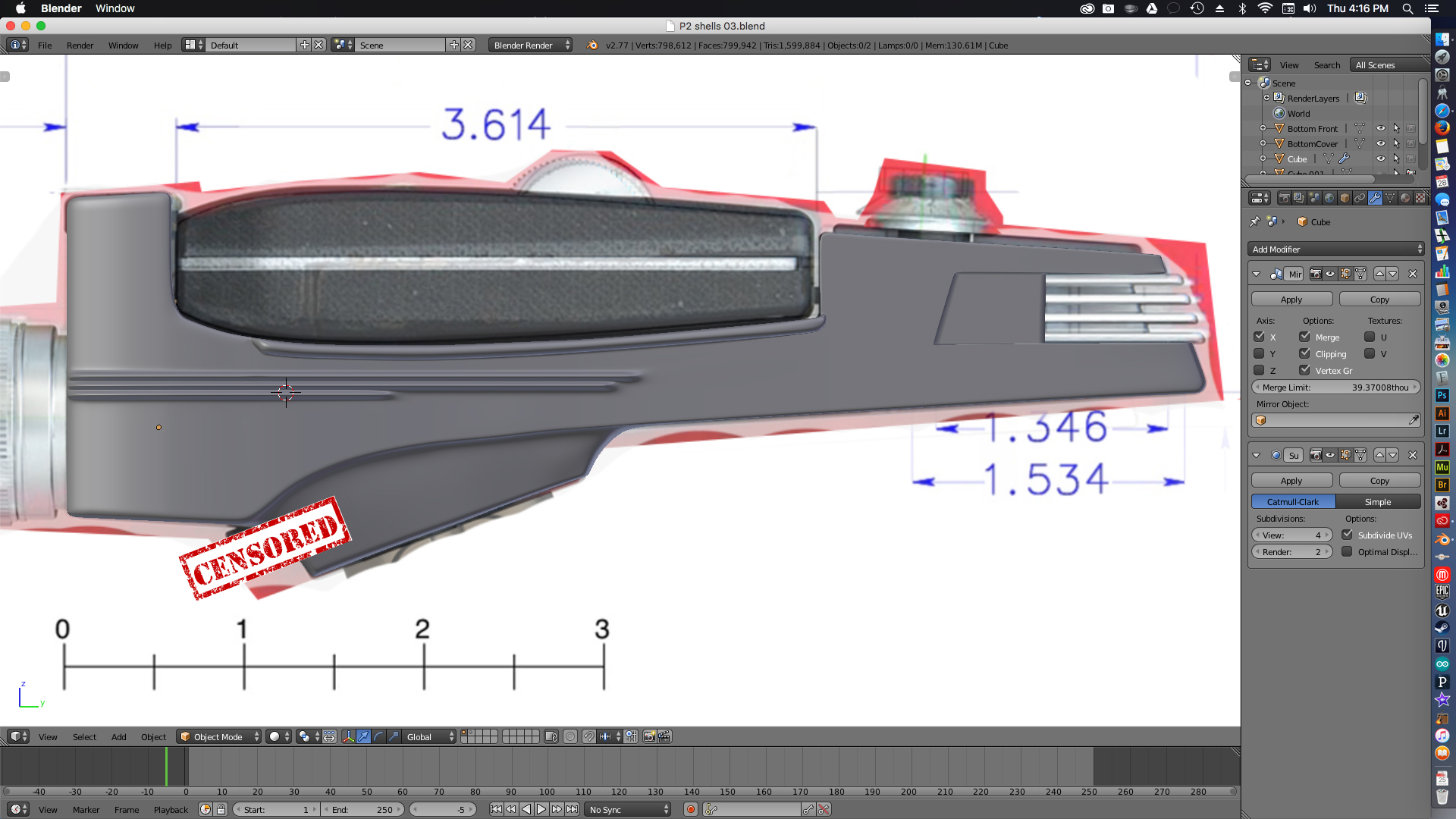

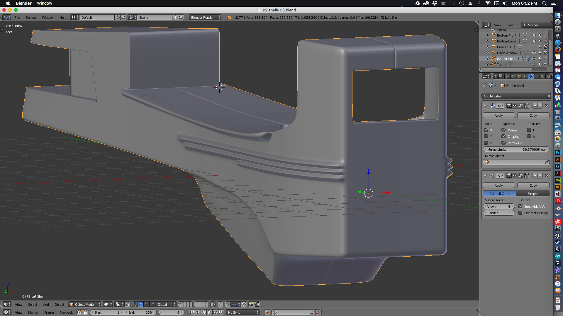

So here it is, today's shameless exhibition of naked phaser pictures!
Phaser Porn.jpgScreenshot 2016-04-28 16.21.17.pngScreenshot 2016-04-28 16.20.37.pngScreenshot 2016-04-28 16.19.44.pngScreenshot 2016-04-28 16.18.46.pngScreenshot 2016-04-28 16.17.48.pngScreenshot 2016-04-28 16.16.49.pngScreen Shot 2016-04-28 at 4.23.02 PM.pngScreenshot 2016-04-28 16.21.45.png

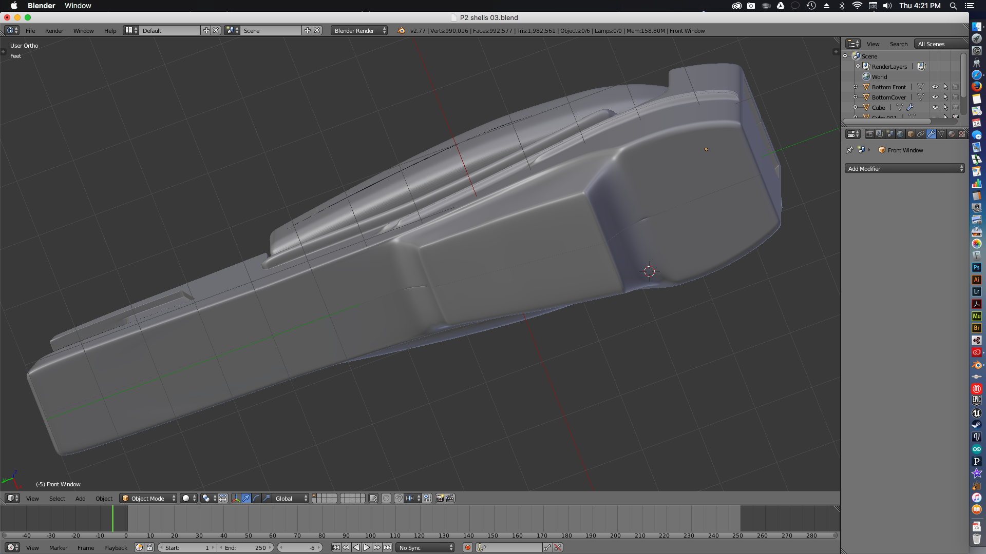

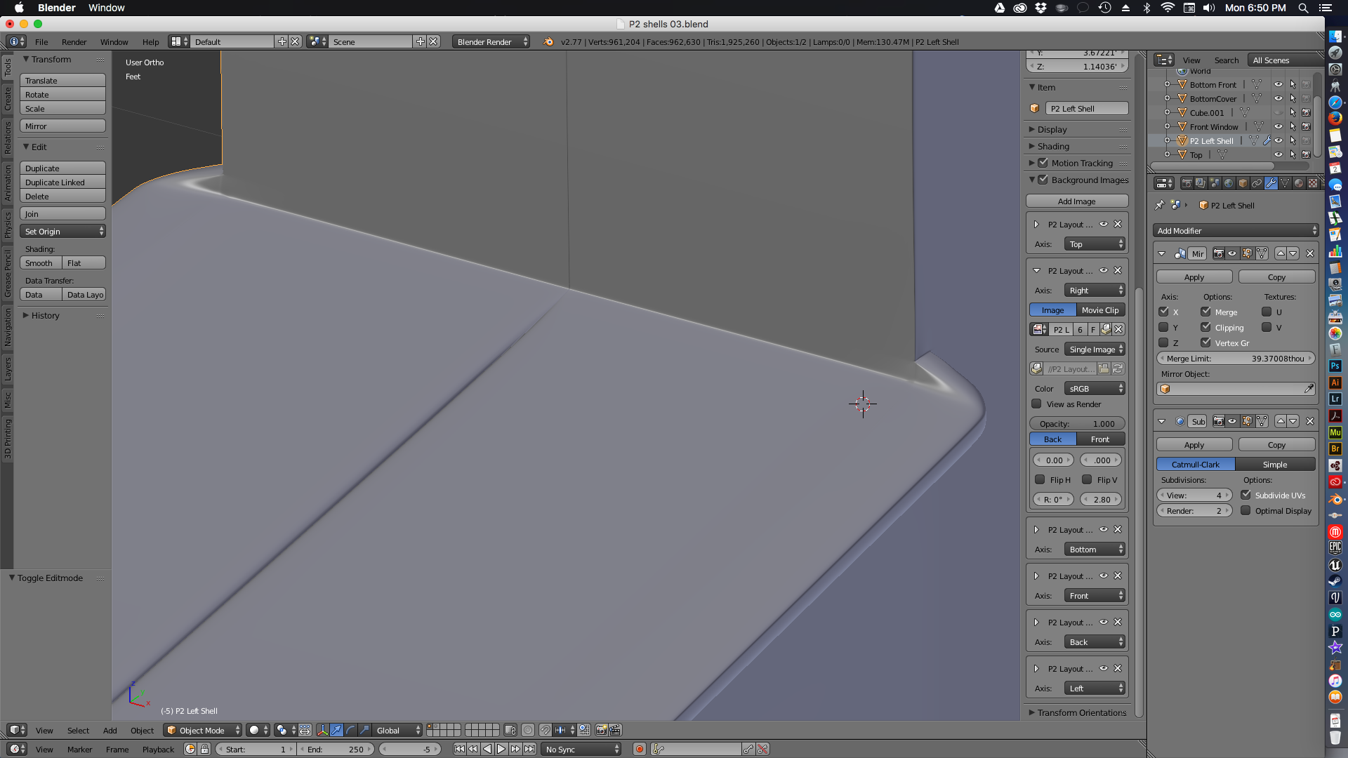

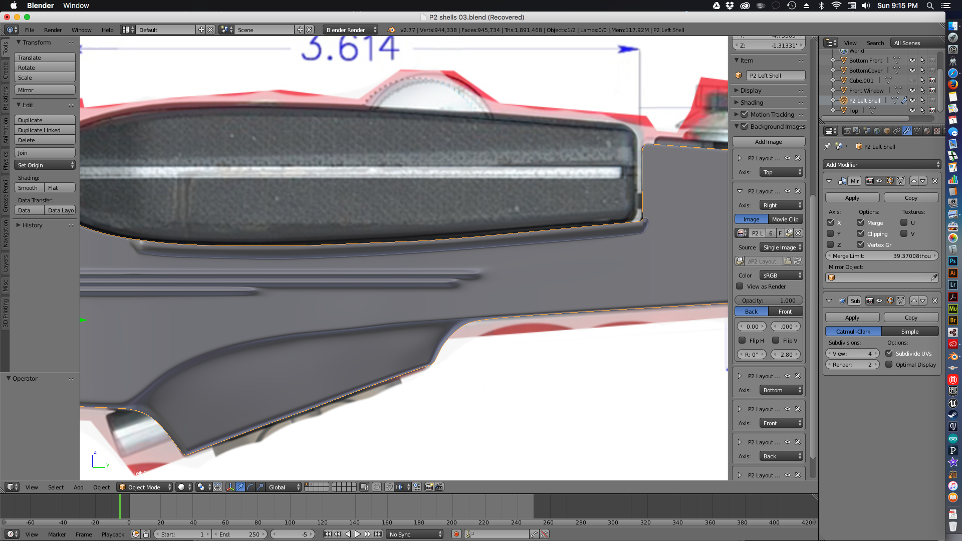

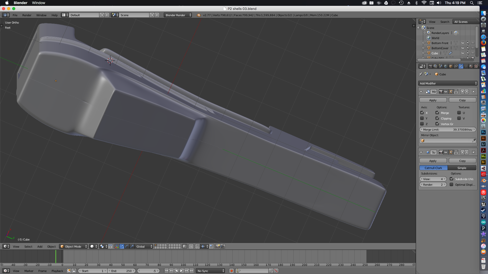

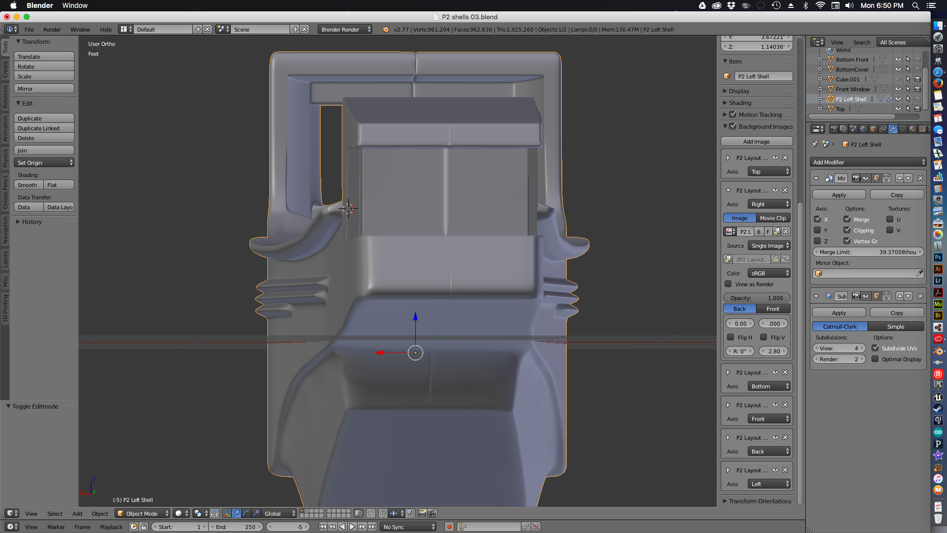

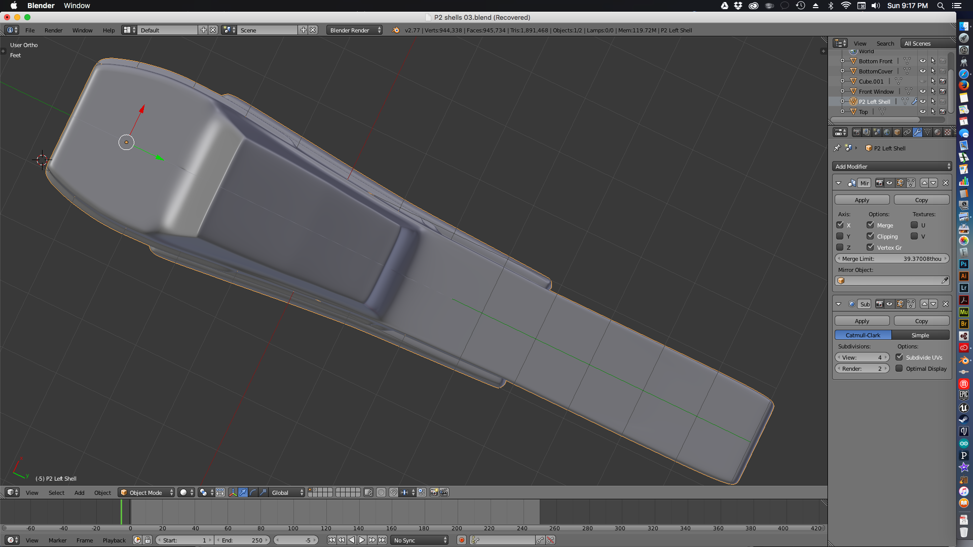

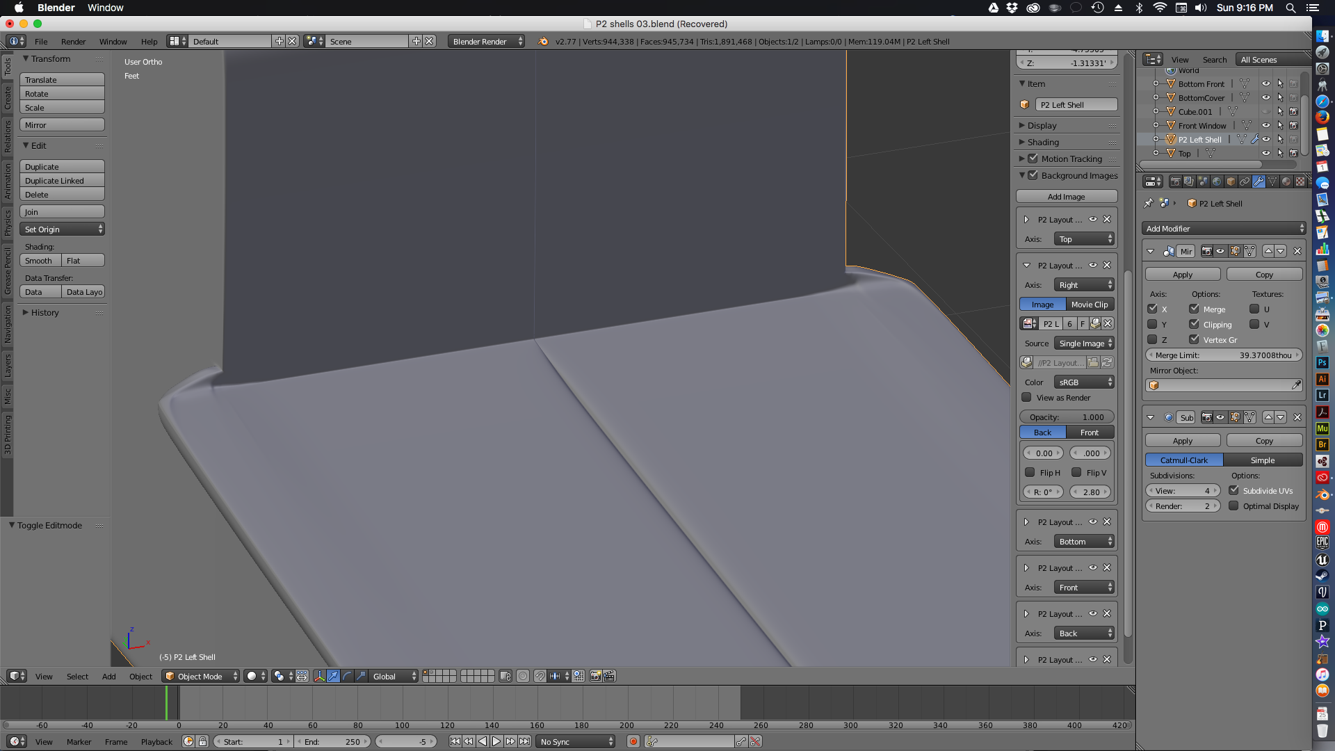

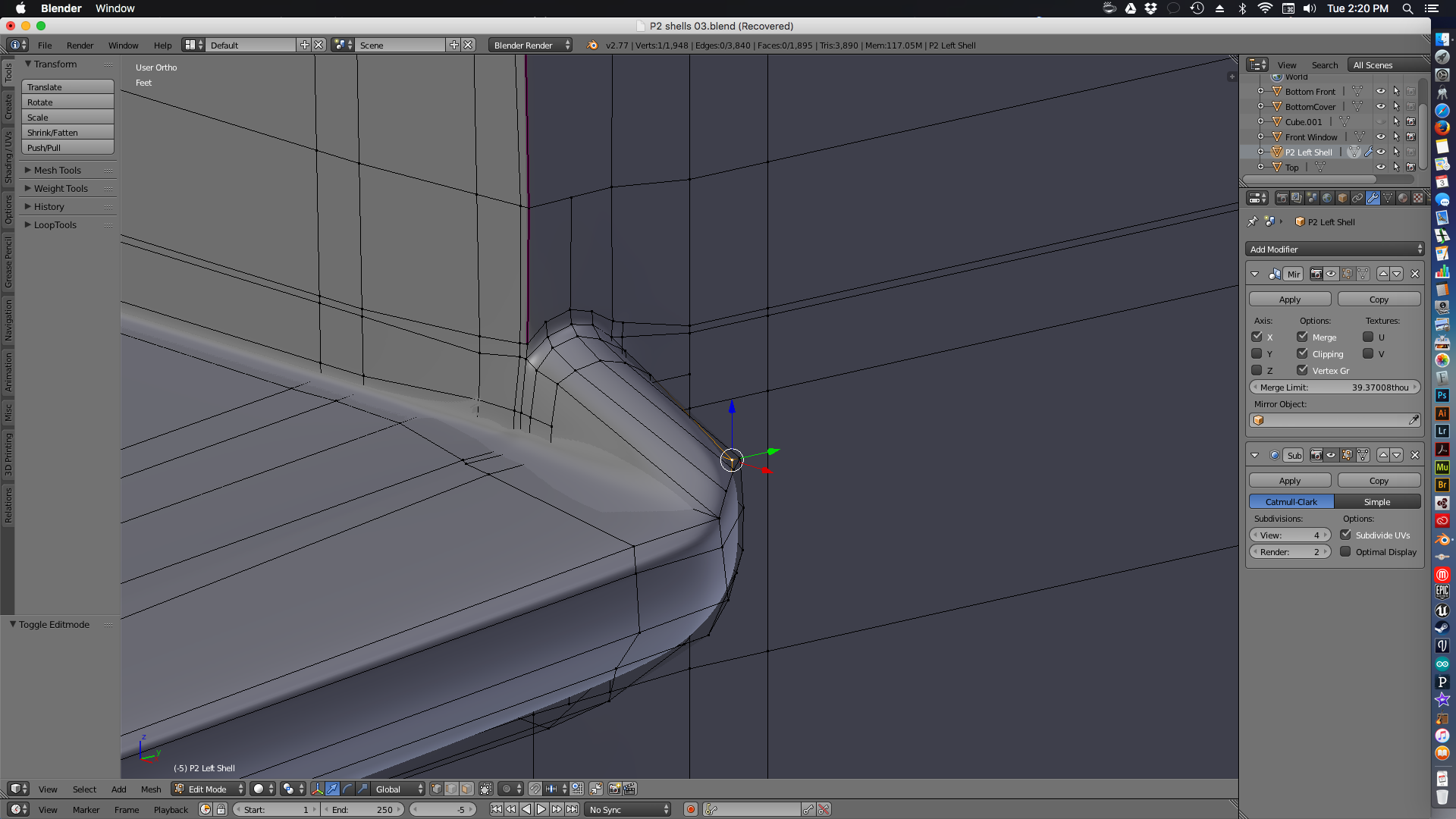

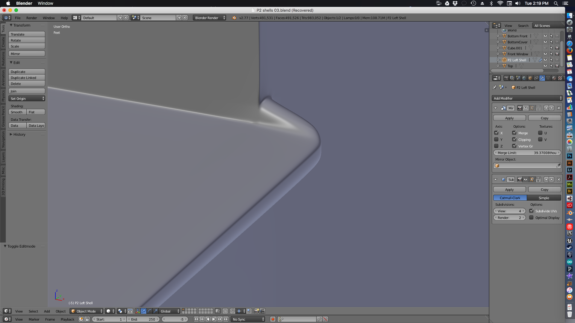

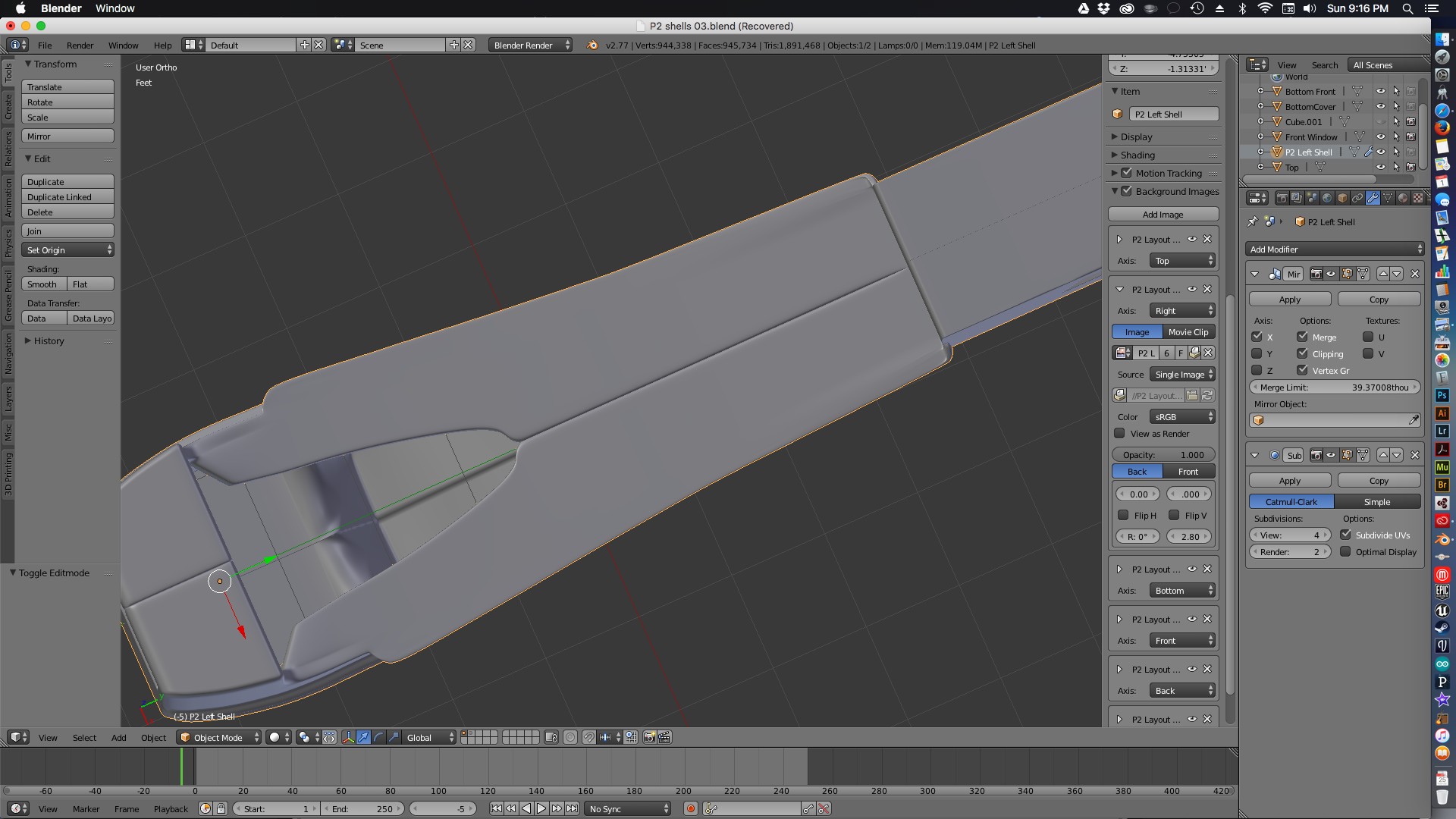

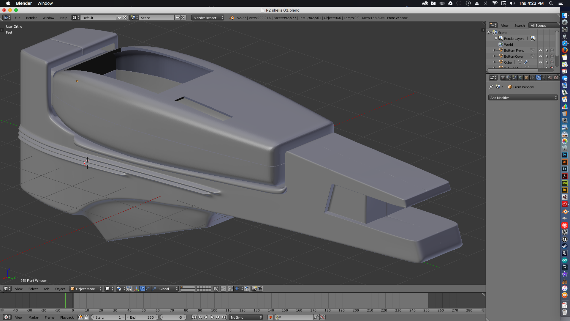

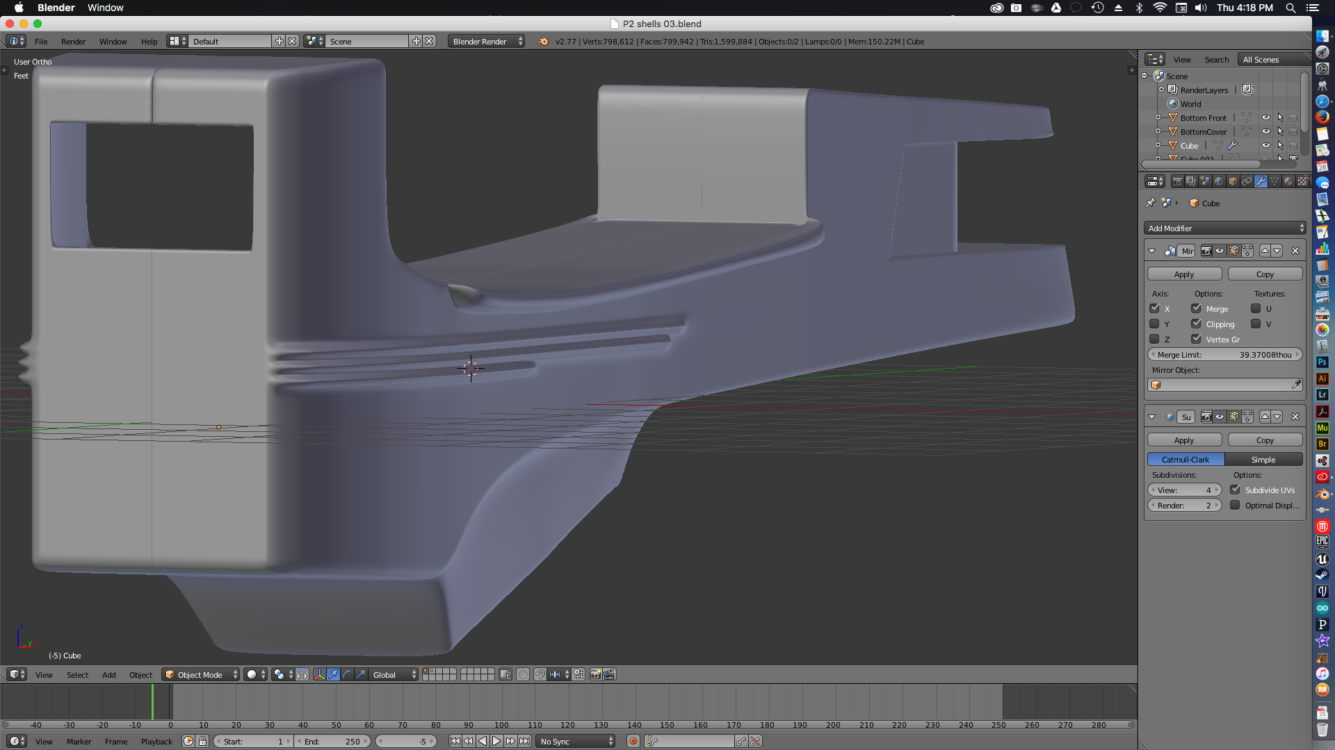

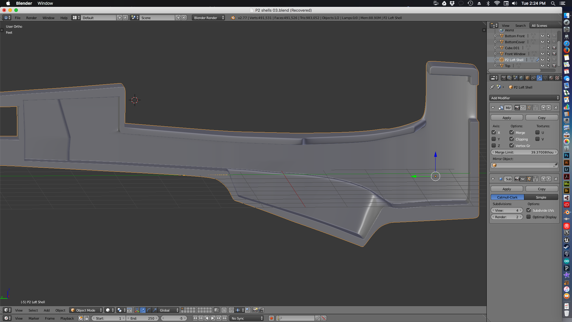

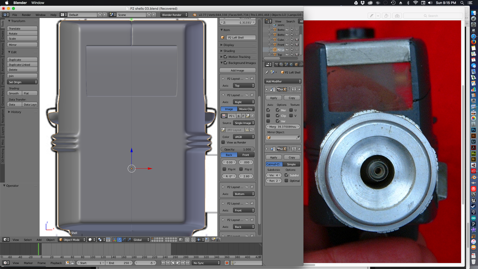

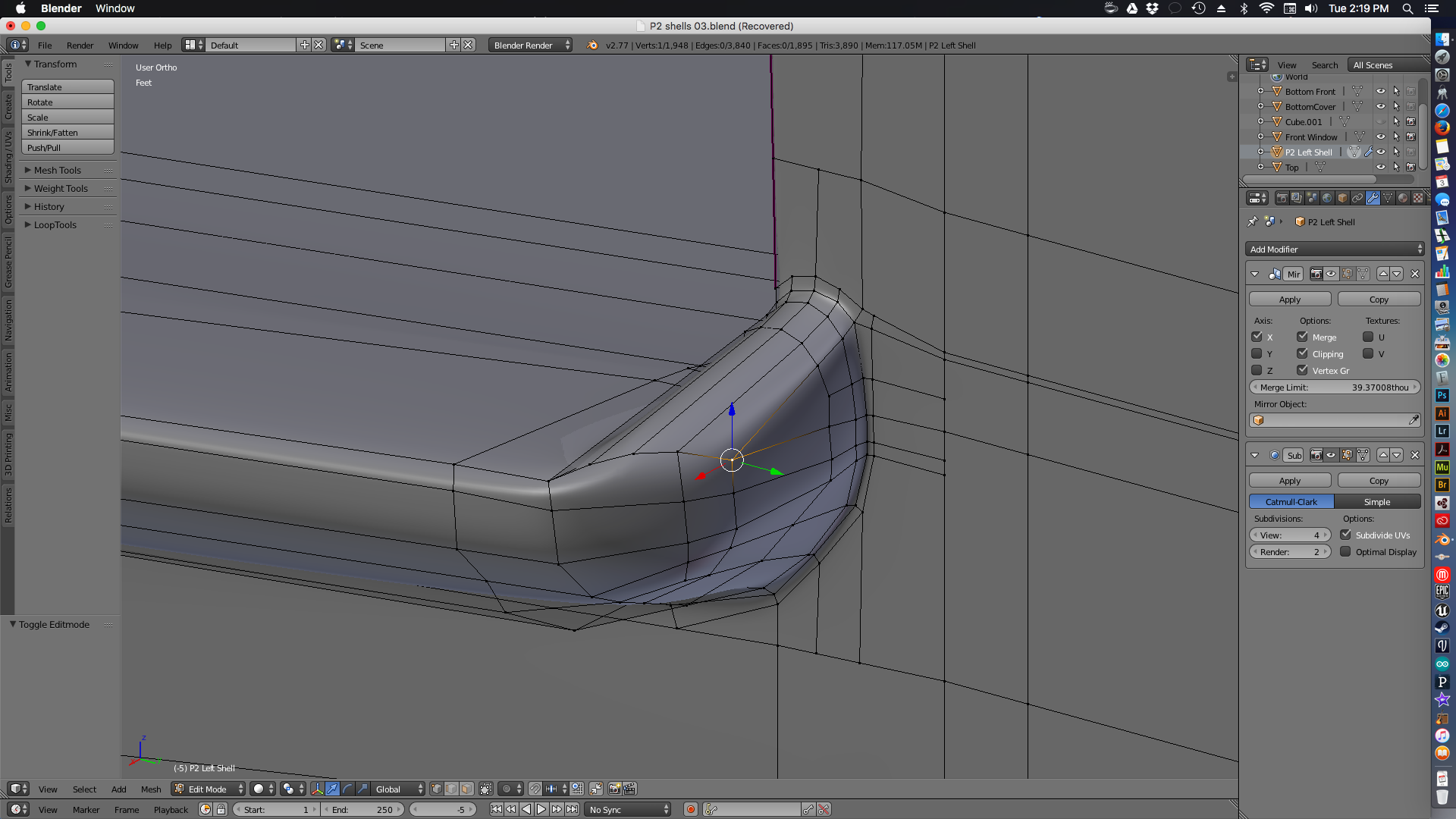

Still some very small geometry issues to fix. I spent about 90 minutes on the little nub at the back of the cradle, and it's improved, but the topology still needs work since I'm still getting some distortions and pinching, as you can see.
I think I should be able to stick a fork in that tomorrow, mirror it, and cut the side dial and other holes. The only remaining thing to model on the pistol is the little ribs and round collar for the 10-turn knob. Still haven't decided whether to make it a separate object or grow it out from the body like I did with the ribs and cradle.
I went back through my source photos of the GJ and the two known midgrades and I think overall it's maybe 90% accurate. That last 10% isn't going to improve much, since the originals are so beat up and covered in thick paint, and the Wand took some minor liberties in cleaning those areas up. But the beauty of open-sourcing the original file is that anybody who knows Blender (did I mention that Blender is FREE?) can go in and make improvements to my work. :)

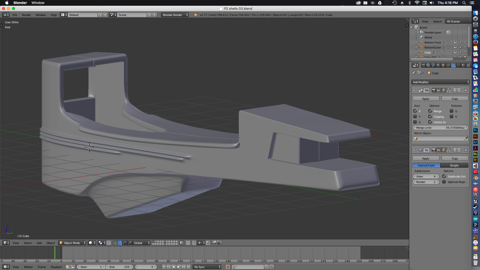

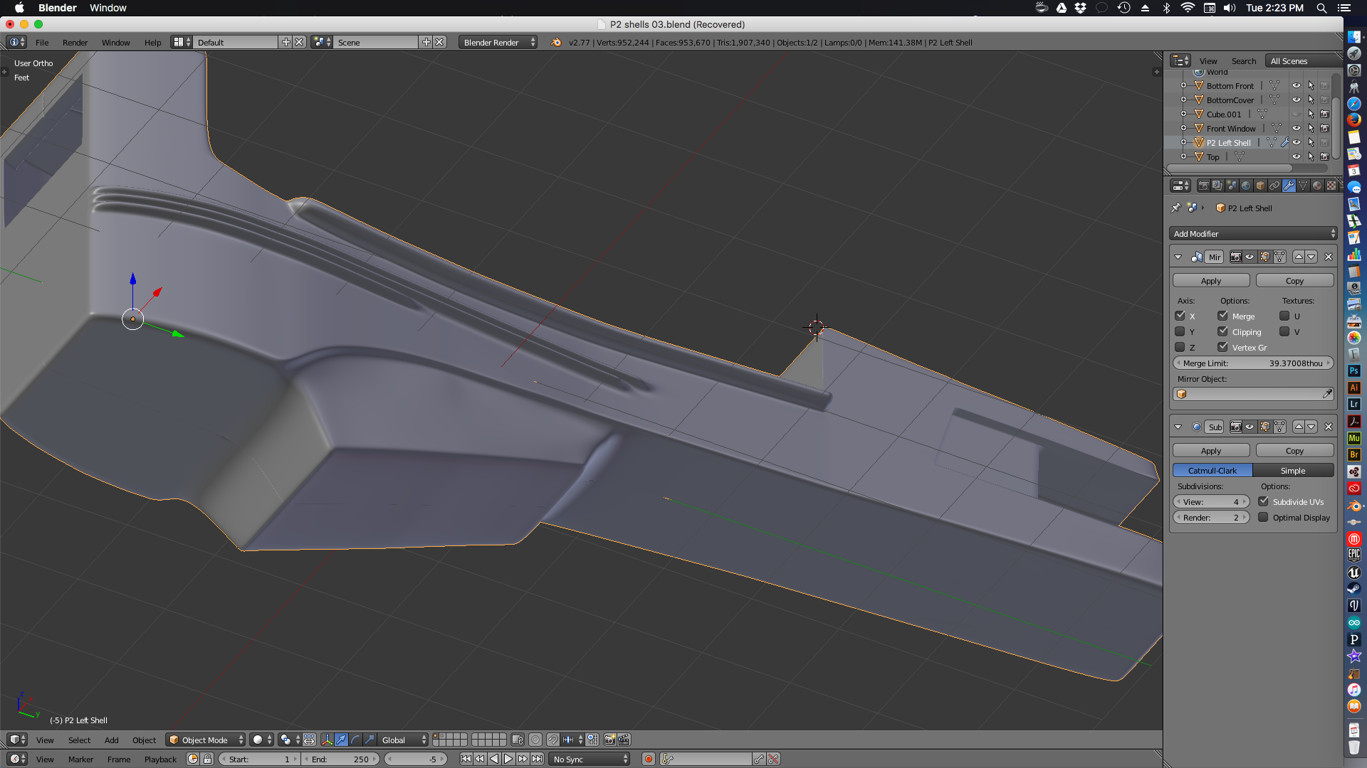

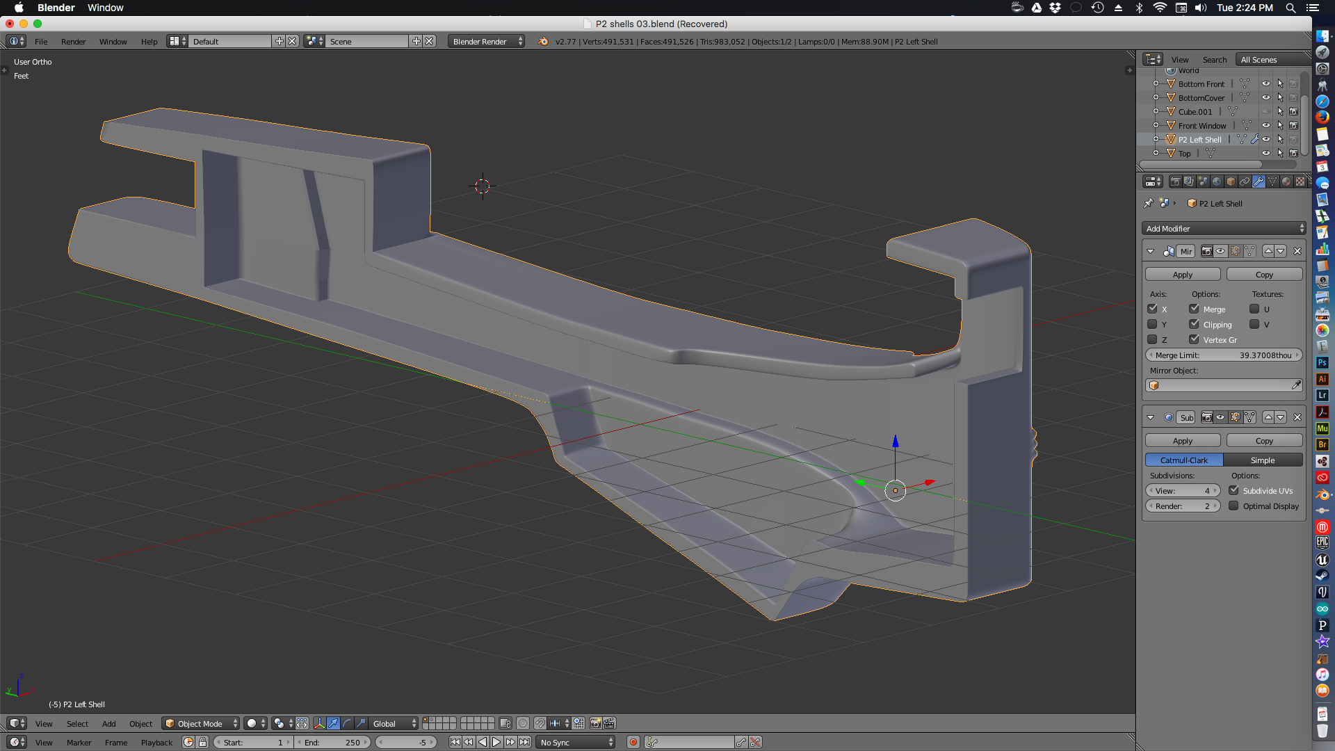

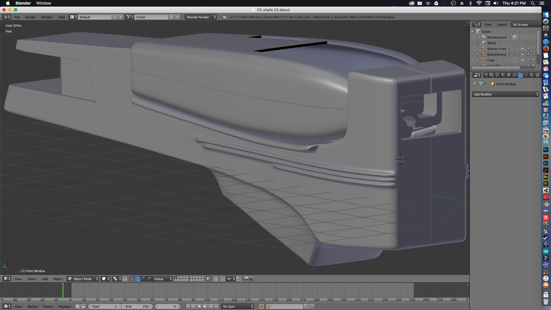

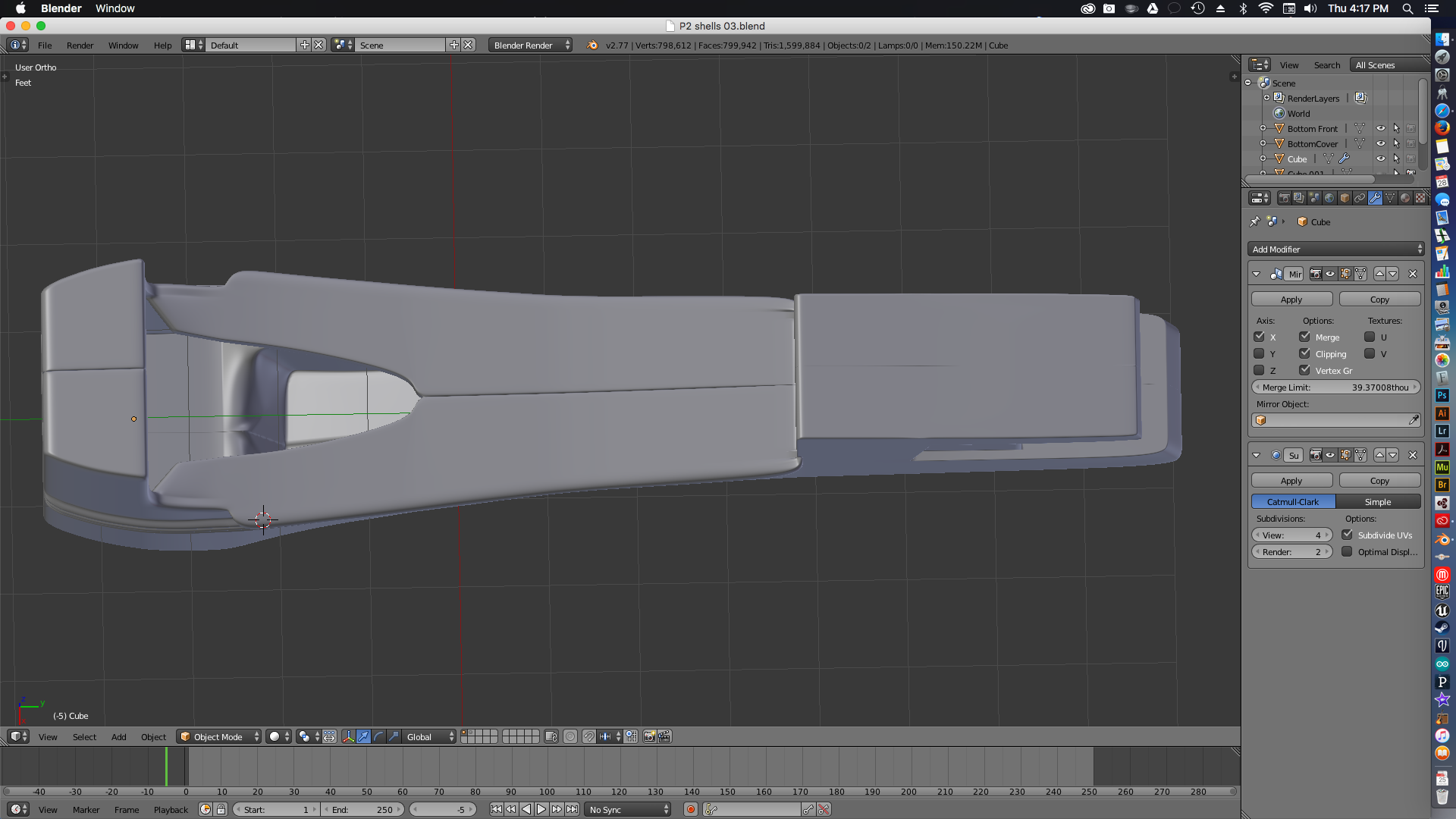

Okay -- I thought I was done, but then I noticed I'd forgotten to build something in!

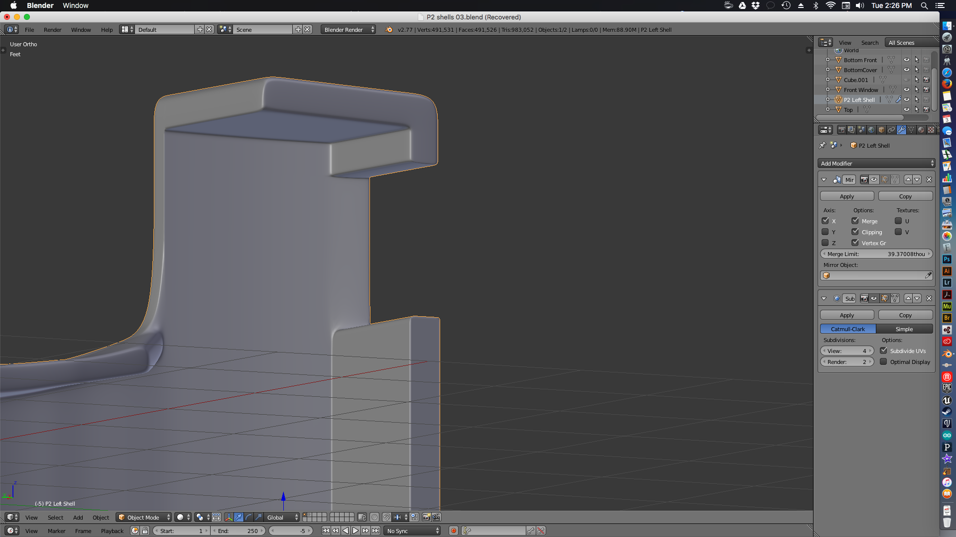

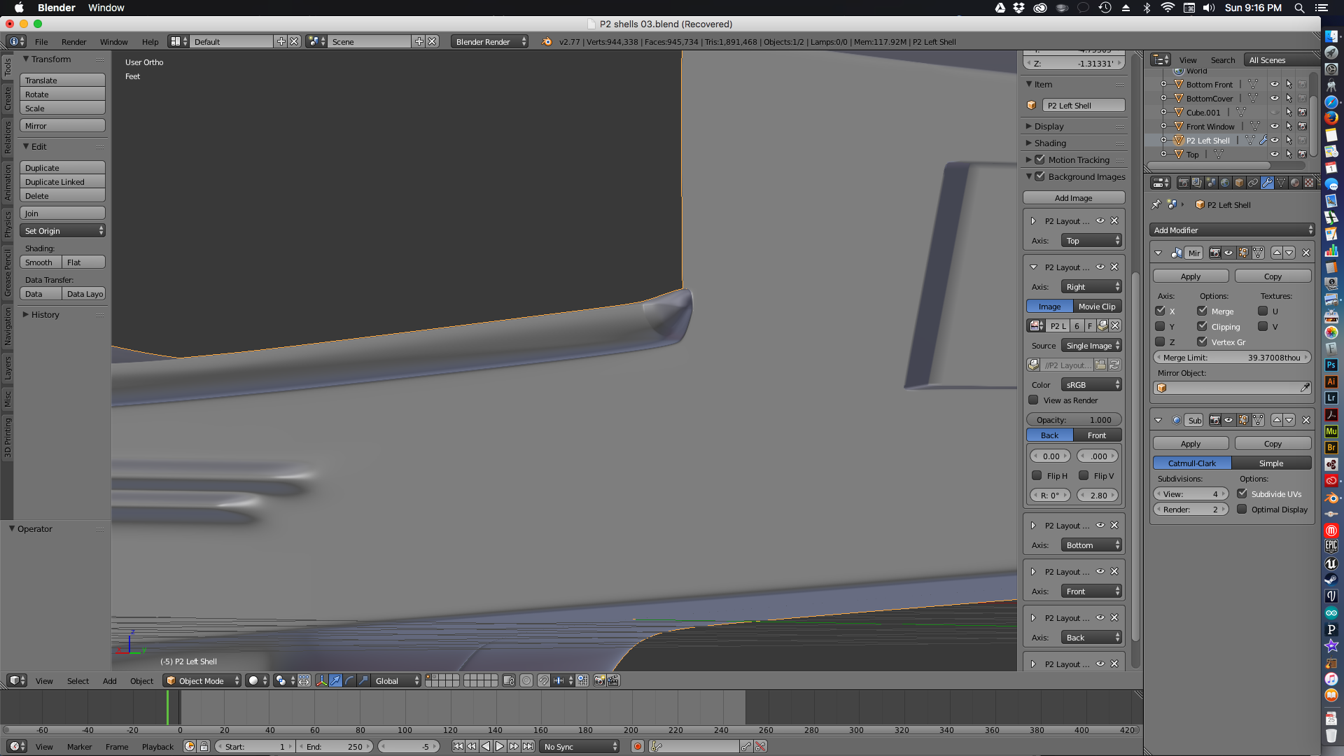

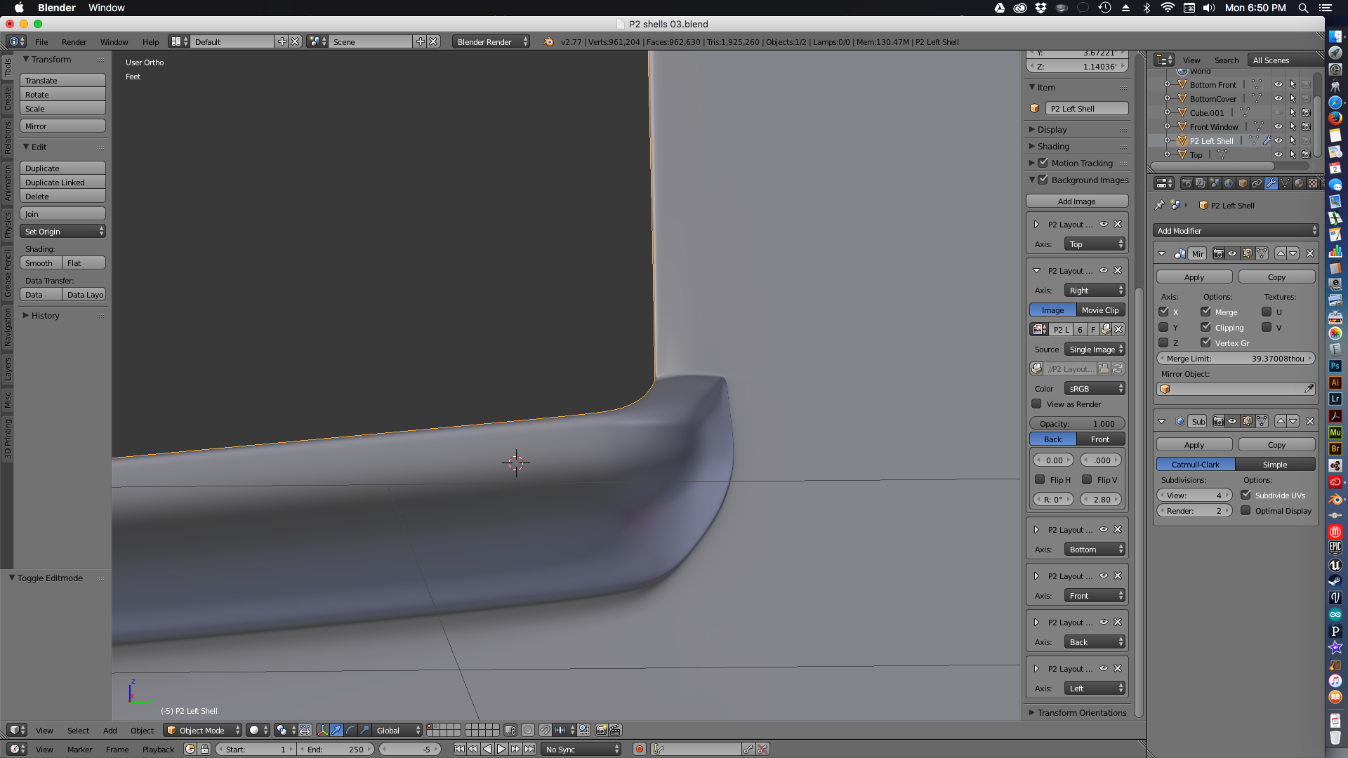

The cradle's as done as it's gonna get this go-round. It's nice and round in back, I've gotten rid of the nasty creases, and it's much smoother. I did a teeny bit of reshaping to the trigger box (nothing you'd notice easily, just rounding the profile a bit more), and was just about to proclaim it finished...
Screenshot 2016-05-03 14.19.04.pngScreenshot 2016-05-03 14.19.15.pngScreenshot 2016-05-03 14.19.46.pngScreenshot 2016-05-03 14.20.00.pngScreenshot 2016-05-03 14.21.30.pngScreenshot 2016-05-03 14.23.23.pngScreenshot 2016-05-03 14.24.13.pngScreenshot 2016-05-03 14.24.56.png
Unitl I noticed...
D'OH!
Hey, that little acrylic window's just gonna fall right outta there. Cuz I forgot to build the friggin' frame for it. :p

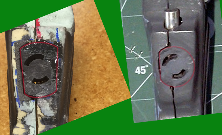

Need a change of pace today -- going stir-crazy from all the modeling. So I'm going to the shop (I still have two weeks paid for) to laser-cut a template so I can correctly sand down the female Hubbell plug every time (if you recall, I made a mess of that back when I made it for the JL MM pistol). I'll post the artwork. All you have to do is print it on card stock, cut it out with an xacto knife, and use it to mark your socket for sanding/grinding.

Wear a dust mask, bakelite is nasty. Not quite Roseann Barr and Rosie O'Donnell mudwrestling nasty, but not exactly Uma Thurman vs. ScarJo in jello, either. :p
When I sanded the Hubbell I expected to ruin a couple but it went pretty easy. I marked two straight lines on the end and sanded to those lines on my disc sander, took about a minute.
Yeah, but the trick is the orientation. I didn't have mine rotated quite enough, and as a result the handle doesn't line up properly and I have to flip it around. Besides, I paid for the month, might as well use it. :p
I sanded the female first, getting it as close to the GJ orientation as possible. Then once it was glued into the P2, I cut down the male and attached it to the female. Then glued the handle to it making sure it was in line with the P2.
Of course get your money's worth from you membership, especially if there's anything that you can't do at the new place.
