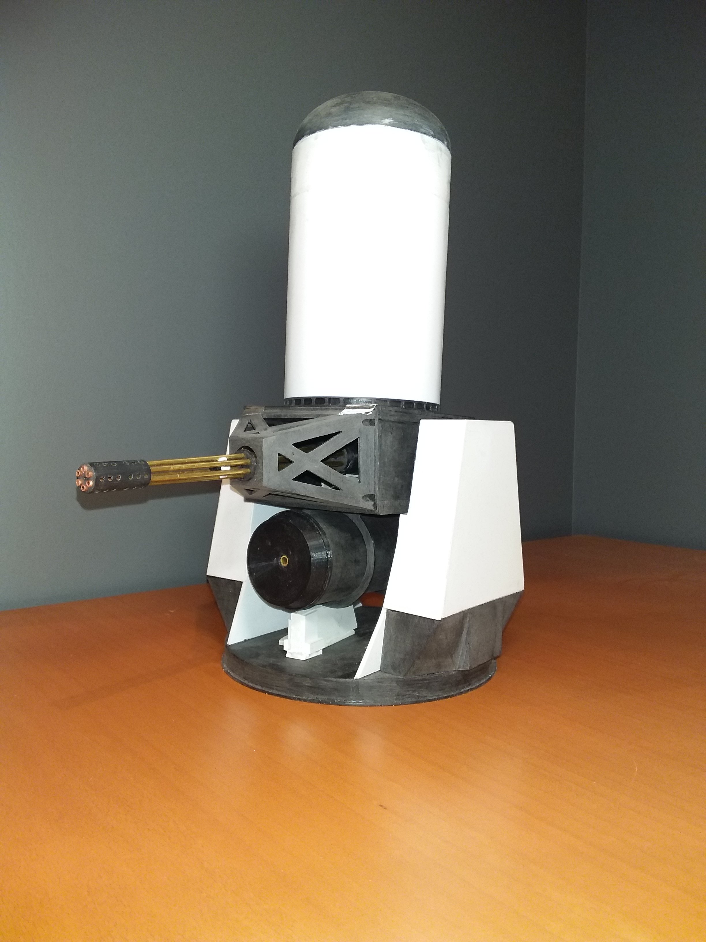

Designing this partially in 3D. Block 1B version.
TazMan2000
TazMan2000

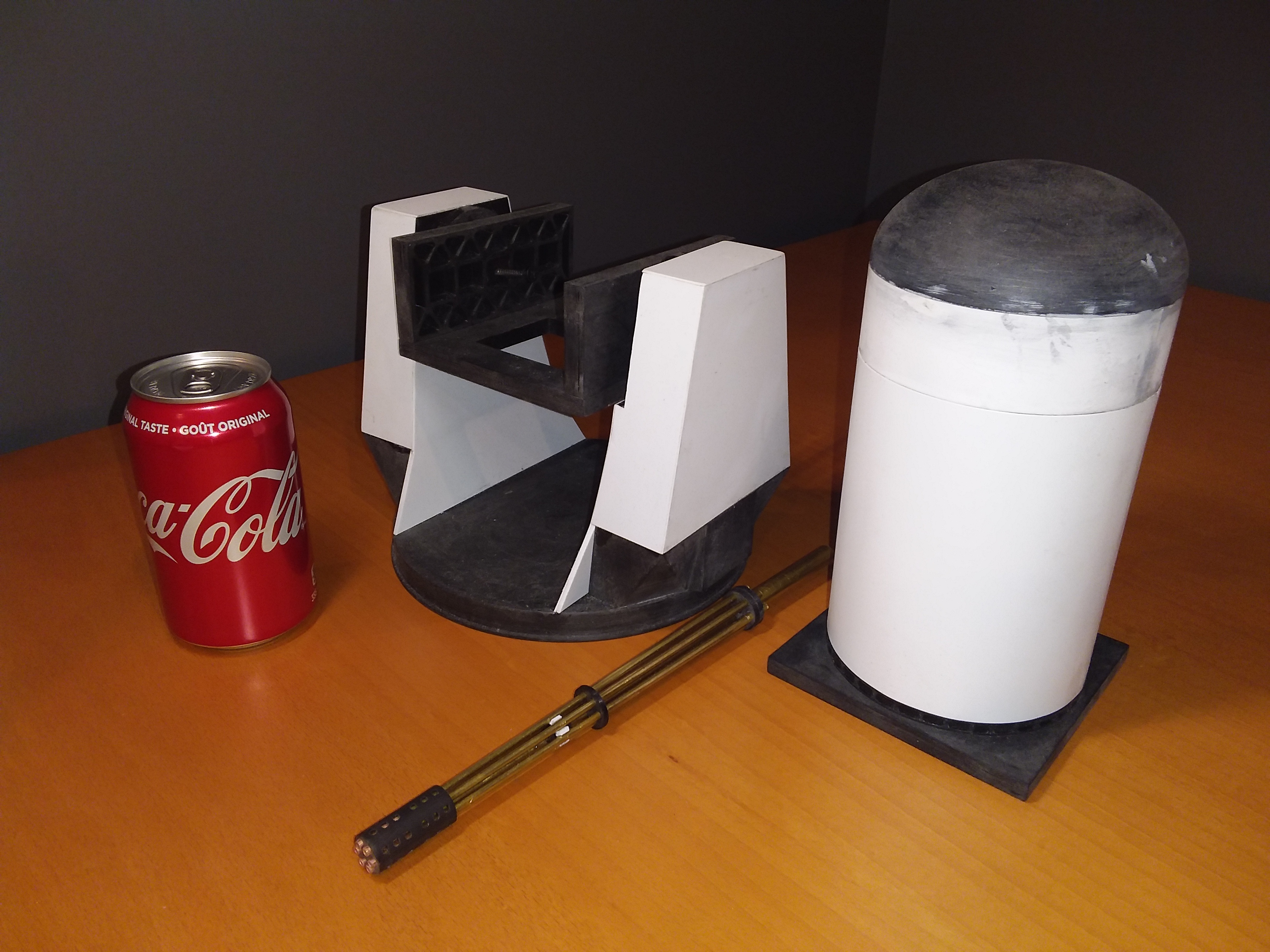

Taped and screwed stuff together to see how things move and what clearances I have. The drum magazine has two end caps I can pop on and off, for now, so I can put in and adjust a counterweight since it is quite top heavy.

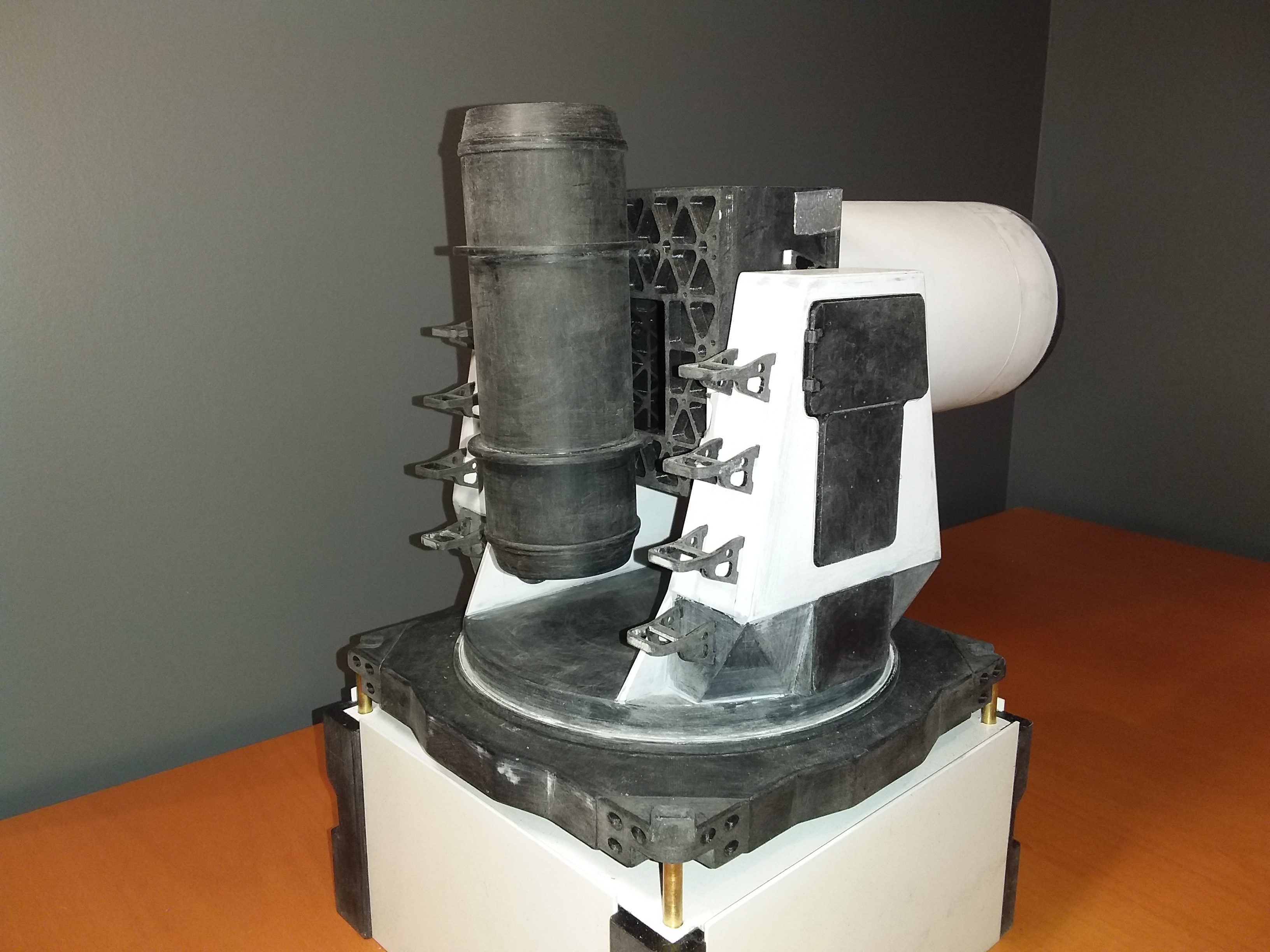

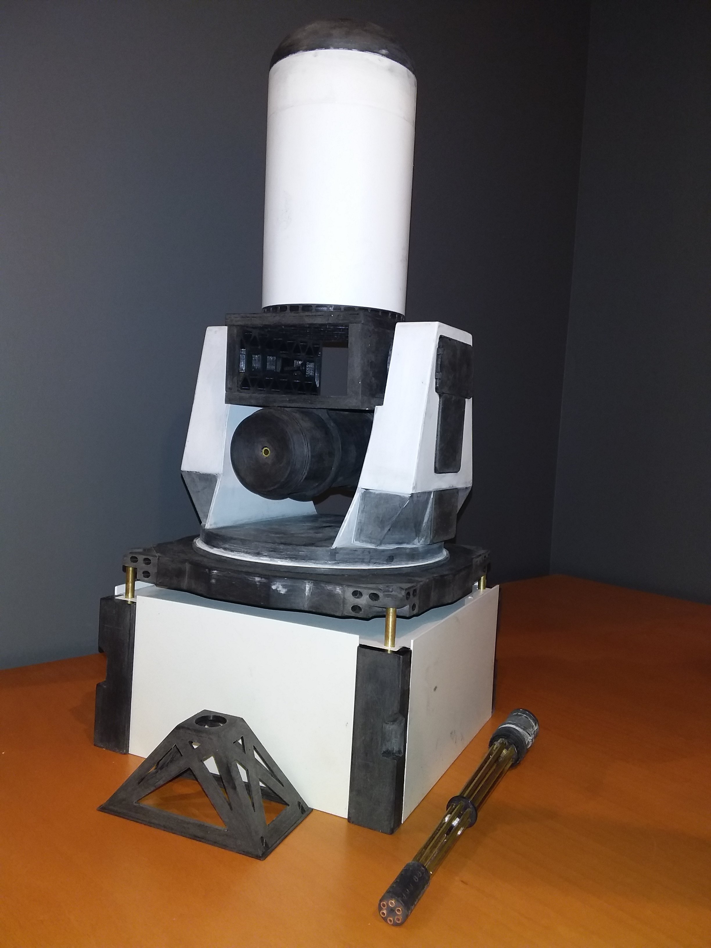

I decided to build the mounting to this as well. There is still a back section to go. I printed out the frame of the mounting and just glued styrene to it while accommodating the holes for the 1/4 inch brass tube that needed for mounting the vibration table dampener (I have no idea what the proper name is). The base is really light weight.
The panels on the hexagonal/trapezoidal are 3d printed as well. I could have modelled them the traditional way but on the real one there are bolts evenly spaced around them so I put holes in the places they would go so I can more accurately glue bolt heads to them.

Designed and printed out the maintenance steps/handles(Is that what they are? No pics on the web with anyone using them for that purpose). Also designed a device to limit the rotation of the gun/radar. I would assume that this limiter is different for some ships, because the Phalanx can be mounted high on aircraft carriers and much lower on frigates/destroyers. You would think that it shouldn't be able to shoot holes in your deck.
The ammo chute is going to be a bit of a chore. I printed out a few and glued them by hand to a strip with notches. It turned out better than expected but the spacing was too far apart, and I realized I needed a jig to assemble this together. The biggest problem is to get a material flexible enough to bend the chute in a smooth curve but strong enough not to snap or disbond the links when stressed to a curve.

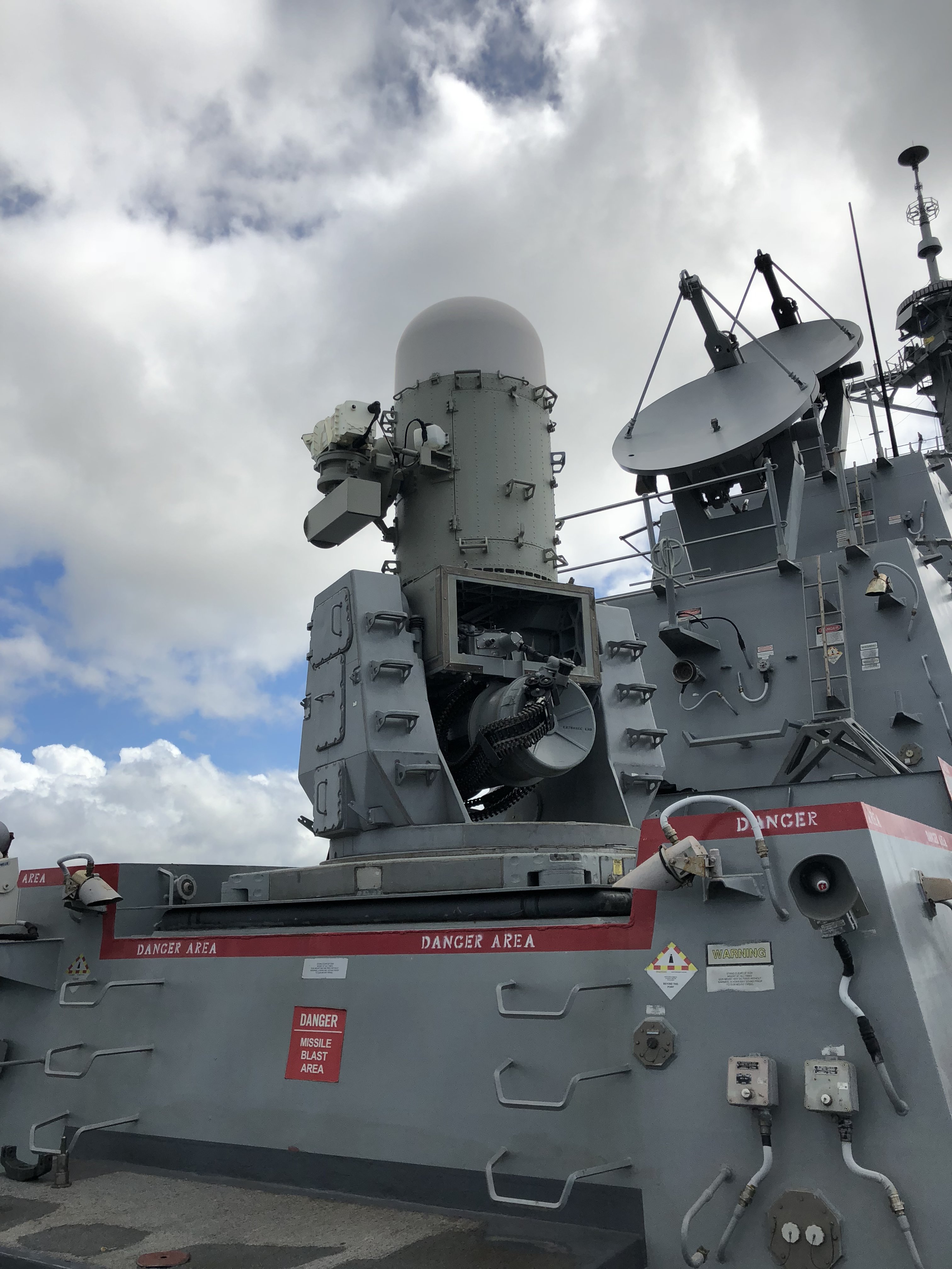

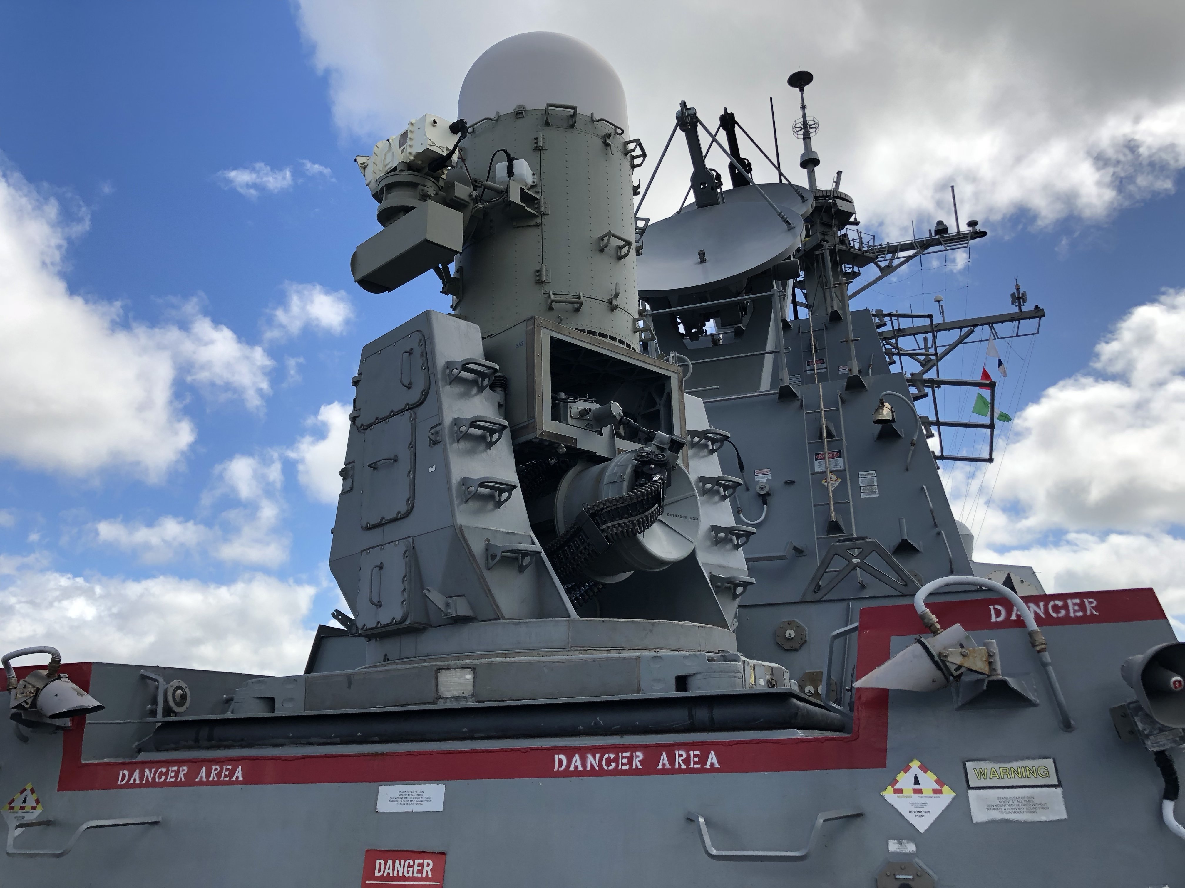

TazMan2000 i keep meaning to offer some pics to you. Until recently I have been a 3D modeler working on training apps for the Navy. Last year I spent a couple days on a ship in Hawaii and got some pics of one of these guys with the intention of 3d modeling one for myself. PM me if intereste.
so I just looked on my phone and only took 2 pics from roughly the same angle,sorry. Still welcome to’em though. I got more pics of the big front gun and exterior of the bridge. I was exhausted as I was only 6 weeks out from brain surgery and going from D.C. to Hawaii and back in 72 hours made for mushy memorie...

Taz,here they are,and for anyone else, not like it’s secret stuff. It’s funny, on the ship you can take a pic of just about anything, but if you take pics from land on the other side of the fence from the ship they’ll take your phone.
