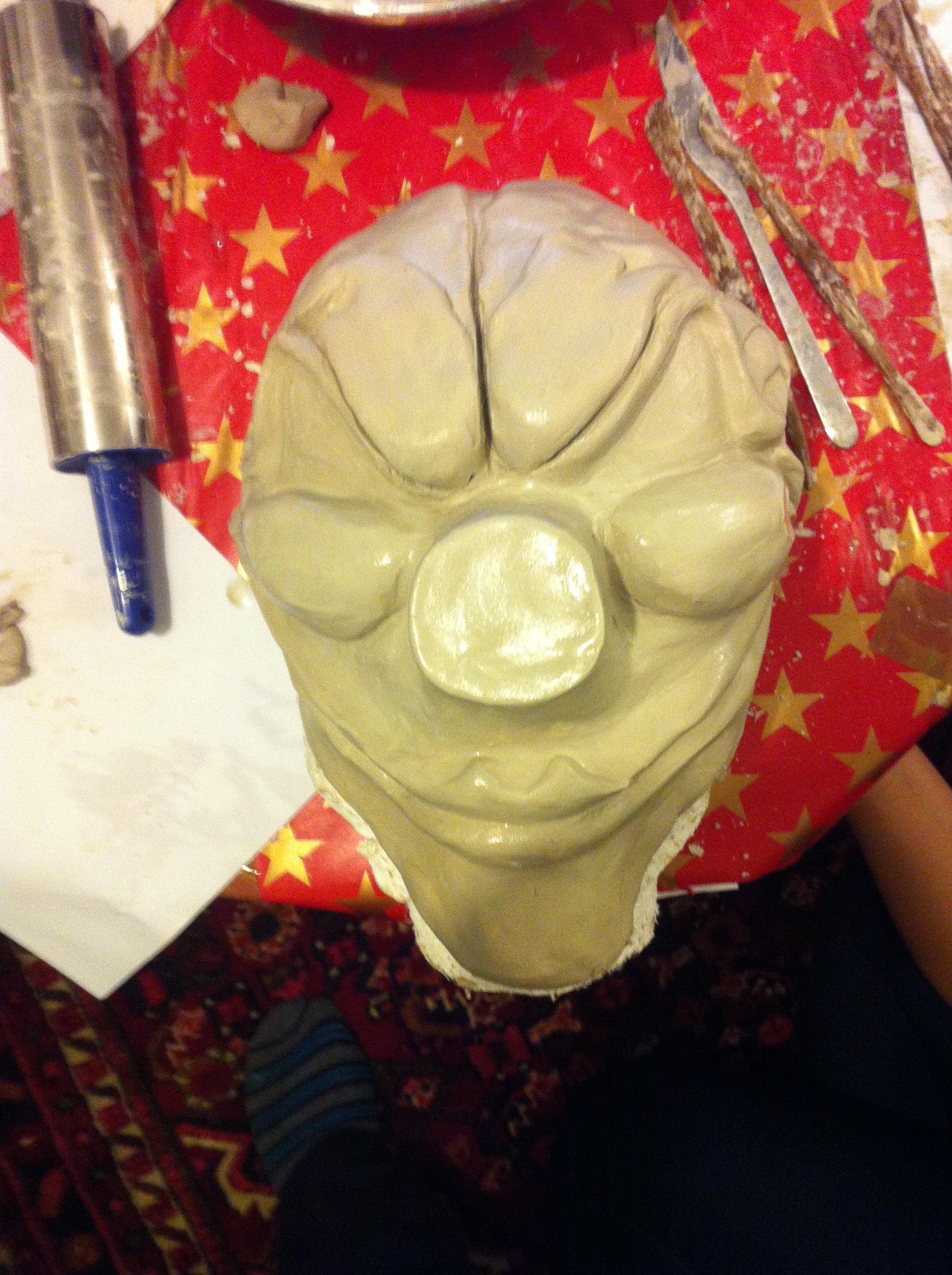

Forgot to add what we did today to start! We've made the clay sculpt, and that's all so far, but it's looking pretty sweet.
We began with a simple plaster life-cast of my face (which is pretty creepy looking):
attachment.php

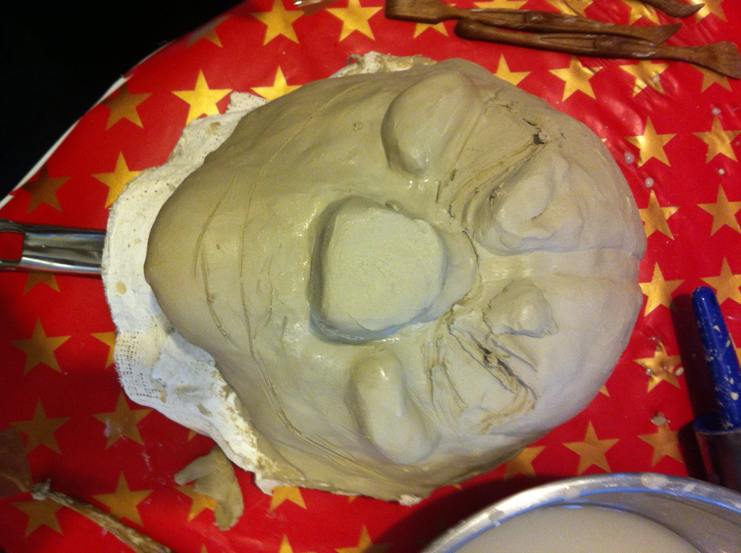

We followed that up with layering clay on, before sculpting it into the shape of Hoxton's mask over the course of a few hours, here's the process:
Until we got to something fairly good looking! To be honest, by the second picture I was struggling and the girlfriend took over, I think she did an amazing job.
attachment.php
attachment.php
The next step will be making the silicone mold! One the glycerine arrives, I'll get right on that.

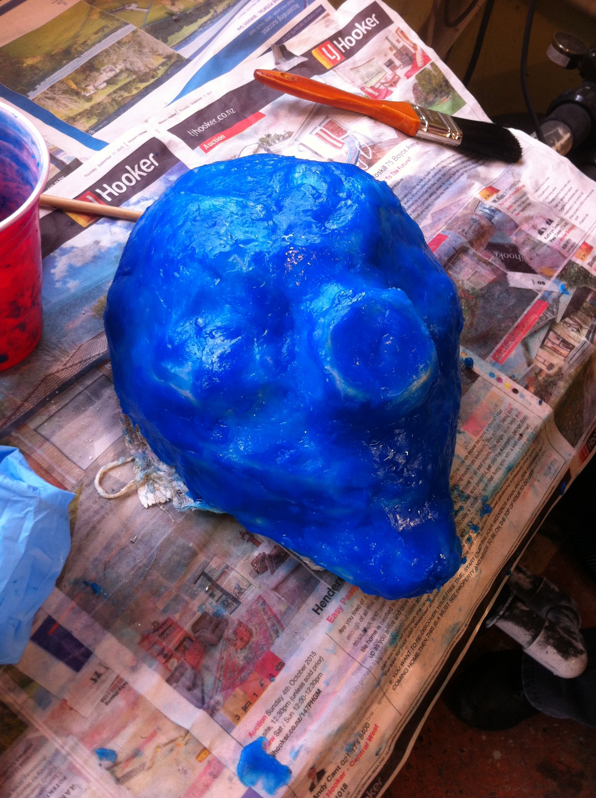

After months and months of saving up, finally bought all of my materials.
I decided to make my silicone mold myself, as where I am (New Zealand) it's nearly impossible to get professional materials for this kind of thing.
My mold is made up of:
100% silicone caulk, liquid glycerin, acrylic paint and (to some extent) acetone.

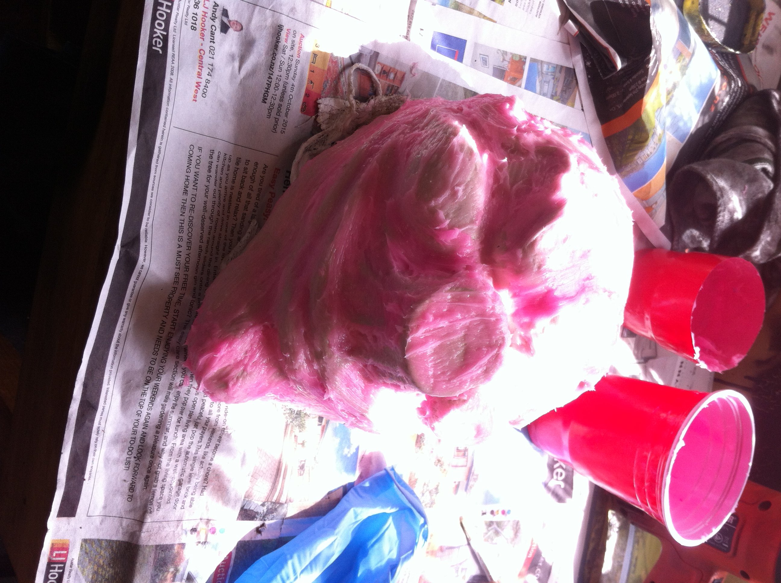

So, after giving the clay sculpt a coat of PlastiKoat and vaseline, to smooth and moisten it, I began applying my mold. The first thin layer I painted into the creases and details of the sculpt. After curing, I followed this up with three thicker layers of silicone, obviously waiting for each layer to cure and dry before applying the next. I also added registration marks in order to help with the application of a fibreglass mother mold, which I plan to apply within the next few days.

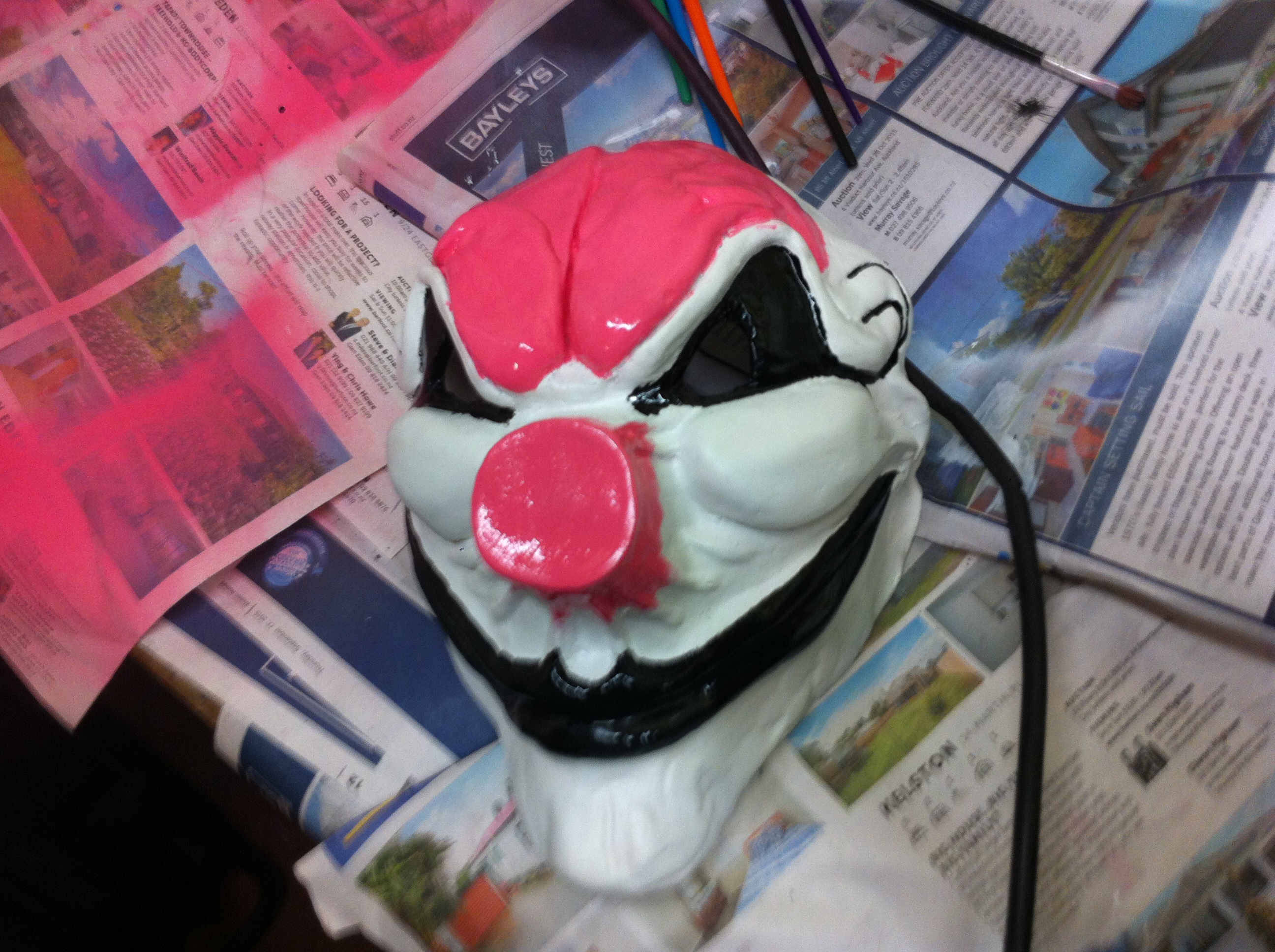

Next, I put down a few base coats of matte white, masked the white areas off and applied gloss pink on the forehead and nose. This came out badly, because the tape put alot of chips and gaps in the white paint. I ended up going over the white again with a paintbrush, and fixing up the borders of the pink, ending up with this:
IT'S TAKING SHAPE!
Next, I decided to abandon the tape entirely, and just use a paintbrush to apply the gloss black on the nose and eyes. After leaving this to dry, I hit the whole thing with a few coats of ClearCoat, to seal in the paint and add a lovely gloss finish.
I like how this turned out; but for my next mask I'll definitely be investing in an airbrush. Will make the whole thing look a hundred times better.

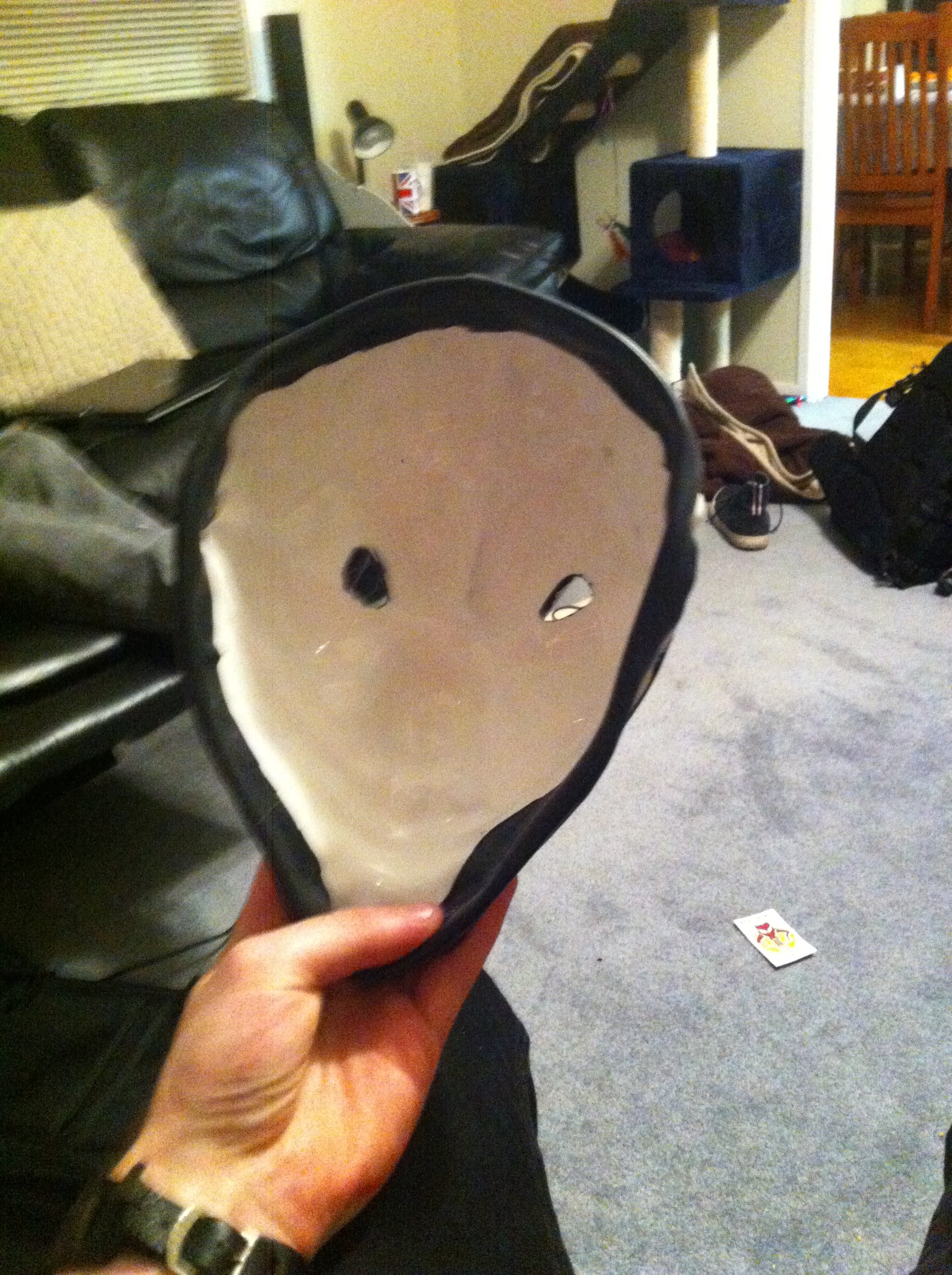

When looking for bits and bobs at The Warehouse, I found this little gem for $6: a bicycle inner tube.
After cutting the thing in half and trimming it down, I used some crazy strong epoxy superglue to slowly attach it to the edges of the mask, all around. Came out looking pretty top, and didn't have to break the bank.

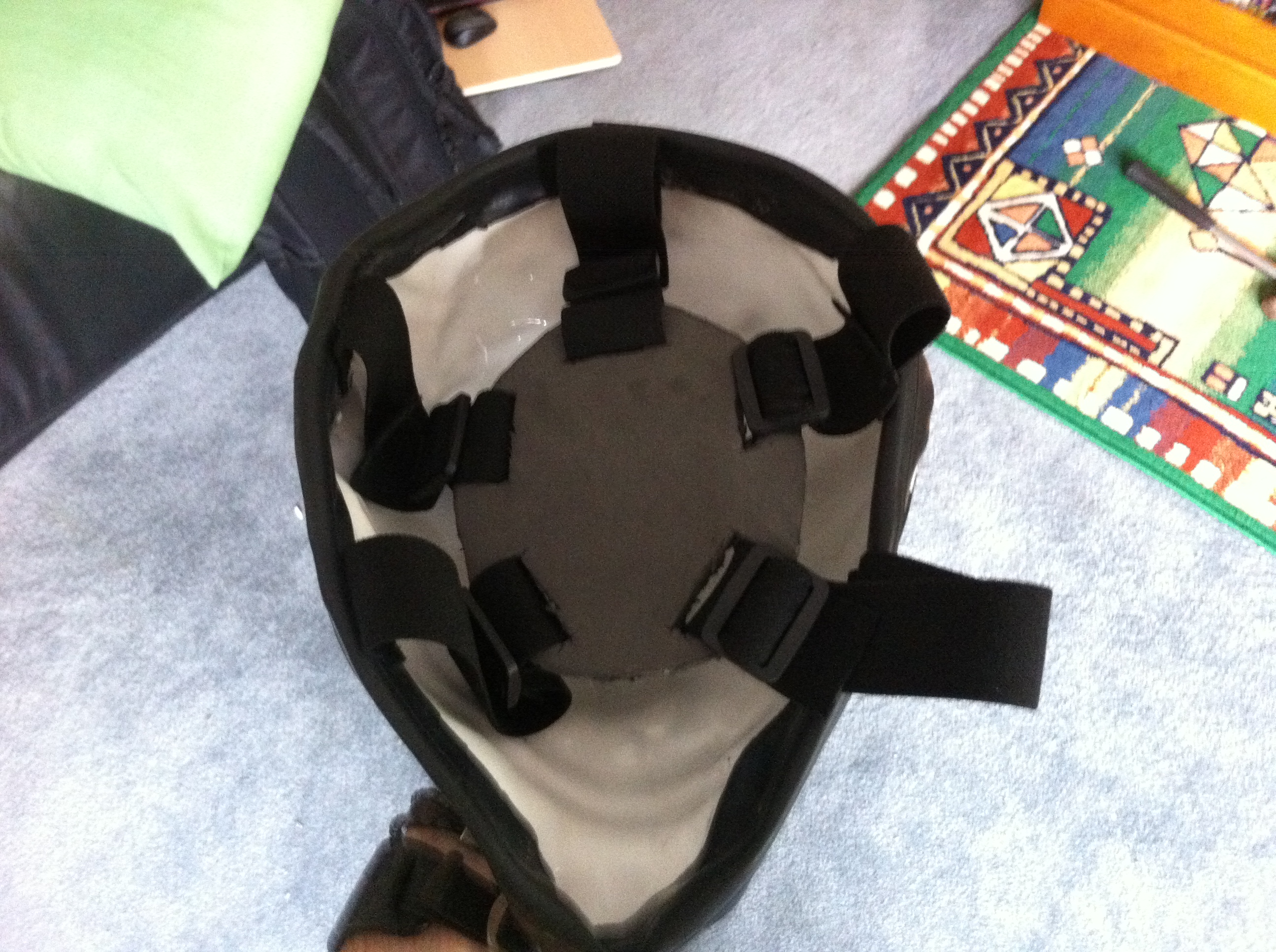

Next, I needed to strap the thing to my head. Looking over ingame models + official PAYDAY merch, I could see they use a backplate method: One solid plate at the back, with five elastic straps connected to it:
Payday2-Chains-Resin-Mask-The-theme-of-the-film-characters-Mask-Resin-hand-made-High-Quality.jpg
For this, I got a bunch of thick, strong elastic from a dollar store, and some plastic fasteners (the kind you see on backpack straps etc) to make them size-adjustable.
Taking some good ol'd fashion EVA foam, I crafted a piece based on the back of my skull. Cutting 5 slits in it, I passed the five elastic pieces (with fasteners attached) through the EVA, and glued them in place inside the mask. It turned out brilliantly: comfy, and not too bad looking in my opinion!
SO SHE IS DONE! I will be doing some test shots in the full get-up in the next few days. The rest of the cosplay consists of a nice grey suit, an EVA + Cloth formed bulletproof vest, some blue gloves, a duffel bag, a bunch of fake cash and cocaine, and a trusty selection of airsoft guns (AK-47, Revolver, Glock 17), and I can't wait.
Hope I've given people tips/inspiration. If this is my first build, you lot can surely do alot better. :D Go forth and craft, you magnificent bastards.
