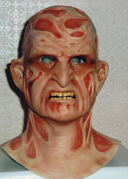

    When I made masks I used to mix acrylic paint with watered down carpet adhesive latex.
