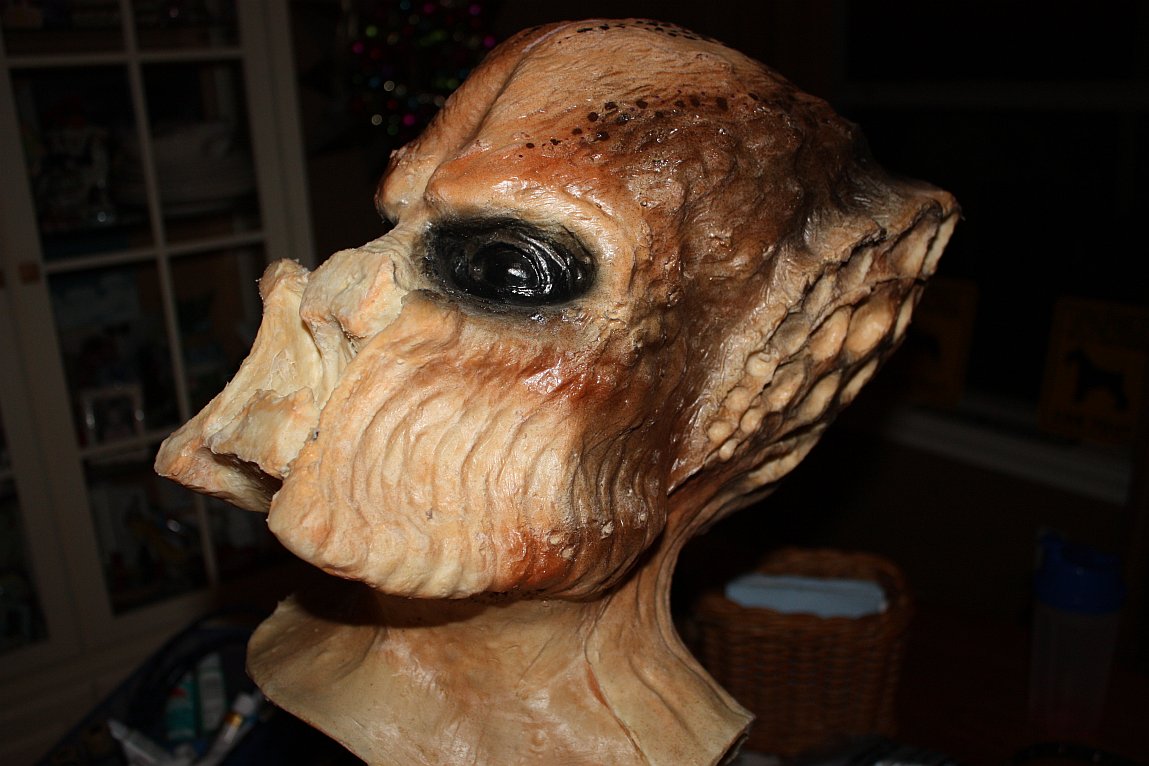

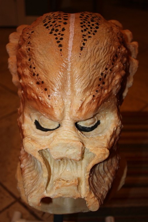

Hey ya'll. I got anxious and starting airbrushing my undermask with Createx paints without mixing in any rubber cement or prosaide. I finely applied the paints and so far I can detect no cracking whatsoever. Is it only a matter of time? Should I continue with prosaide on further layers? Have I totally screwed the pooch? thanks!
a couple of pics so far. (not finished).

Are you screwed? Yes and no.. Technically, yes.. If any of your layers needed a latex, prosaid or rubber cement mix, it would have been your initial layers. However.. Sealing it in permawet or polyacrylic may work this late in the game
vonroll
maybe you'll get lucky :cry:
Oh great. haha
Anyway, so looking at the createx paint specs it says it's good for latex. Why would they say that... just because it applies to latex? Maybe they don't account for any elasticity? Being that a lot of createx paint is used on t-shirts and materials that stretch, wouldn't one assume that they have built in elastic properties?
Ok, so maybe I'm just trying to reassure myself. What if I wanted to start over, how would I remove the paint without too much damage? That might be a bigger mess than just continuing with the suggestions here.
thanks guys.
