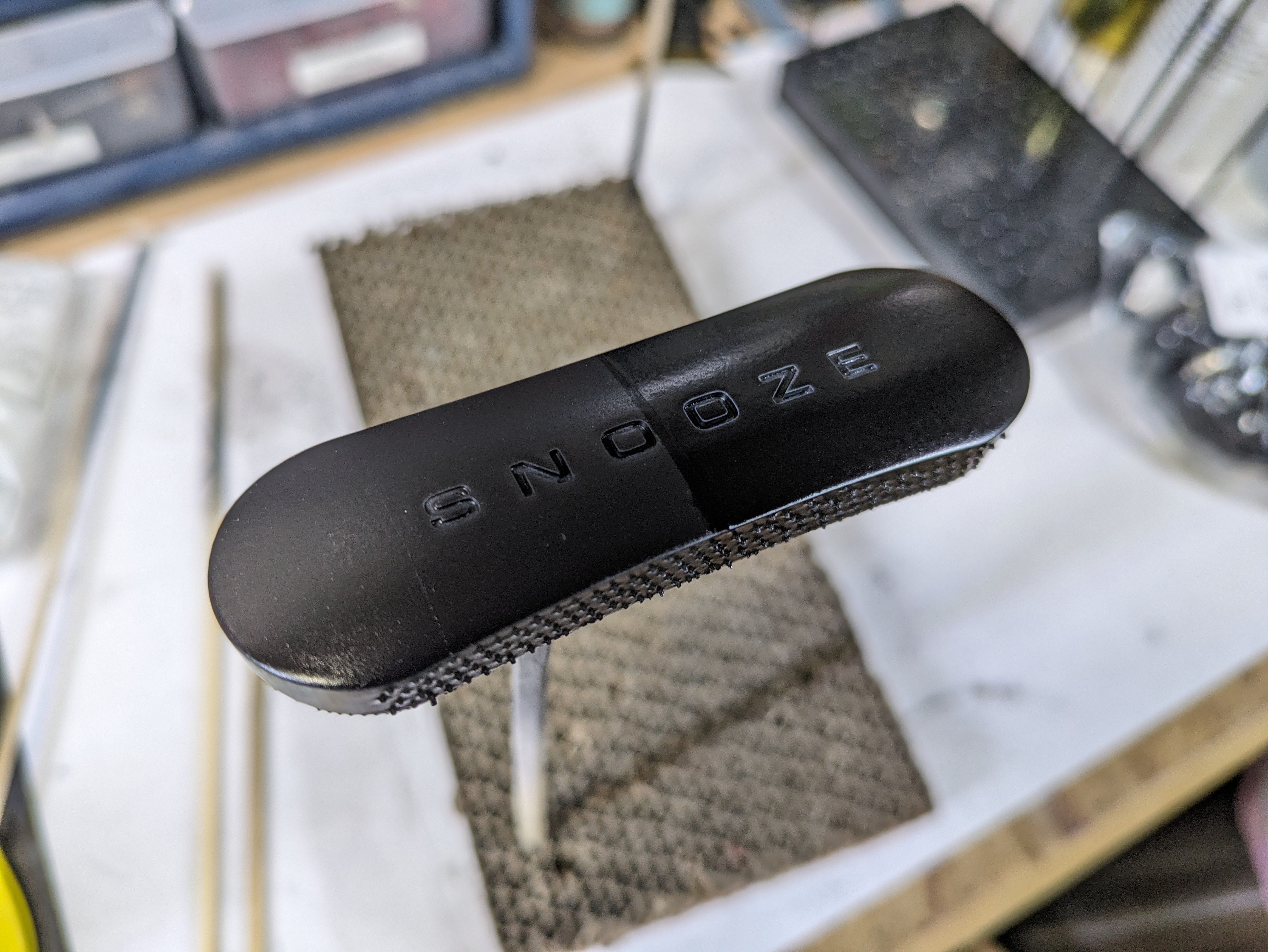

Indeed, since it seems to kind of come down to different brand characteristics and painting styles, a test on a throwaway piece is exactly what I did.
The left side is flat black undercoat, the right is satin black. Both were given a satin clearcoat, and the difference is striking! So it shows me that like stated above, the satin or gloss clearcoats WILL darken their undercoats some, but not all the way to the level of matching satin for satin. The sheen is the same, of course, but factoring in darkening is absolutely necessary here.

That really is a striking difference. Two very different satin sheens and looks.
