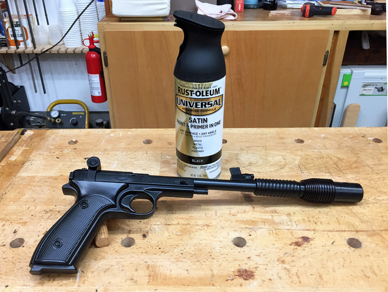

I always hate it when someone asks for advice in a thread and then never reports back, leaving everyone hanging. To avoid being guilty of that, here's what I ended up doing.
I got a can of Rustoleum Universal Paint/Primer All-In-One in a satin sheen, which was rated for wood, metal, plastic and masonry. Gave the blaster a light all-over sanding, then a couple coats of the Rustoleum. Came out perfect, and the paint seems very strong. I tried scratching it in an out-of-the-way spot, and the paint held up just fine.
Really pleased how this came out. This is just for a one-time Halloween costume use for my wife, so I didn't do any other modding or authenticity upgrades, just the basic paint job.
A.J.
Nice. I love that Rustoleum Universal paint, but probably 75% of the time I get a can that leaks everywhere from that convoluted spray mechanism. Hope you got a good can! :)
-Rog
Geez, you're absolutely right! The first coat I gave the blaster, I had paint running down my trigger finger and all over my hand. Didn't have the issue on subsequent coats, though, but I have no idea why or what I was doing differently.
A.J.
