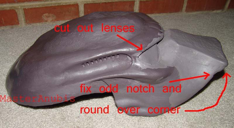

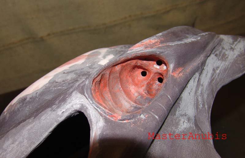

I knew I was getting one of the last of the bios coming out of this mold and had a good idea what I was getting into. These are the pics out of the box and what I wanted to change or correct.

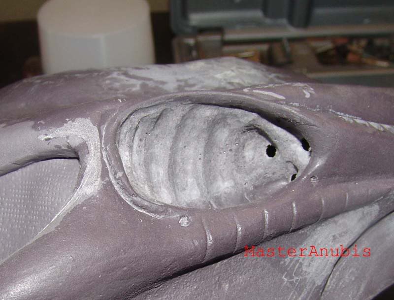

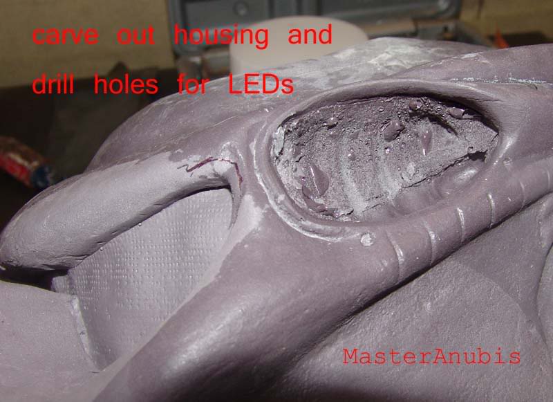

I carved out the lazer housing and carved in a ridge around the left eye. The holes for the LEDs were just for positioning and not drilled to size, yet.
These are Dremel brand high speed cutters. These work great with this resin.

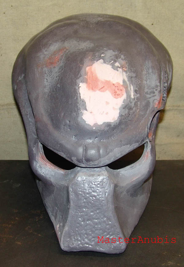

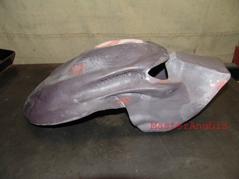

Prep included washing the bio in soapy water and sanding any areas that I wanted to putty with a 100 grit sand paper. Using glazing putty (for auto body) and my finger, I filled in all the small holes from bubbles. I also coated the lazer housing just to be sure.
I prepped the areas that I wanted to use filler (Bondo) using 80 grit sand paper. I probably should have used 100 grit. Then mixed and applied the filler. The dome and the chin piece both took two passes to fill and shape the way I wanted. Bondo is good because it can be shaped with a sharp razor or sanded.
This is after I liked the shaping and three coats of black sandable primer.

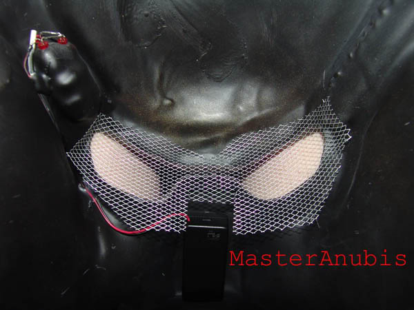

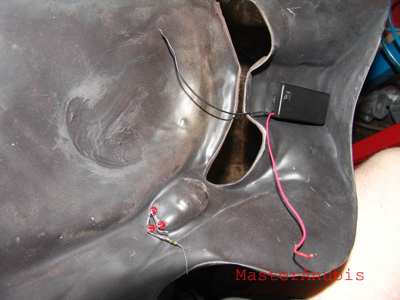

I widened the holes to 5/16";. That allows the LEDs to press in and not need glue. I put in the LEDs and bent the wires over so I could solder them in series. Since I'm using a 9v battery I used a 220 ohm resister in series also. This is moched up to where I'll put them.
I soldered the wires together and velcroed the battery box to the inside and hot glued the wires in place. I also taped off and painted the wires primer black so that it would be harder to see the wires through the eyes.
This is a test fit of the expanded aluminum that I got from my neighbor. He doesn't know where he got it. I lined up the pattern to the way I wanted it and gently pressed the edges down a little.
Cut the areas where it would be a corner so that it won't bunch up and deform. Tape the edges down to hold it long enough for the hot glue to cool and move around until it is complete.
I trimmed off as much extra material as I could.

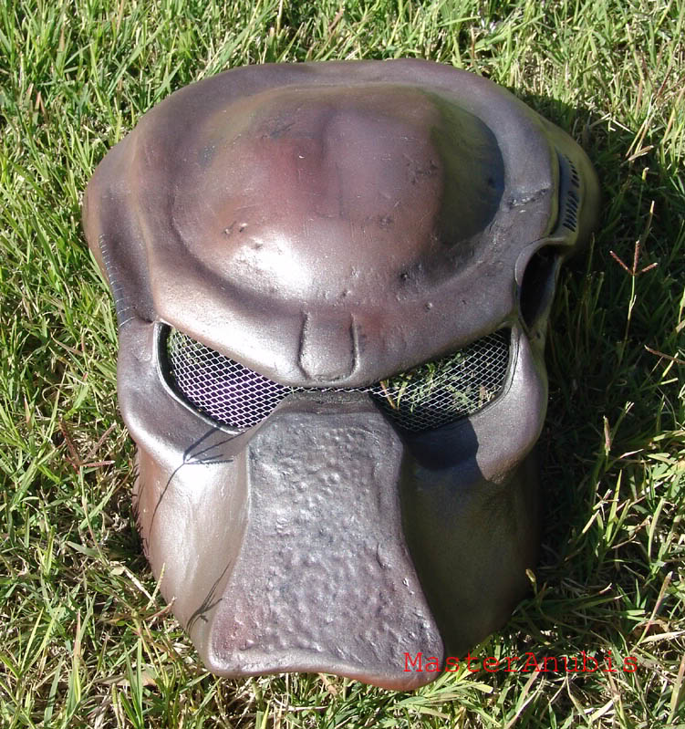

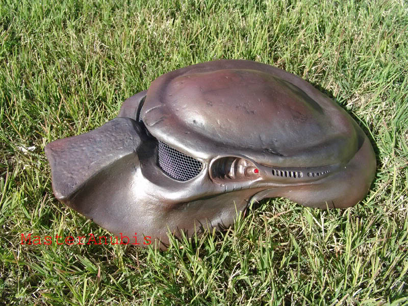

LEDs and screen installed.

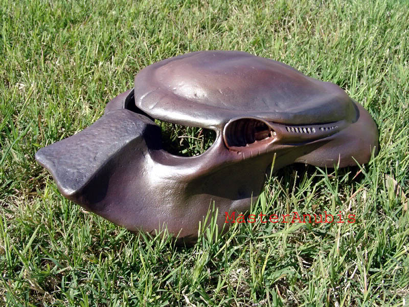

Pics in full blown sun. Yes, I know cloudy days are great for pics. There aren't that many 'round here. It does look different in different light.
