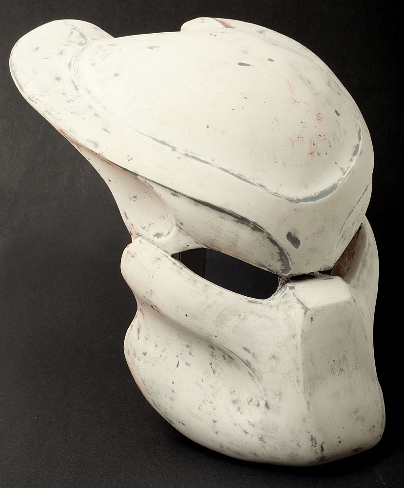

Anyway, here it is, as it stands. I have taken down the primer, smoothed the surface ever so slightly, begun removing burs, and glazed a few pinholes and other areas, and applied some apoxie sculpt to the main mold damage and where the resin and fiberglass backing had gaps. I have sanded most of that back down and here it is. My greatest struggle right now is how to handle the edges. In looking at the helmets from AVP and Predators, the edges actually curl all the way under so you see little to no actual edge but rather a rounded lip around the rim of the helmet. I simply don't have good enough reference to tell if the P1 was done the same or whether it is just the raw edge, sanded and cleaned up. If I have to build a false lip, it is going to take a LOT of apoxie putty.

Hey Art.. It's George.. Met you at Monsterpalooza..glad Ross was able to get you that pull from my mold. As for building up that lip, many of us have been using plumber epoxy.. It's way easier to use then epoxy sculpt.. Dries fast and is easy to sand
PredatrHuntr
Congrats on getting the holy grail of Bios!!!
The inside of the rim can be rounded, but thats a lot of work. I personally try to follow the natural lines and trim them down with a dremel to make the lines even. I did 2 of the P1 Stunts and the lines are pretty much there - just need some TLC. The difficult part for me was getting the area between the eyes and mouth straight again. Thank goodness for Apoxie :popcorn:
I had so much fun cleaning up my 2...its such a wicked Bio to see in person. If you need any reference pics, here's a couple threads for you:
http://www.thehunterslair.com/index.php?sh...mp;#entry287539
http://www.thehunterslair.com/index.php?sh...21497&st=40

George, it was great to meet you and I absolutely love the helmet! It is one of my all-time favorite movie designs! Is plumbers epoxy something I can just pick up from Home Depot or does it need to be special ordered?

Yup - thats where I got mine from. George uses Plumbers Epoxy because it sets quickly - 5-10 minutes or so, whereas I prefer Apoxie Sculpt because it has an hour of working time.

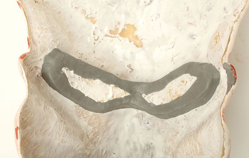

One last bit for today. Having seen the other examples of members building up the visor area, I went ahead and built mine up PRIOR to cutting the eyes. I am hoping that will strengthen the overall lip and keep it from falling apart when I cut the eyes out and provide a nice platform for the visor to rest on.

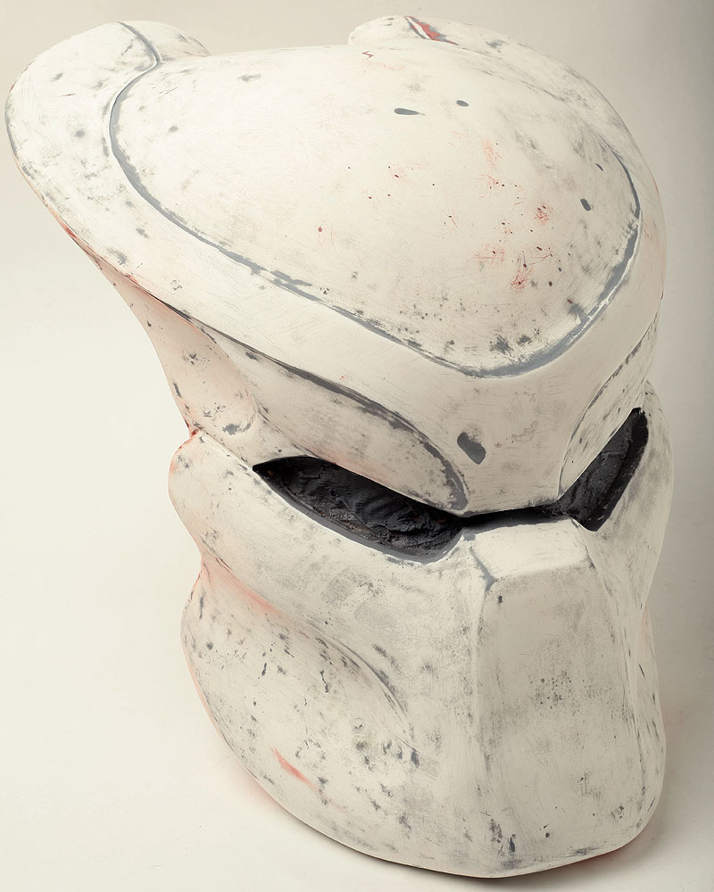

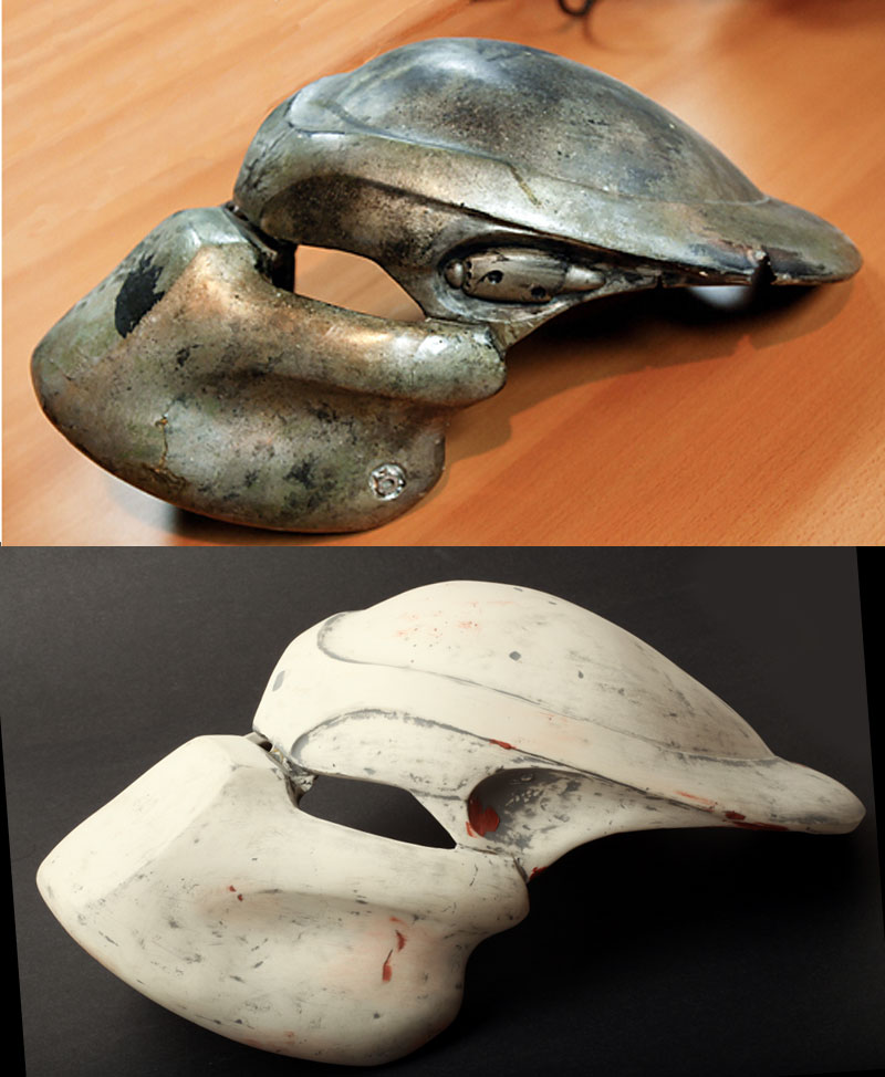

So I cut out the eyes... and man, are they harder than I thought. Based on pics that Jason posted, it would seem the only known original helmet does has the pieces between the eyes intact, so I am TRYING to keep mine intact as well, but it is tough. I am going to have to go back in and build a bit of it back up because I took too much out. Here is a comparison. The angle of my helmet isn't right but it is close. After looking at the movie, and looking at this pic, I see the edging along the back of the helmet needs to be MUCH thinner.

Its hard to see in that last known original Bio pic, but you could be right about the piece between the eyes and the mouth being intact. Who knows if that was screen used or just a duplicate copy in case anything happened to the screen used ones. Typically that area is cut out to allow for the lenses to go all the way across from eye to eye, but I have to admit that having left the support in between give it more strength if dropped and while painting.
The one physical attribute I never liked about Bios was how fragile they can be if the resin cracks on either side of the jaw. Has this every happened to me? Yes, when I bought my second Bio, and it will always be a fear of mine...I have nightmares about it!!!

Agreed. Much like the Boba Fett helmet design, once you cut the eyes out, the helmet isn't exactly stable. After watching the movie again today, I really feel there are indicators (just indicators, not proof) that the center section is there in the movie as well. Trying to get better pics.
