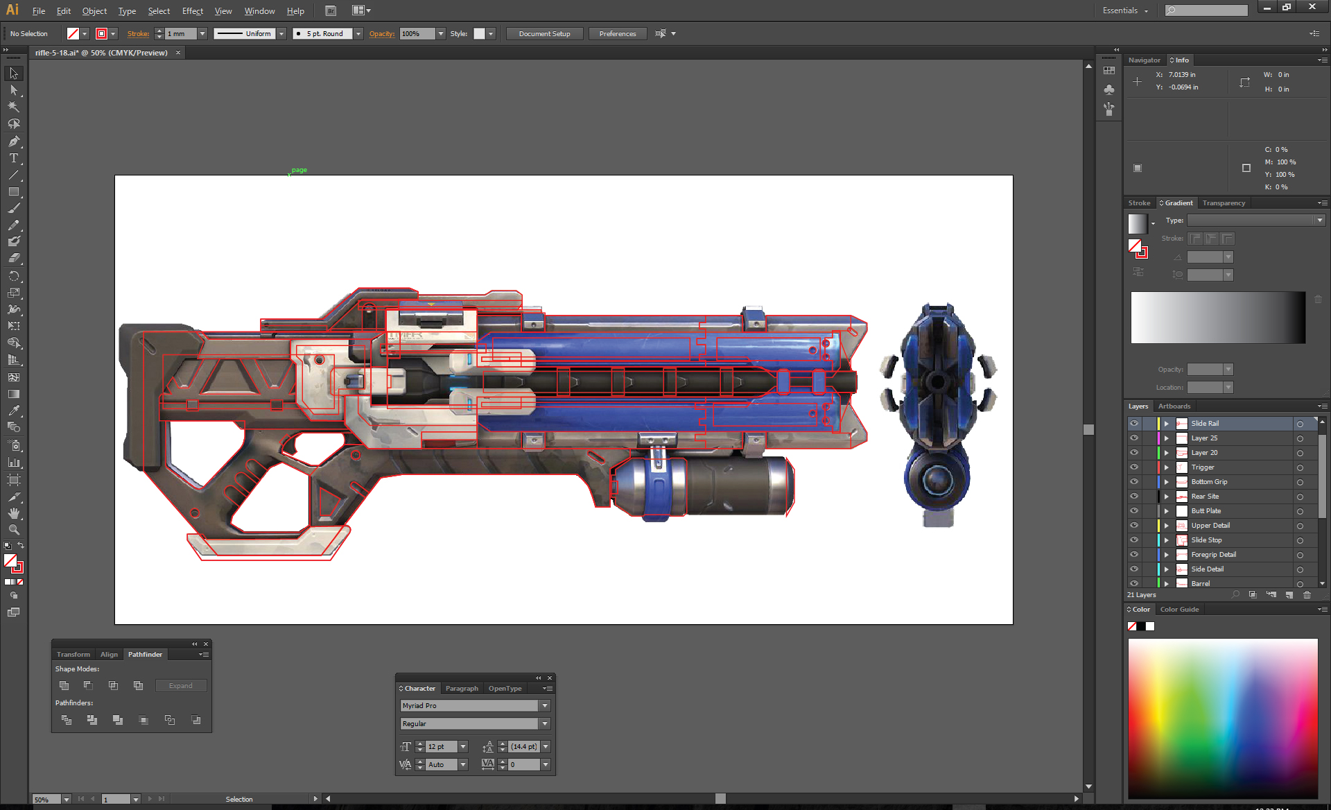

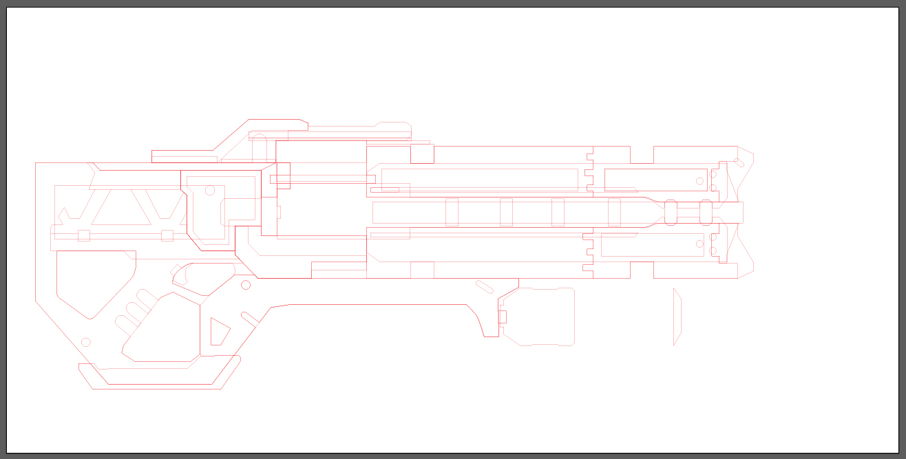

I started with the concept art from Blizzard. This isn’t 100% the same as what’s rendered in-game but it’s close. You’ll have to examine the in-game model closely to see minor detail changes. But the concept art has the best side view (the in-game rotation doesn’t allow for a good view of all sides).

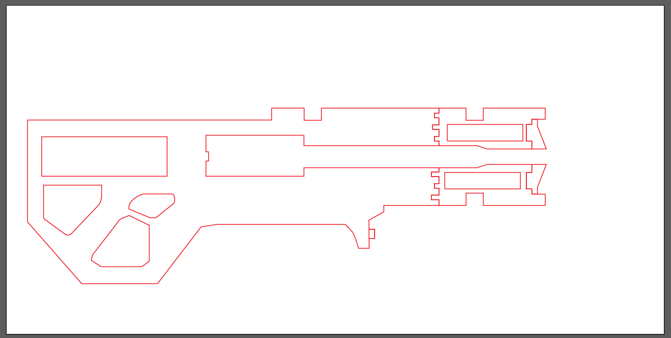

The art was brought into Adobe Illustrator and scaled up to be the real-world size I was looking for. In this case, 30” long. The actual rifle would be about 40” based on Soldier being 6’ 1” but that comes out to be comically huge for a real person. And I’m only 5” 10”.
Each layer is then traced out as a vector. Since I’m machining MDF, there are really only two choices for thickness, 1/8” and ¼”. For the core of the rifles I used ¼” and for the detailed layers I used 1/8”.
This is all the layers stacked up. Each layer will be sent to the laser cutter individually though.

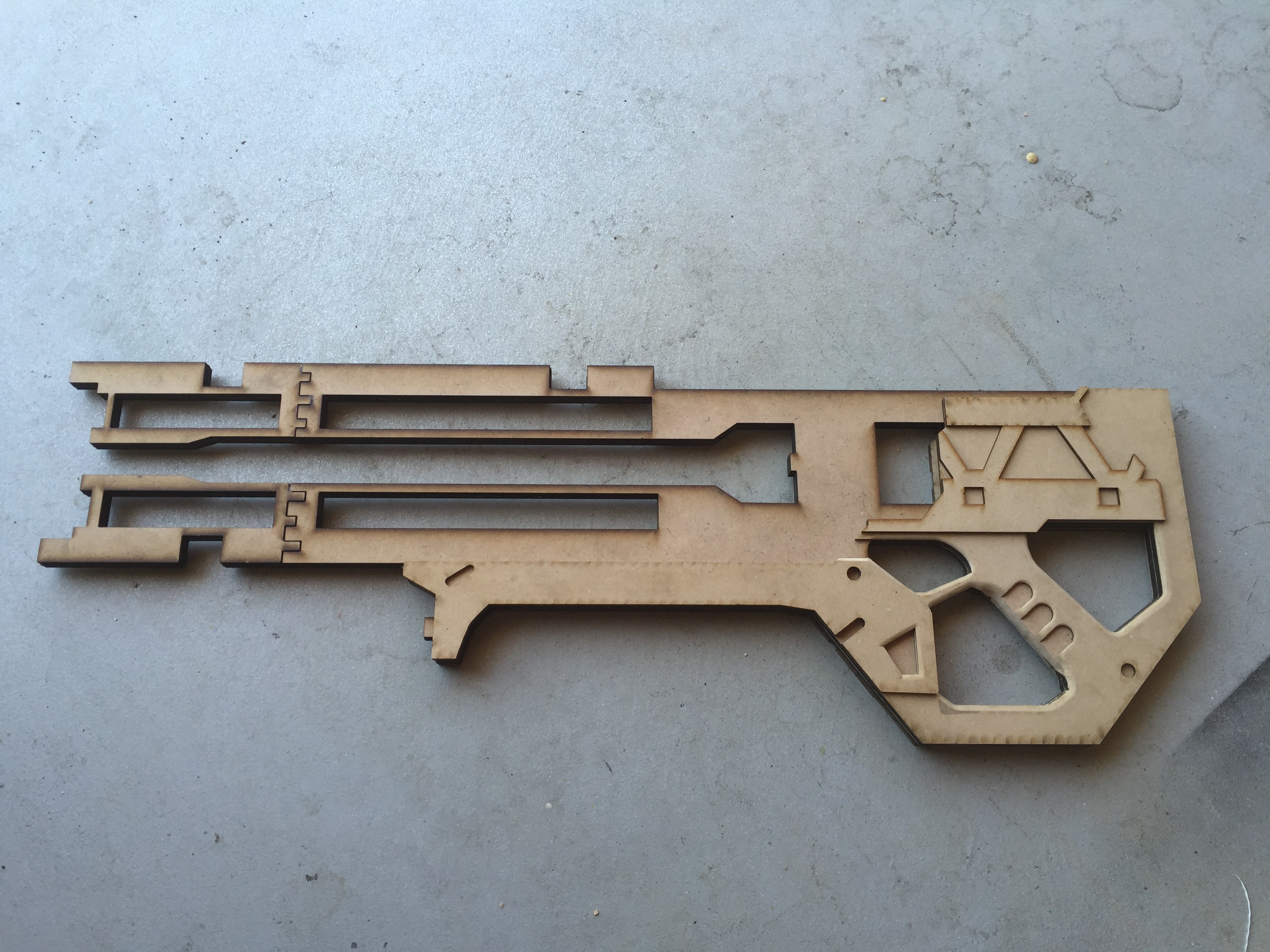

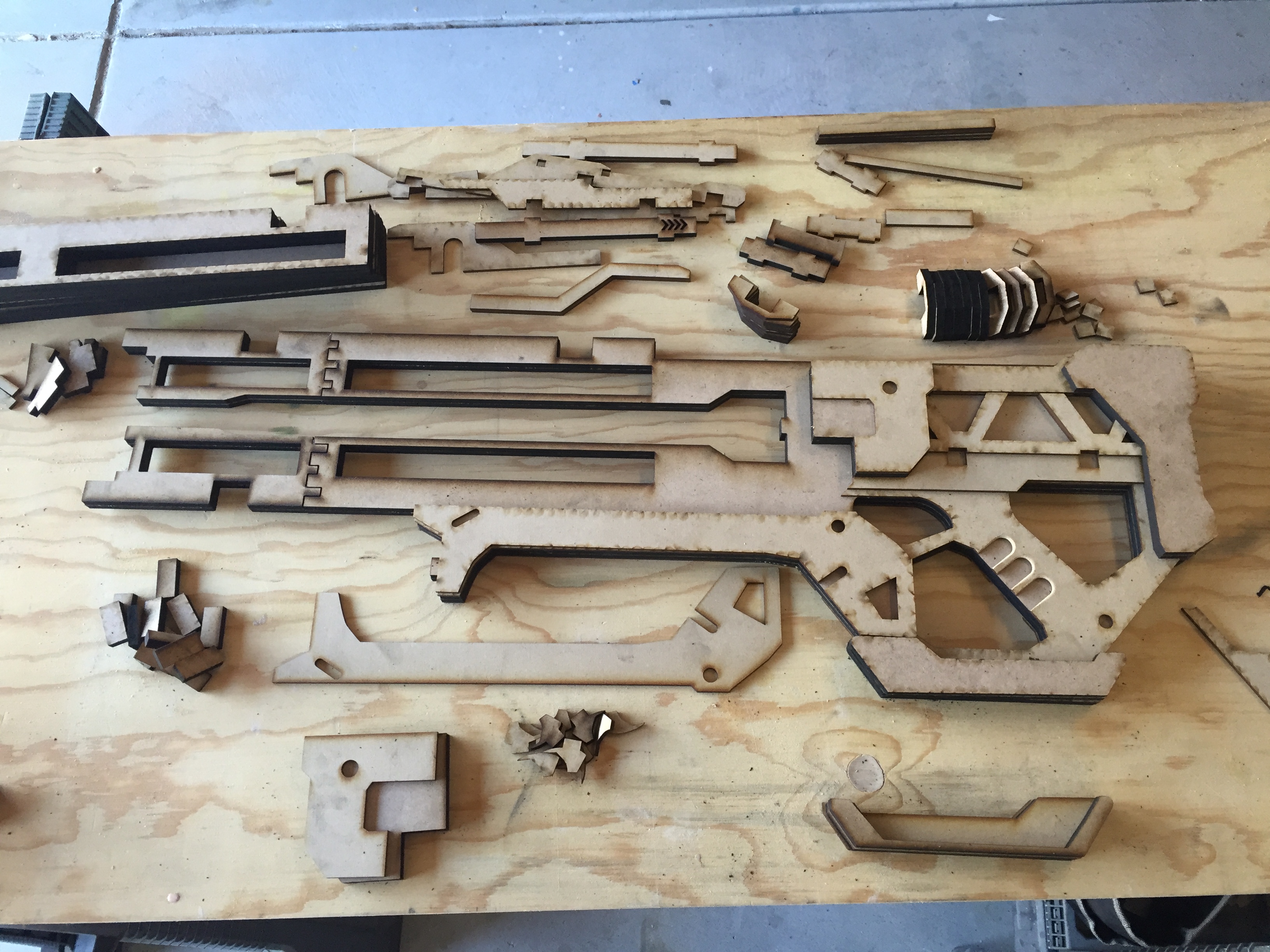

This is the core layer. The laser cutter can only handle 24” lengths so it has to be cut in two sections and pieced together like a puzzle.
These are the cut pieces. The core has been glued up. There is some minor contouring

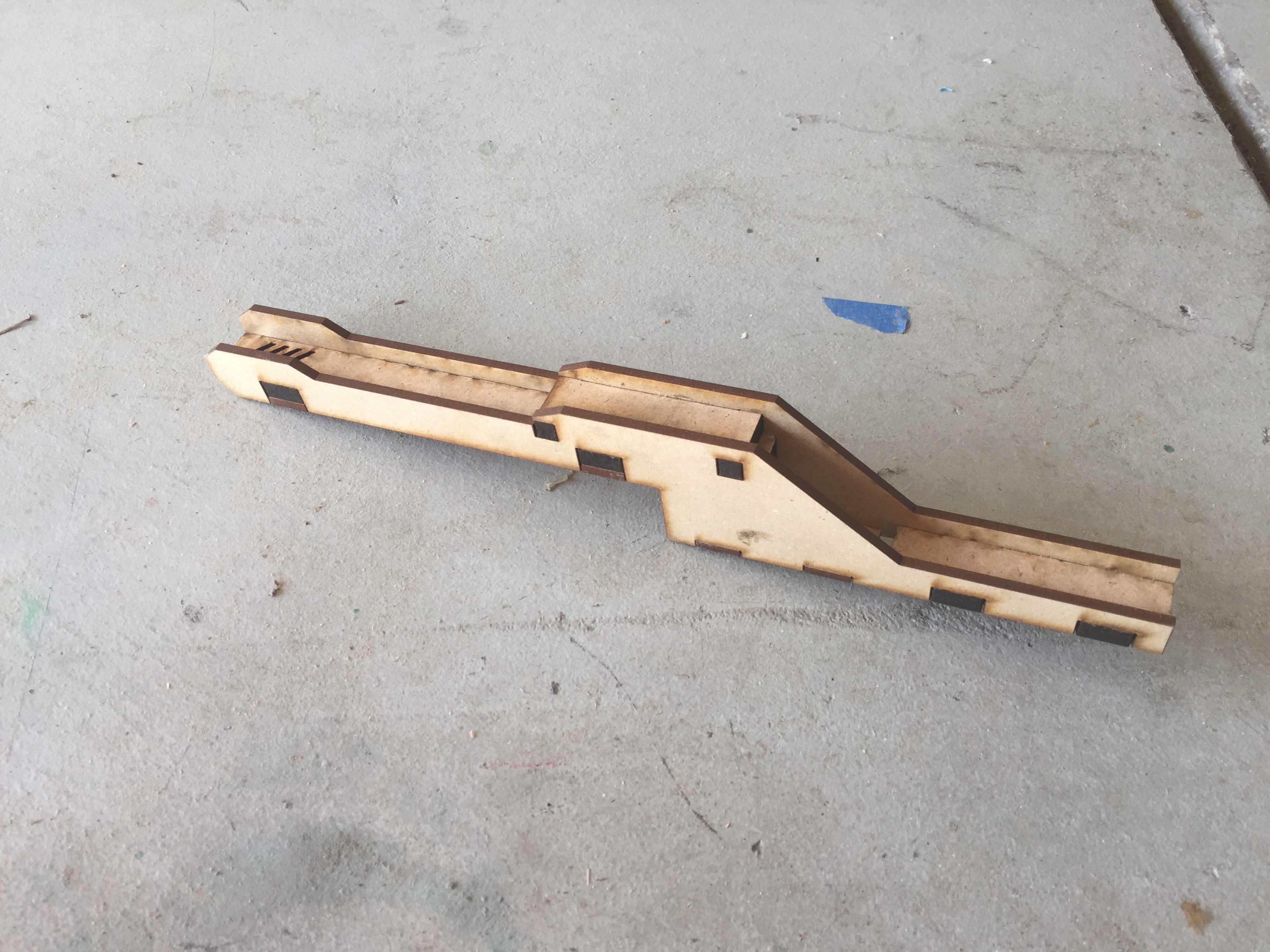

The site is several pieces of 1/8” MDF.

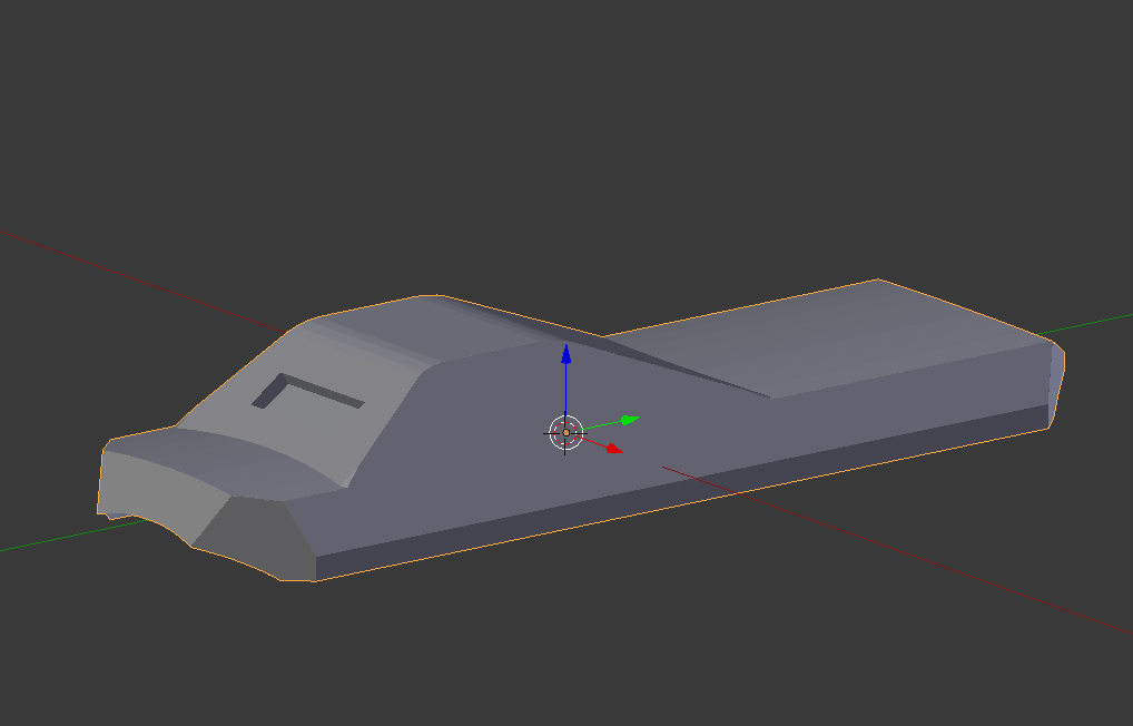

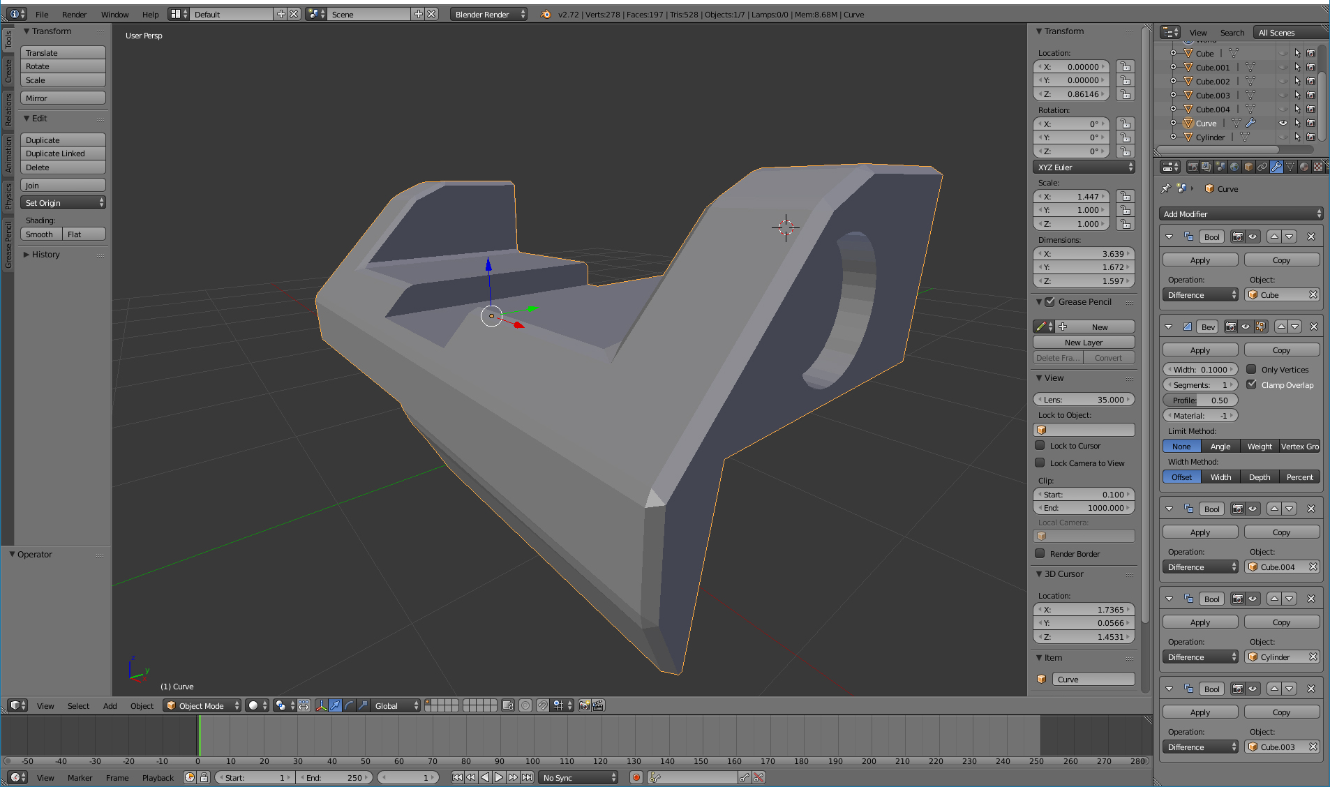

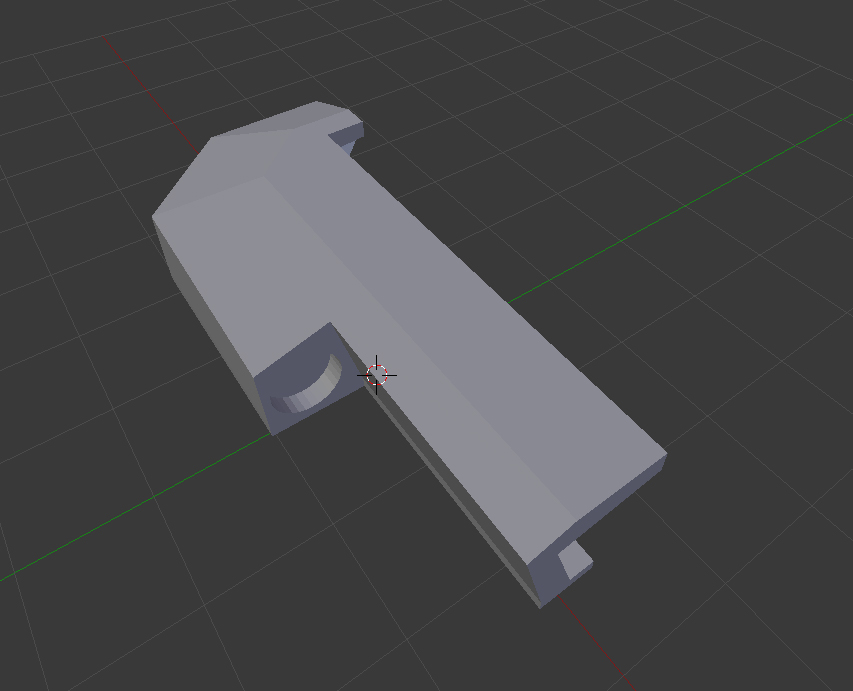

Certain pieces are too complex to be broken down into flat layers. Those pieces were rendered in Blender and then 3D printed.

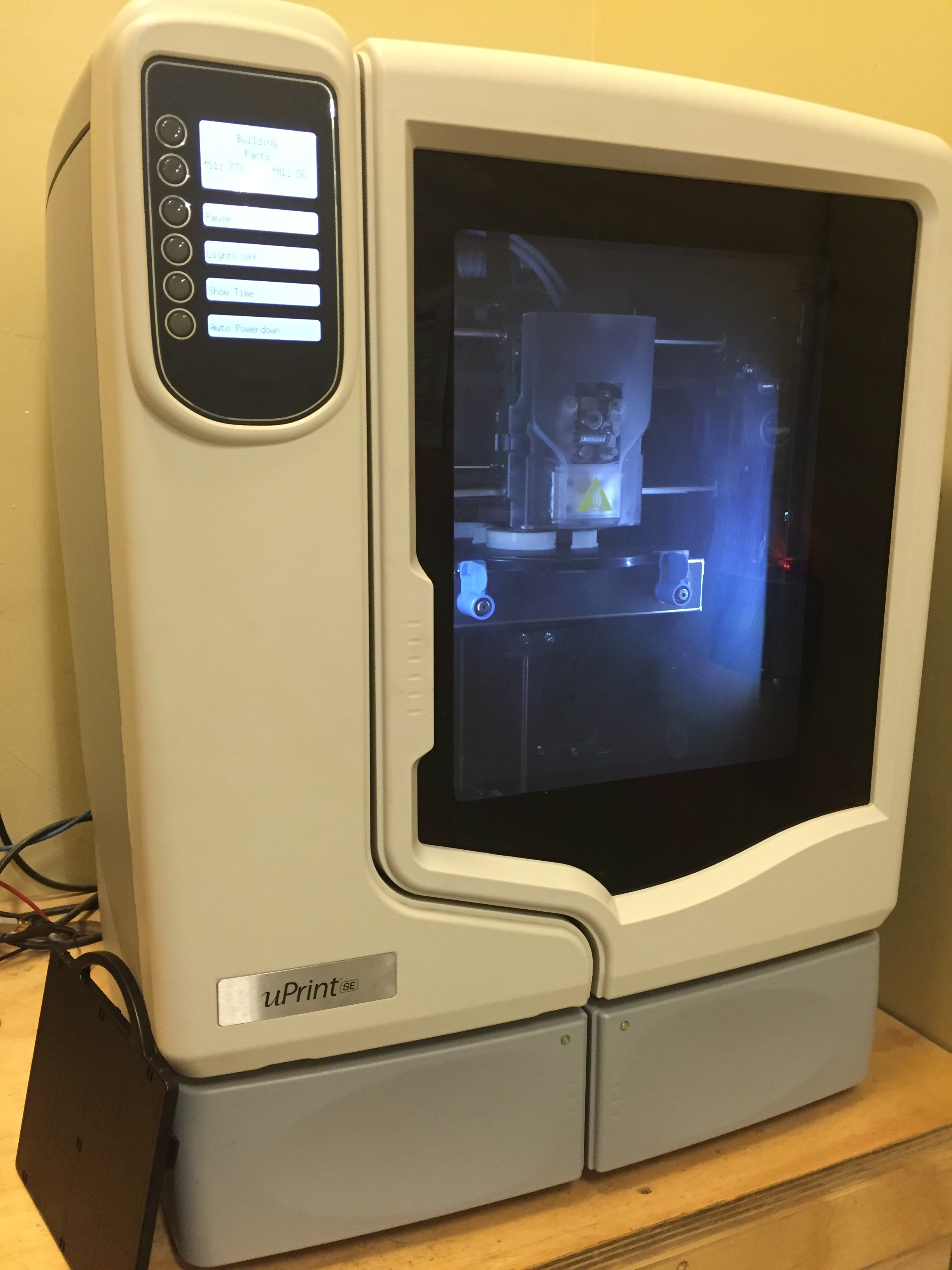

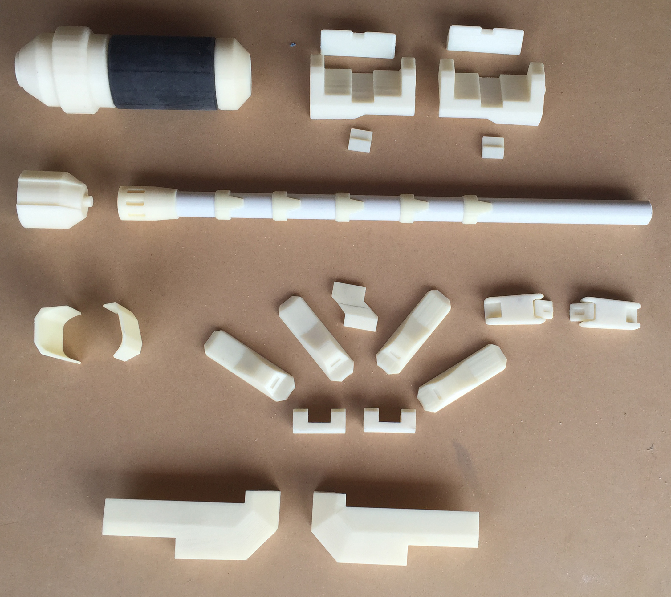

I used a uPrint ABS printer and a PrintrBot with ABS filament. The uPrint is faster and does a much better job of printing but it’s more expensive to use than a PrintrBot. I prefer ABS of over PLA because I find it easier to sand and finish ABS. Although I hate finishing any 3D printed parts. It just annoys me.
The uPrint in action.

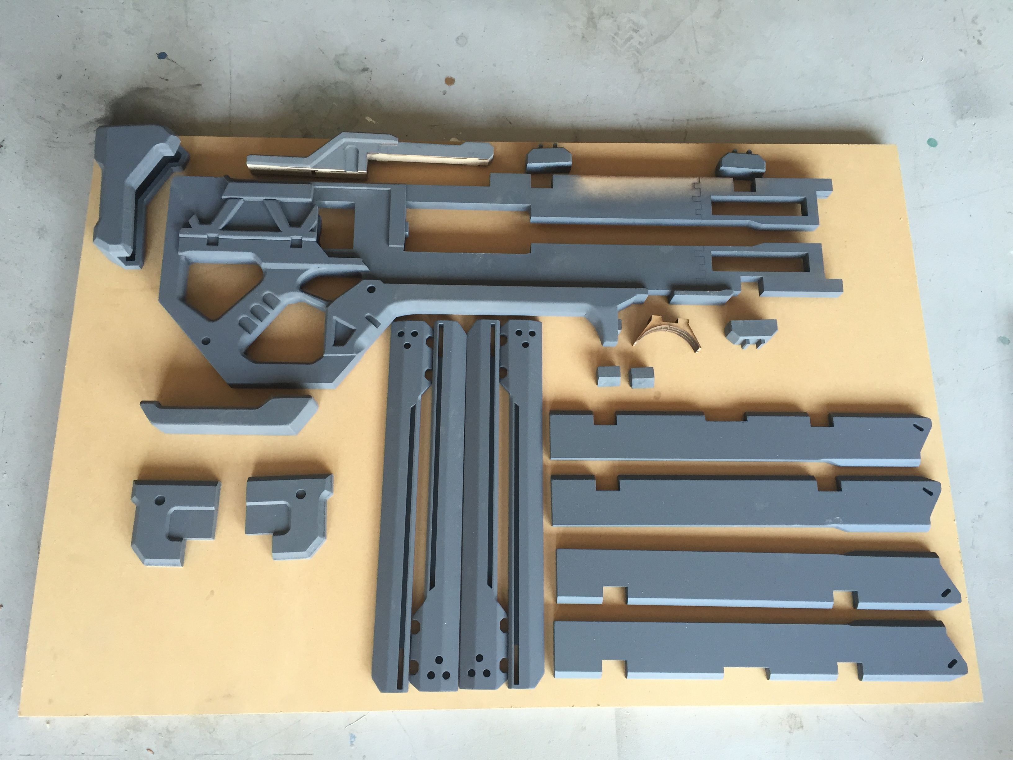

The 3D printed ABS parts.
The MDF parts, primed and ready (Wait, that’s Junkrat…)

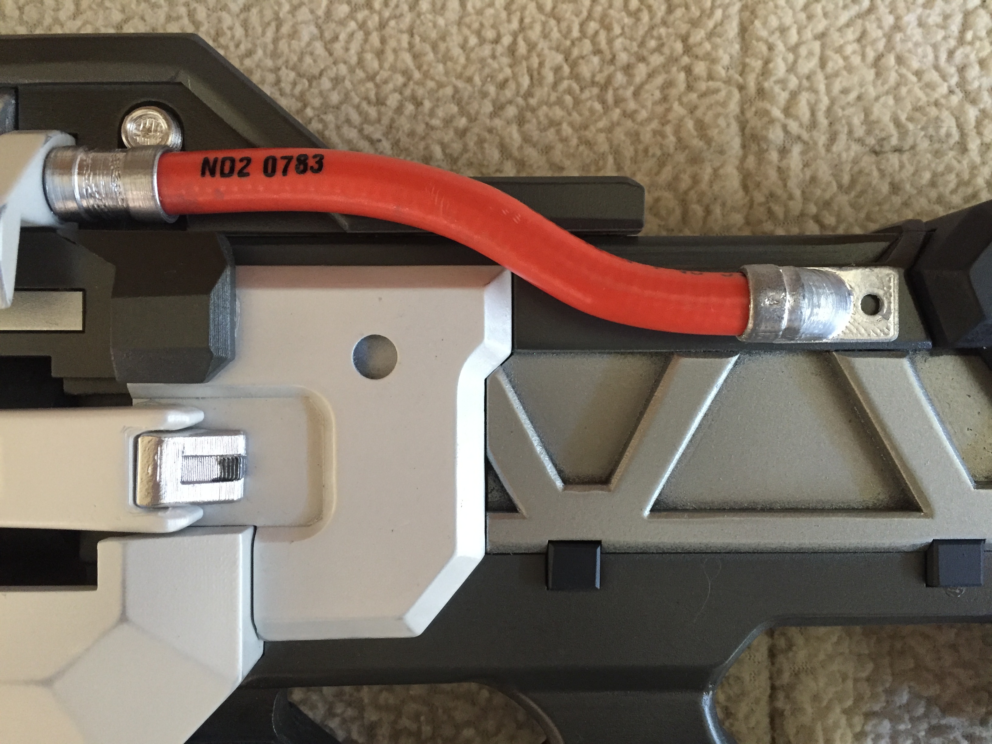

Verry nice!! I'm making my own for my S76 cosplay . I'm verry interested in how you did the red tube. Is it an existing part and fittings?
Best regards
-hopli-

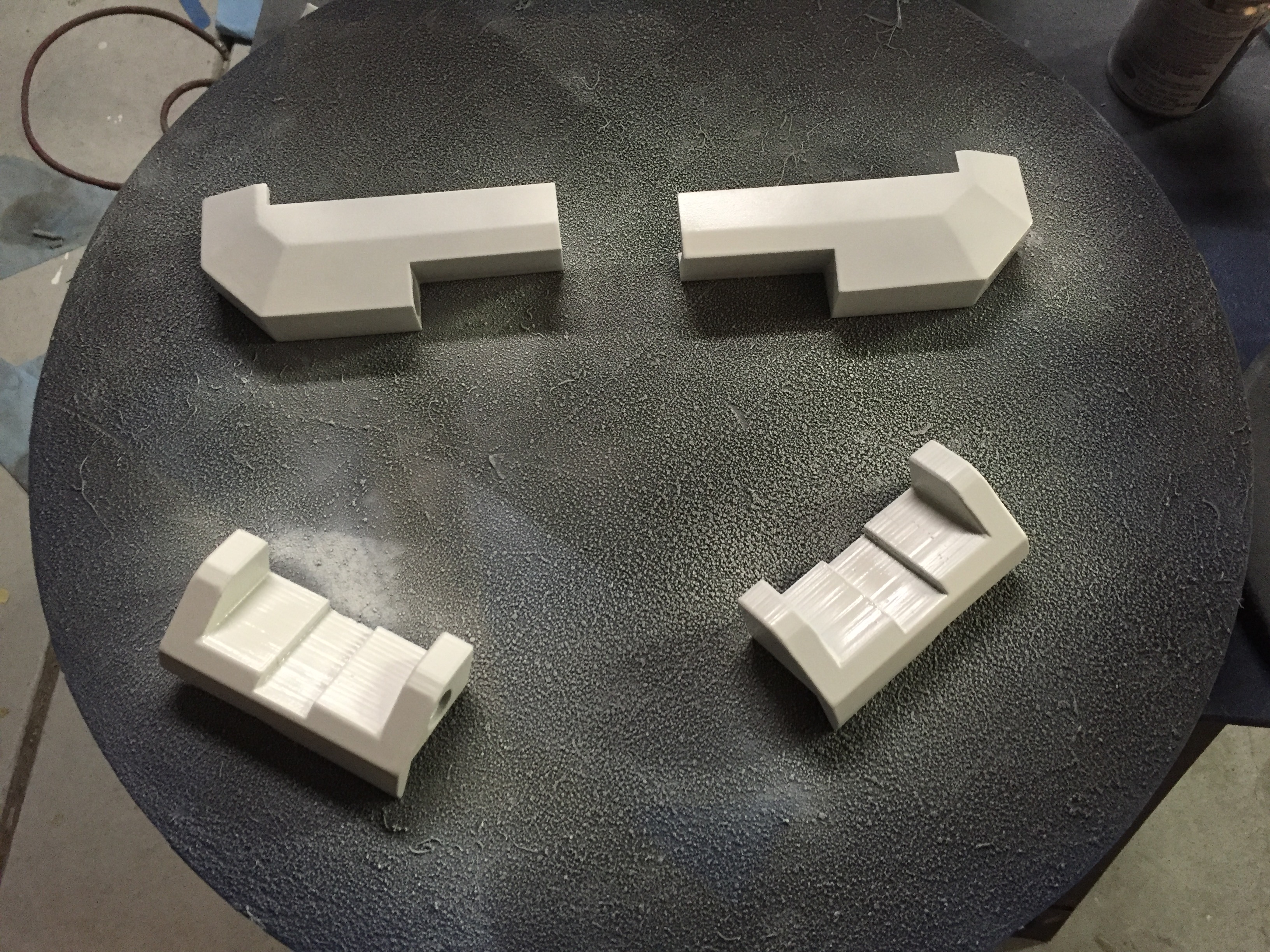

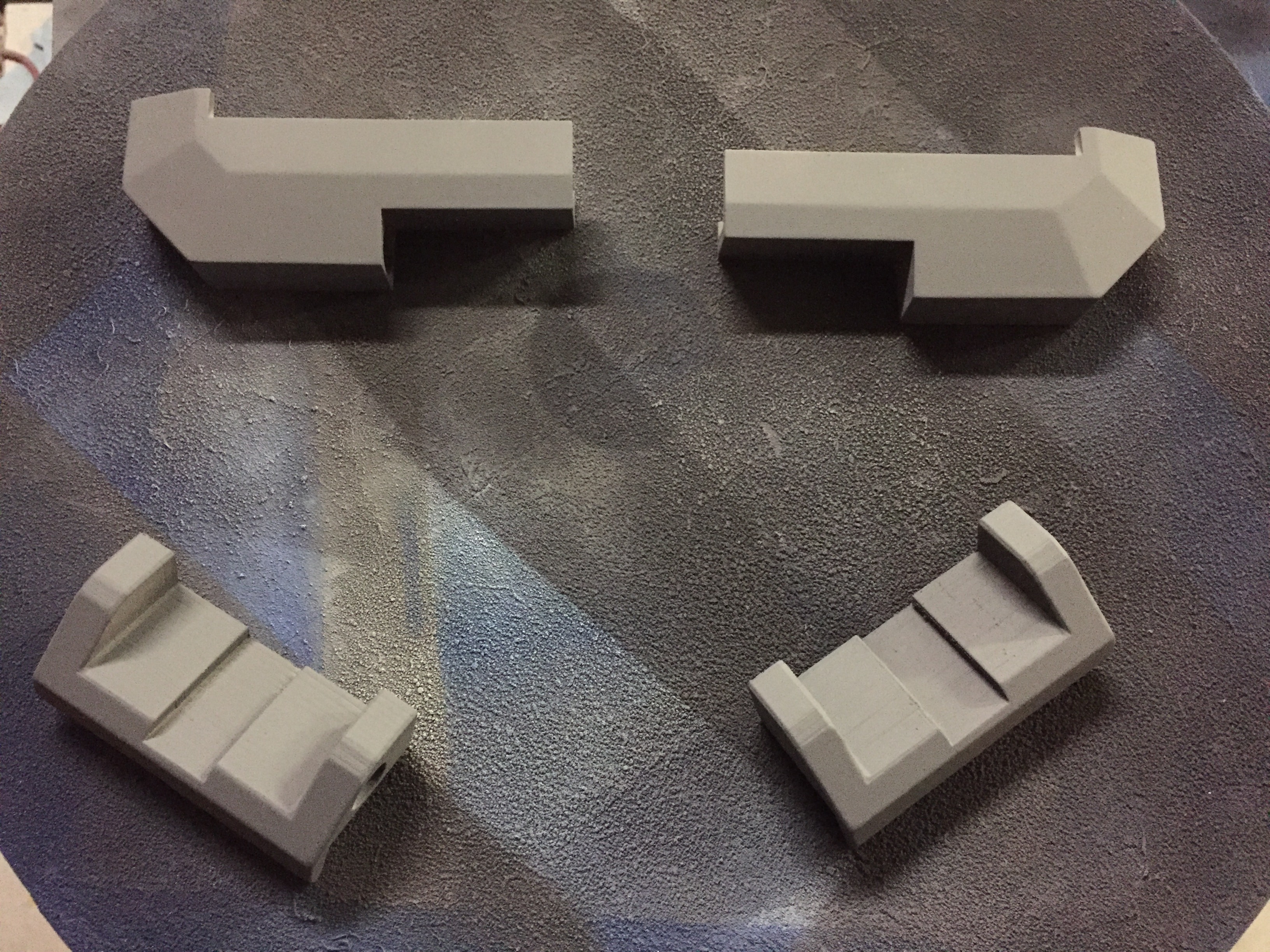

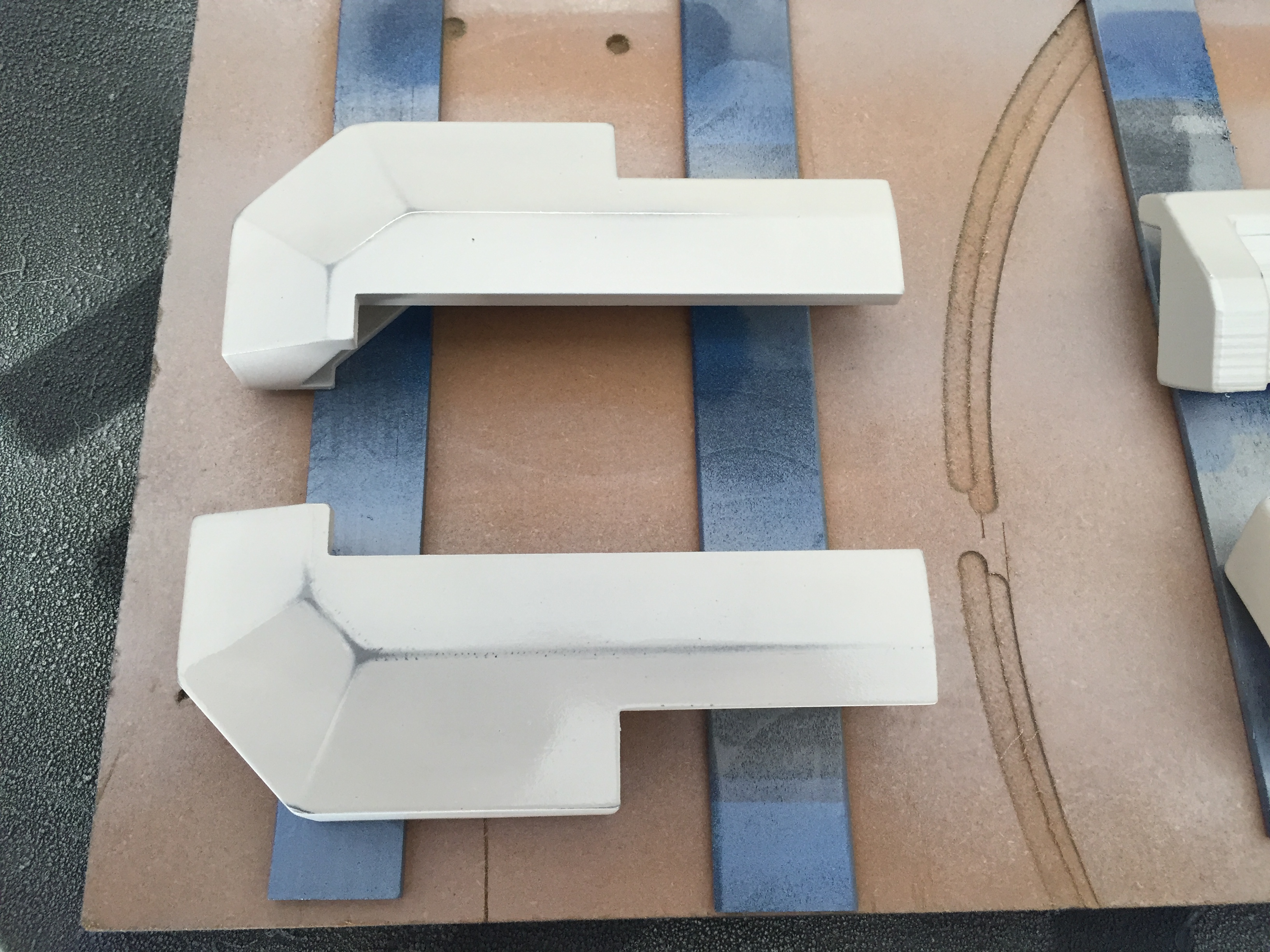

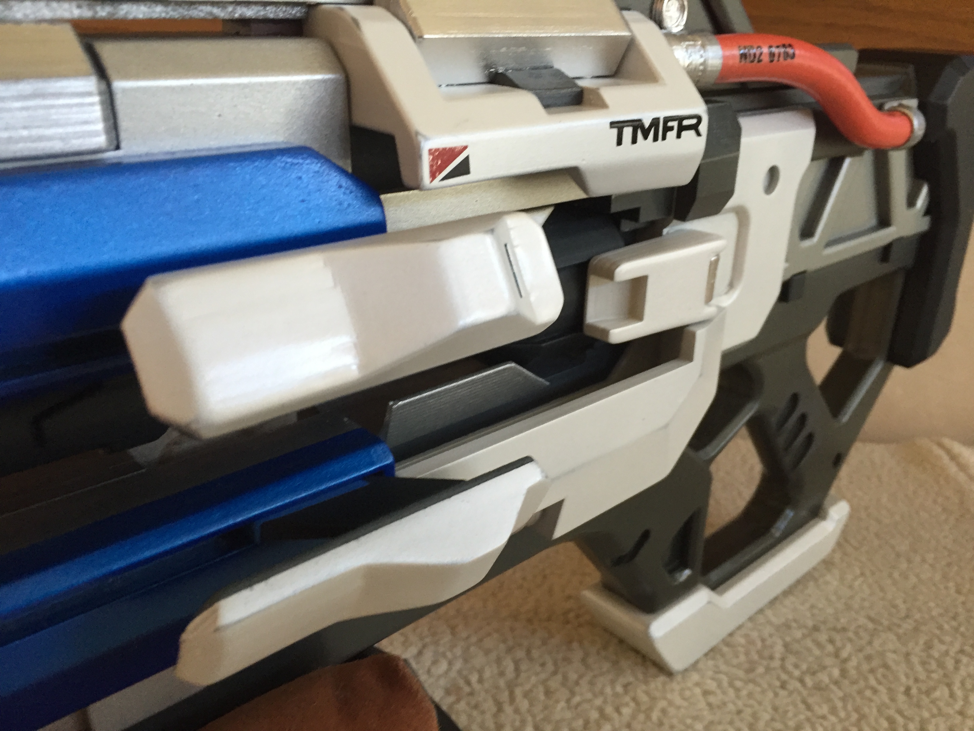

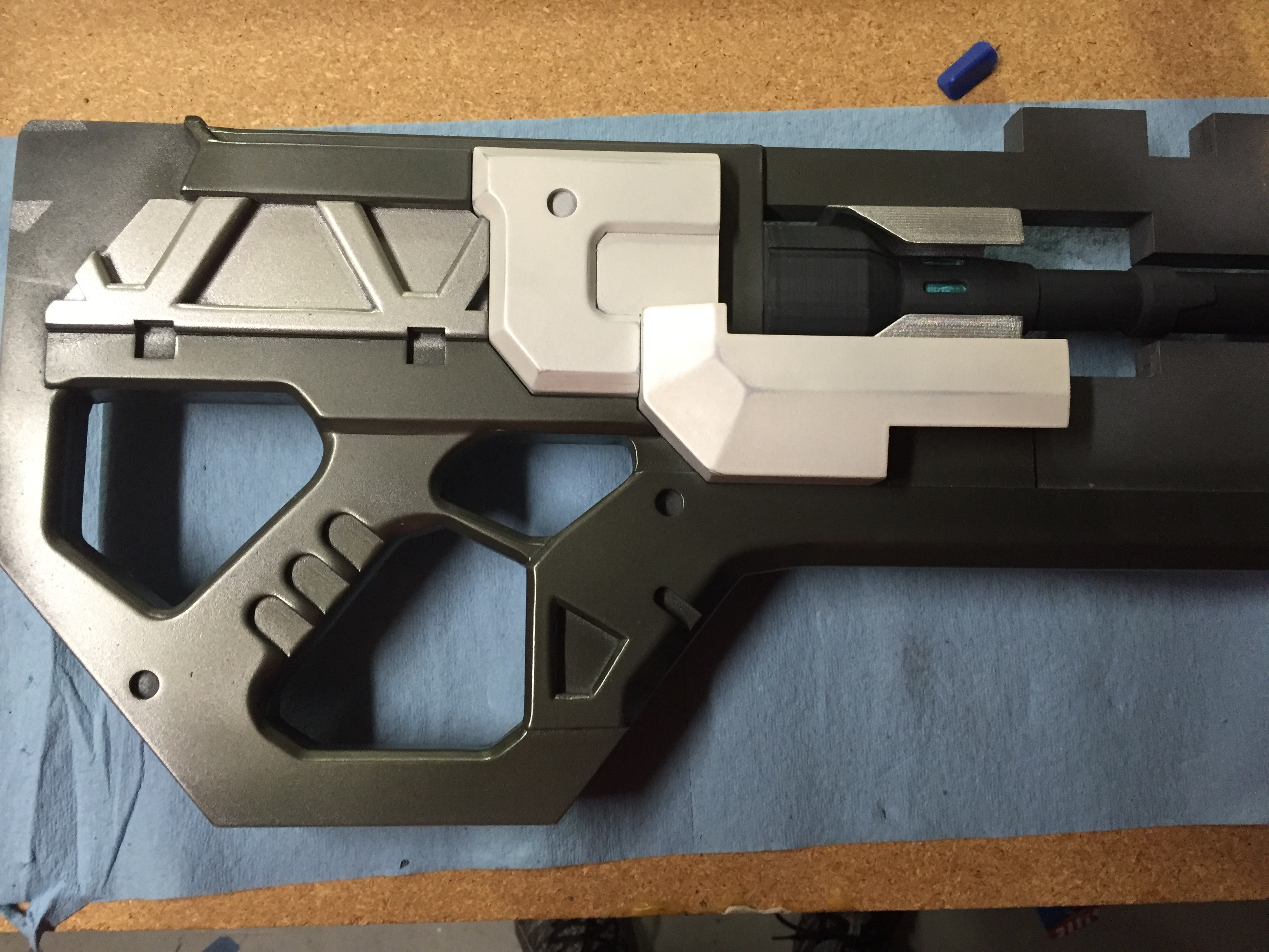

The guns in Overwatch tend to be a bit beat up. The pulse rifle has definite wear and tear visible. To simulate this I primed with gray primer and then coated with a white primer and sanded back down to the gray primer. I prefer Krylon primers. They dray fast and sand well. At least the gray and white do. The black seems to get a little gummy.
This is the gray primed parts.
Now the white coat.
Sand it a bit with 300 grit sandpaper and top coat with a white lacquer. The white lacquer is translucent (which is why you need the white primer) and blends the white and gray a bit and adds protection.

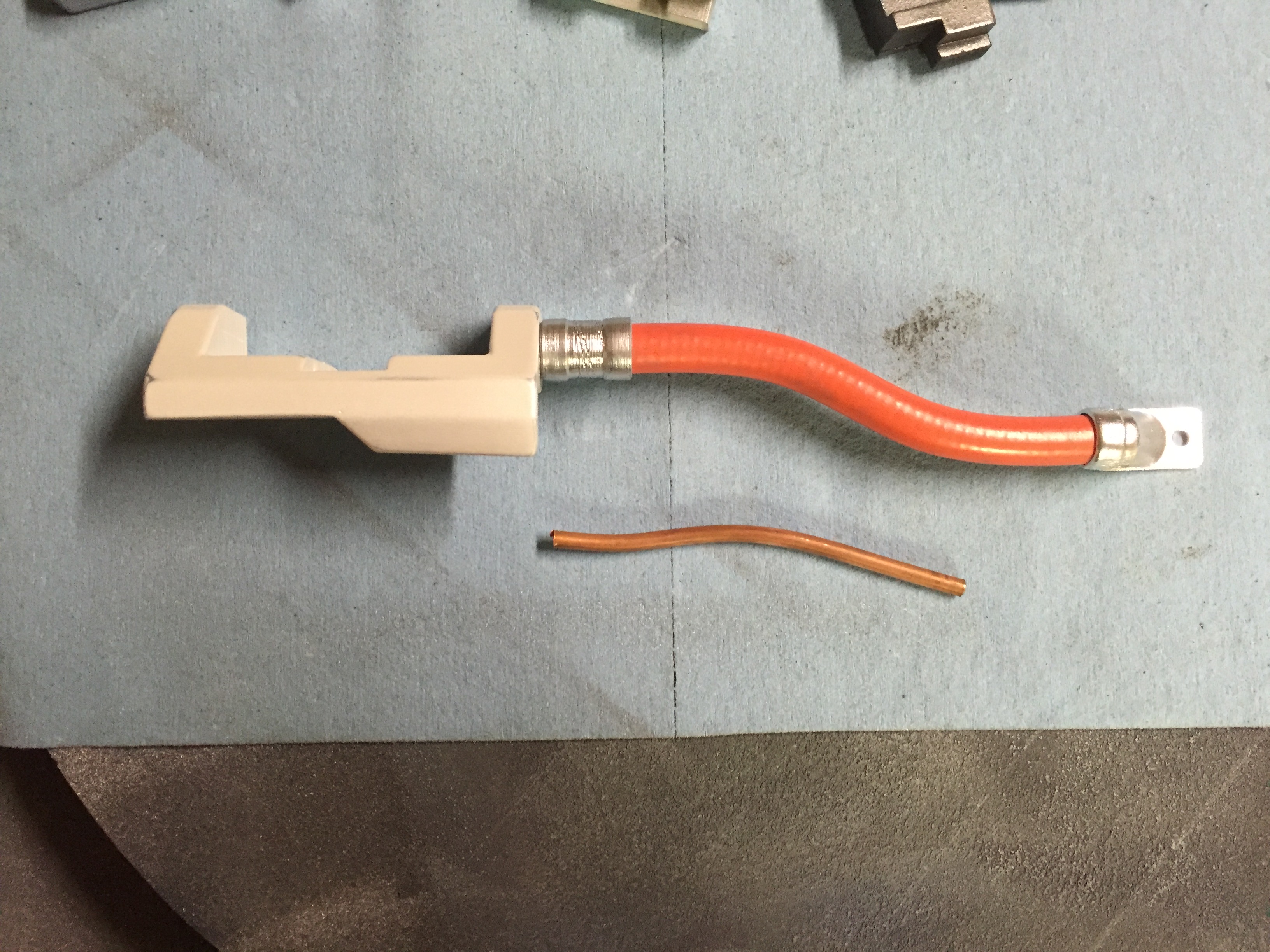

The tube thing on the side has an s-curve to it. I use airline hose from the hardware store. The hose will tend to bend whatever direction it wants to so to force it into the shape I wanted, I put a piece of copper tubing inside and bent it. The nubs at the end were 3D printed.

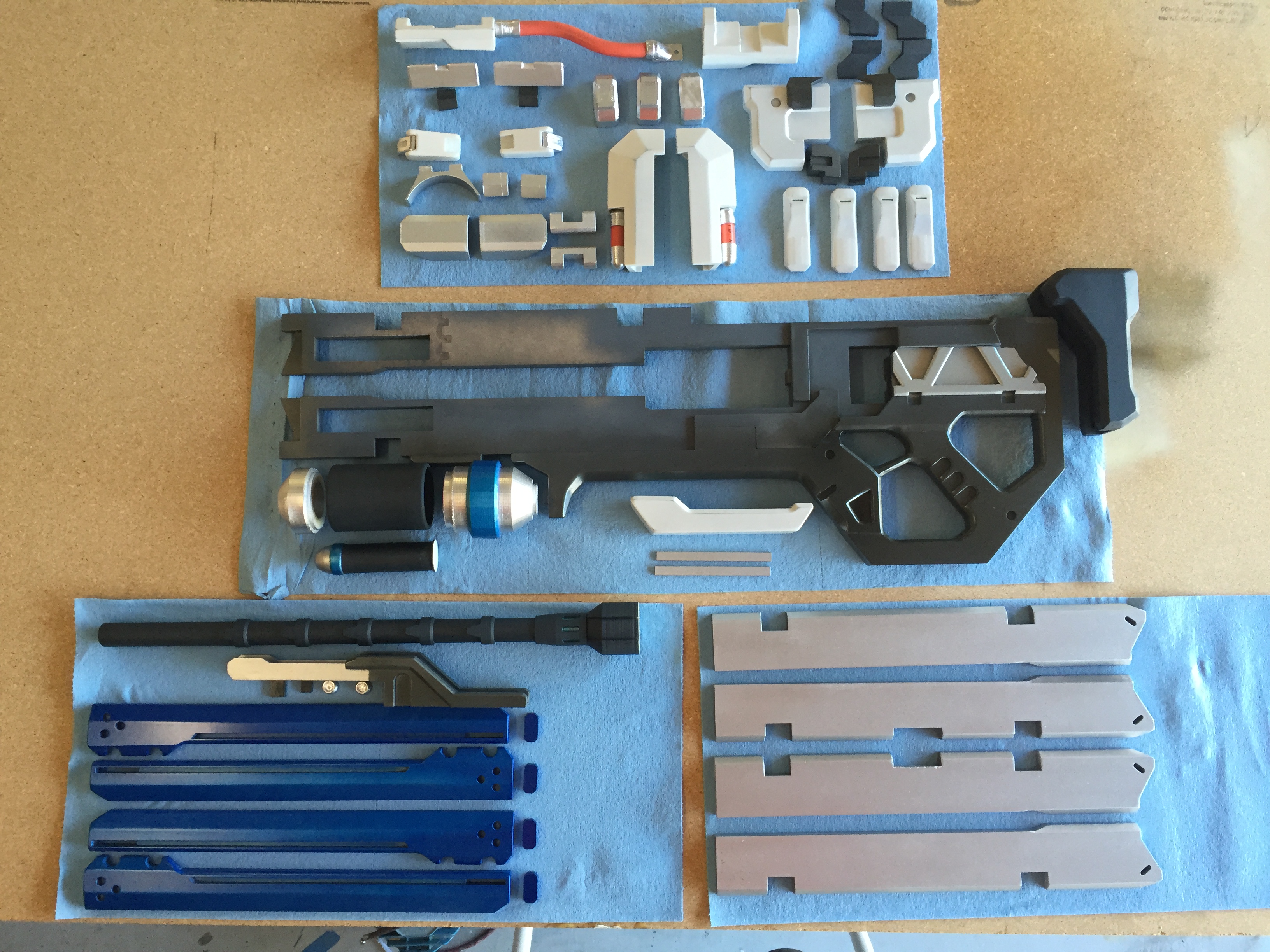

The final parts painted and ready for assemble. There are almost 100 pieces for the 75 parts for this project. I used mostly Testors lacquer spray and Model Masters metallic enamels with an airbrush.

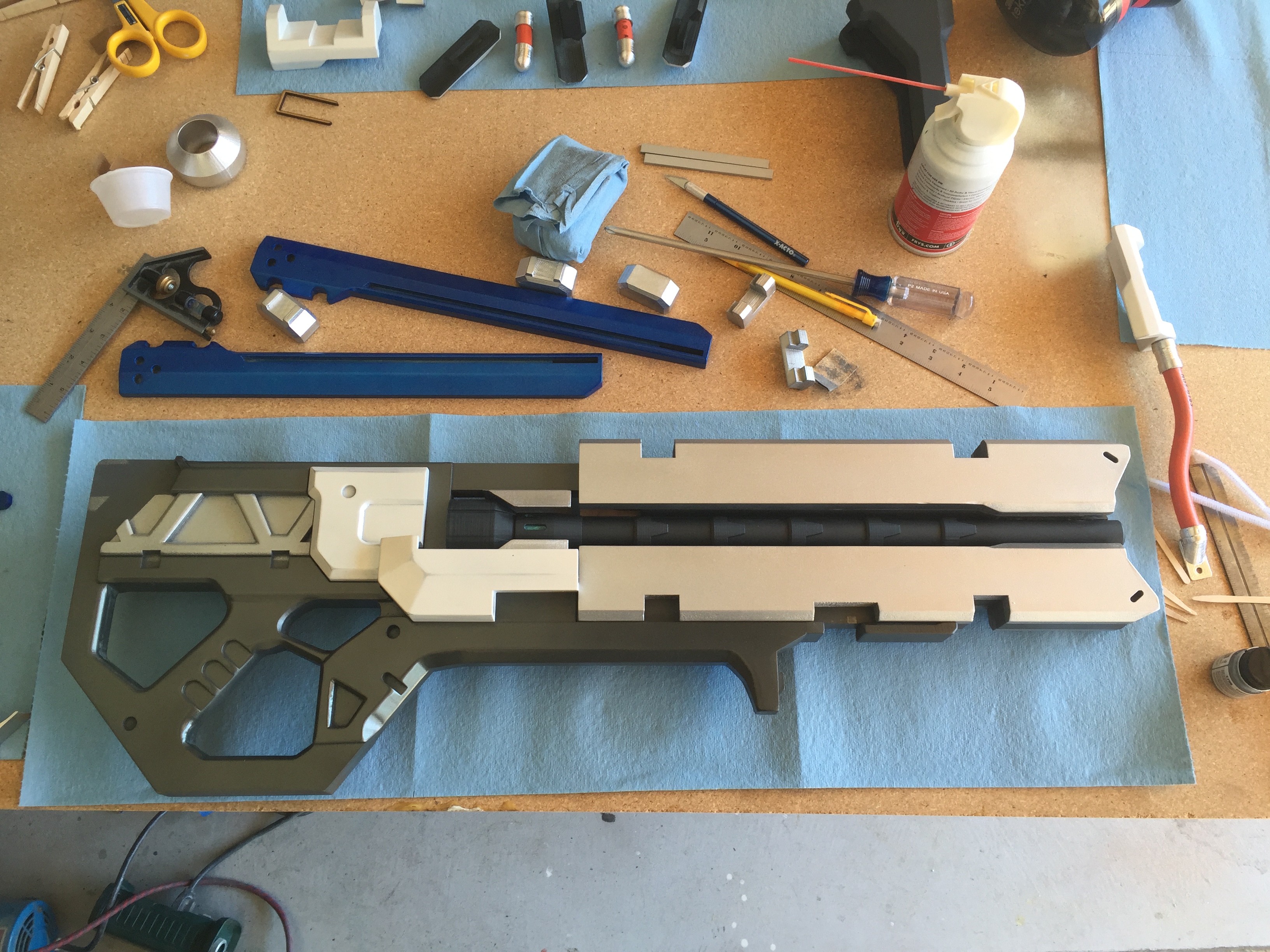

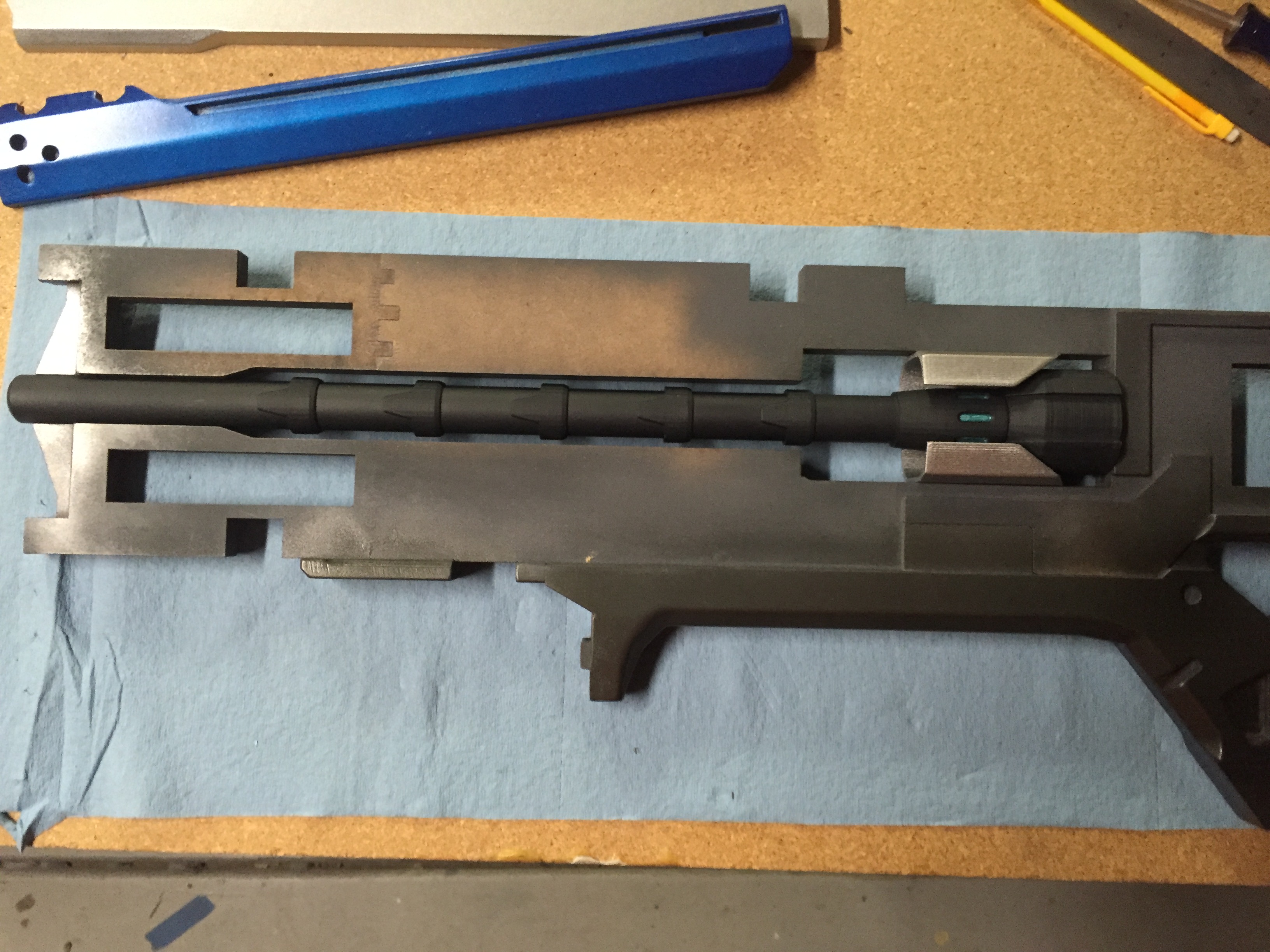

Now the assembly. The barrel goes on first.
Start adding pieces layer by layer.
These front pieces should either have been hollowed out more or vacu-formed. They add most of the weight to the rifle. They are 1/2" thick. Two pieces of 1/4" MDF glued up. They were hollowed out a bit with a router which eliminated about 25% of the weight but I could have done better.

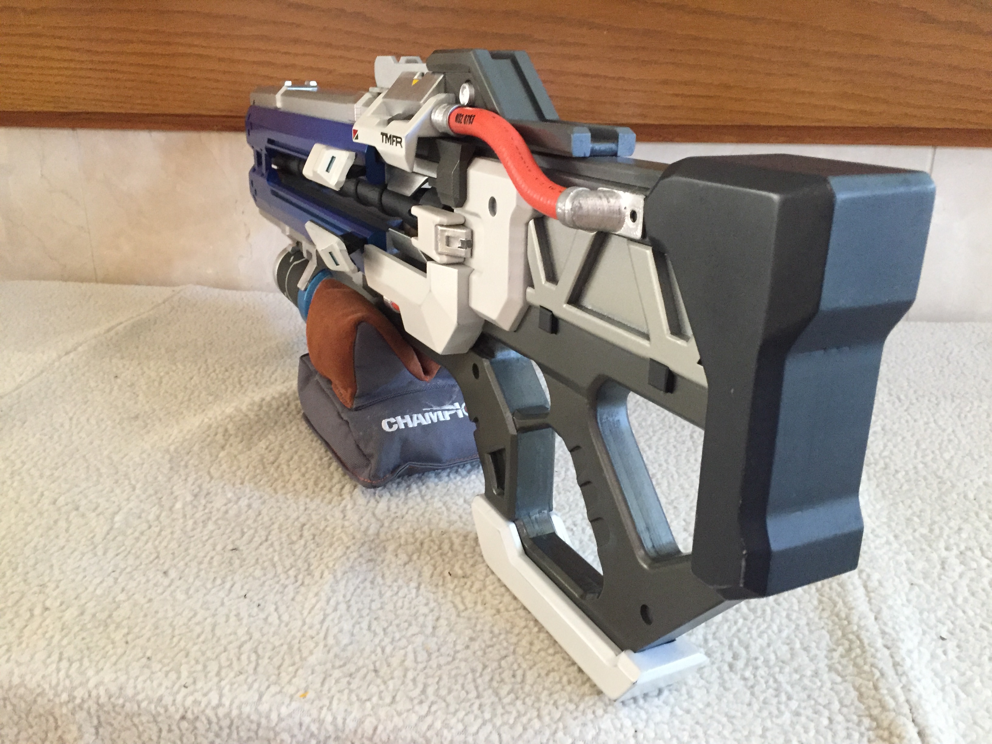

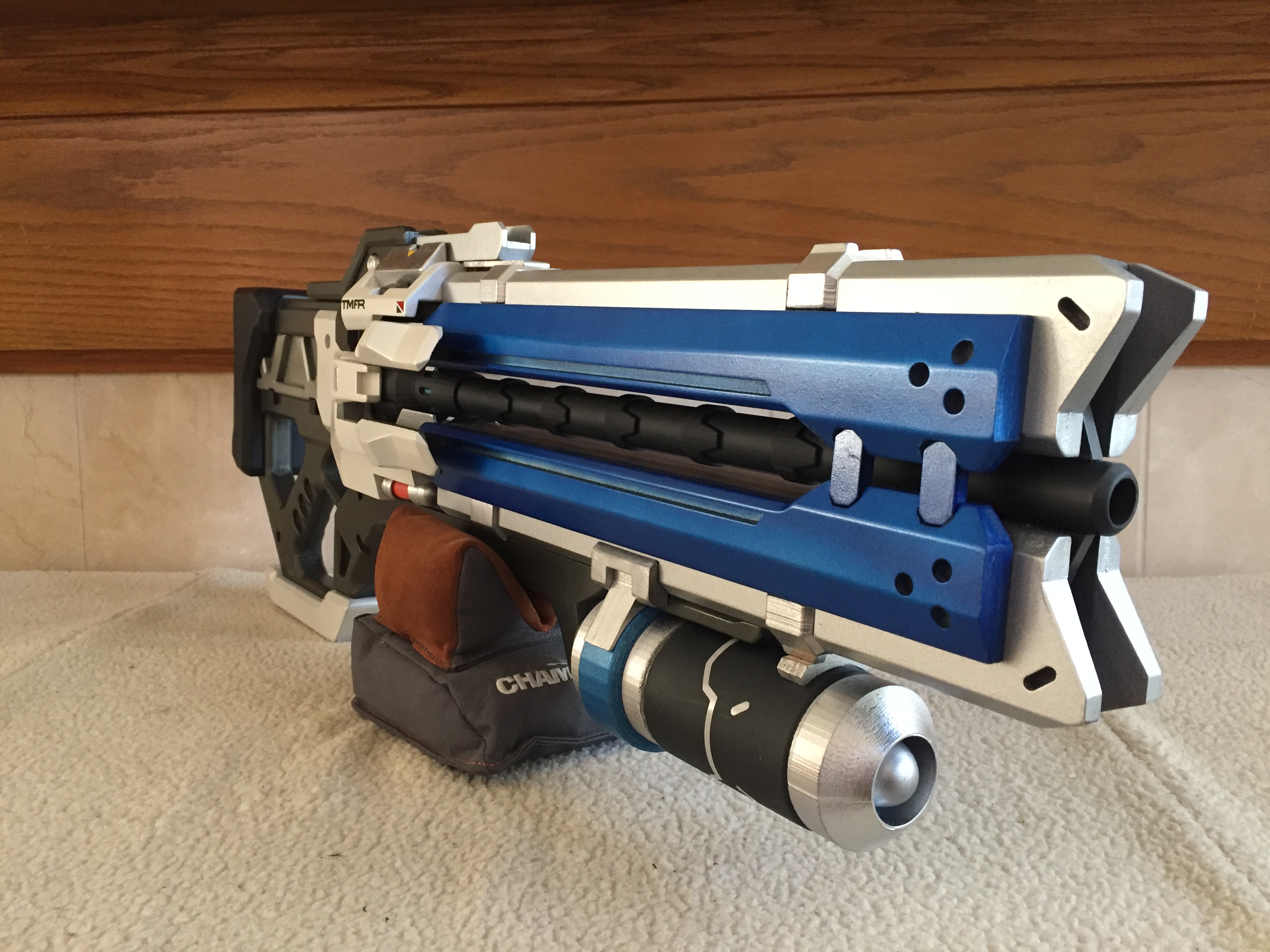

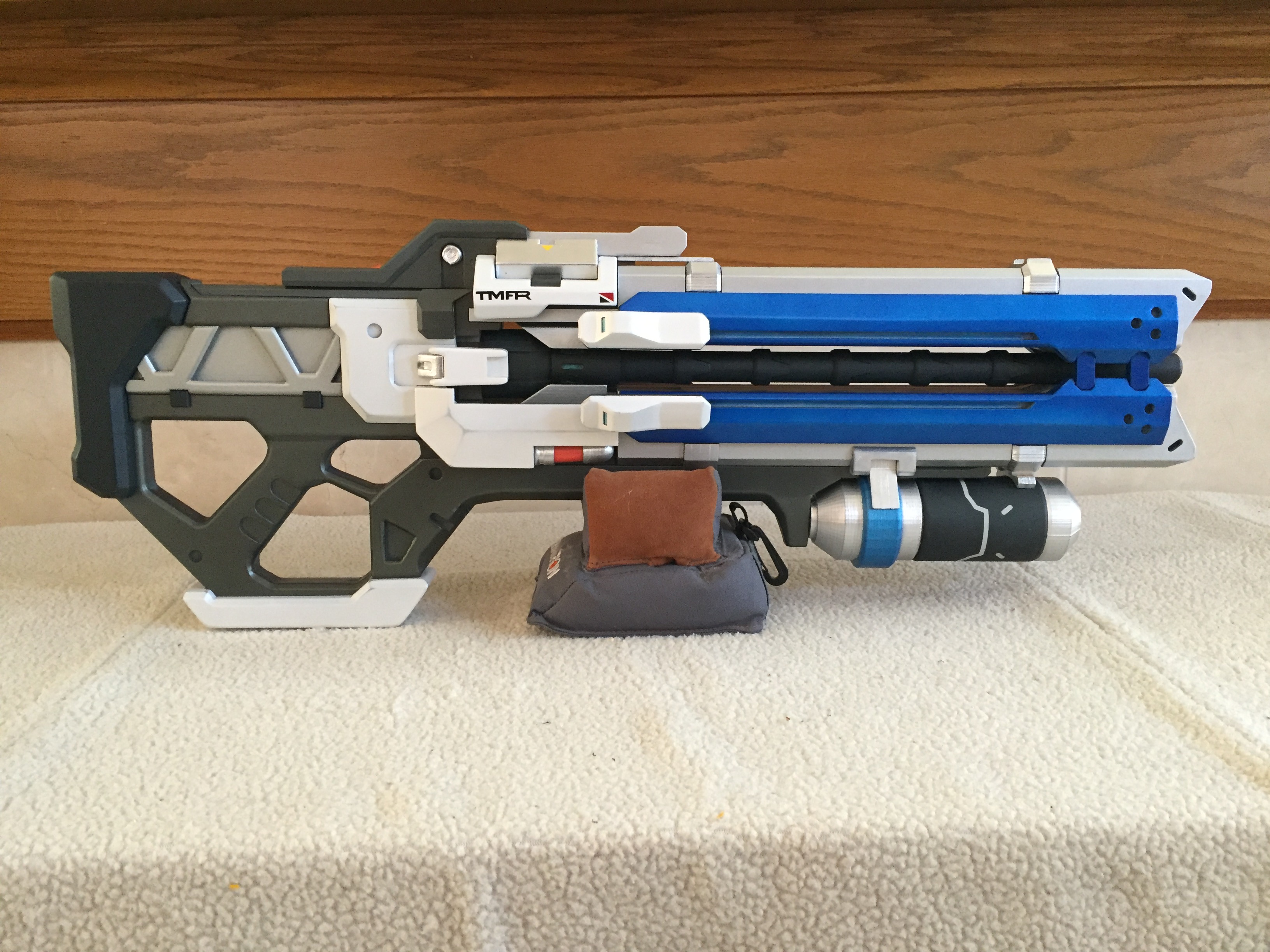

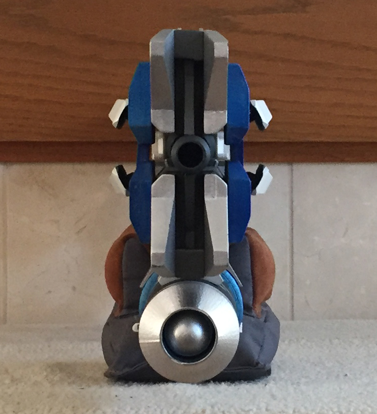

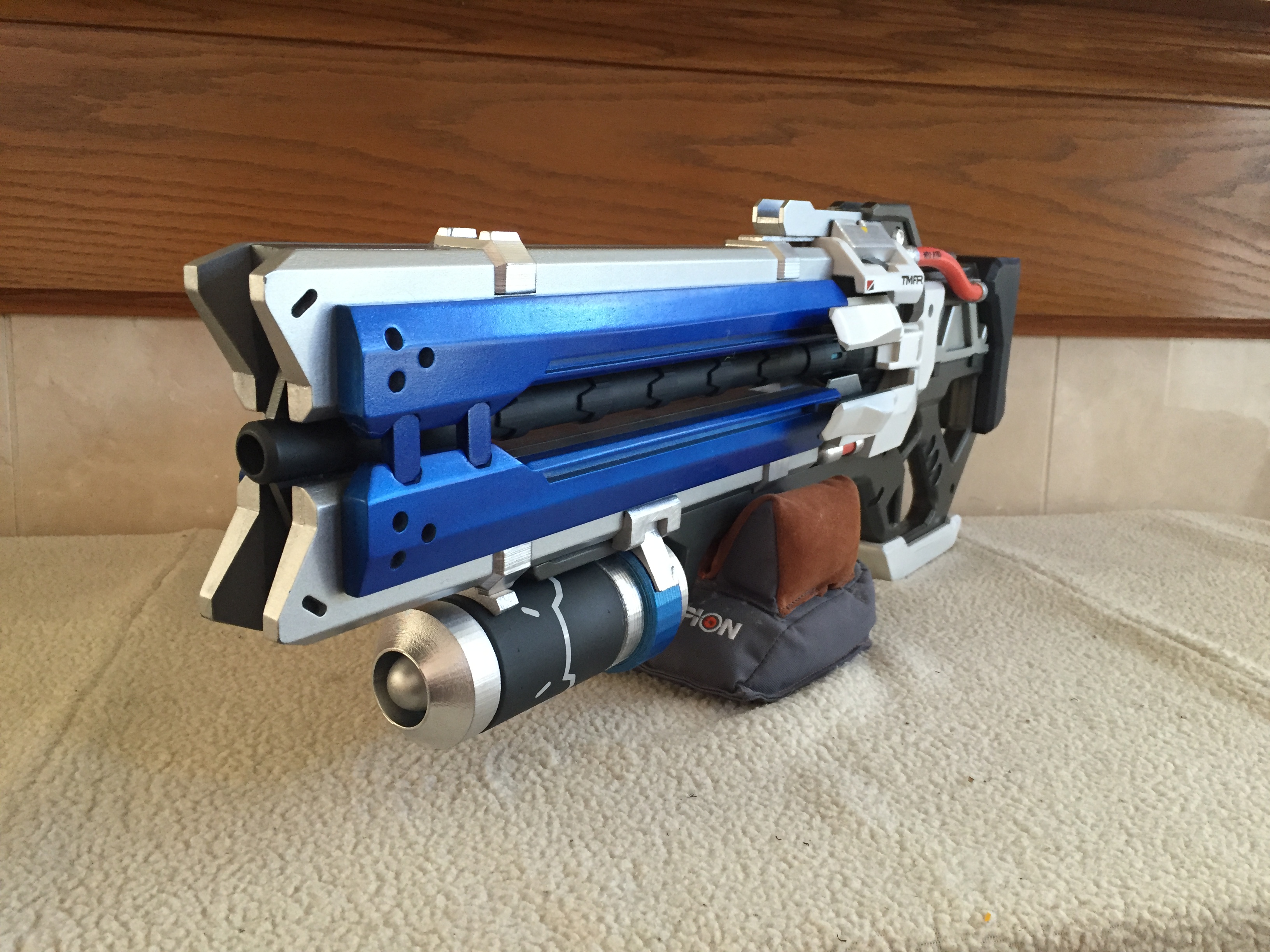

I got you in my sites…. It’s done. This is the view most people see in the game.
The side details. The hose is what gives it a distinctive look and feel. I’m not sure what the hose does but it makes it look cool. The graphics are adhesive vinyl.

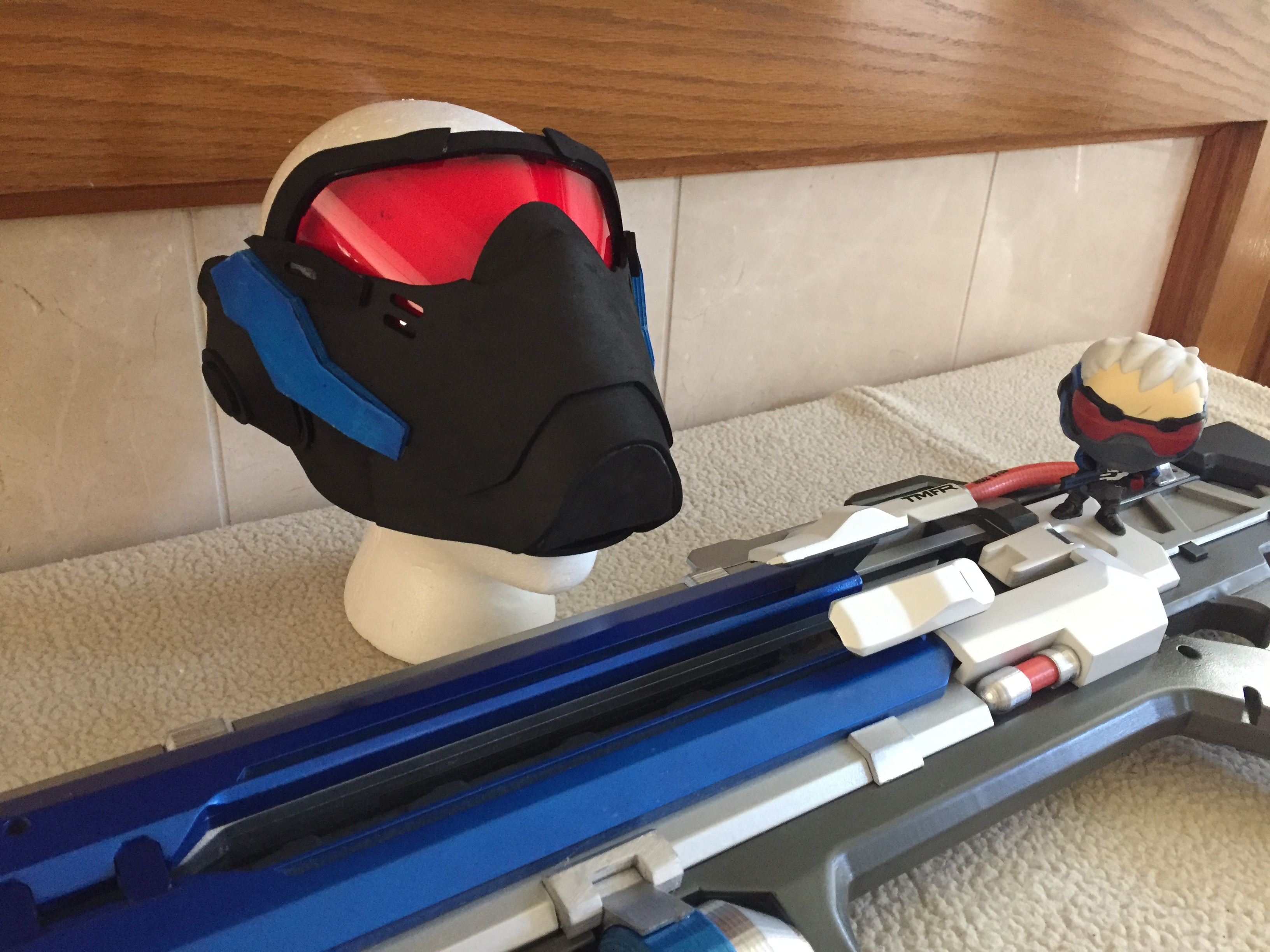

A simple EVA foam visor and you’re ready to deploy.

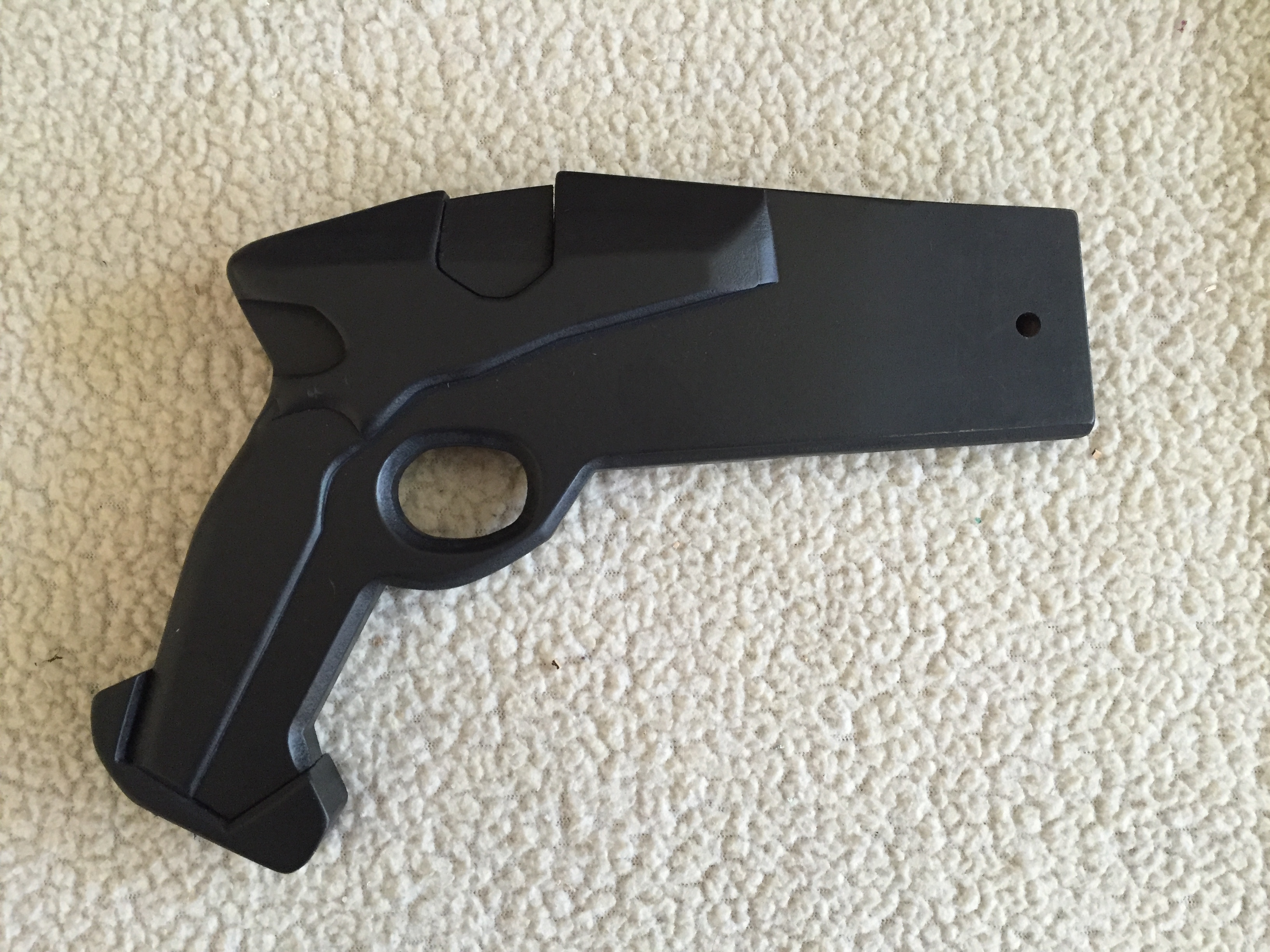

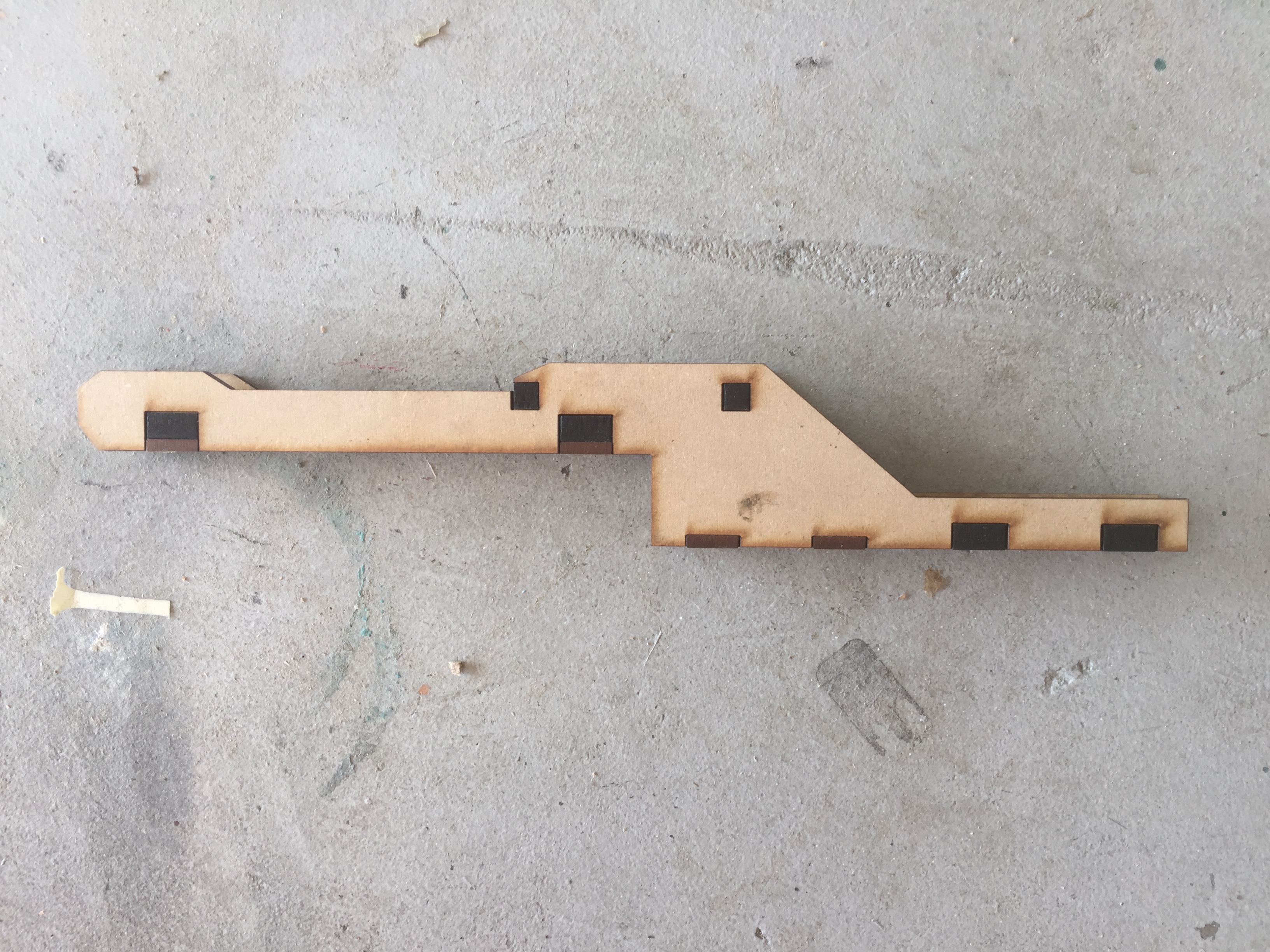

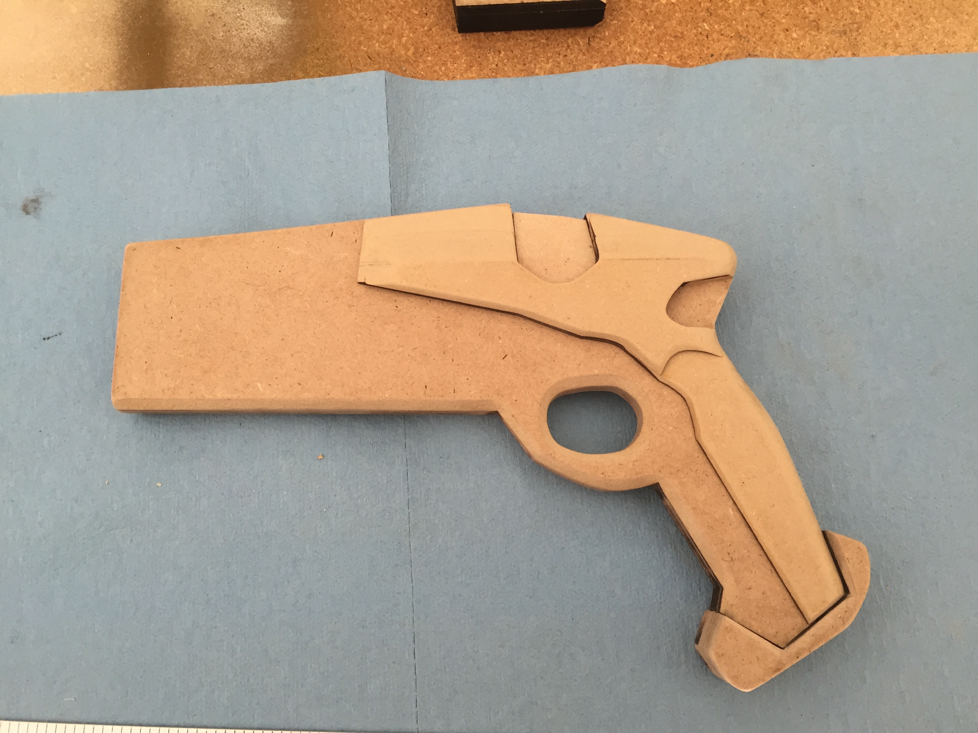

Soldier’s side arm was done the same way although with less attention to detail because I was running out of time. I didn’t’ add any detail to the front since it is always holstered.
The side arm is just primed black and left as is with no top coat.

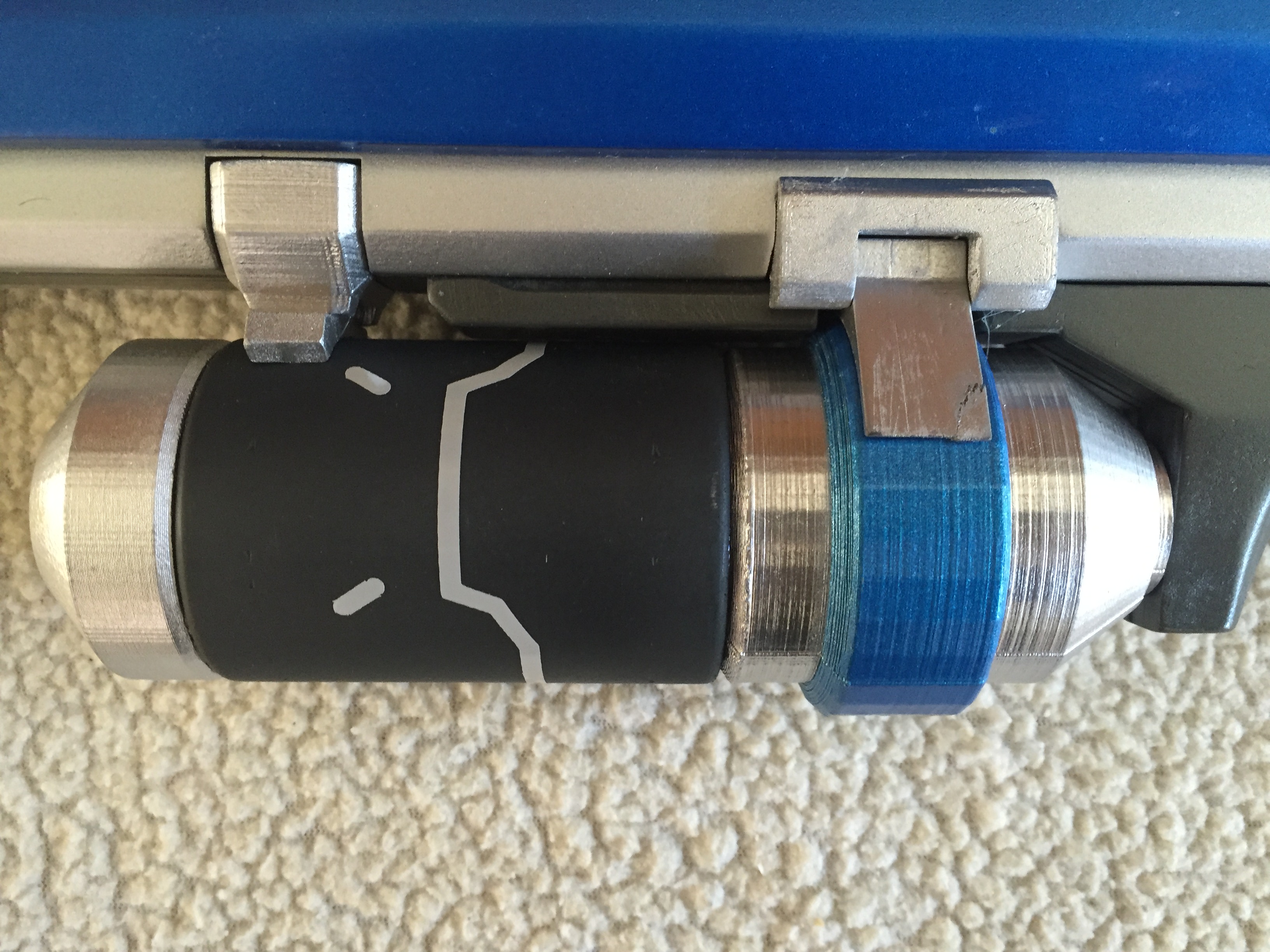

The yellow canisters are pulse munitions I think (which smell really good in the morning). They are just PVC pipe painted yellow.
