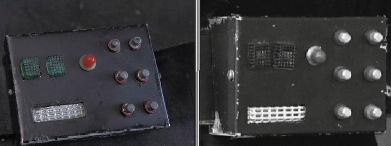

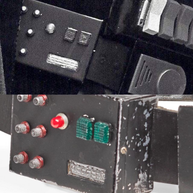

Number two, those are not the original Vader boxes. The tell is that the original box was dented n the left hand side and these aren't These are boxes that are probably the closest to the original, but like the gloves replicated.
These look to be the same belt. But these (and the ones in the auction are not the screenused boxes.
The knobs are too close to each other compared to the screenused boxes. And the spacing between the pilot lights and the knobs is off as well.
The mesh slot is cut uneven in the middle which is not the case in the screenused box.
You are right, Vaders left ANH belt box was dented on the box wall which faces the belt buckle, where the lower belt enters the box. This can be seen in the DP Kermit pics. The leather belt and buckle on the Bonhams suit is not the screen used belt and buckle, so perhaps they accidentally changed the lids/boxes when they removed them from the ANH belt?
On the Bonhams suit, Vader left belt box, upper row of knobs: why is the left knob (seen from front) shorter compared to the others? Like the one on the screen used box? Coincidence?

Ok, back on topic. In the pics you posted above, it seems like the placement of the geeblies on the Bonhams suit box does not match the one on the screen used box. Is this what you would like to demonstrate?
That and the location and size of the cutout for the mesh prove they are not the same box.
You may be right, but I‘m still not 100% convinced. It’s just a gut feeling. I have never seen the original belt boxes in person, nor the Bonhams belt boxes. And I wasn‘t able to find any images of the originals in my archive with matching perspective, shot from the same distance with a similar lens.

Also, is the mesh on the promotional boxes resin cast? The old B&W photo looks like I can see through the holes, like its actual mesh
