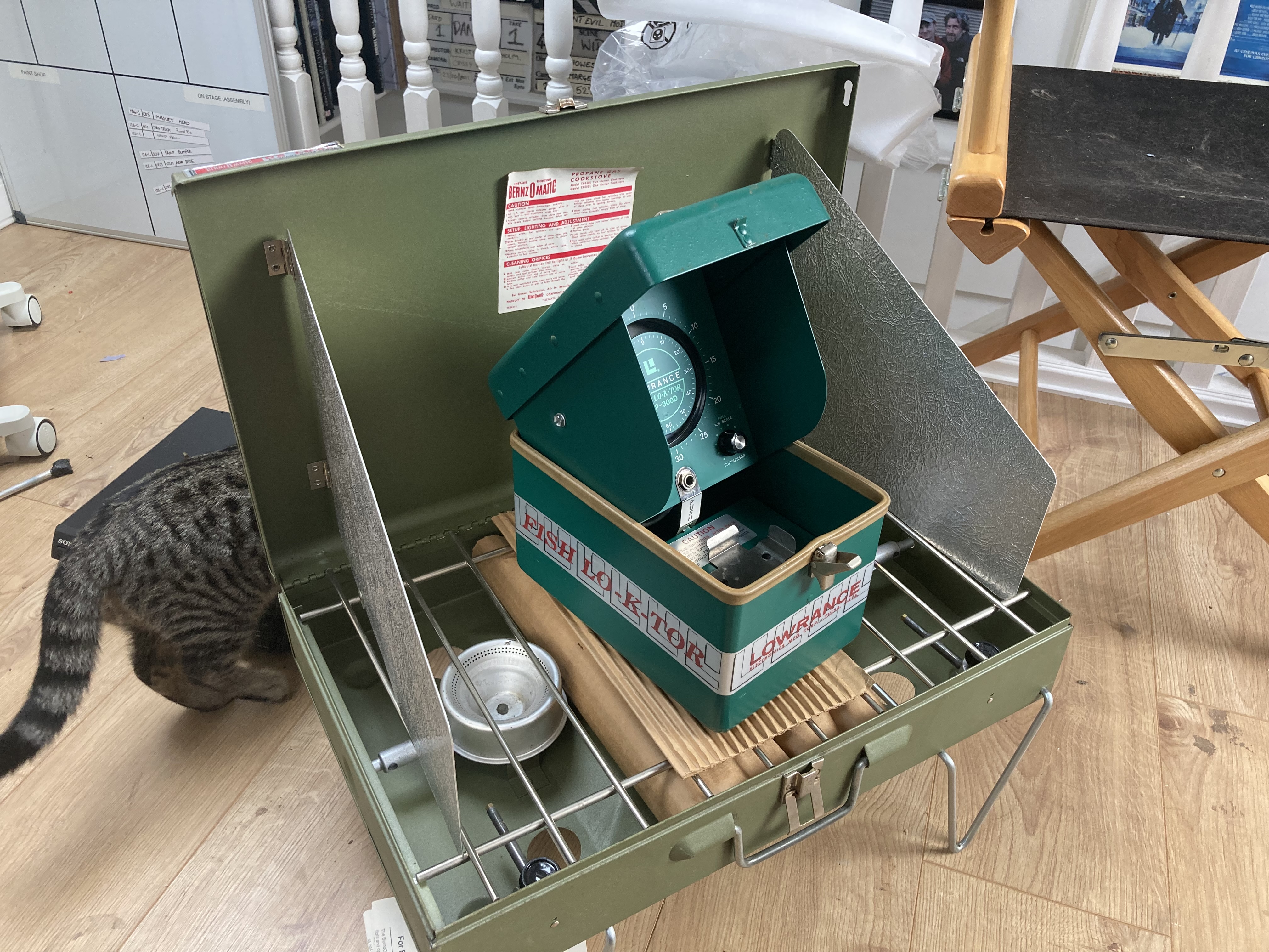

I managed to go to the States a wile back and pick up my stove.View attachment 1782844View attachment 1782845View attachment 1782846I've made molds of the radio, so I can make a few to sell with sound cards in them
NOT THE SPINNER:eek::eek::eek: Rambunctious little devil:lol: Glad you're back at it!!

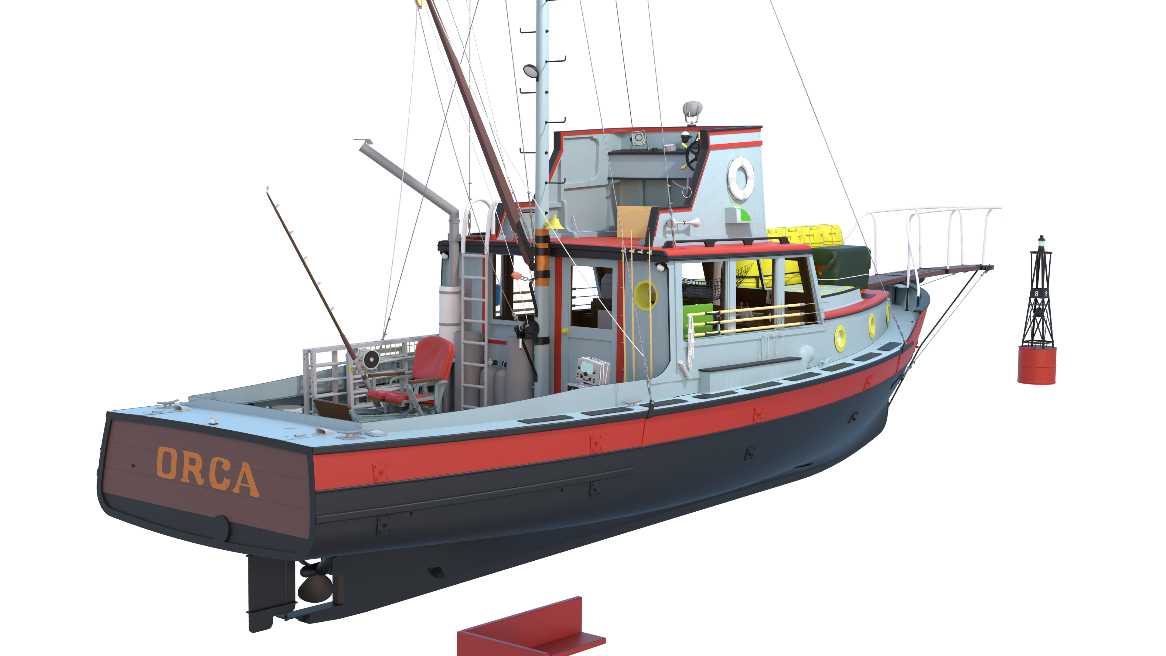

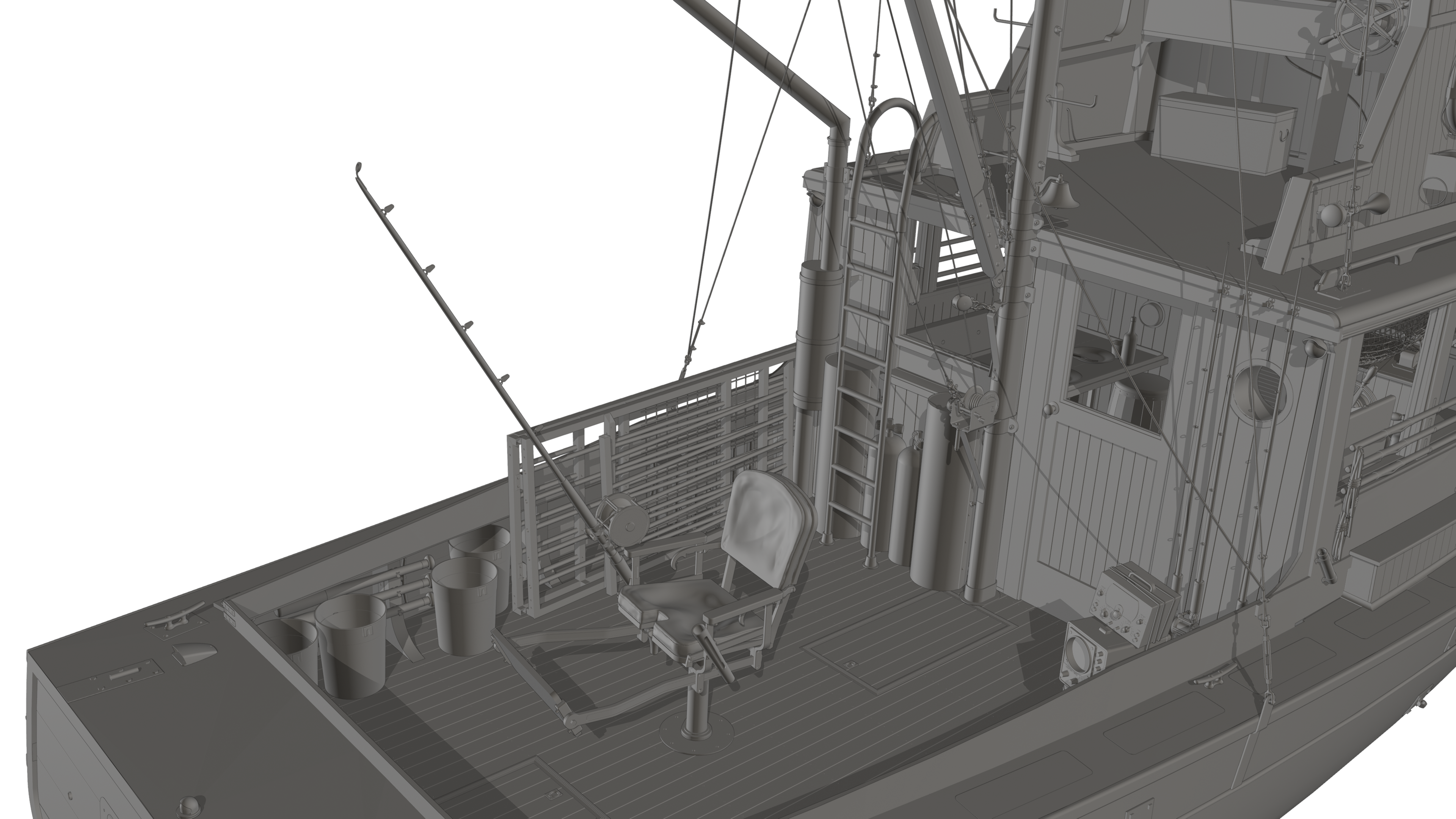

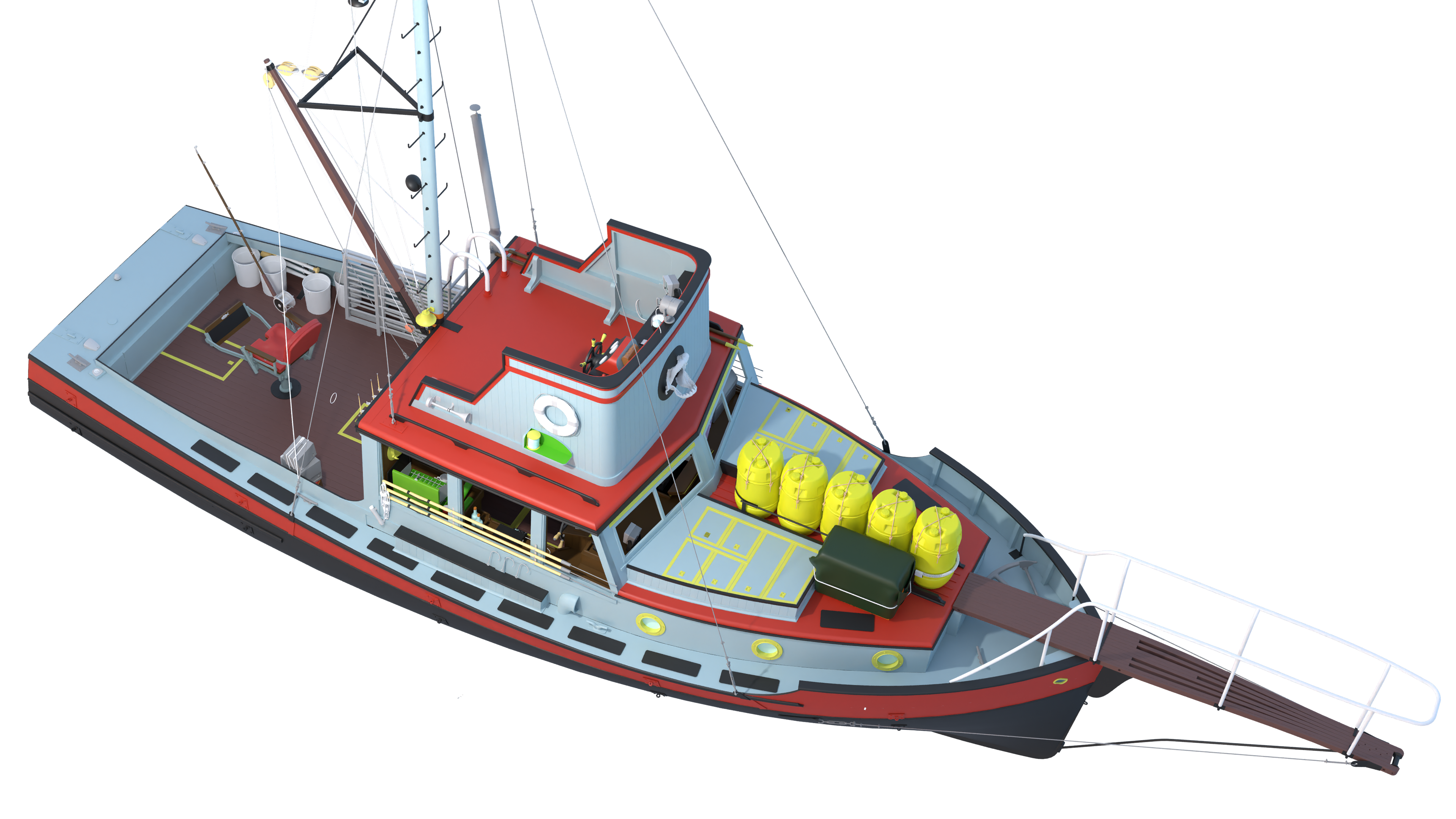

so as it's dark and cold and that time of year when I just don't want to do anything. I'm working on the 3D model, Adding all the little details so I can throw it in Unreal Emgine and learn how to use it . I'm just adding basic colours as the materials I use in Blender won't import in to UR.

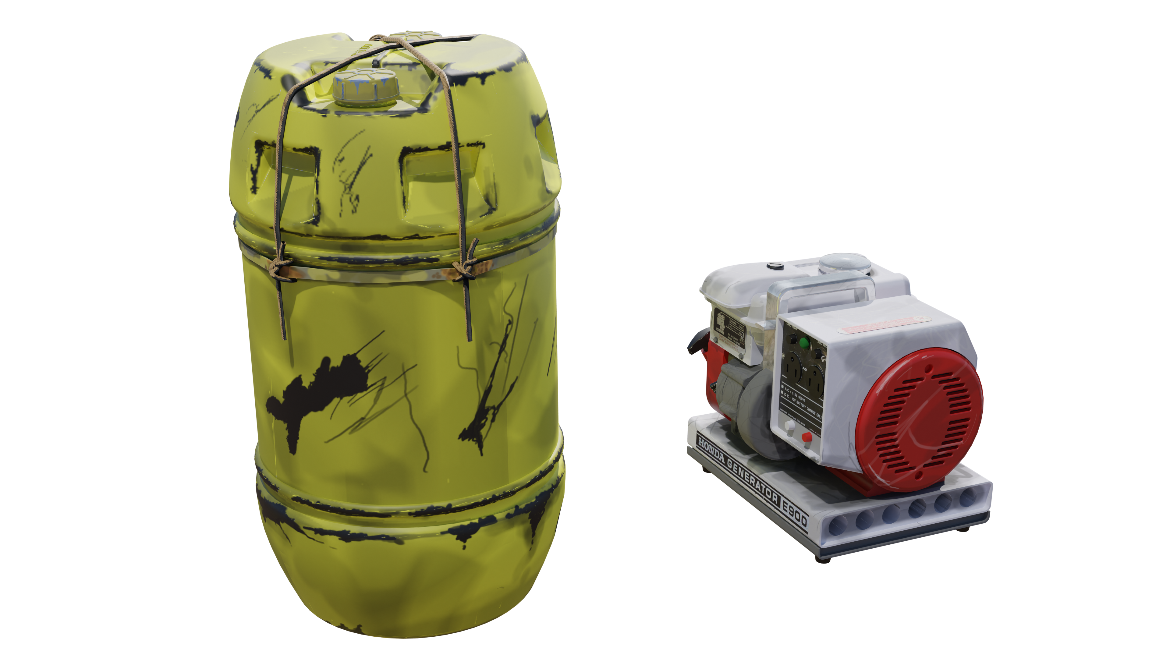

If I'm eventually selling the 3D model it needs to be Textured, something I have no experience in doing.
So I've decided to model the Orca one more time. I've taken a break and have a go at texture painting the props.
I'm not going for ultra-realistic more a hand-painted look. As it's all been modeled in Solidworks I'm keeping the
models as water-tight printable objects

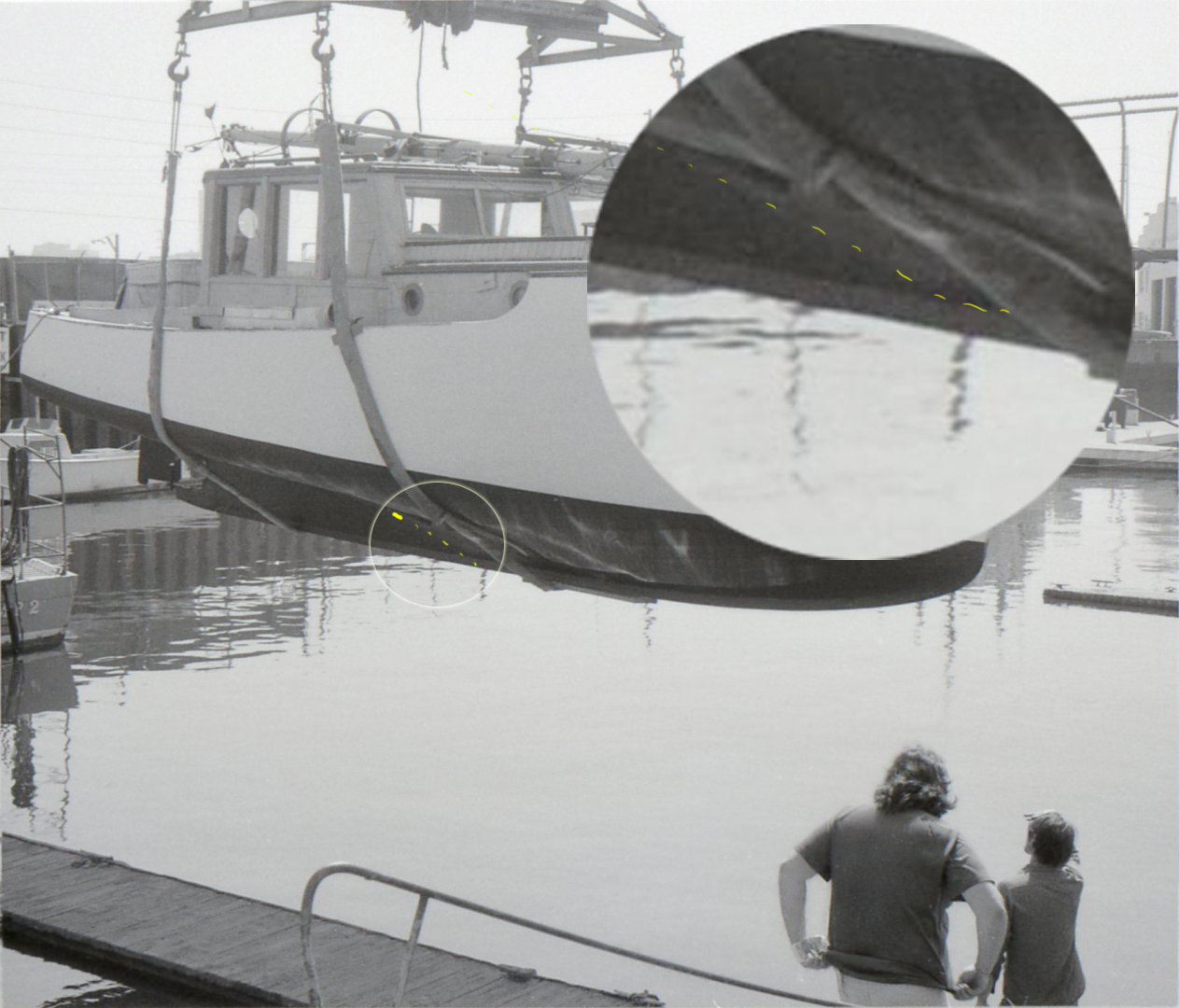

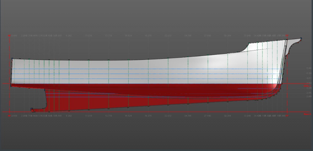

So I've drawn/modeled the Orca a few times now, there are always a few things that have bugged me but this morning I've finally given in to the fact that the mast is 2.5" off center I've always moved the trap door over keeping the mast centered but the math never works

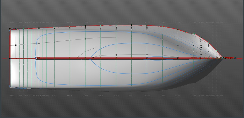

I found a better image of where the hull flares in.
I fully accept that I'm on an unendable unprovable mission to get this as close as I can. But I think that is part of the fun.

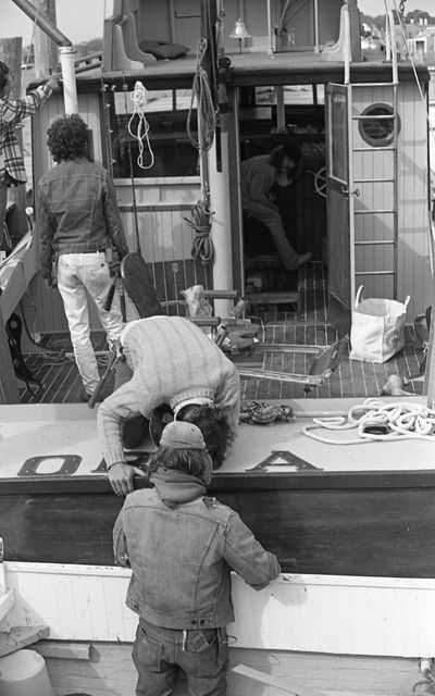

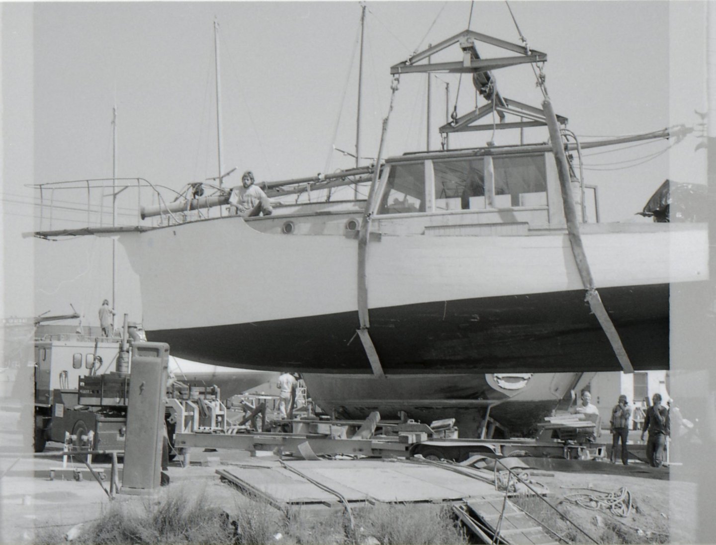

That was an unbelievable catch with the hatches and mast. I always thought the hatches were down the center line of the hull. Remember the whole back wall of the Warlock/Orca was moved and rebuilt. The first picture shows where the exhaust stack was on the Warlock and how much of the cabin they cut away to make Orca. (look at the ladder location on both back deck pics)
Be careful of the hull. the lift strap is in the way (had to be there eh? just where we need to see) follow the keel. First two pics of the hull is the pattern I used. Only problem is, the stern on that pattern doesn't flair in to center line enough. Hope this is helpful.
