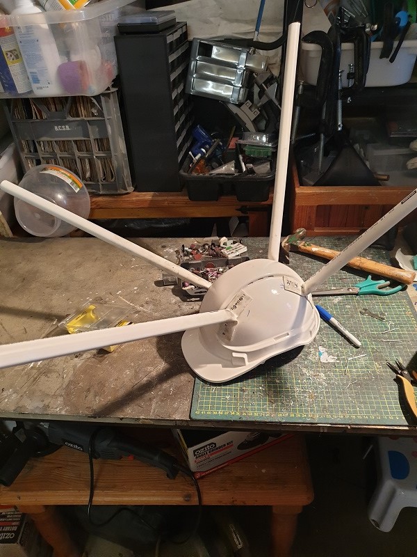

I started on the head, made it stronger with some irrigation pipe so it keeps it's shape then connected struts to a hard-hat. It can balance but the helmet needs a chin strap. I think i'll add in 2 straps that go under my armpits and into the upper struts for a little extra support.. we'll see, i don't want to walk around with my hand supporting my head all day.

His head is not heavy but it's not stable and it was windy so i had to keep a grip all day, i have a plan for straps that go under my armpits that still keep the ability to turn my head, that's the next iteration :)
