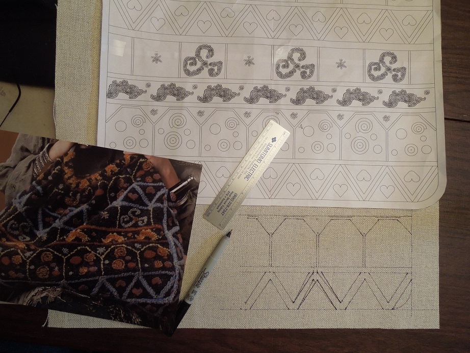

After several googling attempts to find one already made were unsuccessful, it became apparent that we (I) would have to make one ourselves. Since the bag has a carpet like appearance, I sifted through a few on-line videos, and adopted a hooked rug approach. I generated a pattern and transferred it to the backing material.

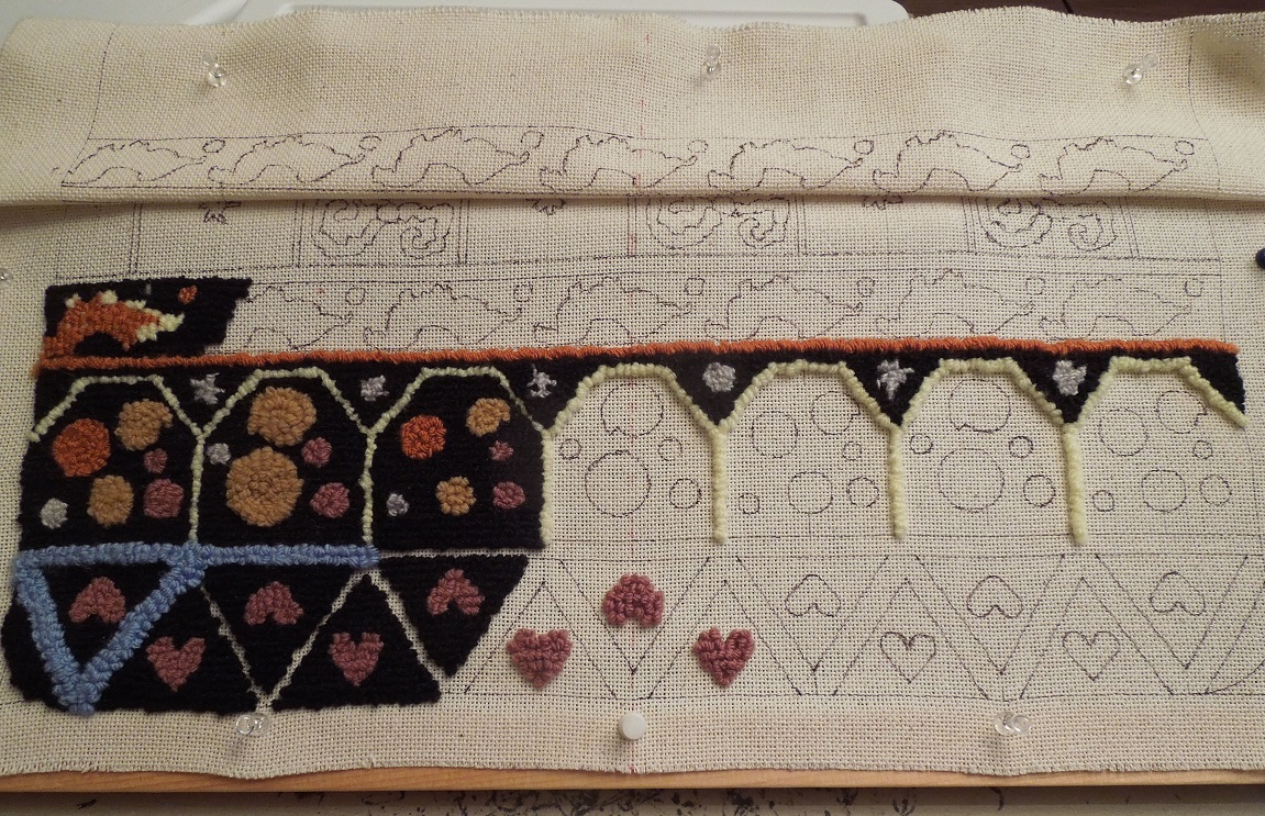

Bought some yarn and started hooking :) .
Unfortunately, at the rate I’m going, this’ll take the better part of a year to finish :(

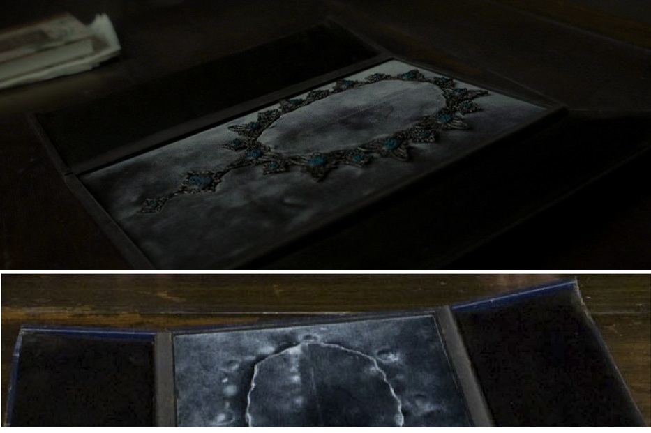

Another prop I’ve been working on is the Opal Necklace.
After I started collecting the components to make it, of course, it’s now available at Borgin & Burkes at Universal Orlando. They were sold out when I recently was there for “Open at the Close”. :( They only had gotten in 3 of them, and they went quickly.
The Necklace was designed by Miraphora Mina of MinaLima designs . (Necklace image used below with permission). Anyone who’s a fan of the Harry Potter movies should spend some time perusing the MinaLima website, and if afforded the opportunity, should see them at a convention. They put on a wonderful presentation.

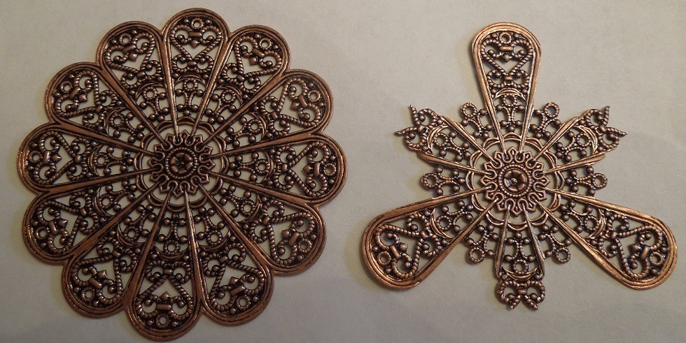

The large three-lobed part came from Cherry Tree Beads and they call it Vintage Silver Plating on Brass 55mm Filigree Component. They're currently out-of-stock, and although the webpage does refer to wholesale, they sold to me without a problem.
Actually, using scissors, and small wire cutter, I then cut off the parts I didn't want. I smoothed the rough edges using a half round file from a set I have.

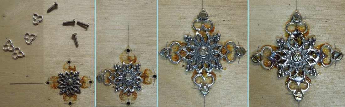

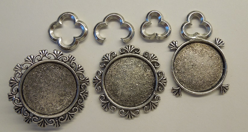

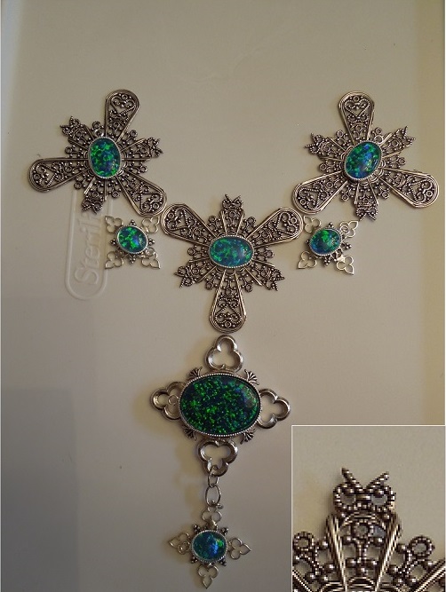

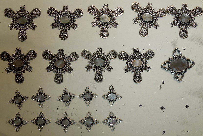

The large opal is 25x18mm. Once again I cut up some findings. The central part is a ”Round 20mm Cabochon Setting Frame Pendant Filigree Edge Antique Silver” from the Etsy site, to which I soldered 4 TierraCast Large Connector Link-SILVER QUATREFOIL (eBay) that I cut down to trefoils. I tried using epoxy and also super glue – but they kept breaking off :)
On top of the base I added a 25x18mm cabochon setting , once again removing the ring, and using epoxy to attach it.

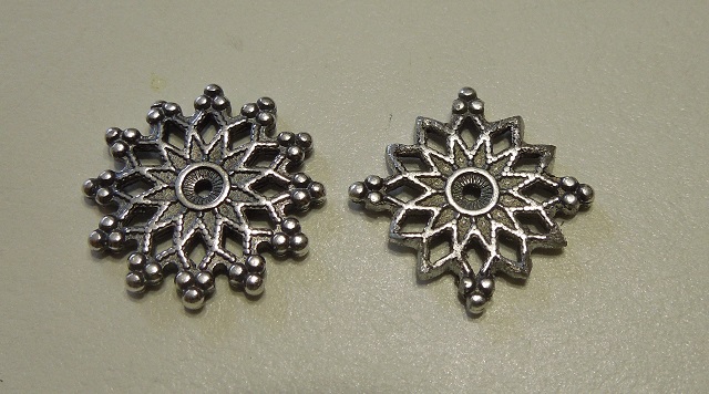

For the 10x8mm opals, I cut up a pewter finding from Fire Mountain (H20-4604FX).
To this base I soldered 4 Sterling Silver Mehndi Components from Rio Grande . I made a simple fixture to hold the parts while they were soldered. I’d recommend applying heat to the sterling silver part and letting the solder flow to the pewter part since pewter has a very low melting point itself. Once again, I did try adhesives, but the parts wouldn’t hold together.
I then epoxied on the 10x8 setting.
Since I used parts that were sterling silver, silver plated, antique silver, nickel plated, and so on, I lightly brushed on some very thin flat black paint to all the pieces, let that dry, and then wiped most of it back off using a paper towel dipped in naphtha (paint thinner). This helped all the parts have more of the same old looking finish.

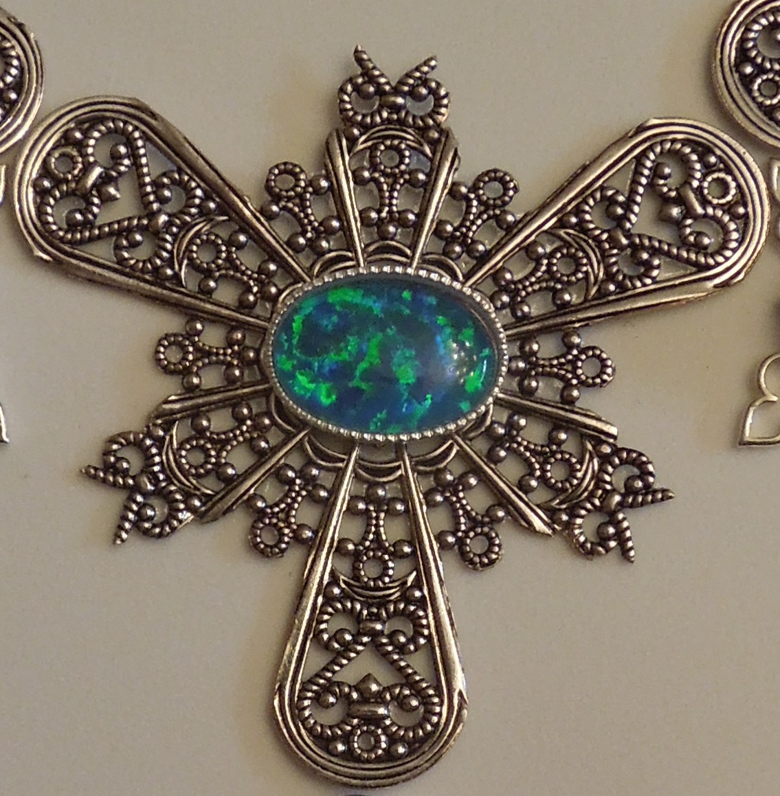

I then set the opals using clear silicone RTV.
I’m now in the process of figuring out how to connect all of the parts together with jump rings. Hope to be finished soon.

Using 112 jump rings of various sizes and shapes, I was able to connect together all the parts of the necklace.
It's basically finished. Now for the wood box!

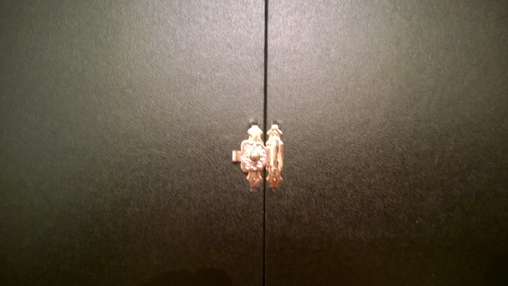

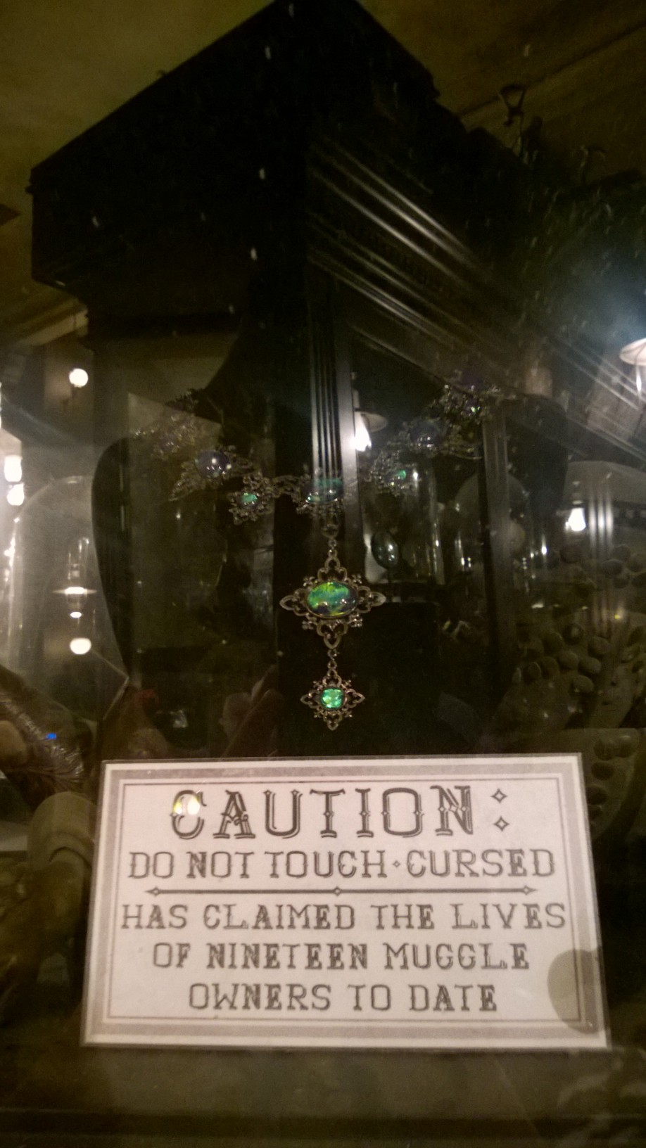

I purchased one of the necklaces in Borgin and Burkes, it is displayed in a pretty nice display box. If you would like more detailed photo's let me know, happy to take some for you.
ATL Kenobi
Thanks LorduDesign and ecl!
House Elf - Nice purchase - I'm envious! Yes please post pictures to this thread if you'd like! Any or all of these would be welcome: The whole display case closed, a close up of the hinges and a close up of the latch(es), the case open, a closer shot of just the necklace, and then a close up of each of the 3 different size opals would be great. THANKS!

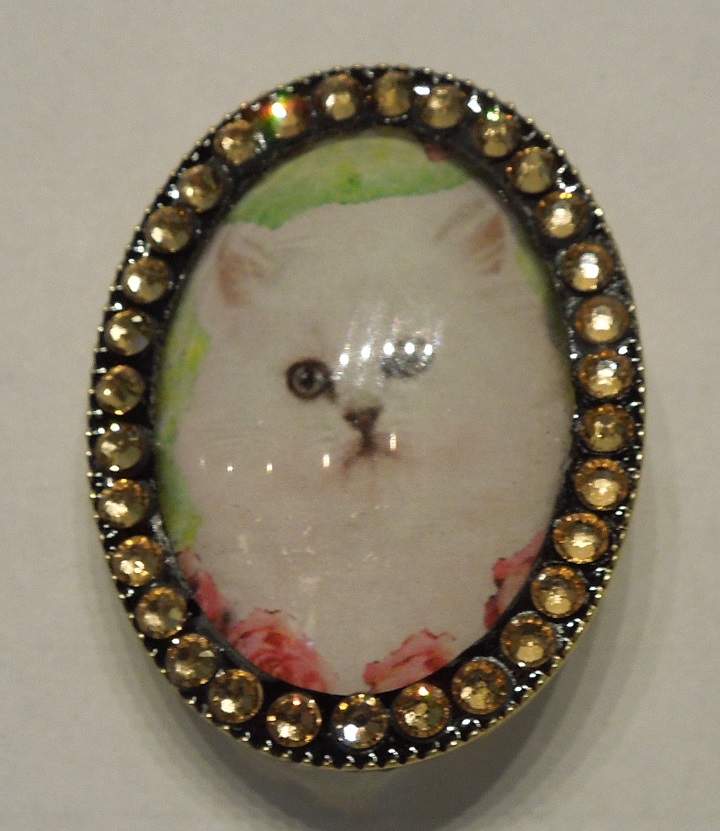

I've taken a little break from making the display box. We're working on an Umbridge costume for a sister-in-law and I thought I'd try to make the brooch she wears:
Perhaps not up to RPF standards, but its close enough for me, and my wife thinks it's soooo cute.

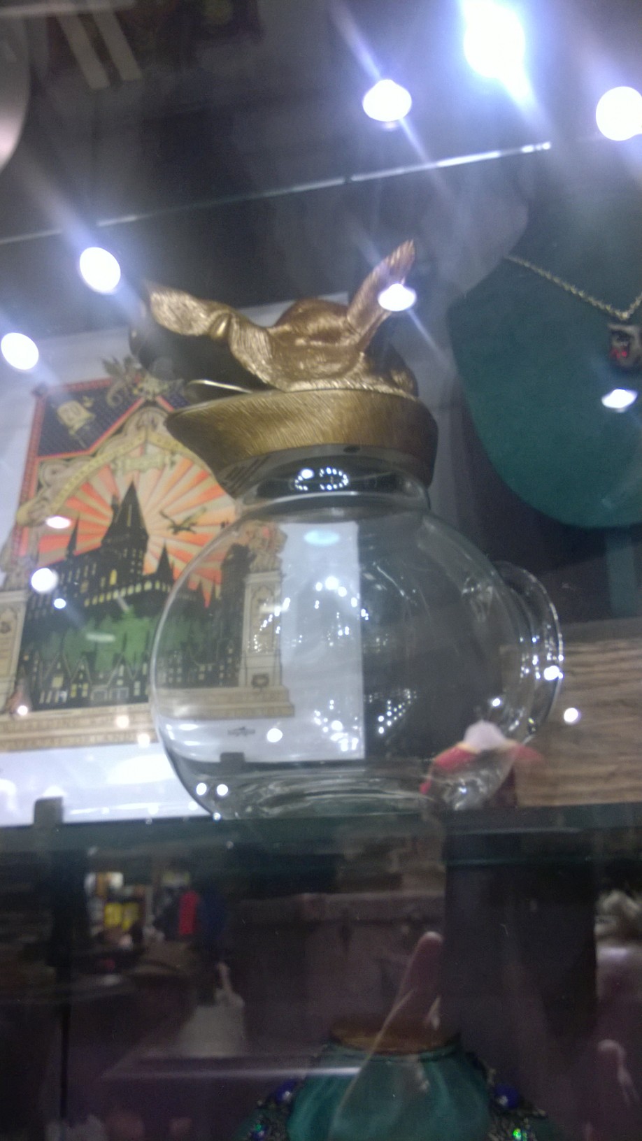

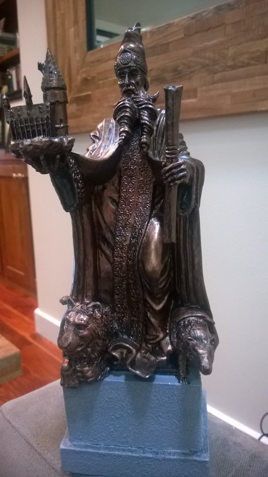

House Elf
Yes there are replicas at WW. I will take some close up photos of the necklace and box tonight. They have actually added a few really awesome replicas including the hogshead jug (the ones the students had in the great hall) and also a small statue of the Hogwarts Architect.
ATL Kenobi
House ELF - Thanks for the pictures! I was wondering if there were two latches on the box, plus it's good see that there's a clasp on the necklace itself. I'd added one to my replica because I couldn't get it past my wife's head to fit around her neck. BTW - since I've studied the necklace a little bit, I'm here to tell you that this reproduction is excellent!

The jug was $125 and the necklace $350 (I think) however if you use an AMEX inside Universal and ask for the mobile discount you can get 15% off. These items aren't available online but if you contact Merchandise Services they will sell them to you over the phone. I am hoping that they will sell more unusual items - I am holding out for someone to make the Troll Foot Umbrella Stand, which they have as one of the props items not for sale in Borgin and Burkes.
