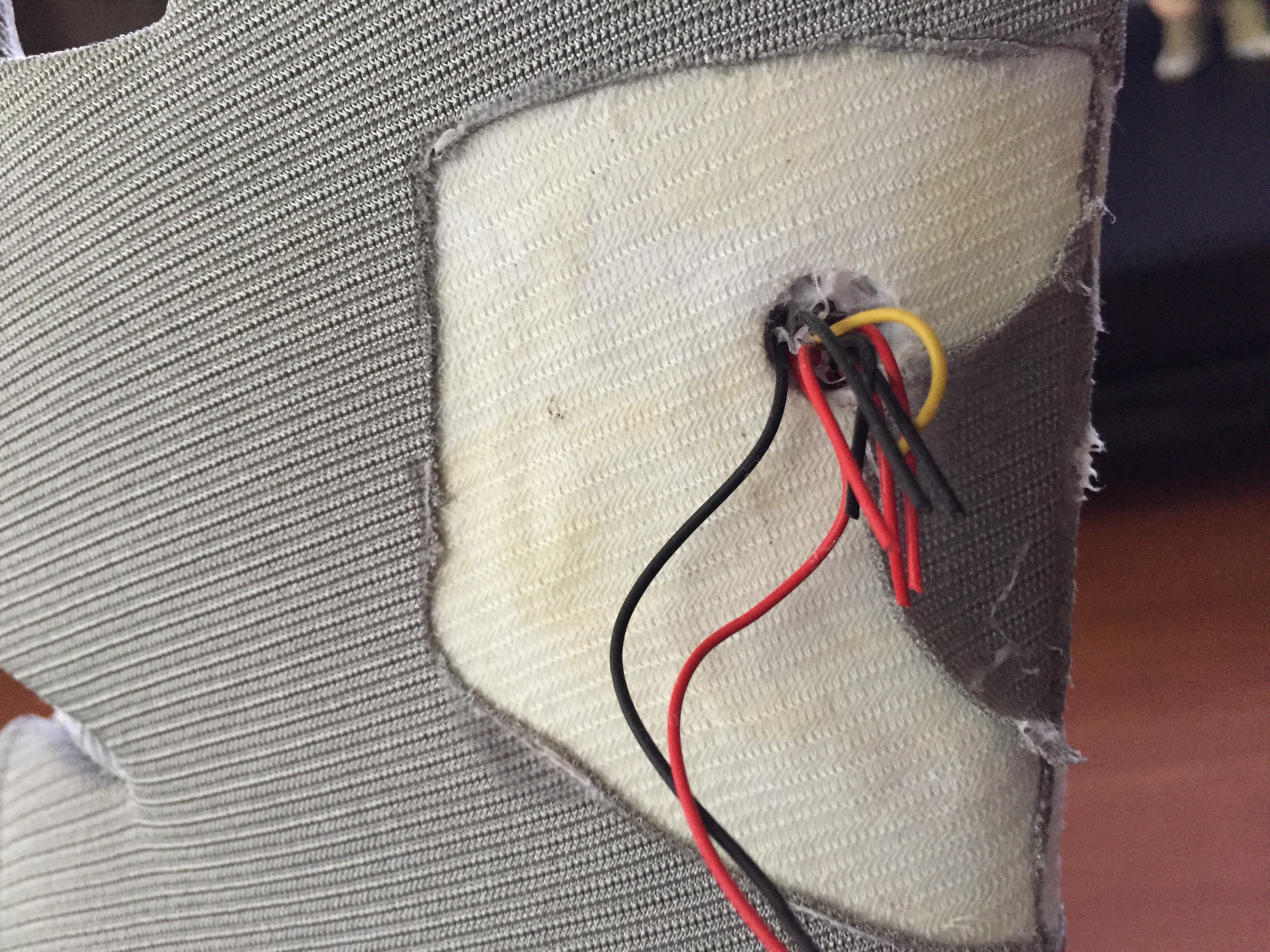

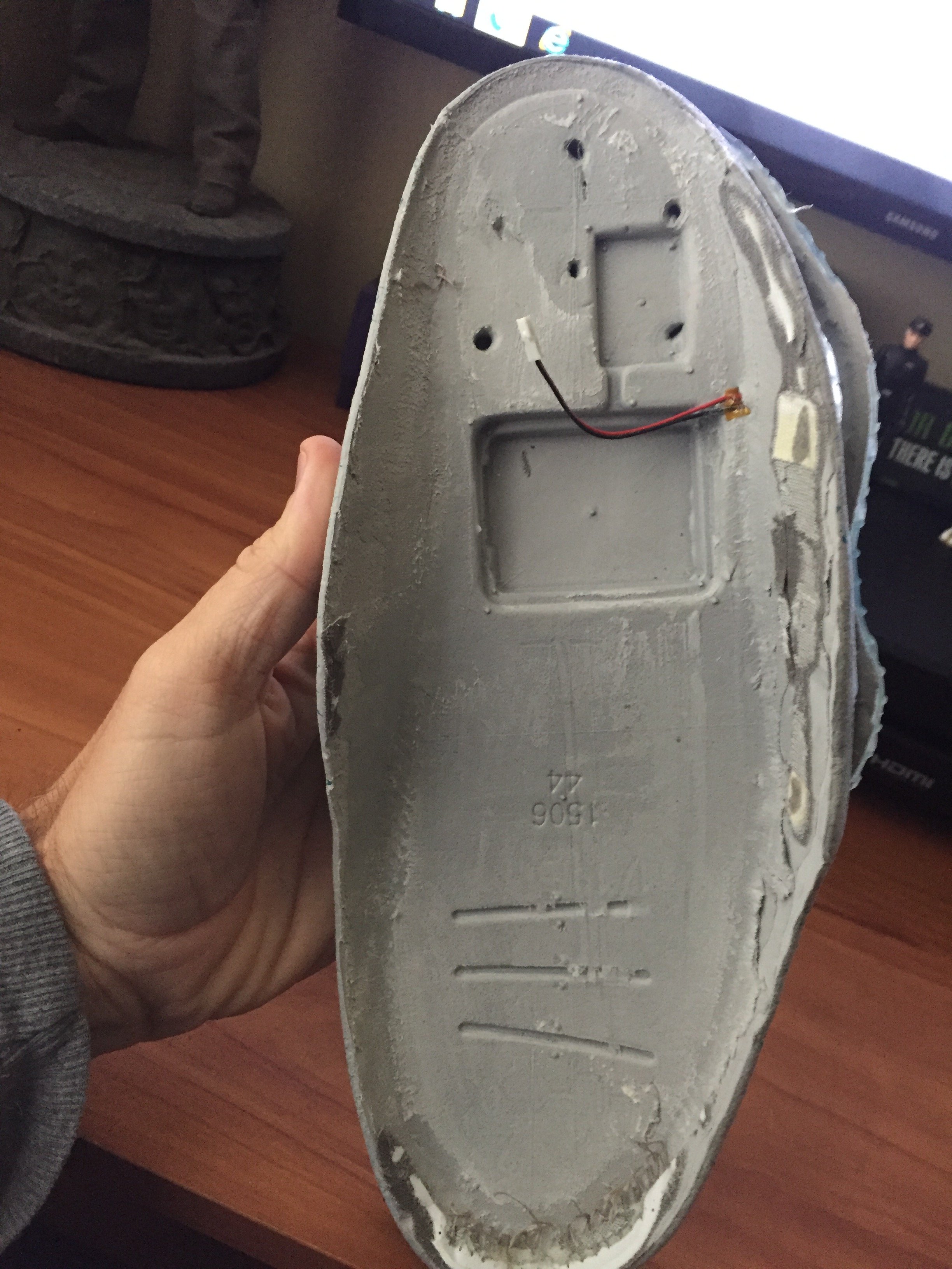

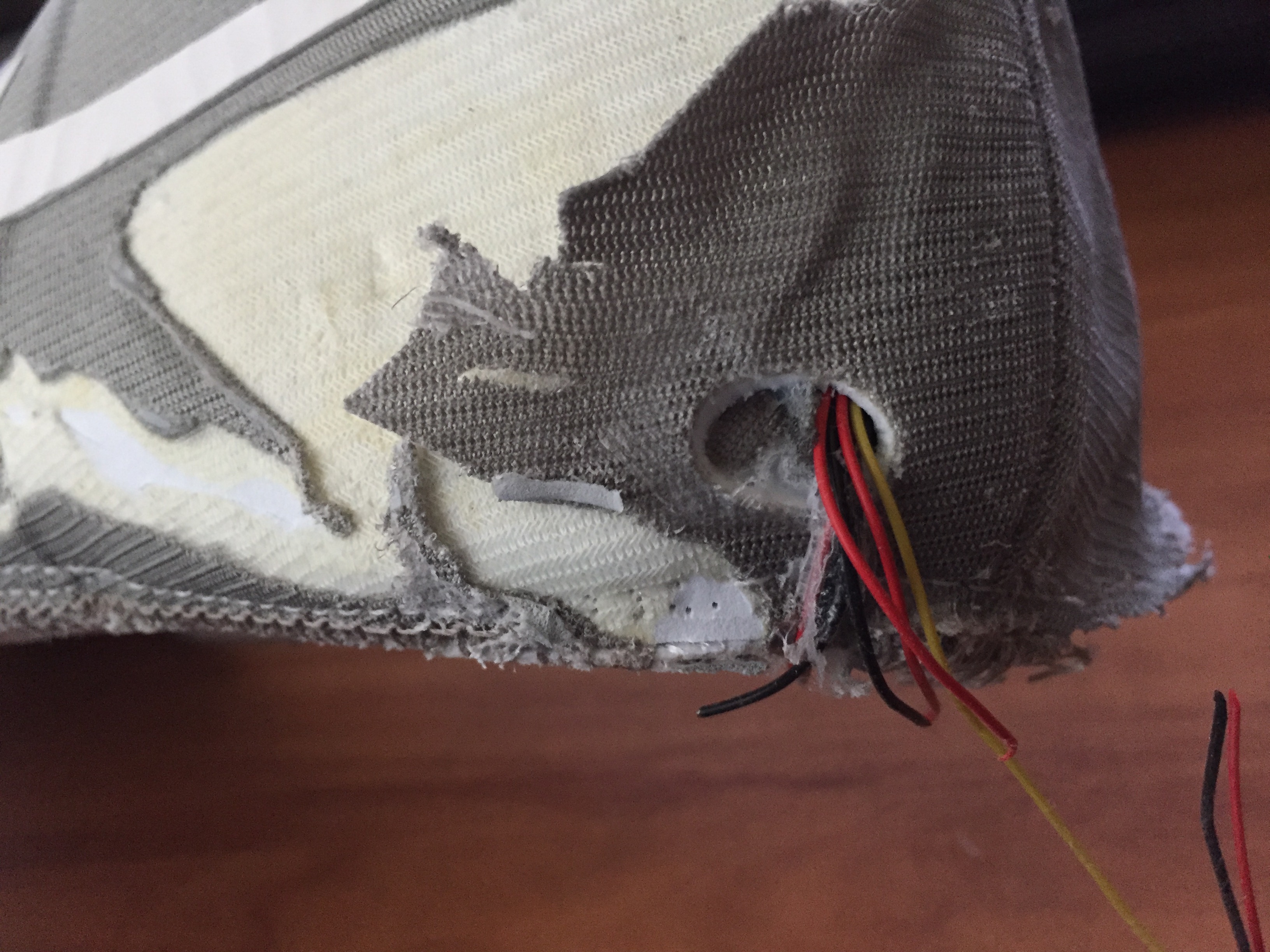

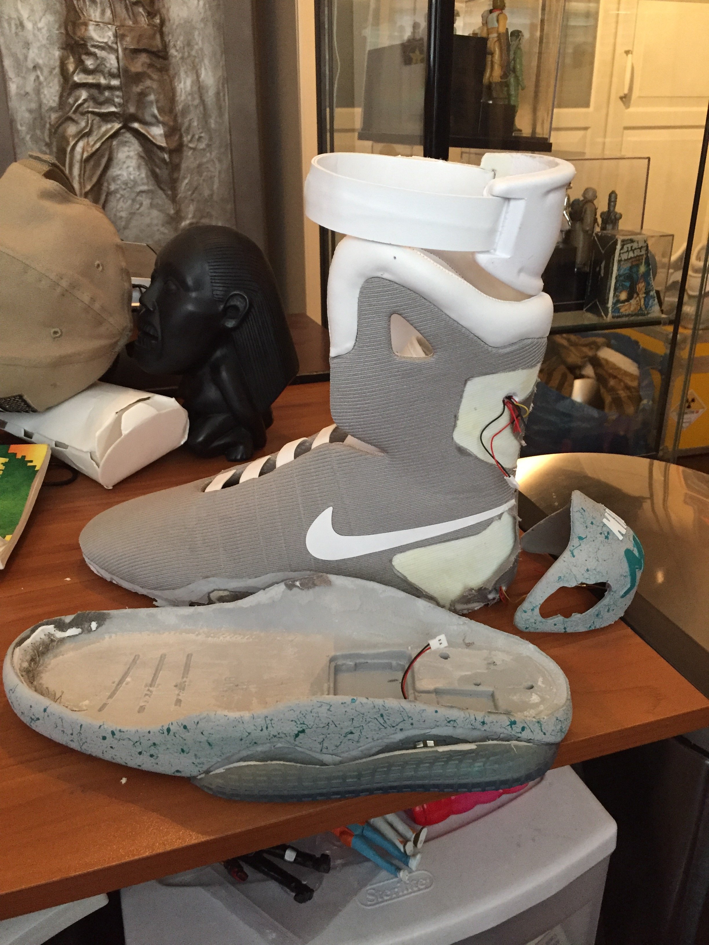

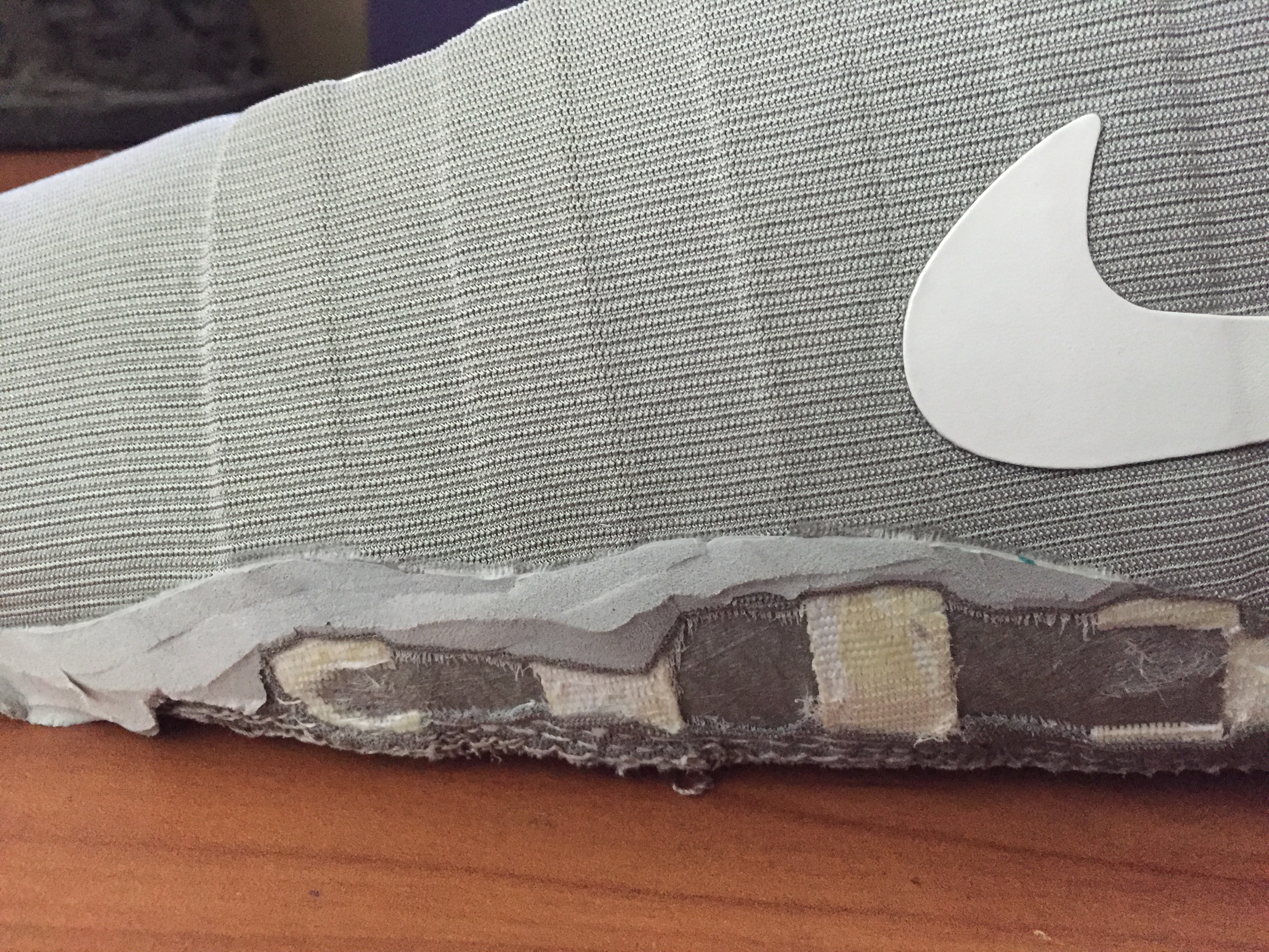

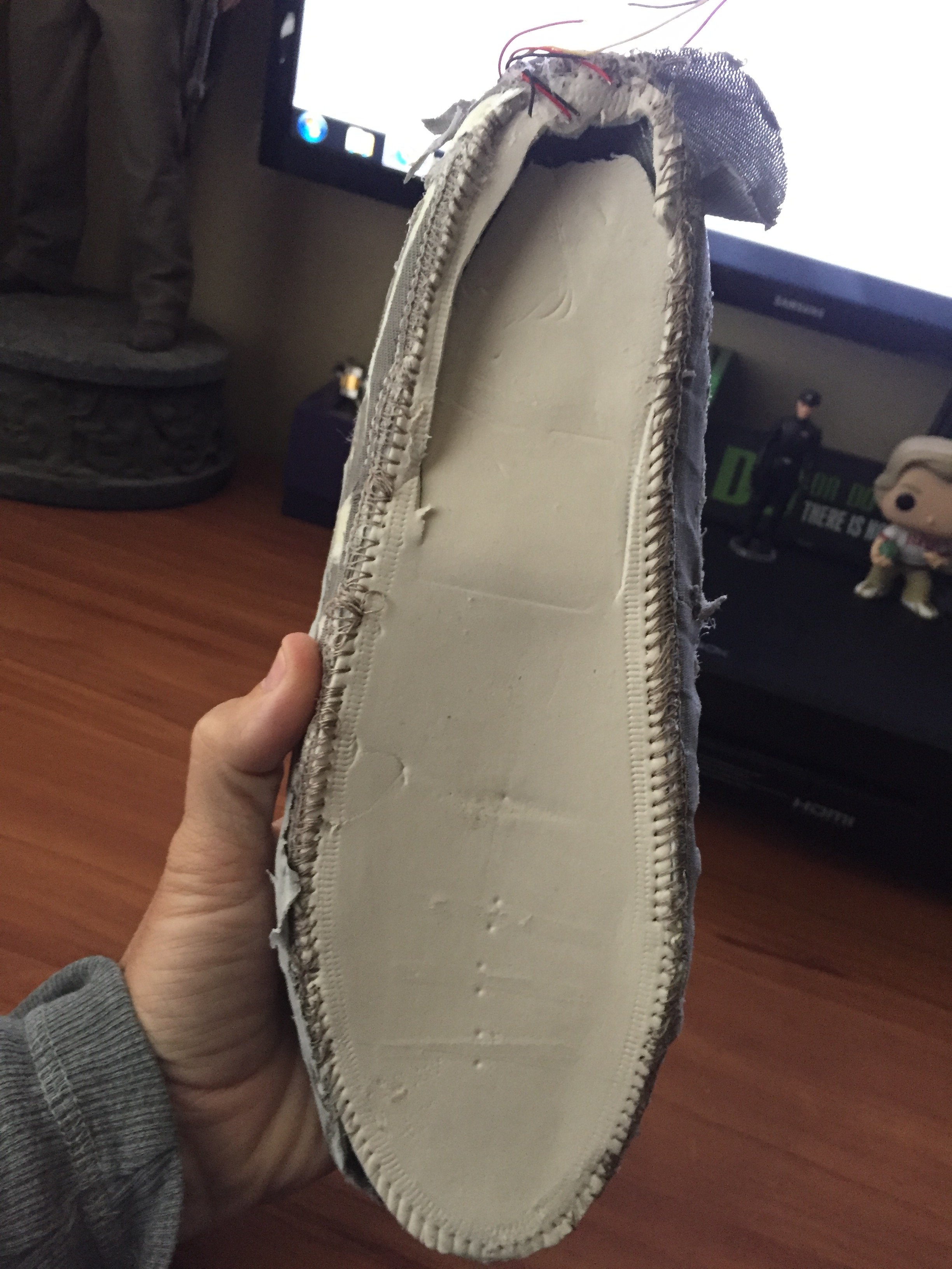

nah. I took this one apart for fun:

Nope. This was a perfectly good shoe. It was sent to me as a replacement for a show that I was able to fix. This one had the slightly darker grey fabric from the second release. I used it as a test shoe but then decided to take it apart.

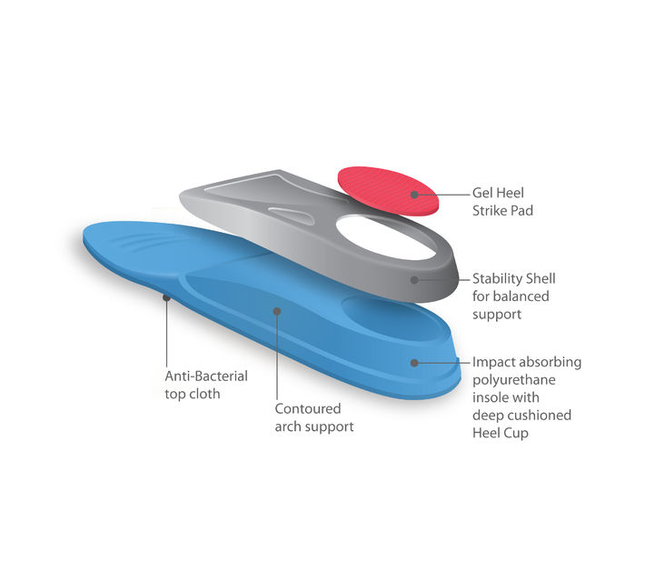

I always (since the V2's) used these special insoles with framing plastic that would have covered the lumps made by those clips, that's probably why they never bothered me.

Are your batteries still in or have you taken them out? I use a similar in-sole and I can feel a difference now those plugs are pushed down. Like with the V2s, the V3 has a cavity once the battery is removed that needs a supportive fill. The EVA foam I have used compresses over time. I originally used this in my V2s and I ended up using small blocks of PinkySil (A25 Shore Silicone which is about the same sponge feel as the V3 mid-soles) I had from old, redundant molds. In time, I will have to make the same sort of blocks for these V3s, but I might go as far as making a proper mold first.
I haven't taken the batteries out or even replaced the side domes under the clear with anything yet. Too many jobs on the to-do list at the moment. :) But that PinkySil idea is good, I don't think silicone remains compressed after the pressure put onto it is removed, so it should stay spongy.
Exactly. The pink silicon I used in my V2s is probably 2 year old and still as springy as the day I put it in.
