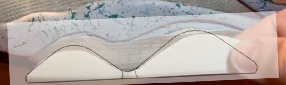

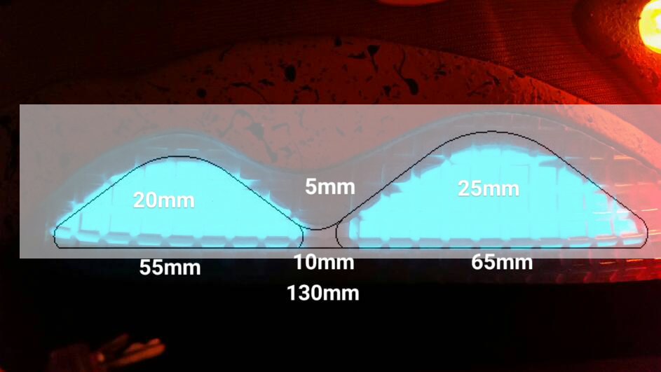

The shape is a little off. I over laid the template with Jedifyfe youtube video on photoshop and you can see it. I am gonna see if I can make a template later tonight but I am not sure mine will be any better. But my electronics are completely shot and rather than buying the replacement boards and ELs that will break again I am gonna try and make them like everyone did for the V2s.

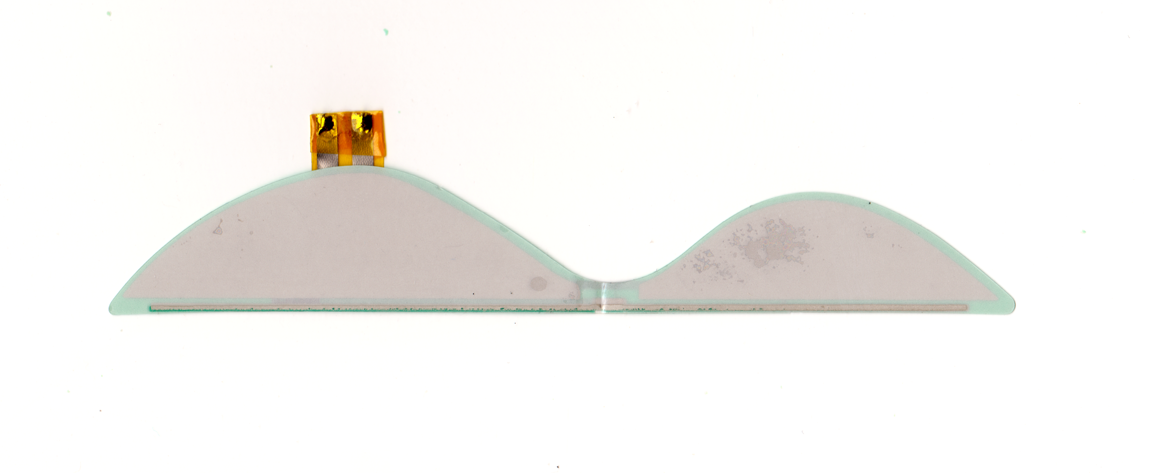

cavx Here's a scan and template from when I sent off to have panels made. This is a original panel I used from a size 10.5 so I could get the shape correct. Your 130mm over all length is pretty spot on for this size range.
@cavx Here's a scan and template from when I sent off to have panels made. This is a original panel I used from a size 10.5 so I could get the shape correct. Your 130mm over all length is pretty spot on for this size range.
Awesome,thank you for that.
remember that it;s not just about the shape of the EL panels but also about the voltage. You can have the most accurate size panels but if the color isn't right, no one cares...
True MAG fans want to see CYAN EL. Joe Average does not know or care and thinks blue LEDs look awesome.

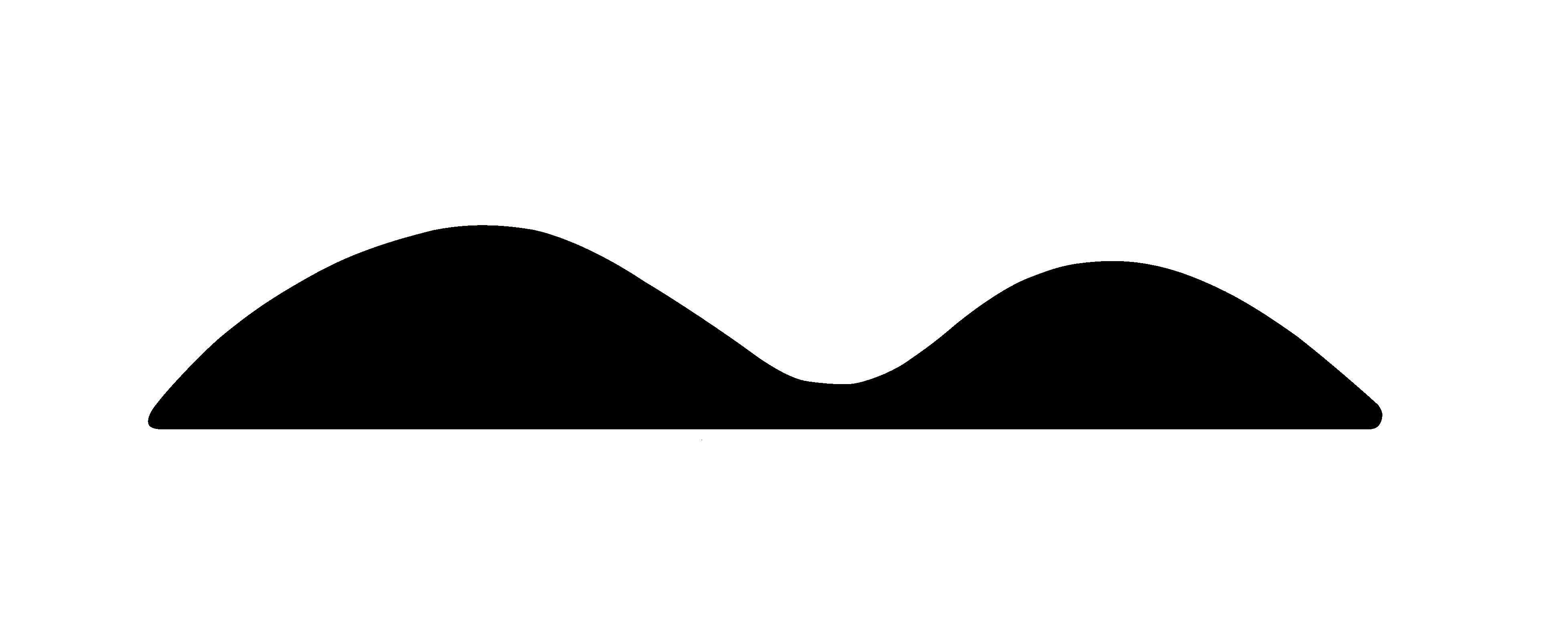

Thanks WizardBTTF this is now scaled to be about 132mm.
