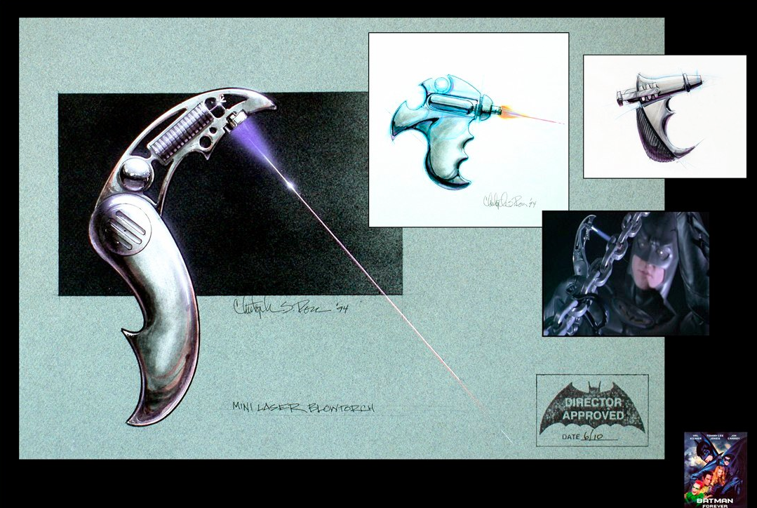

Ever since I saw Batman Forever I wanted to reproduce the cutting torch he uses in the opening action sequence. I used to pause the video tape over and over trying to make out enough detail to make it. Now, thanks to blue ray, there are better images on the internet so it's time to finally make one!! Mine will be made out of aluminum and wood.
Here's the original prop.

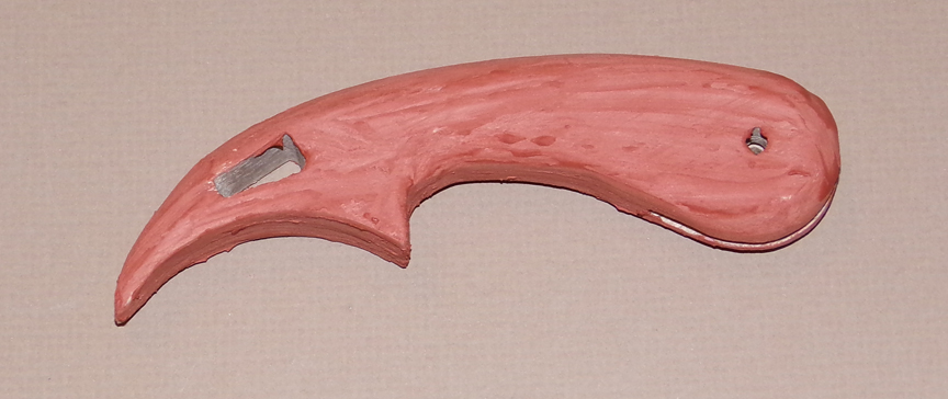

Here is the handle puttied and waiting for sanding

It's not a difficult prop to make depending on what tool you have. The main body on mine was made from a 1" by 2" board. I cut the basic shape out with a scroll saw. Then I sanded it with various sanding methods to get the smooth, rounded shape. The metal plate was made with 1/8" aluminum. I traced a pattern on the aluminum and cut it on the same scroll saw. The aluminum I used was a 1" wide plate found at the local hardware store. The miscellaneous pieces were all found objects.
This thread has some reference images you can use to make a pattern. If you have specific questions feel free to ask here or Private Message (start conversation) me. Good luck.
For the inside cutout I drilled a hole in the aluminum. Then I disconnected one side of the scroll saw blade. I ran the blade through the hole and reconnected it to the armature. Then I was able to cut along the lines I had marking the cutout. When I was done I disconnected the blade from the armature and slid the aluminum off the blade. That's how I did it using a scroll saw.
It does depend on the material you are cutting and what tools you have available. If you're using thin plastic you can cut it with a sharp X-acto knife.
