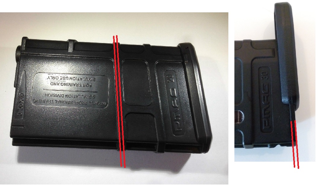

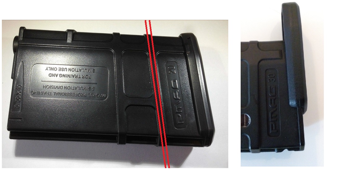

cool, I will try cutting down a 20 round (might be able to use ridge as slide fixing - see pic) and failing that will try 3d printing something, but like Joe says tolerances will likely be a problem.
Didnt mean to derail thread - thanks for ideas/discussion

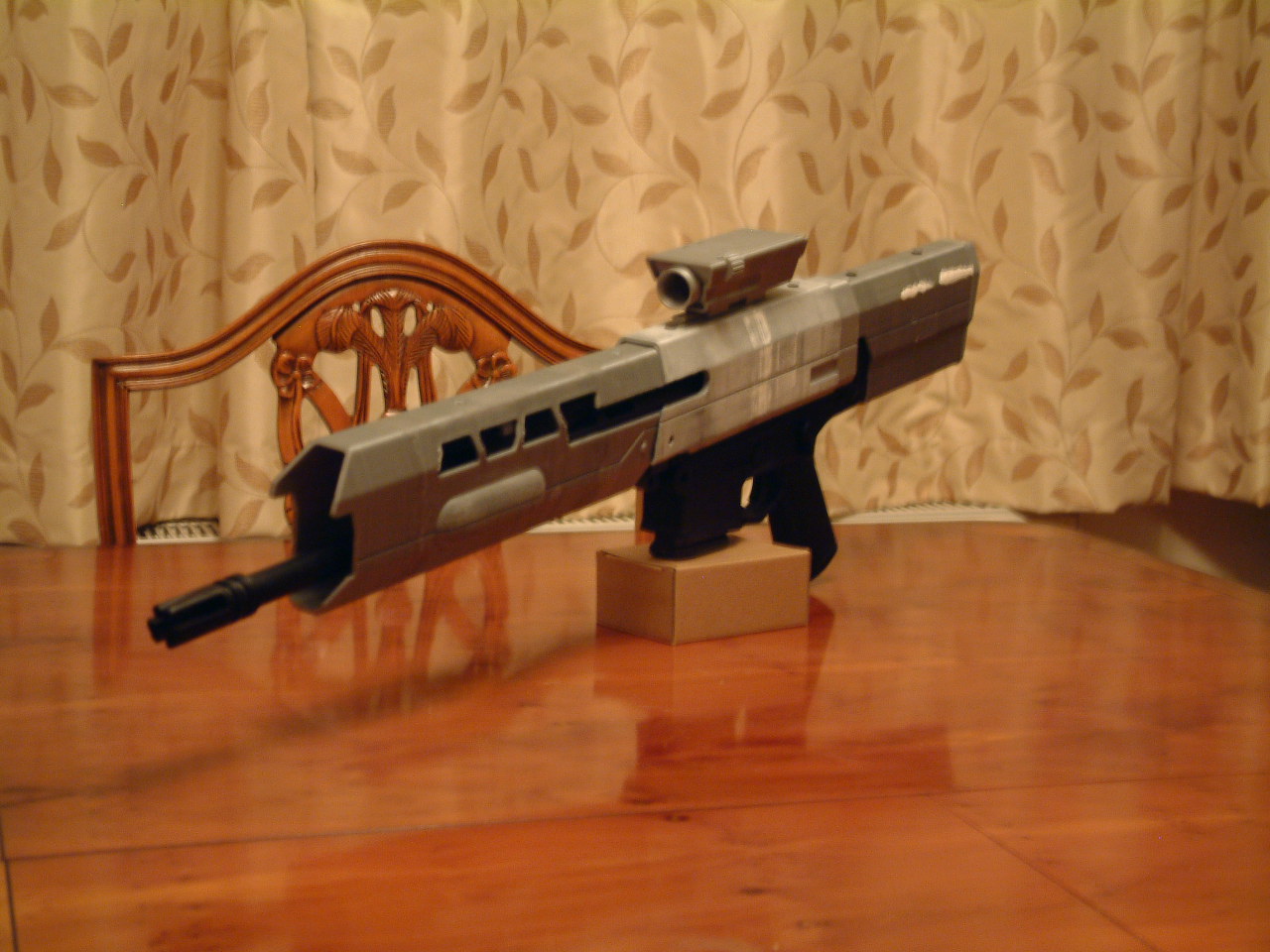

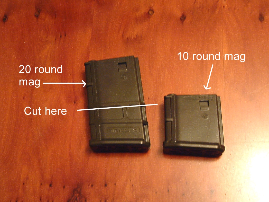

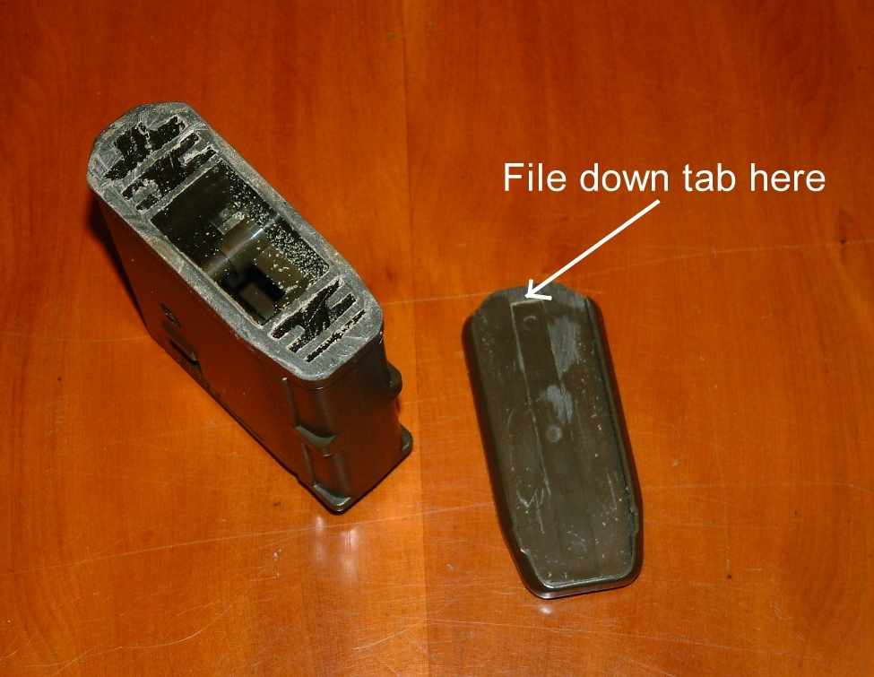

Hi Joe,
Hope you don't mind but here are a couple of photos of my kit test fitted to my Masada and I think its looking real good thanks :thumbsup I have cut down the 20 round pmag and if it is cut just on the molding line just below where Nostromo20 marked his red lines above, with a very minor change to the bottom plate, it just slides right back on :). I am going to make it functional by inserting some 8mm copper heating pipe in a curve which will house the spring and BBs. More to follow if that is OK. Thanks again John.

Hi Joe,
Absolutely not! Looking good so far.
