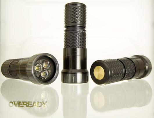

You have an XPG2 4000k neutral H3 HML engine. We made 4 oblivion lights this year, all 4 with the same spec. You can see all 3 that have sold in one this image. One is actually yours, one went to another shop, and the 3rd went to a private dude. The fourth (not shown) is still for sale:

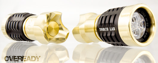

Here's another configuration with (most) of the same parts (in solid hand polished brass):
