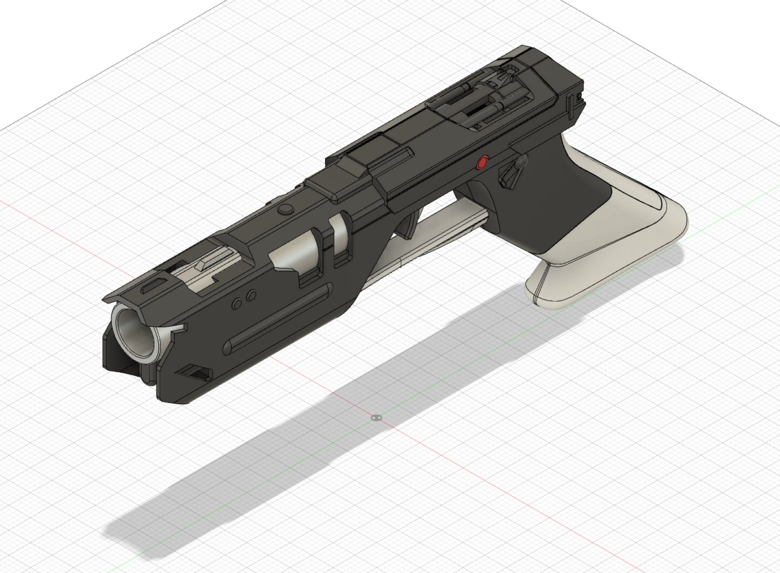

I started working on it in early 2020 in Autodesk Fusion 360, well before I owned a 3d printer. Since then I purchased a Creality Ender 3 Pro FDM and an Elegoo Saturn resin printer .
This is a rendered version from Autodesk Fusion 360 giving me an idea what the final should look like.

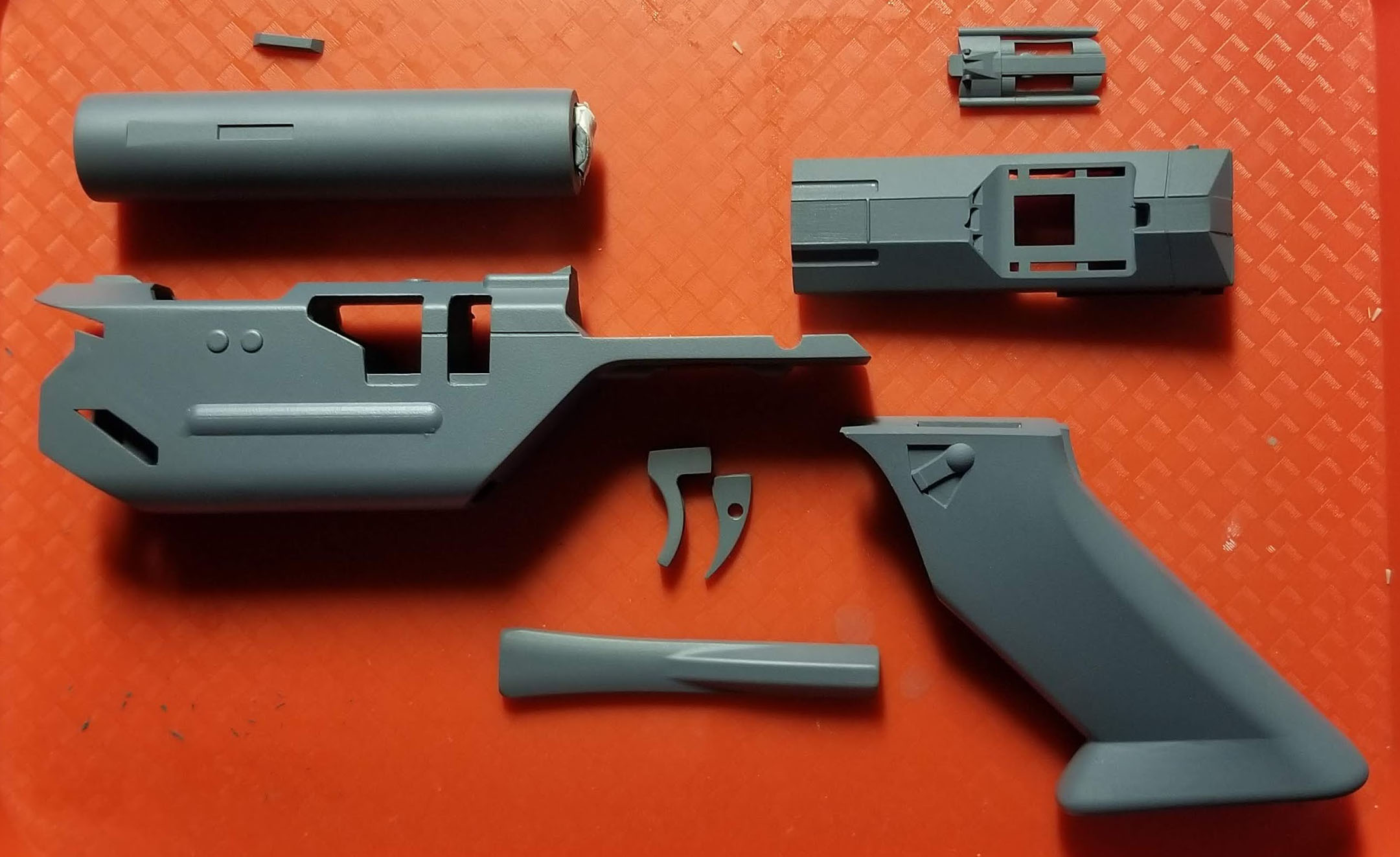

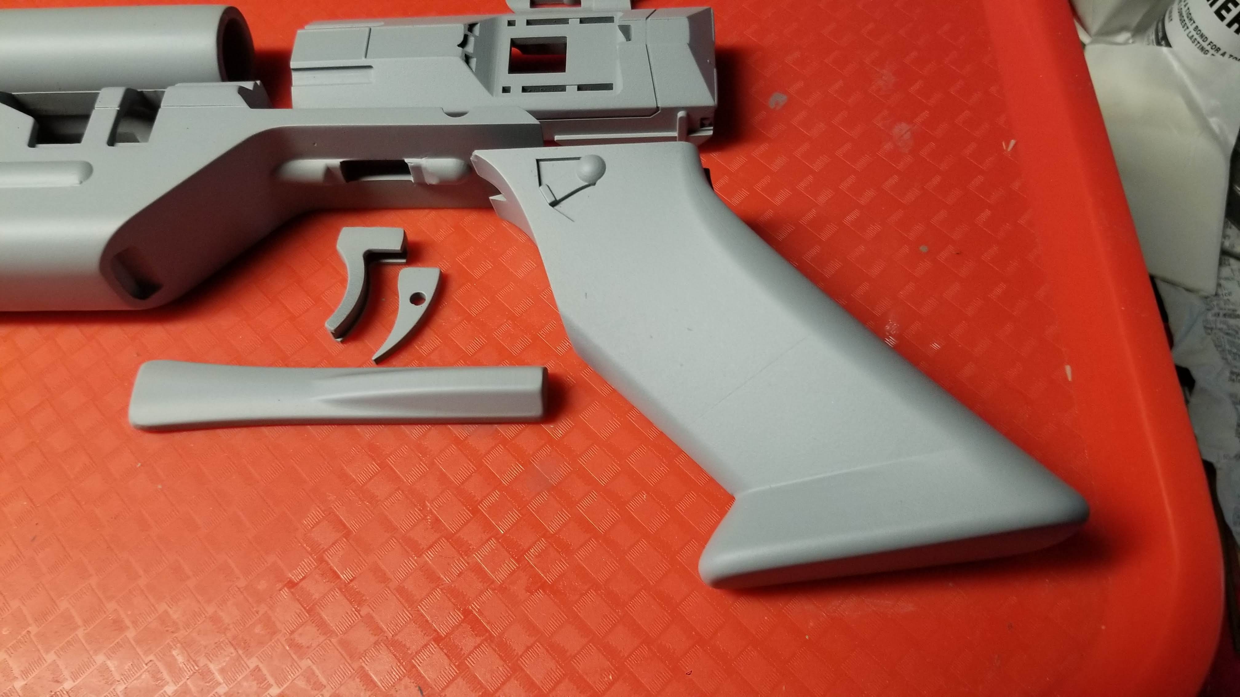

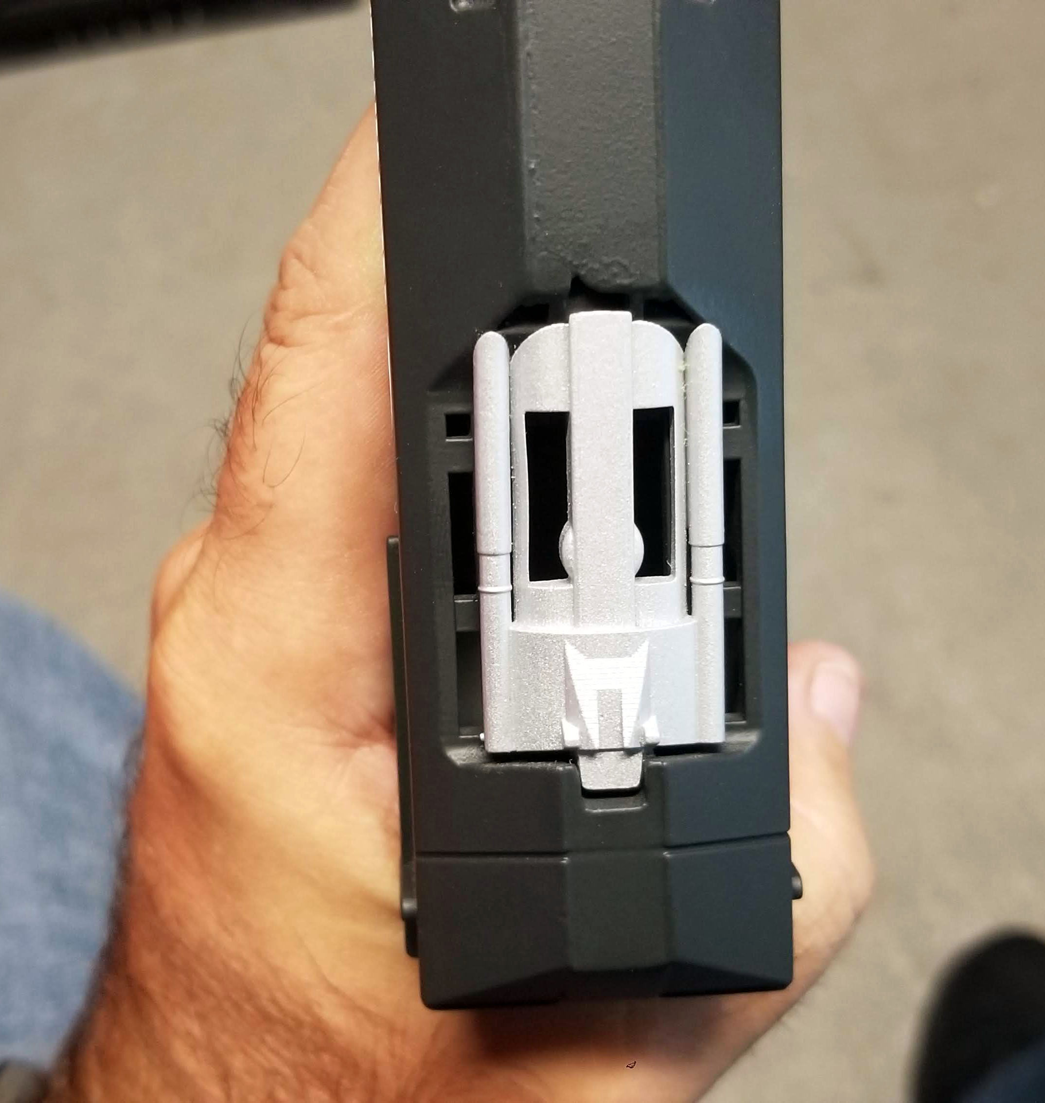

I used the Saturn resin printer for most of the parts. This build wasn't going to have electronic lights and sound so I used the Ender 3 Pro for the red side greeblies which in the original would have been red LEDs.

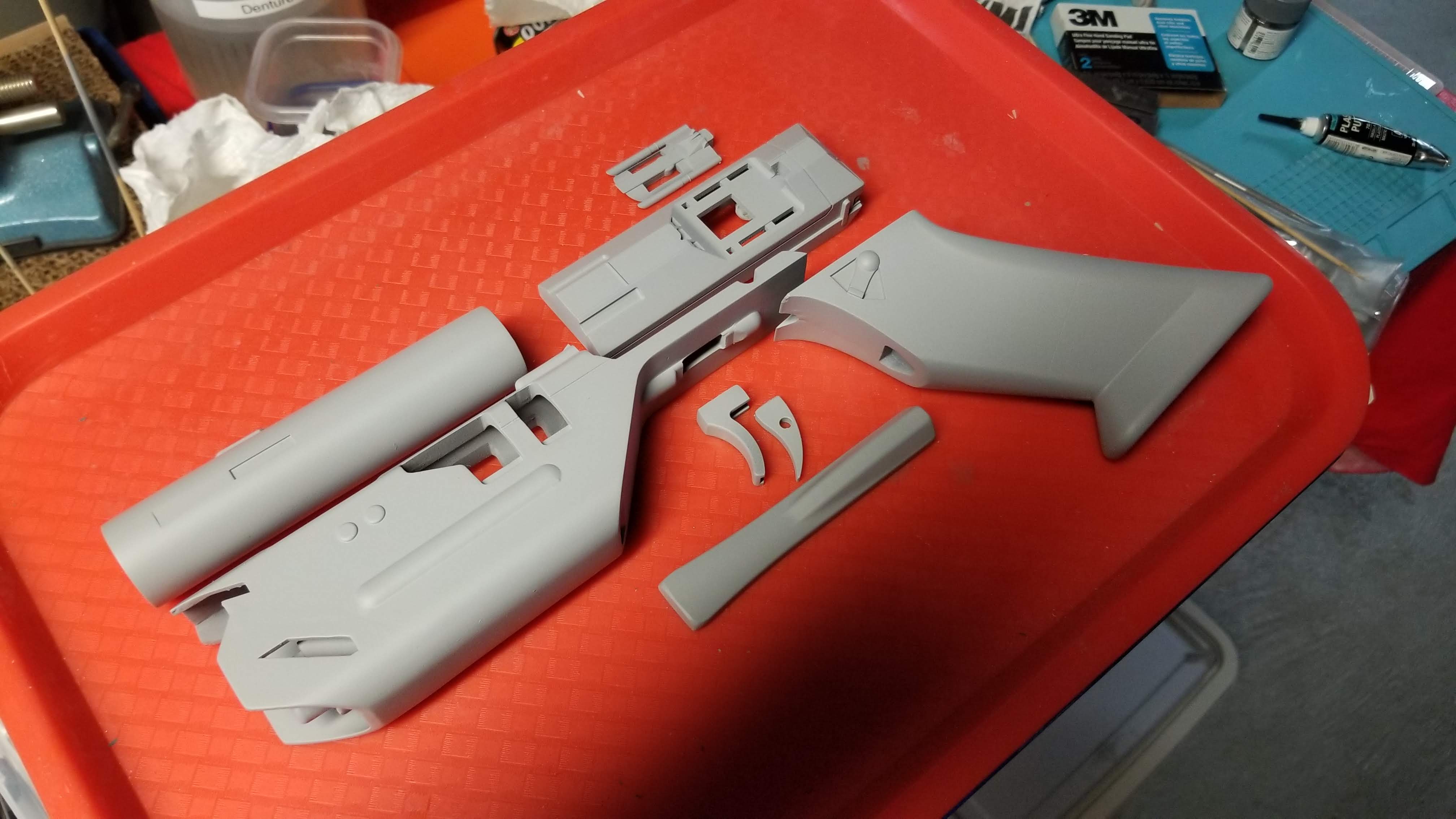

After the supports were removed and the parts cleaned there was still going to be a lot of fine sandpaper work to remove any blemishes.
It took me a few days of sanding but the effort was worth it. The finish was consistent and ready for a coating of primer.

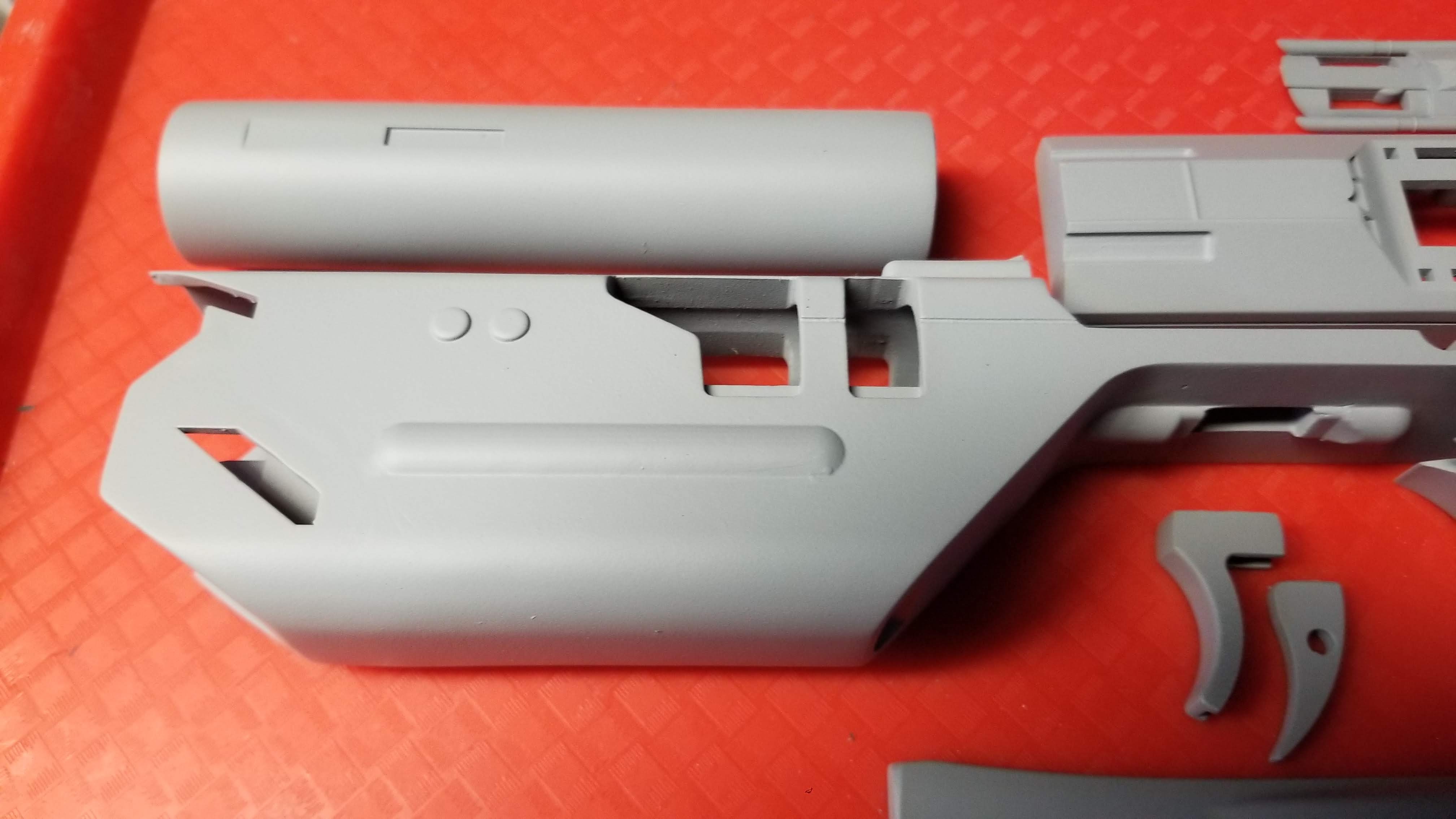

Paint primer showed any additional sanding work or if I needed to fill gaps or bubbles. I ended up doing this 3 times until it looked like was it was manufactured versus resin printed.

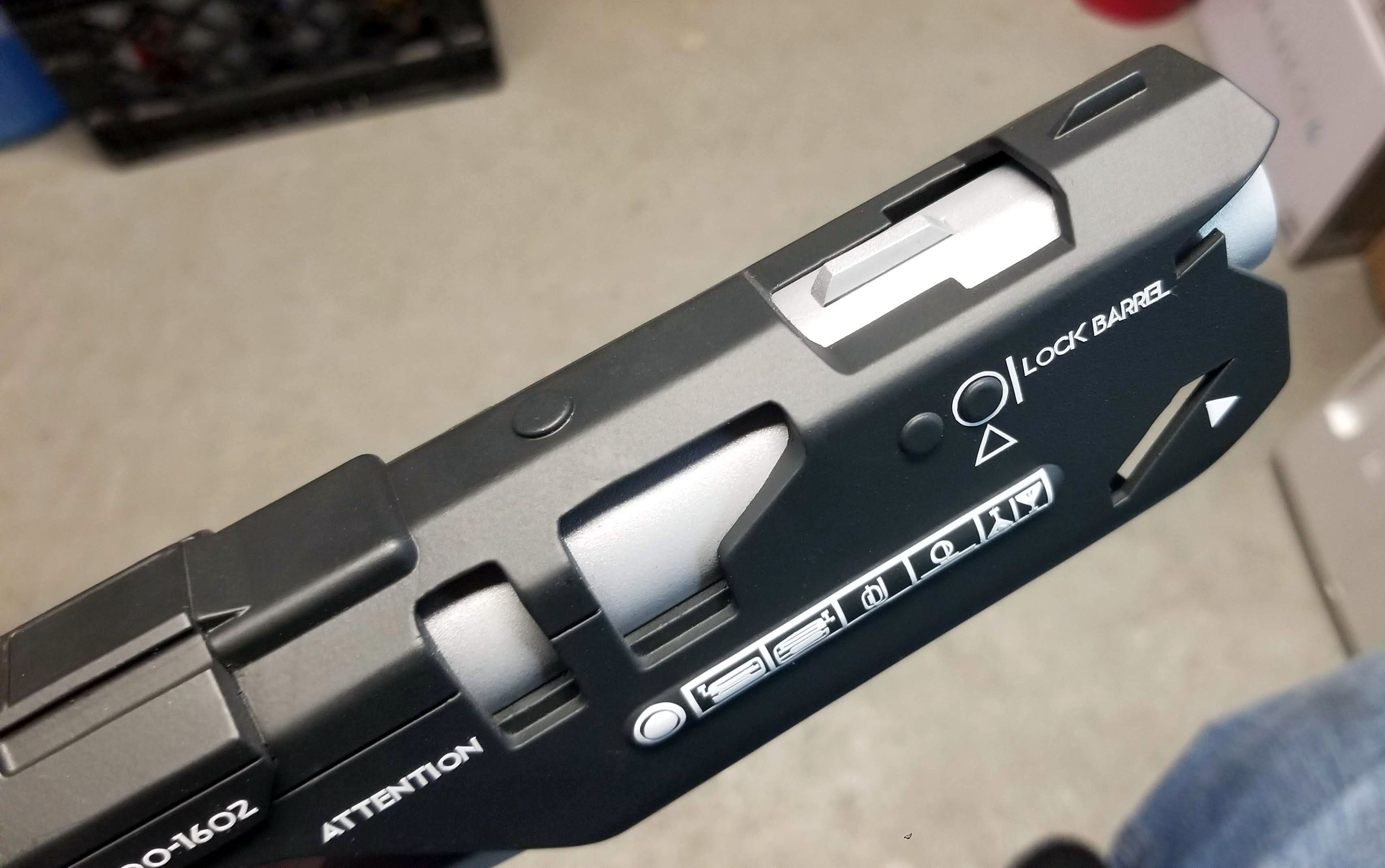

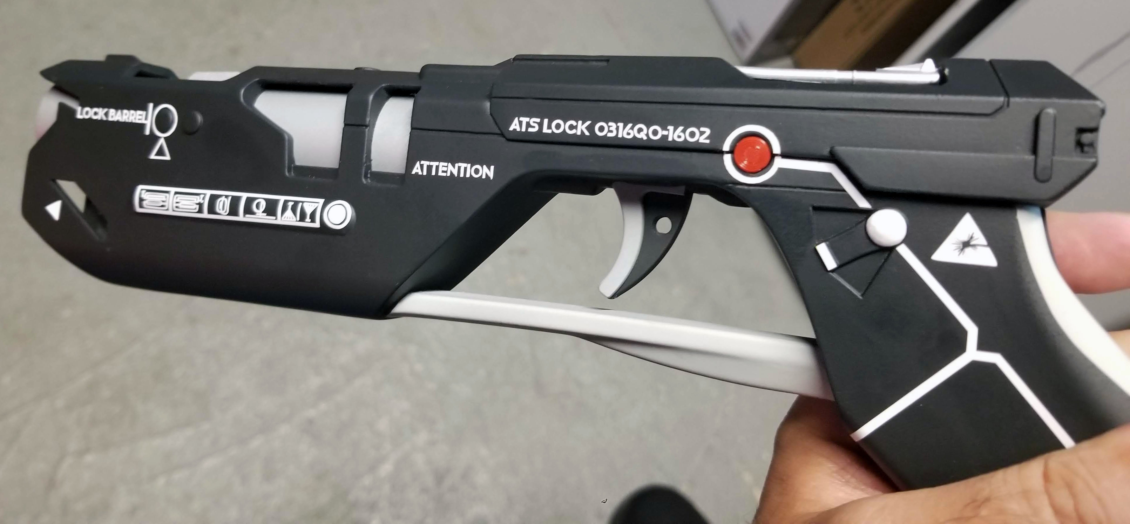

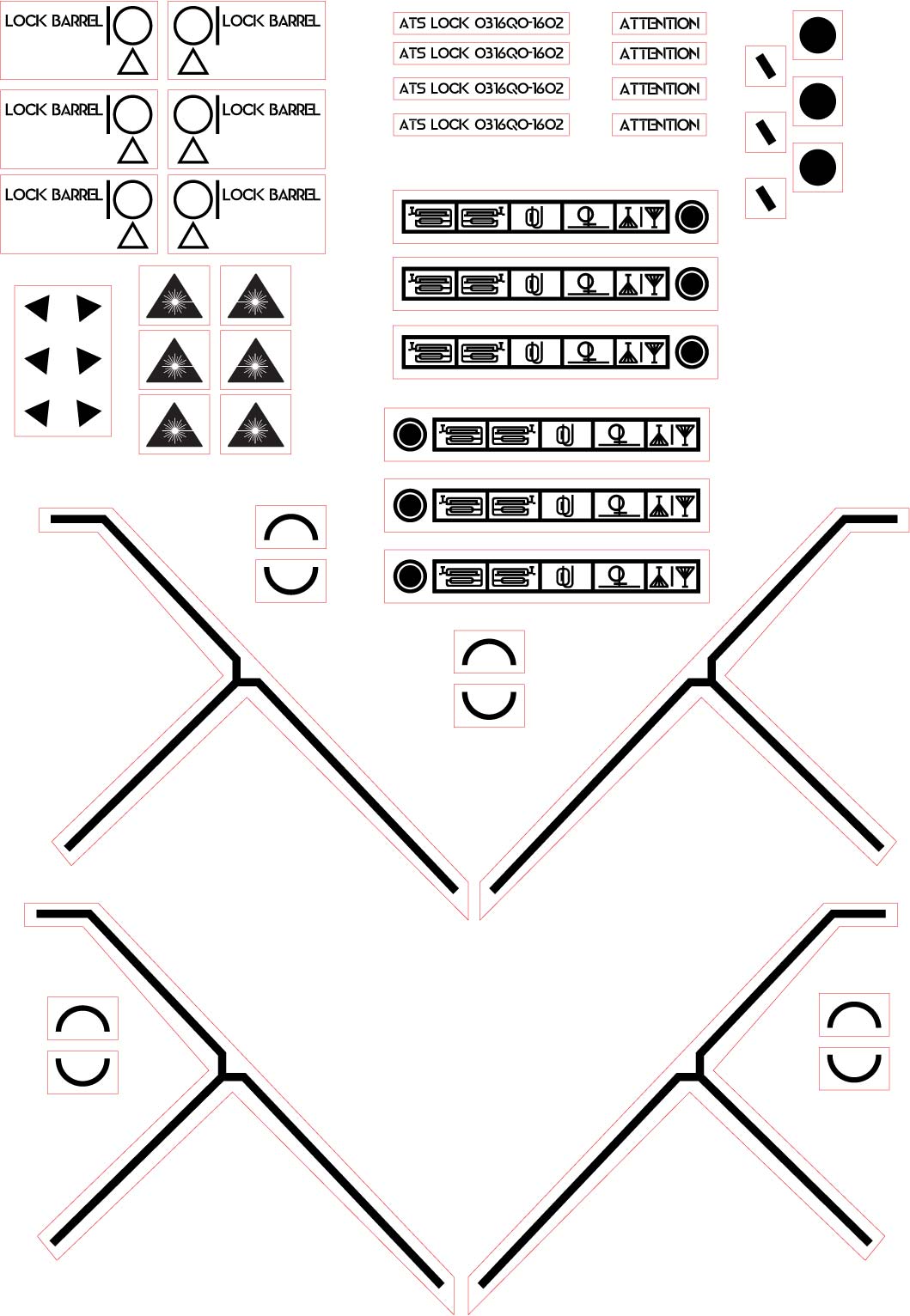

One of the things that was unique to other props I've made is that it has a bunch of text and other decals. I used as much reference images that I could find and recreated them in Adobe Illustrator. In the end, I had to make the text sizes a bit bigger (about +10%) because the font is so thin the Silhouette Cameo 4 vinyl/paper cutting machine that I got as a gift last Christmas was having problems cutting them. But, I was able to fit them in the appropriate places.

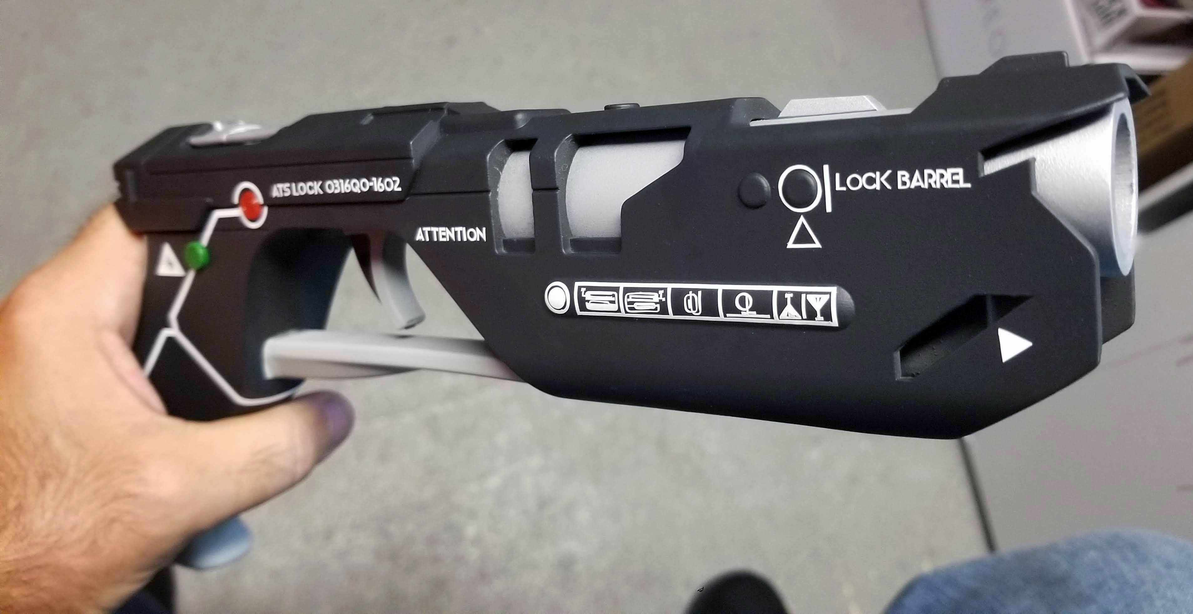

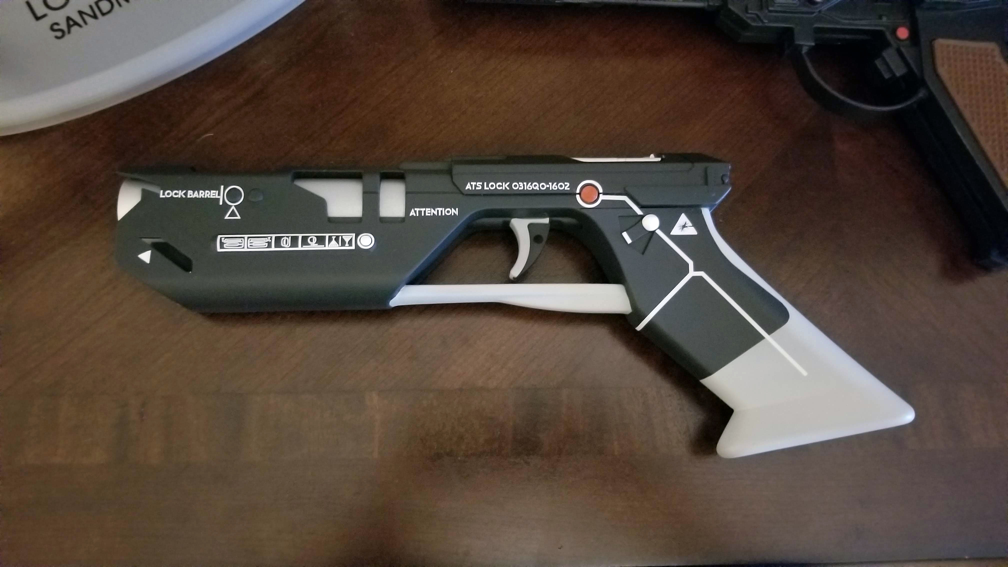

Here is the final version and I decided not to add any weathering because I liked the clean, just manufactured look.
