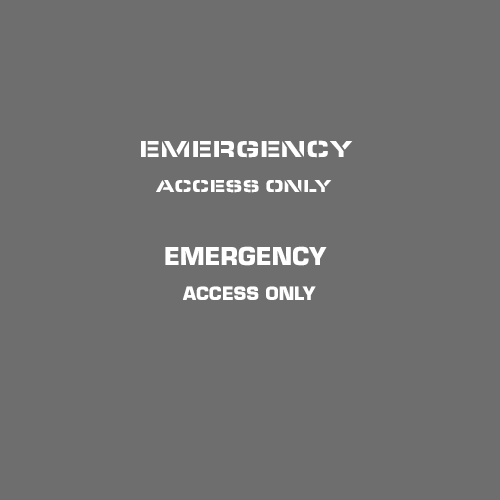

Can anybody please help me identify this font?
I first thought of the usual suspects Helvetica, Futura and Arial, but the G isn’t correct.
Also, I think it looks a bit like a stencil (some breaks in the letters) or, do you think it's because I've been staring at this grainy image for far too long and I'm seeing things which aren’t there?
Any help would be appreciated.

I think it's a stencil, but I can't be certain. There are definitely breaks in the letters, you can see it on the "N" "G" "S" and "C".

Is it perhaps Eurostyle stencil font? I know they used Eurostyle and the stencil version in Aliens (mainly on the airlock of the Sulaco) and other Sci-fi movies.
