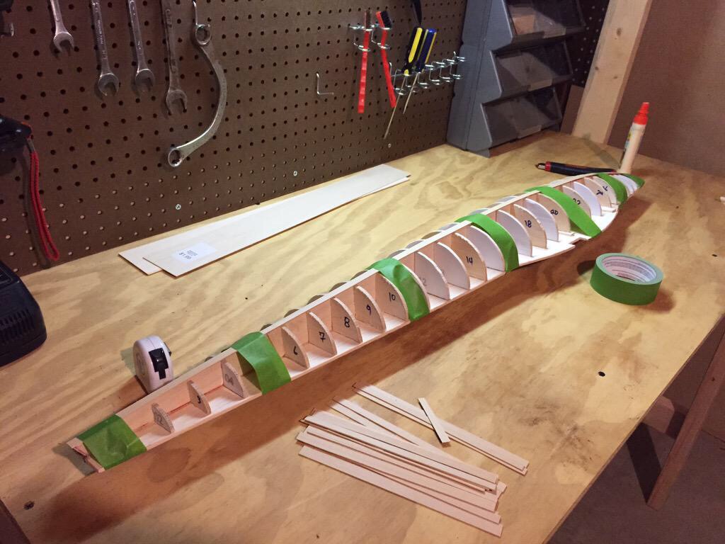

New to the forum but I figured I would have the most trouble shooting help here than anywhere else. Basically I'm building the Normandy SR 2 from Mass Effect and it's basically through trial and error. Due to its shear size it's built from wood and bondo. So if anyone here has any idea or pointers, all input is welcome.

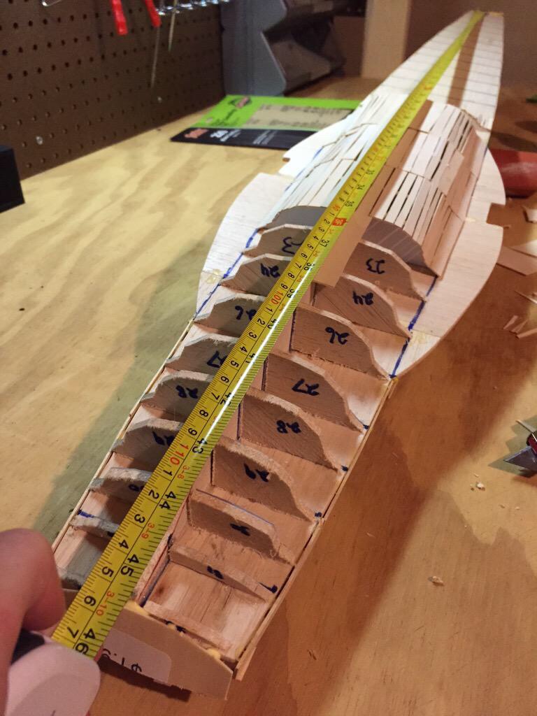

Only plans I'm working with mostly for measurement. (I'm posting from cell phone, so I know about print screen :p)
Give you an idea of size.

Cool design. Looking good. The only thing I can reccomend with the information you've given is to make sure you have the structure of the display in mind from the beginning, because the thing's going to weigh roughly a million pounds.
Is this a mold master or the final piece? Looks great so far. Glad to see someone else actually using Sketchup for a change. Love that program.
Are you filling the gaps between the formers with Bondo? I'd opt for spray foam and then a glazing coat of bond or Evercoat. Evercoat sands much easier btw.

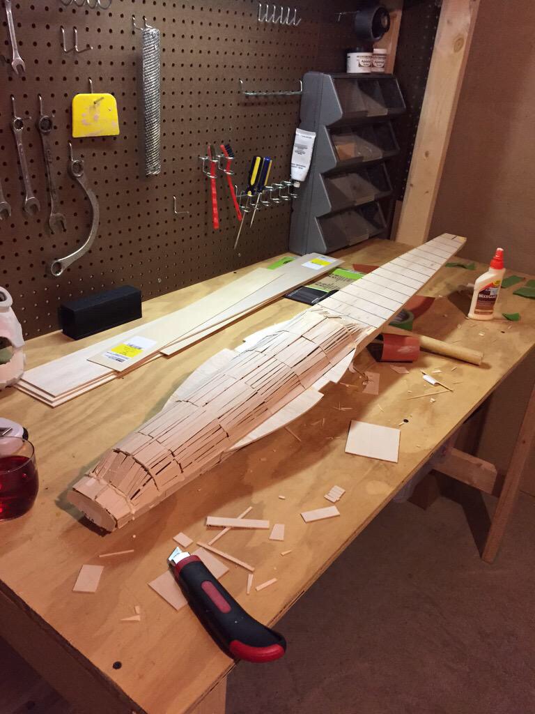

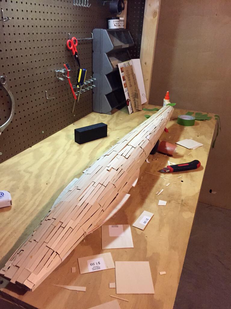

Final piece though I am debating.... But laziness will probably win out on me. Also, it's actually a body filler called "half time" it's a bit softer and easier to work with than bondo. Also, I didn't fill the gaps, I actually cut a buch of little "boards" out and covered the outer hull, like a boat, then covered that in bondo.
Talk about ugly before adding filler, I'm sure I could have made it nicer with a bit more patience.
