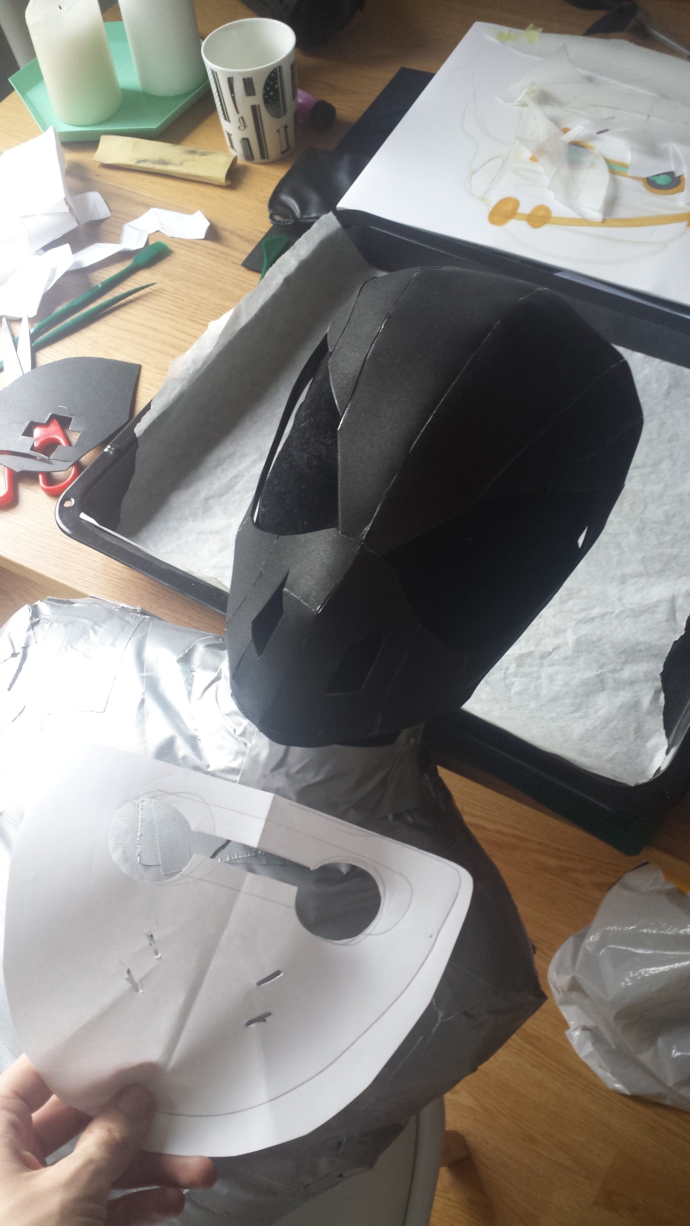

I started by drawing a pretty rough sketch, cutting it out, and testing to see if it had a good fit to the hole for my eyes.
I made some alterations, and got a size and shape i was happy with. Lastly, i did a check to see if i could actually see anytihing, and cut out the lens section of the goggle. The vision was good, and i could go ahead and do a final version that would serve as a template for later.
