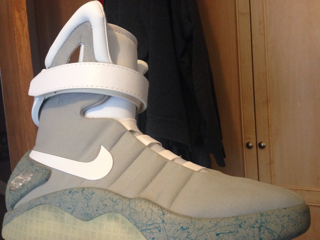

My display pair have a switch in the white coller ( that was a pain to do ) as tried to get them as movie accurate as poss
NIKE placed the switch in the cuff for the 2011 release. No where in the film does it suggest that the switch is there for the movie shoe. It is debatable if the lights and power laces are activated when he pulls the on the collar or because his foot applies pressure to the sole.
I've got an idea for a "switch" in the strap that only completes the circuit when the strap is done up. Lights turn off as soon the strap is un-done.
Yep I agree that's not in the movie , when I say movie accurate that's a pinch of salt and more nikes version which is kinda more movie accurate , Id love it if you put your foot in and hey presto all done up and lights on but it's the cost I would think , with the strap it's possible , when you strap it down it makes a connection and lights come on , then would be next best thing

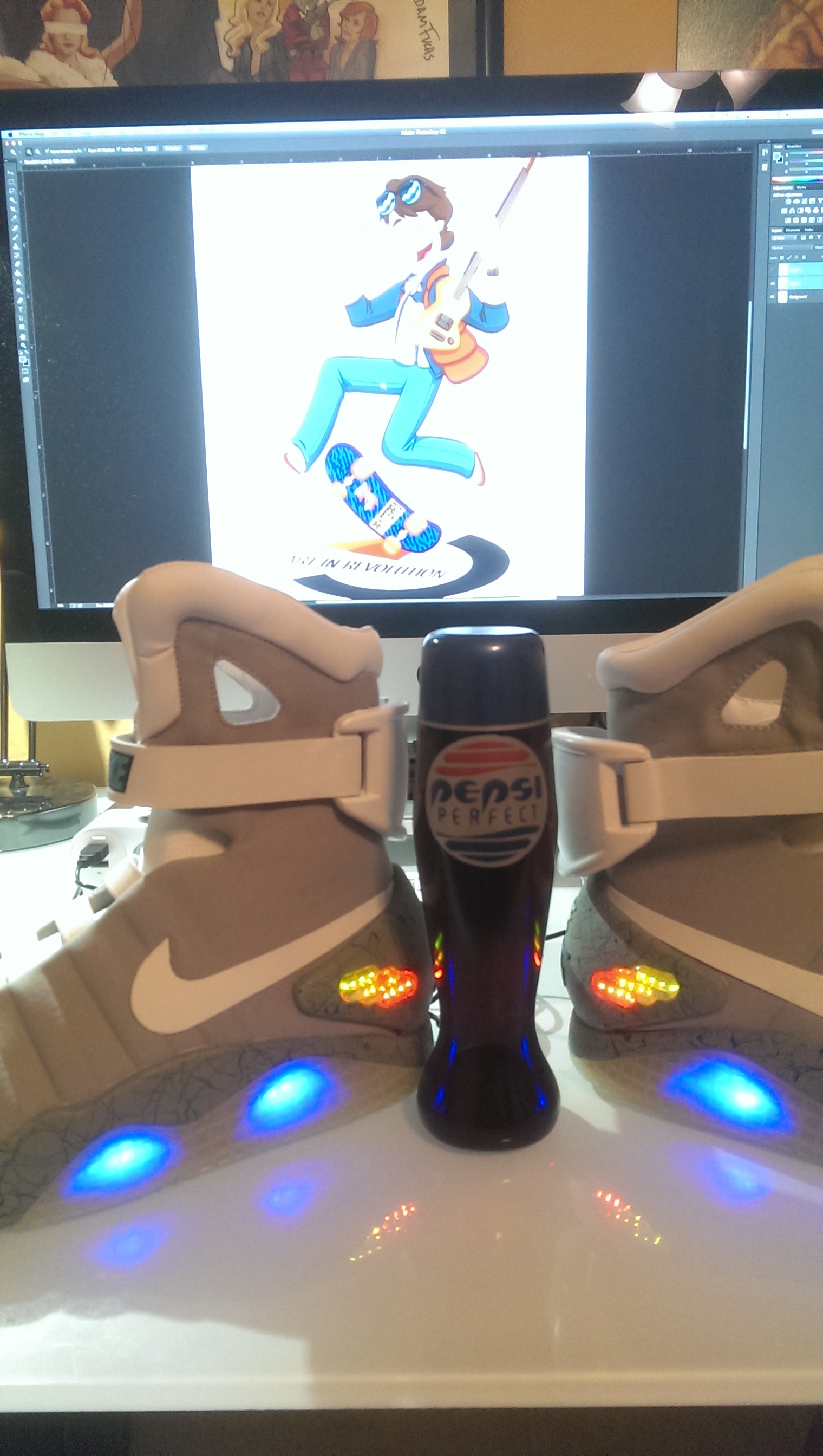

I'm not much of a modder (not yet anyway, I might look to mod my V2's soon), but at the moment, when they are plugged in (on charge), all the lights are fine, but when they run off the batteries, the blue sole lights on one of the shoes flash on and dim nearly straight away. They are fairly new, haven't been worn and haven't been switched on much at all. Is this just a case of dodgy batteries? Cheers.
It's a case of dodgy electrics from china , so it's either stick with them or totally gut them and do you Own , some only mod when the electrics start to go , normally 3 choices have flickering lights , no lights or start modding :0)

Hey there guys. I wanted to chime in with an update. My Mags arrived today! It took a month from Feb. 26th to March 28th to get them to the US via Karin Chen. Slow going. I wanted them for MegaCon last weekend, but better late than never.
So I have a few questions and a few notes for anyone looking to order through Karin. First off the box they arrived in is totaled. Not a big deal to me, but so much for having a good place to store them. The shoes themselves look pretty good. However, the biggest issues are 3 of the 4 yellow LEDs are firing on the left shoe, and the toe cap has some heavy grit on it. I'm not sure if I should try some soap and warm water on it, because I don't want to discolor the grey fabric. I still have an active "purchase protection" available on the shoes themselves, is it worth opening a dispute to try and have a new pair shipped to me? I didn't know if anyone here had dealt with getting a new pair sent over. Lastly, how long do you charge the shoes for? and how long should I expect the lights to go before needing recharging?
Thanks and any feedback would be most welcome.
Sounds like my second pair. Karin gave me 5% off my third pair as compensation. 1st and 3rd pairs were awesome, especially the 3rd which even came packed in plastic bags. You should get between 2 and 5 hours from the lights. And sometimes one goes out before the other and one reason many mod these.
