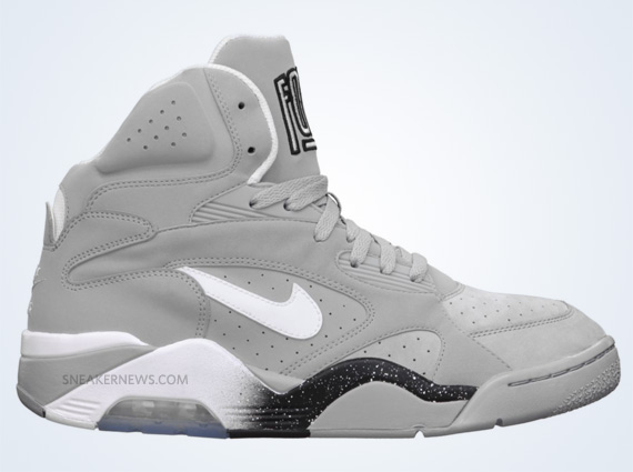

in the meantime i think i may start my modification of my pair of air force 180's .... they already have a "mag esq" style to them,, im thinking repaint the sole/midsole and somehow get to the air bubble and fit either EL or LED for a nice little custom job? :p
Just be careful you don't pop the air bubble when you mod them, I had air 180s when they first came out and man they felt weird when one went flat.

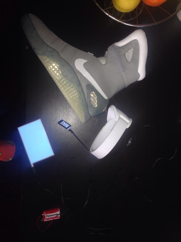

I really wanna get the EL strip or whatever i need to make the NIKE part light up... i know the shopping list helps but can someone point me in the right direction? or does anyone sell what i need?

elwirecrafts el sheets are crap.
i made the mistake once of buying a sheet. For some reason their el sheet has a massive gap between the edge of the sheet to where the light begins.
it means it's useless for the el sole cut outs and the straps. As the connection points are already hard wired, you are going to find it impossible to fit the el cutout in the strap area and glue it down properly. Same with the sole cut outs.
From your pic it looks like you have the exact same one I had. I just threw mine in the bin because of how crap it was.
the el sheet was overpriced too. The ones straight from Hong Kong are superior. You can properly cutout the correct shapes and solder your own connections.
also elwirecraft doesn't sell any thin inverters either, only the huge square ones.
absolute crap el sheets from my experience. Totally useless for what is required on these shoes where you don't have much space available.
also you can't connect everything using those el connector cables as they are too thick to be under feet, so unless you want to do it incorrectly like Robertx who placed everything in the tongue of the shoe, you will definitely need better el sheets in my opinion.
I know what you mean bout the inverter but I've since changed it for a tiny one runs a watch battery and have it behind buckle , which has the switch built into it as well , the sheets where fine ( I did slightly trim the edges ) both for my wear pair and display pair , the only thing I changed bout the el sheets was the colour , as I decided on blue for my wear pair as it went better with my normal clothes lol , as the aqua looks awesome on display
I made new straps to incorporate the wires , they run double around front so I slightly cut a grove out , and ran the wires round , my display pair has all that original wires as they are just display , my wear pair only has one wire under foot for el sheets in sole but goes under a thicker sole, I had to shorten the wires as they do come quite long , and have them tucked in the side in a pocket .
the coin cell inverter battery won't last that long once you have your LEDs running as we'll as a coin cell hasn't got much mAh to last that long.
you may have to change the coin cell much more often than a standard battery. In fact I think you will be lucky to get more than an hour off a coin cell which is powering the el strap and el sole cut outs and the 12 LEDs.
if you are using the coin cell 3v inverter it means you may have to remove the flashing bit of the functionality if you just want on and off.
the single coin cell inverter usually has on/ flashing/off.
I have several pairs running off 3v using 2 x aaa batteries (either 1.5v or 1.2v Nimh). They last very long as the 1.2v Nimh batteries have a high mAh of 800 to 1000.
