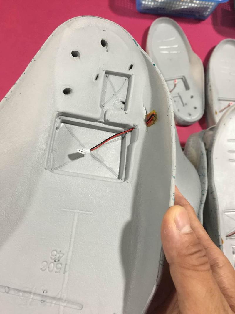

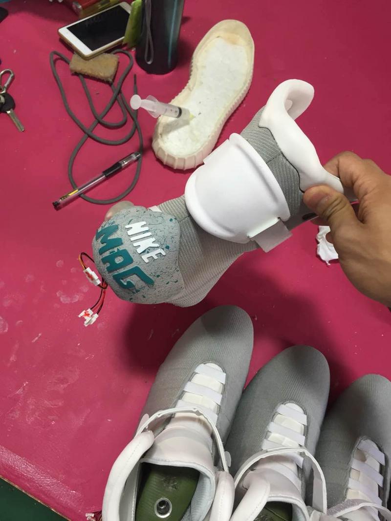

Here's what David had to say about the battery/electronics
Here are pics of the battery compartment:
He seemed to think it was not a matter of resistors limiting the EL panels' brightness, but rather the makeup of the battery itself.
The specs he quoted were "4.2V" and "2A". I'm not sure what the 2A pertains to and some online research revealed that that usually refers to a battery charger. But he insisted that was what the battery itself said.
4.2V at 2amp = 8.4W. A 9V battery is what is needed to make these shine. It has a lot to do with area of the EL and how much voltage/amperage it is getting.

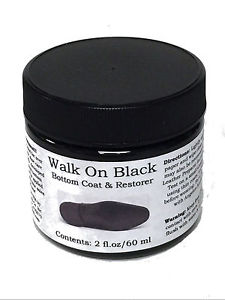

The swoosh is bigger because i handmade the vectors to get them lasercut and i felt like it looked a bit better with a bigger swoosh.
The black paint on the sole is this one from angelus :
You will never see any crack with this paint because it is specially made to cover the soles.
I wore them for more than 50 complete days and the splatters and paint are still going on very well, i have washed them for more than 10 times.
