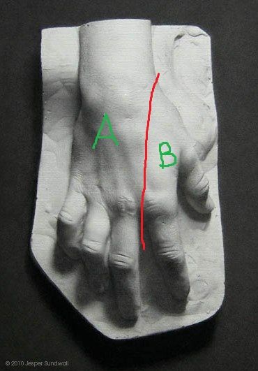

I haven't ventured into glove making yet but to me it seems like making the the thumb and forefinger removable from your plaster hand caste then after you mold the glove you can take your plaster hand out in two piece you wont need to add any zippers or spirit gum to hide any seams cause you wont have one.
the red line being where the two parts are split then removing part A then B. Makes sense to me but then again i've never done it so............:confused
If your going for the three finger scenario then you probably only need to thumb to come off
