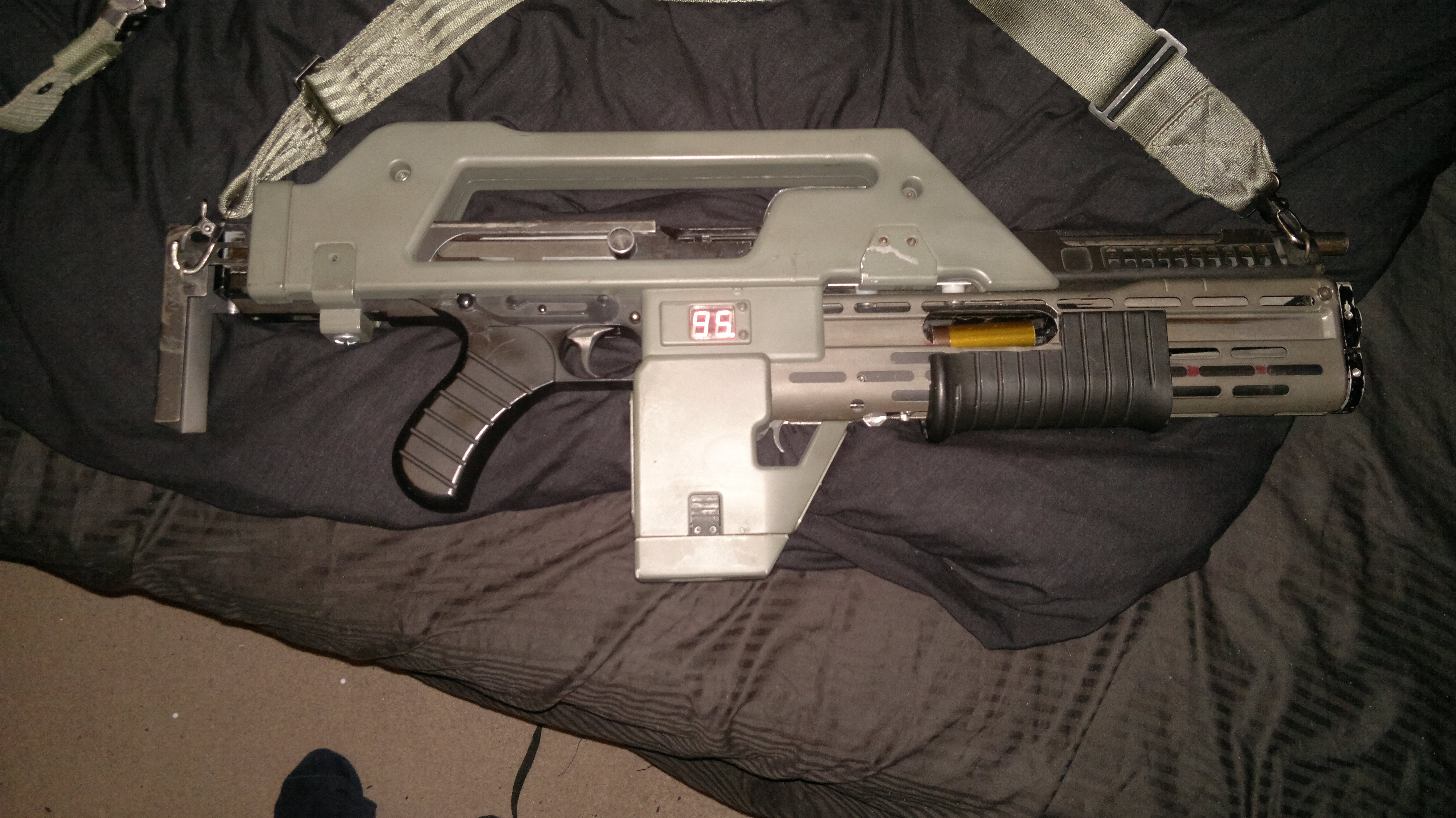

Here's my handy work

about 600 rounds per battery including running the counter but considering they are less than $5.00 each not a big deal. my only problem now is figuring out how to count the shots now as there is no room for the light gate. was thinking of some mechanical switch to count piston strokes.

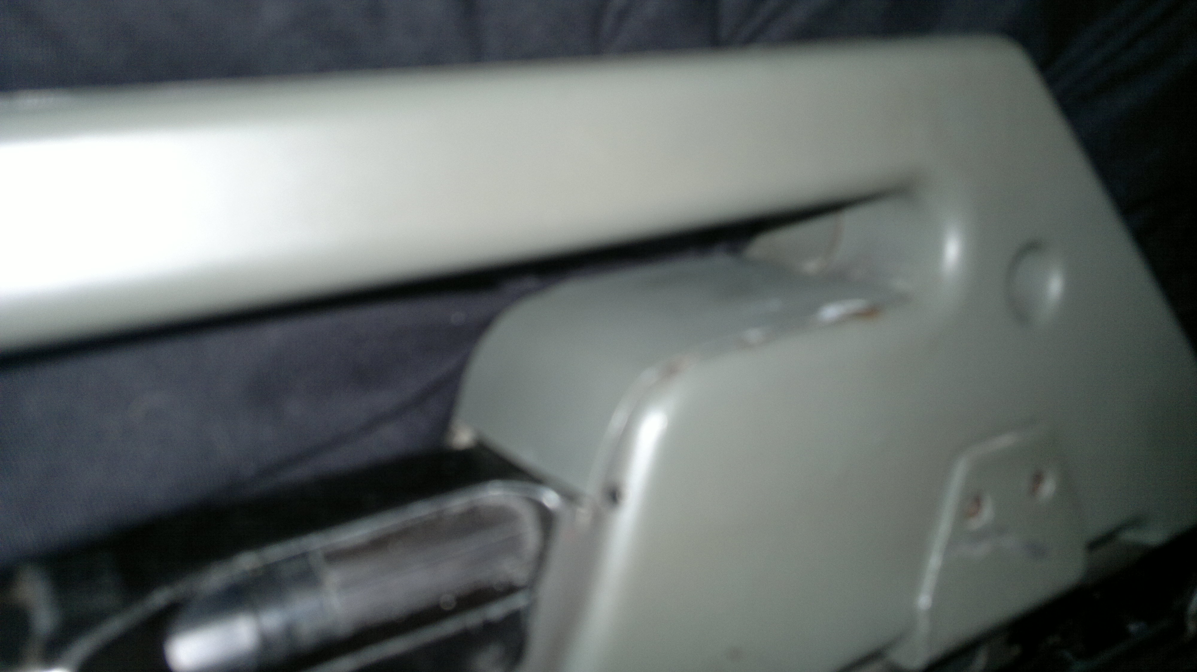

Here's an old pict of my rifle with the front shroud plate.
Could be a good access point for lipo battery cable.
