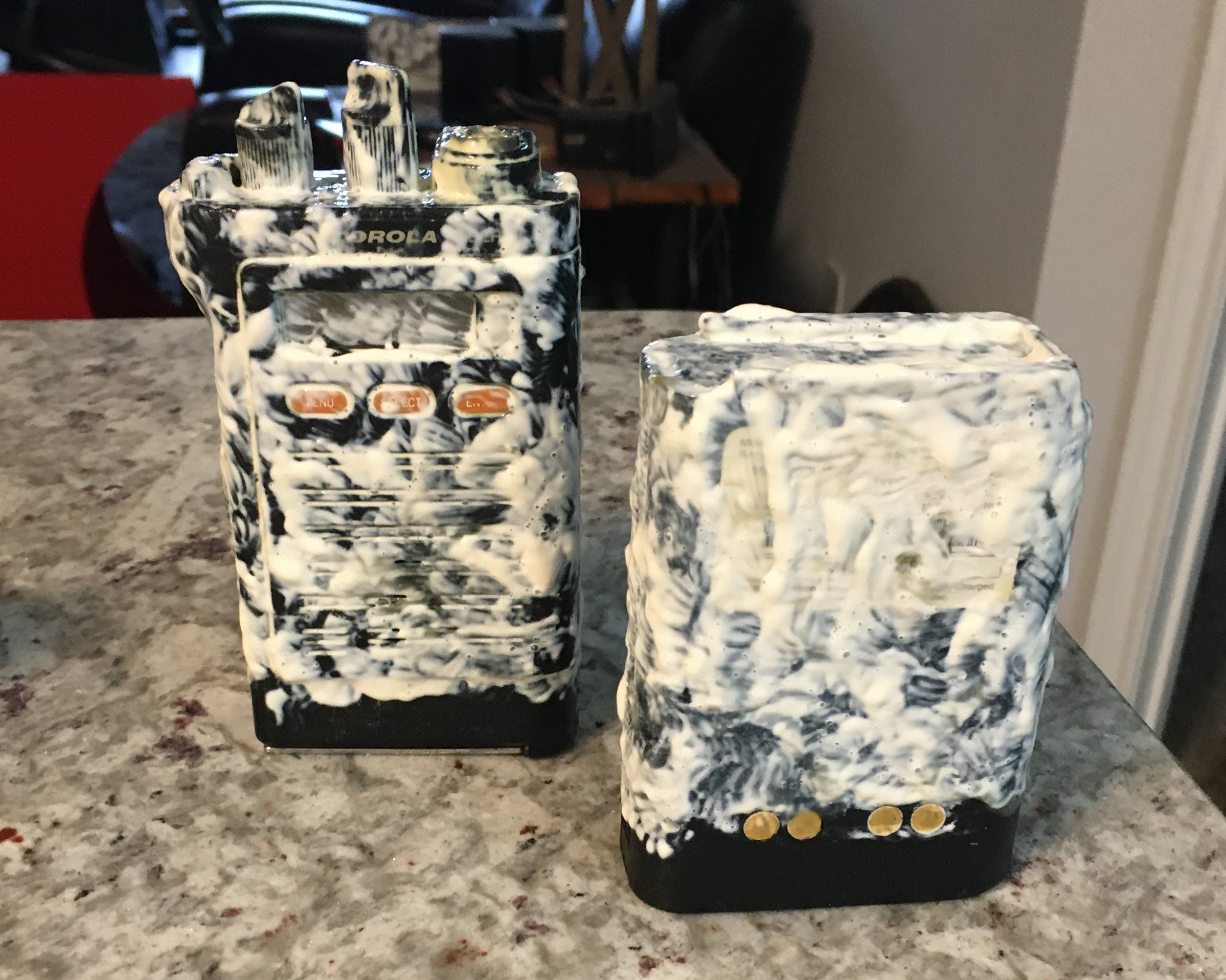

This is the Motorola Saber 2.
I've learned from an expert (perhaps a member) who built an AMAZING Explorer replica, that there were MANY variations even within the "2" model.
This was an eBay find for about $120.00, and is damn close to the correct model.
Mine has an additional "encryption node" between the radio proper and the battery (again - learned from the 'expert').
And the battery is too long.
Making the overall radio too tall.
Hence the molding...
I am molding the two components separately so that I can easily cast and / or cut the finished pieces to the proper length.
Not certain at this point if I will hollow-cast the radio and add a 9v battery and lights.

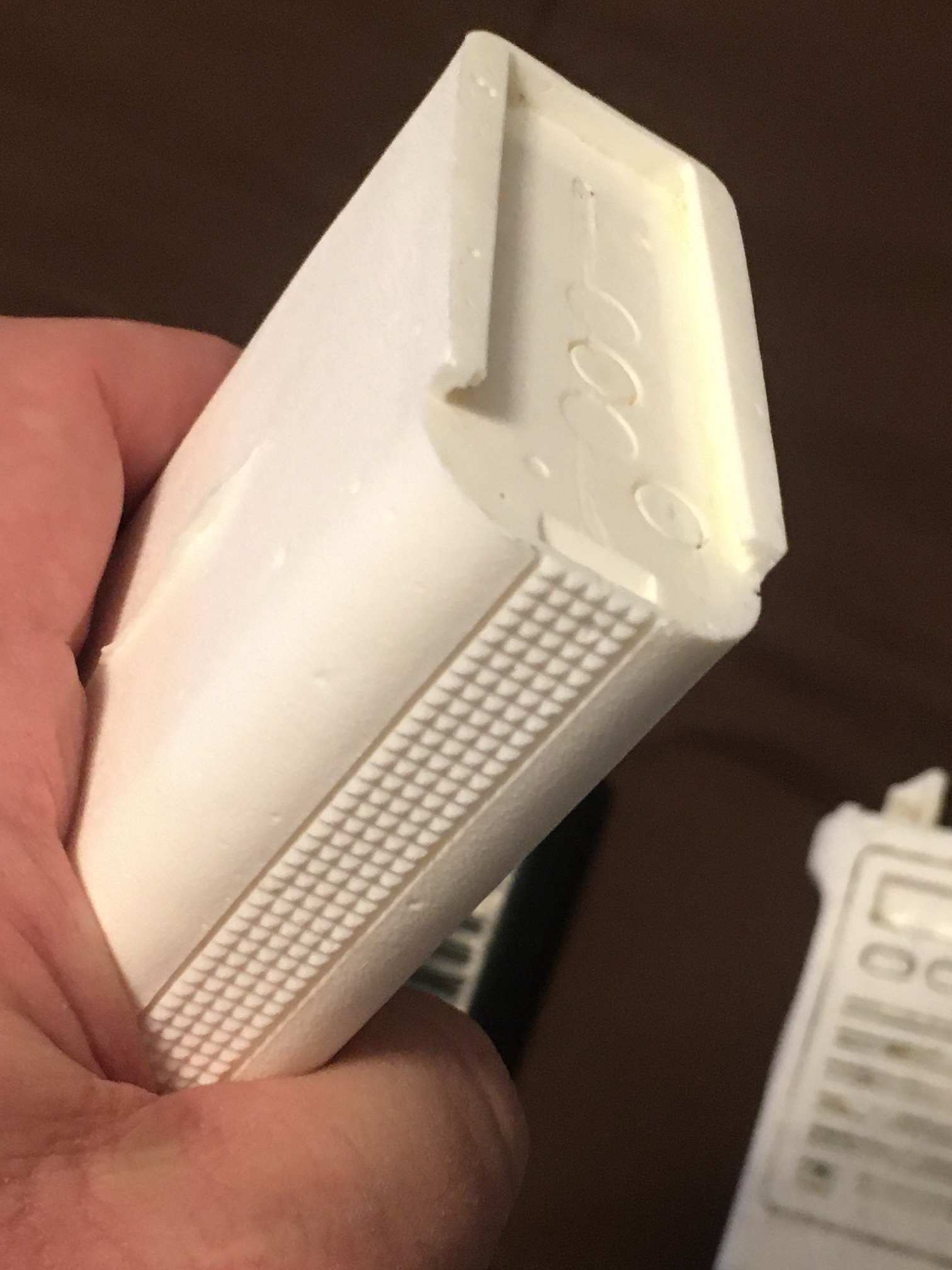

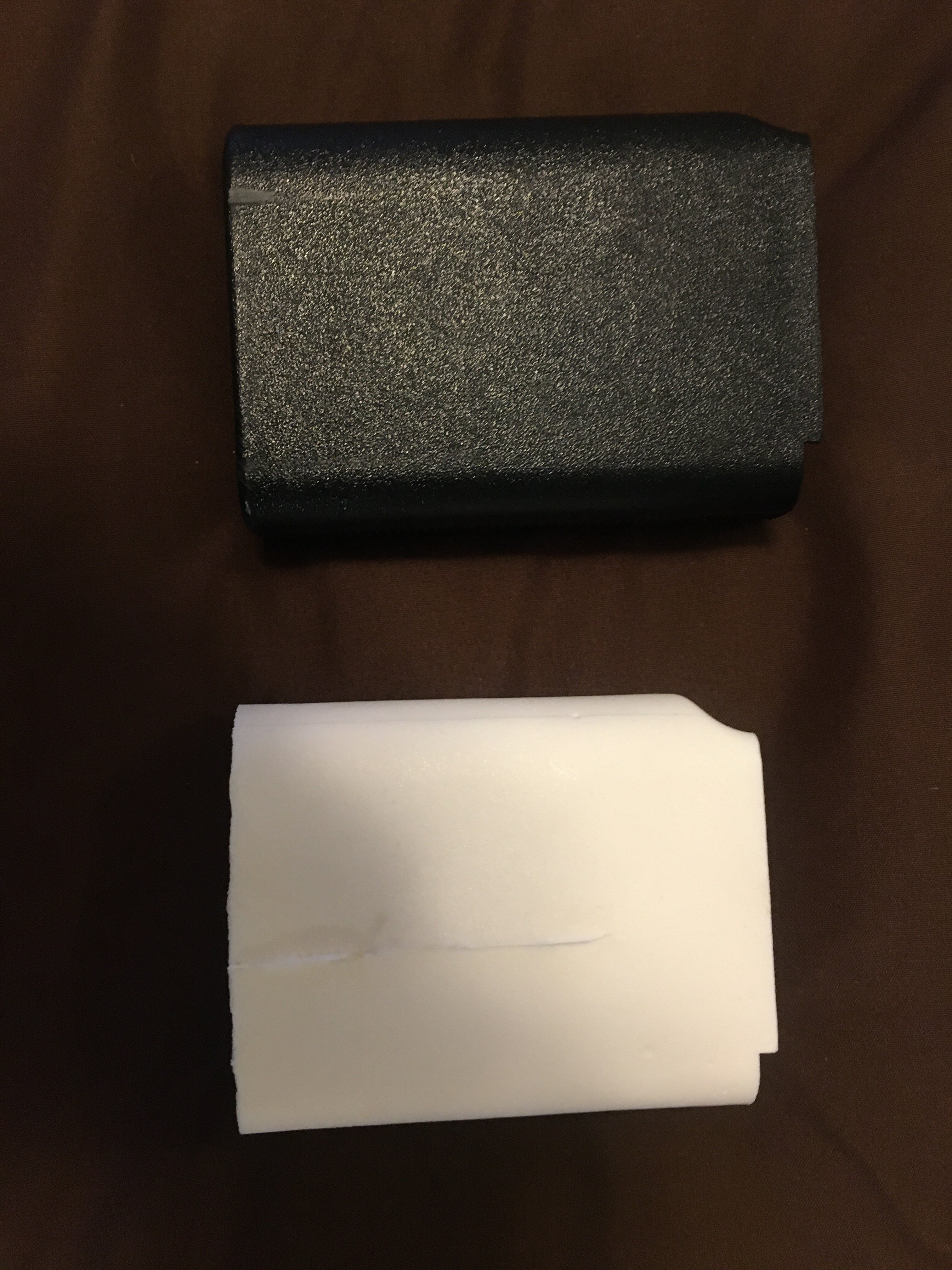

Finally made my casts...
The upper half (the radio proper) had some swell at the opening of the mold, but this cast will be cut down immediately below the grill, so I am hopeful the swell will be mostly or entirely cut off.
Am going to take a mold / cast of the other half of the battery connection so that - though resin - it may function (slide into each other).
Like the radio, the battery pack needs to be shortened as well.
Initial thought was to cut off the bottom (which currently is the rough "pour surface" of the cast) and sand / sculpt the cut surface to shape.
An alternative would be to take a mold / cast of the true bottom of the battery pack, and seam the two halves of the overall pack cast somewhere in the middle.

Right now I'm having a bit of an issue getting a good cast, as the resin "swelled" a bit in the mold, making the cross-section a bit more oval.
Cjfedler
Not a run, per se...
But if I can get my casting "dialed in", I can probably pour a couple more.
You may have better luck if you add a frame or box around the most to help prevent flexing, but i've never tried a latex mold so i could be entirely wrong on that
