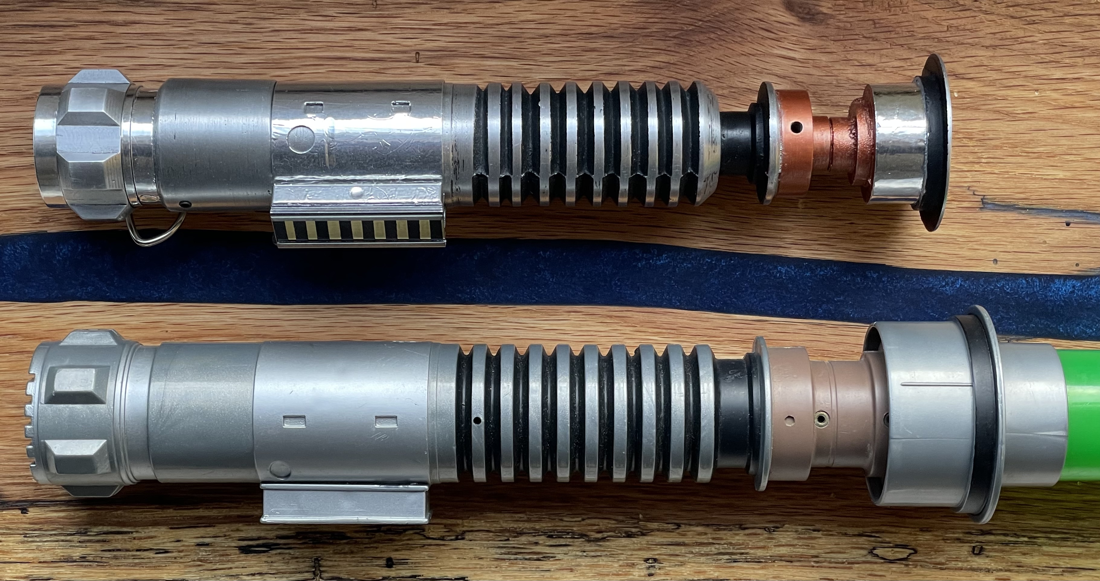

I’d be interested! Though I have been chipping away at one of your early models for mine! Made a steel core for it too :) But this will be a nice accurate version as well! Count me in!
