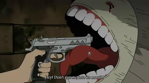

I'm about to have a bash, at painting, a pair of HFC HA 118 Beretta 92fs spring BB guns for my daughter. Specifically Basing them on the Berettas sported by Death the Kid from the Soul Eater Anime Series.
Being Based in the UK the first problem that pops up is I shouldn't really be respraying them.......... Oh dear.... Well they are going in a presentation case once finished and wont be being brandished at any CONS, Banks, corner shops or anywhere in public. The other slight side step is the change in colour I'm going for. Presumably 'real world' would see the guns in silver. But I'm going to paint up in the anime colours, so, at least two shades of grey and one charcoal/black with ivory for the 'eye' detail.
The serrations in the slide will be filled, where the 'eye' detail goes. I will also be cutting/carving the teeth/triangles into the slide as well once I've added a little thickener internally. As well as adding the death head symbol to the grip. There are a few mold lines to be wet n dried out but nothing major and over all the build of the guns is pretty nice.
I've had one of the guns in pieces so painting should be easy. The only parts I couldn't remove were the trigger and the hammer mechanism. I wasn't sure if they were secured by drift pins and didn't want to risk damaging anything trying to find out.
The only other 'artsy' thing I may try is a DIY transfer of Liz and Patty done in a translucent print so they can only just be seen when in situ on each gun.
Here's a couple of images.

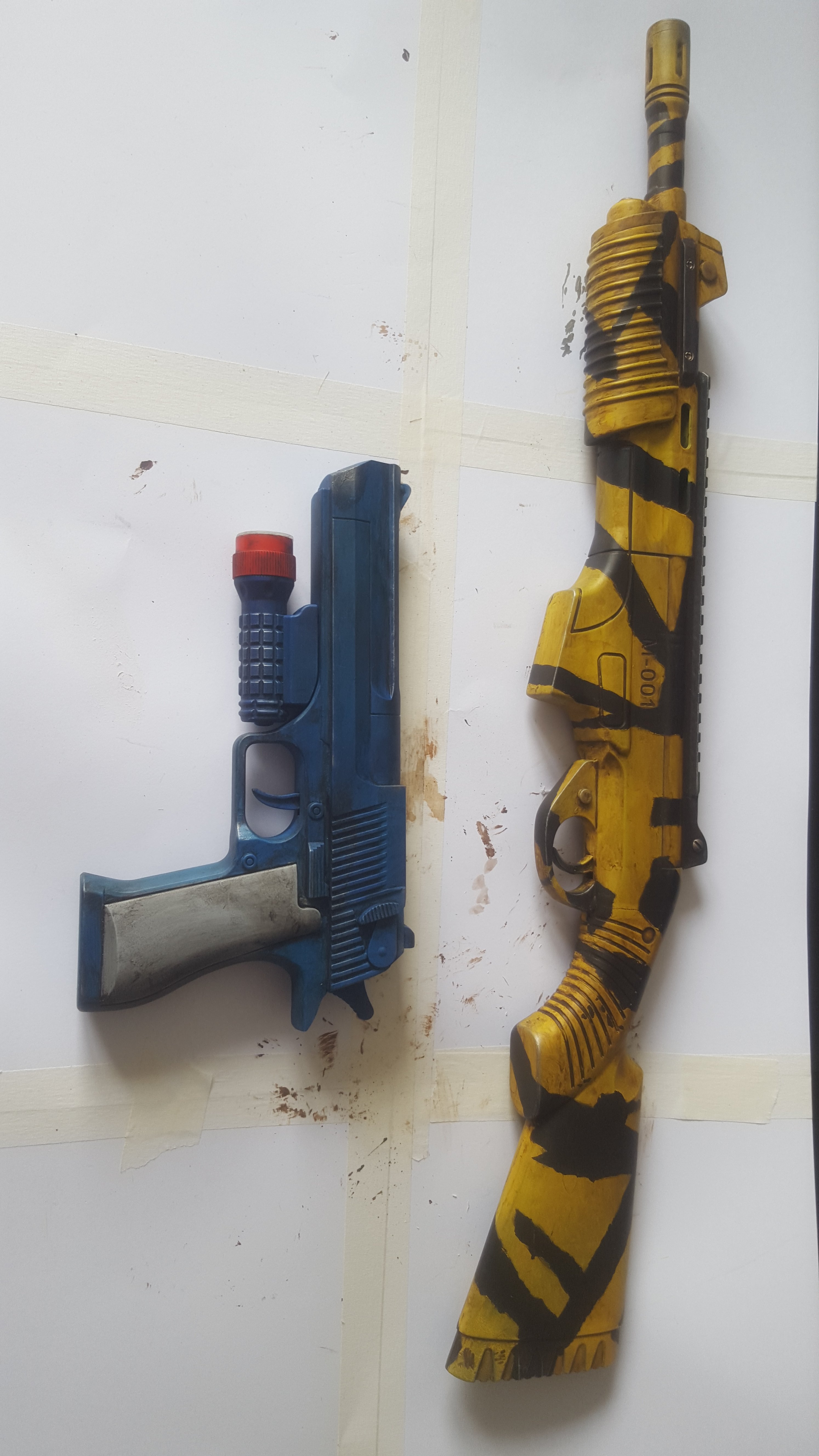

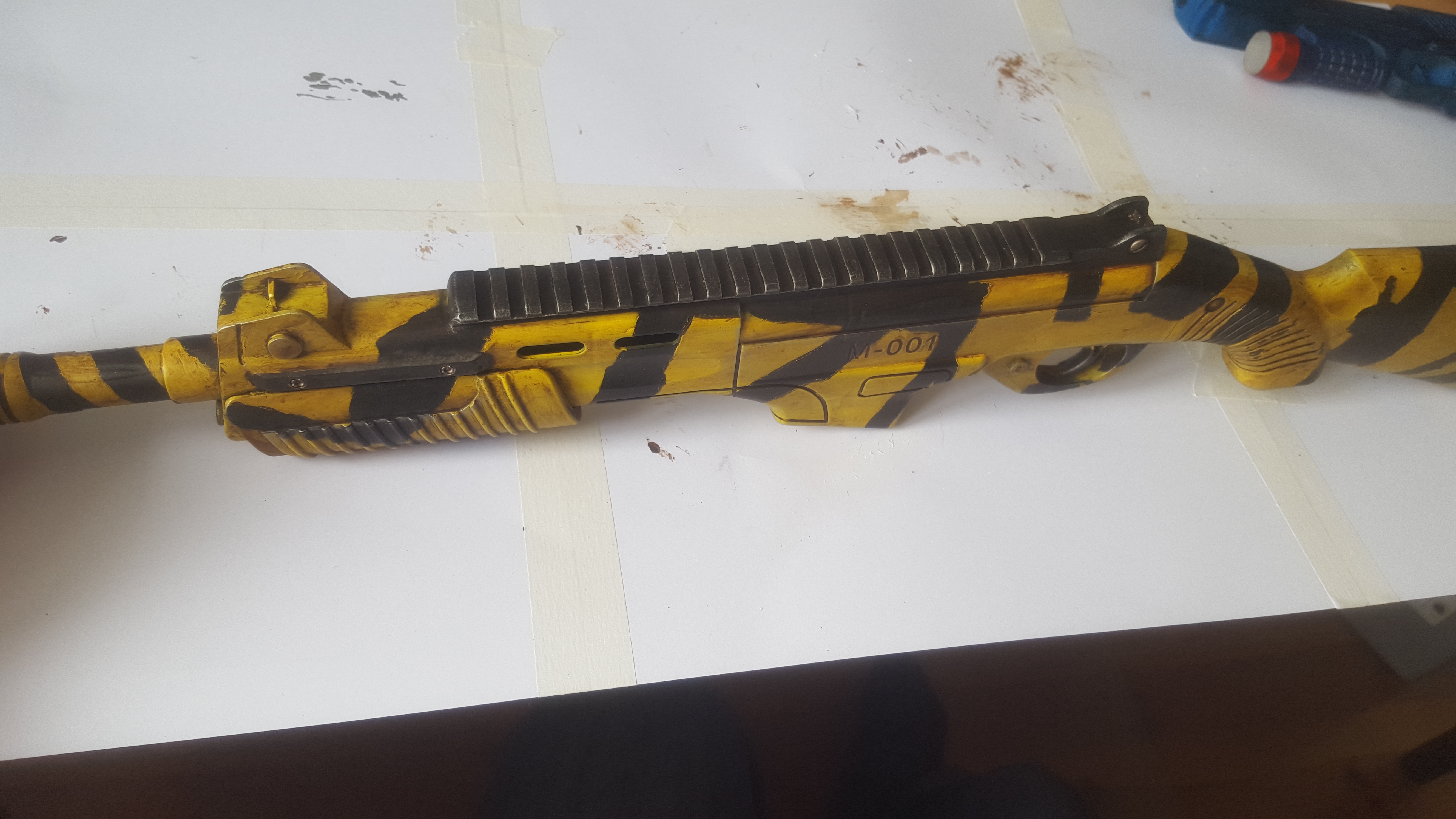

Not nerf guns, but i did a custum paint job on these for my upcomming 'the division' cosplay.
The paint job resembles the skins you can put on your guns.
These are my first steps in props and cosplay, so any feedback is welcome.

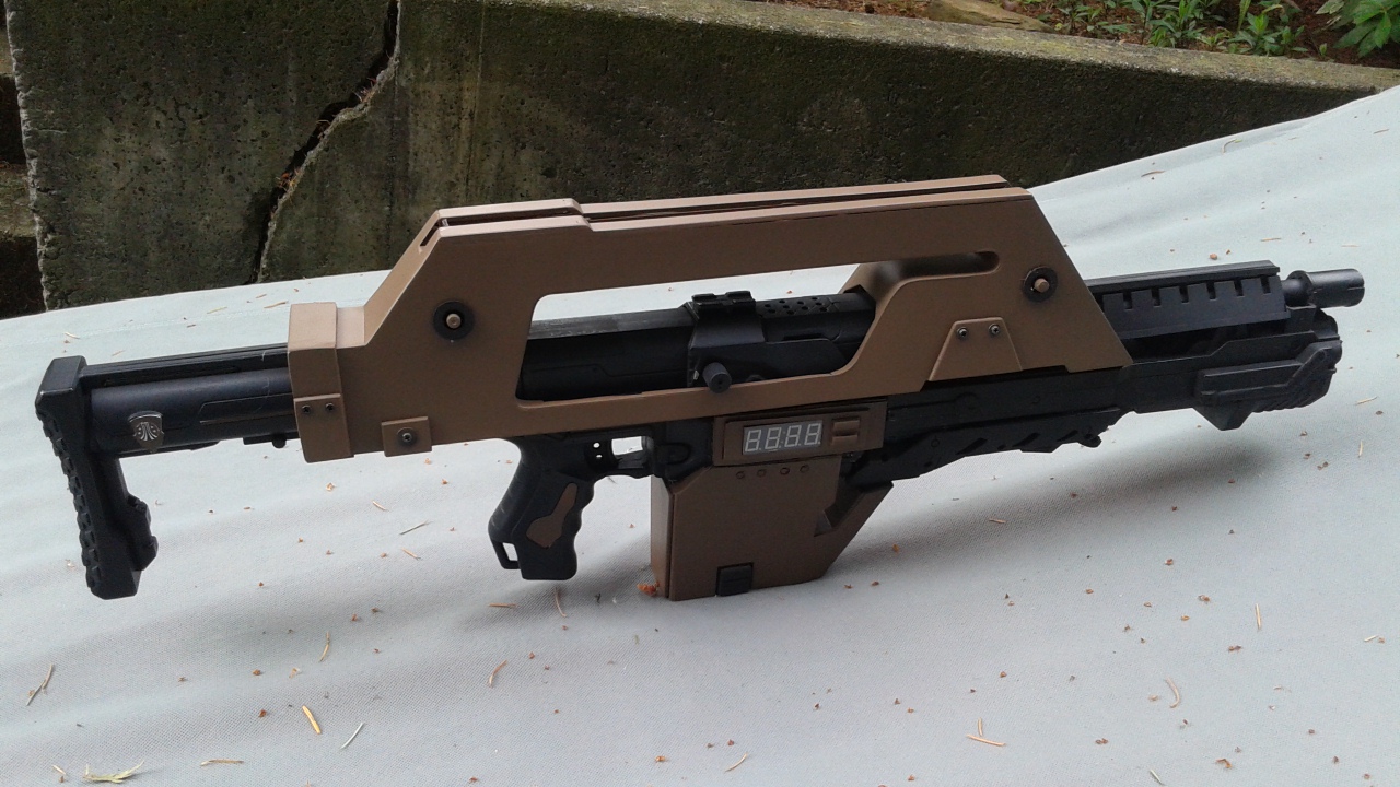

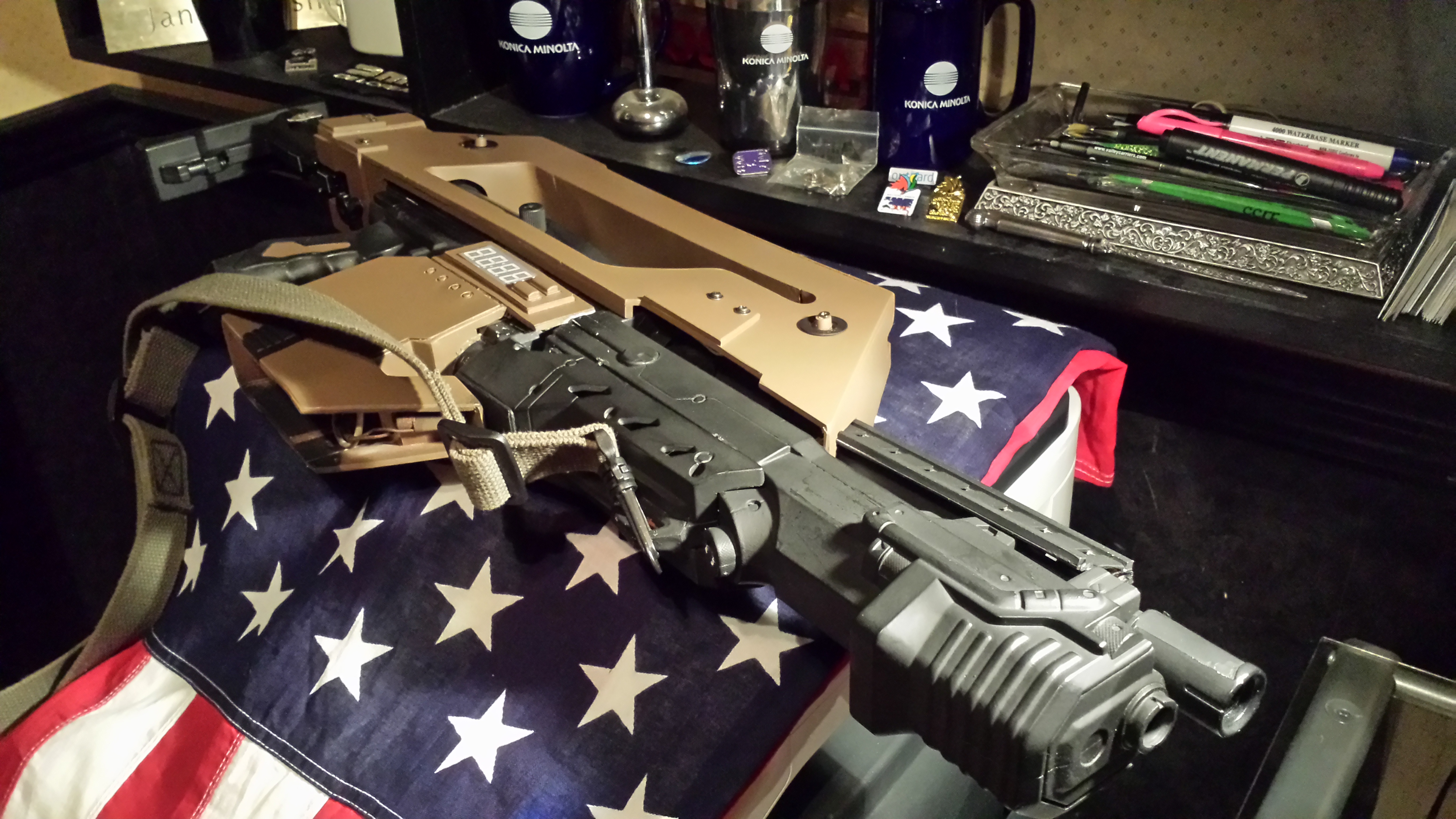

Any write-up or suggestions, appreciated. I just finished my M41 Nerf Pulse. magazine and main off/on switch still to be added for the 4-digit counter :) could not source a 2-digit one and it will only count-down with single press with button, kinda sucks.

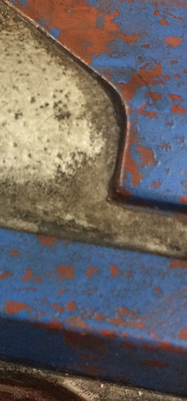

There are as many techniques for prop painting as there are threads on the RPF, but the most common one is to start with the darker colour, and then drybrush a lighter shade over the top, then highlight random edges with silver to simulate paint-chipping. Most metal parts are as simple as a matte black base-coat with a liberal amount of dry brushed silver on top.
If you want, you can then go in with a bit of thinned-down black or dark brown that'll creep into all of the cracks and crevices to give it a little more of a well-used look. Use a rag or similar to wipe away excess if it gets a bit too heavy. I find that spirit-based acrylic is great for this, as it won't disturb the enamel paint underneath (assuming you use enamel for the base/top coats...).
If you wanted to get a little more complicated, you can start with a metalic silver/aluminium base (or rust, if that's the look you're going for), and apply a rock-salt mask before you go over it with your top coat - you can see the results of this technique on a few of my posts. It gives a nice pitted finish that looks a little more authentic because of the slightly raised edges of the top-coat.
e.g.
attachment.php
The above is from my Dieselpunk Hammershot (apologies for the potato photo) which can be seen at the bottom of post #1975, here.
As I said - there are dozens of techniques, but these are just a couple of my favourites - I hope this short explanation helps a bit.

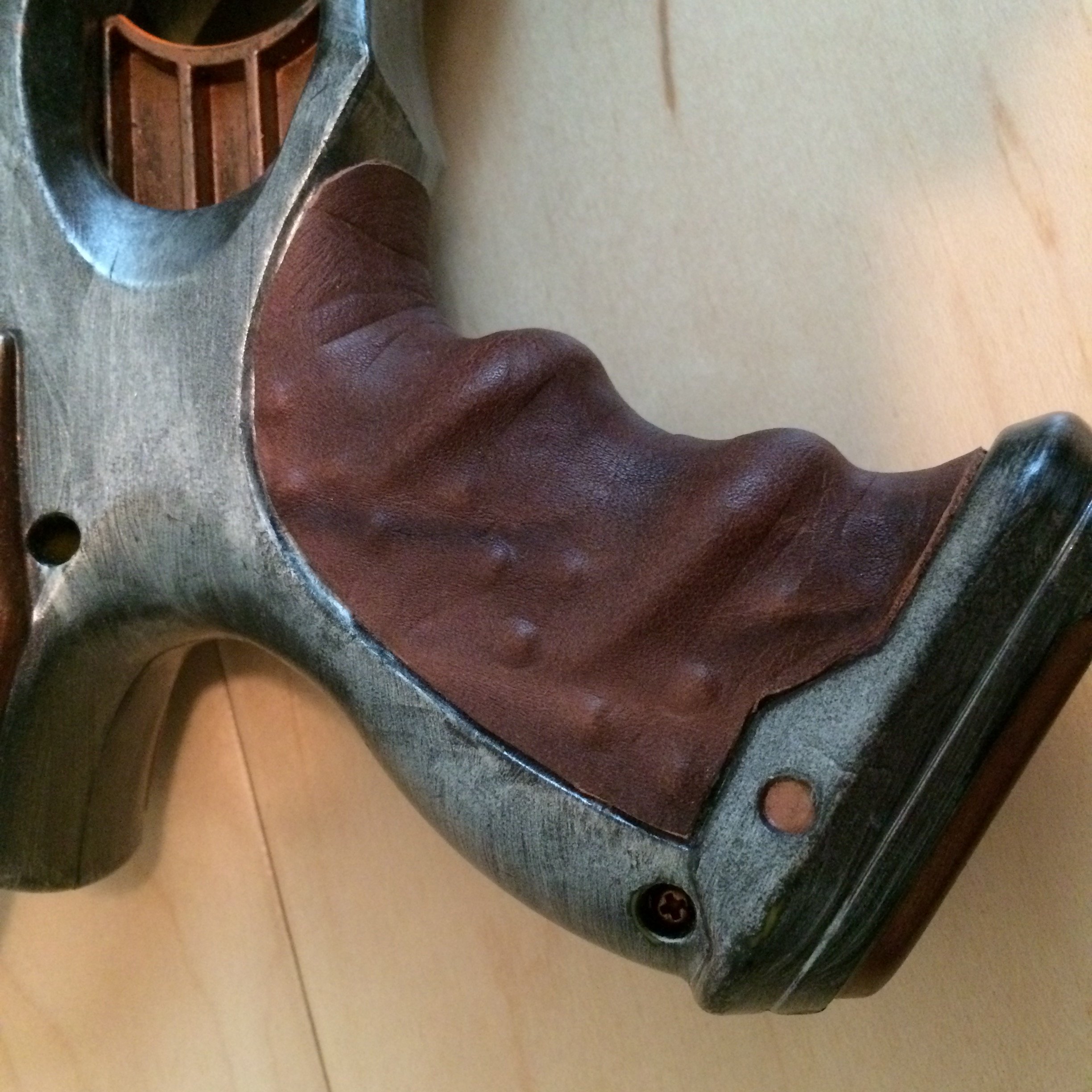

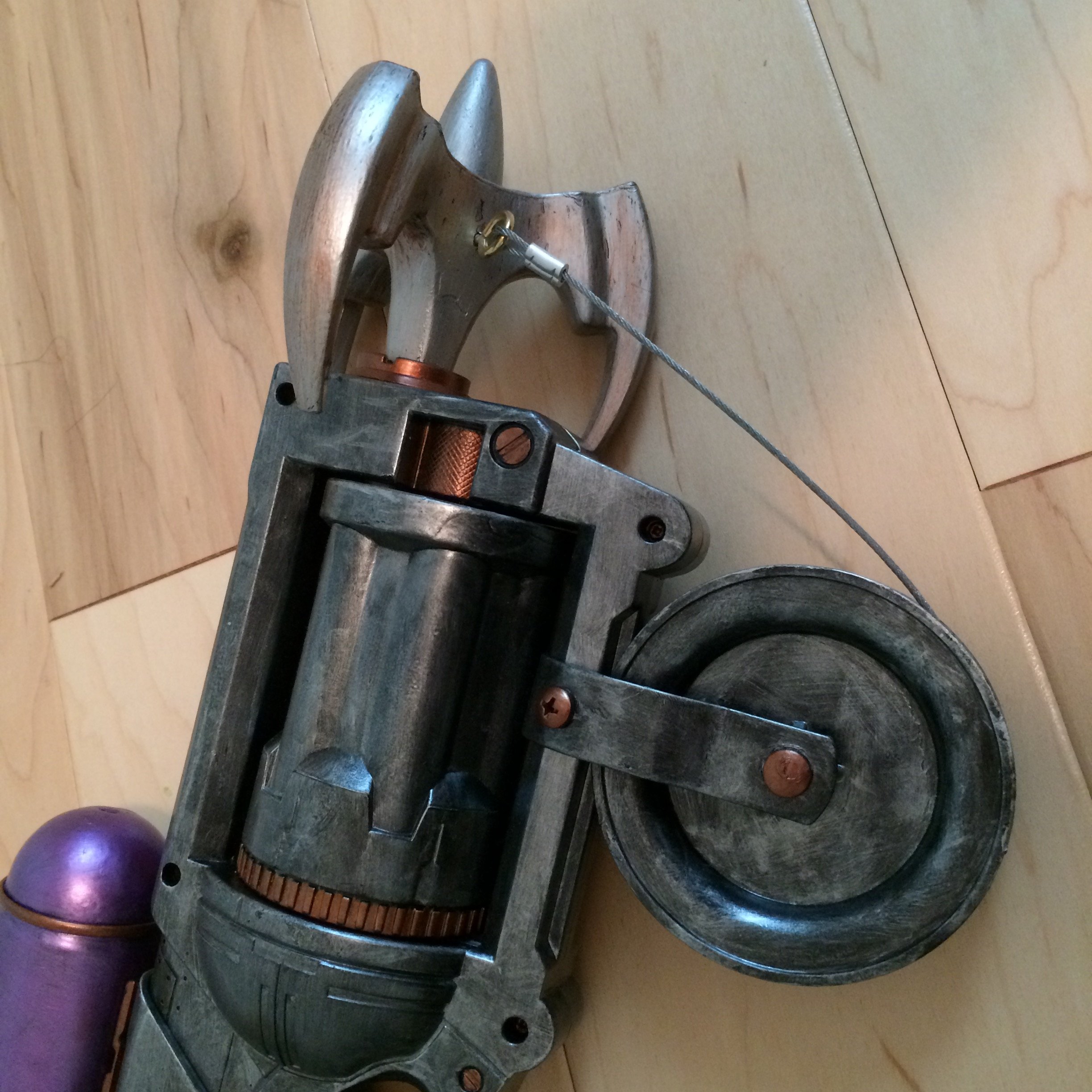

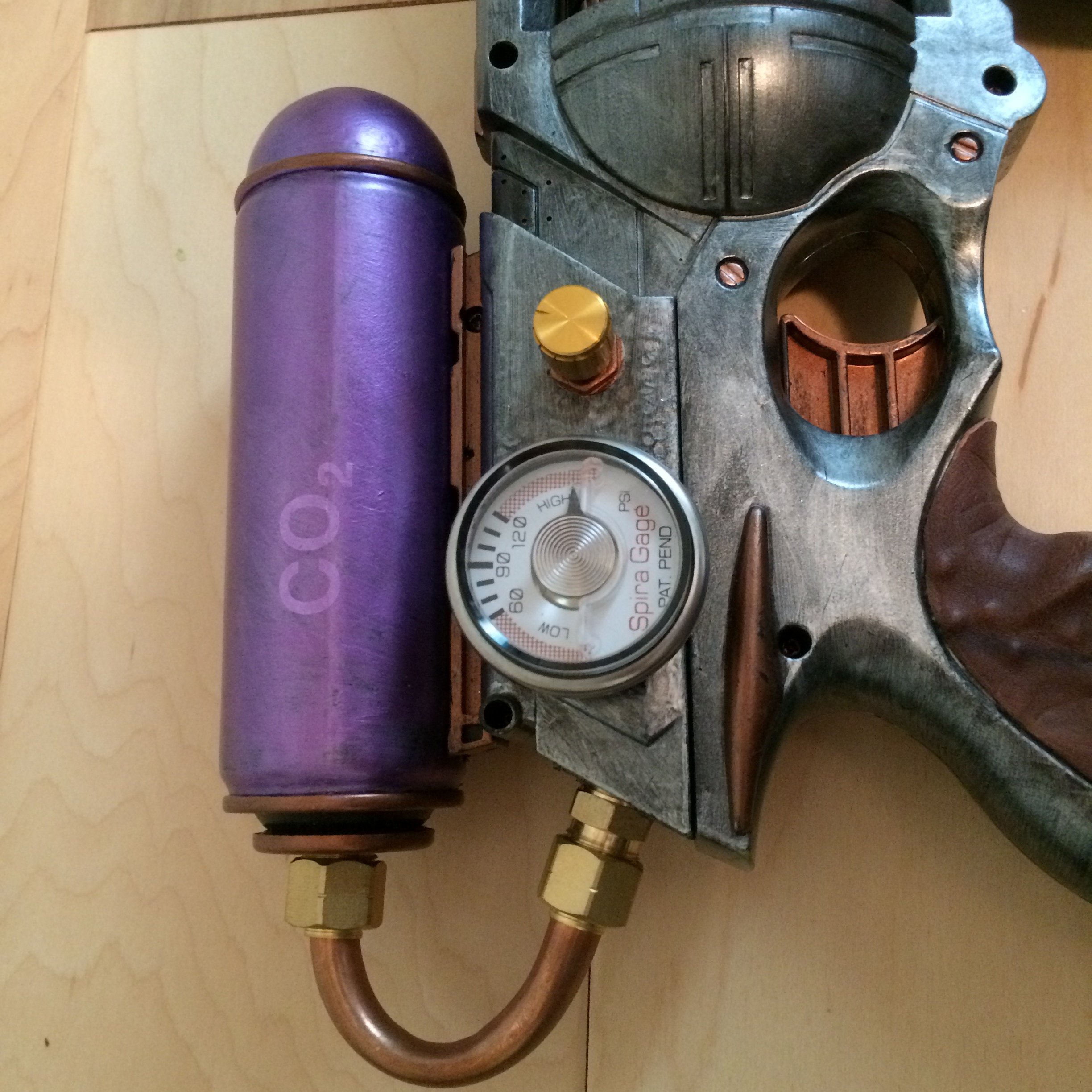

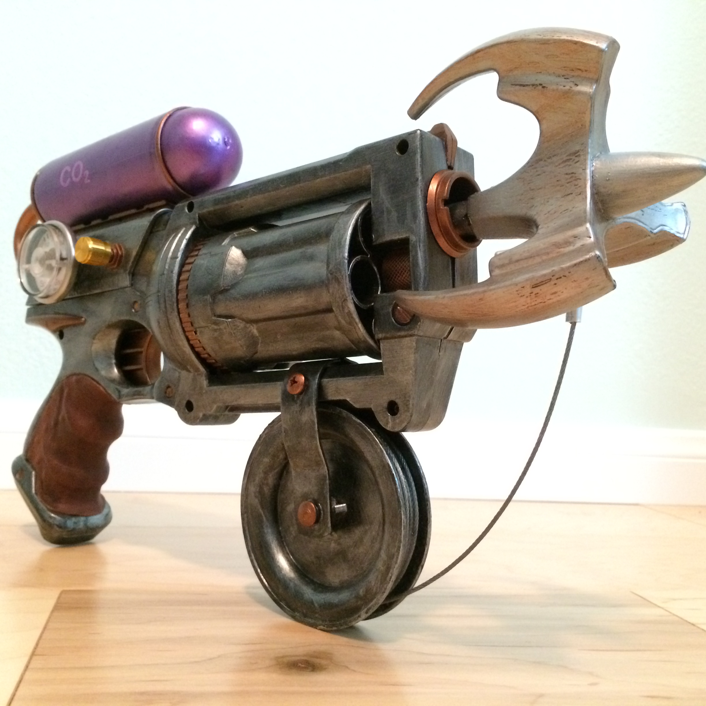

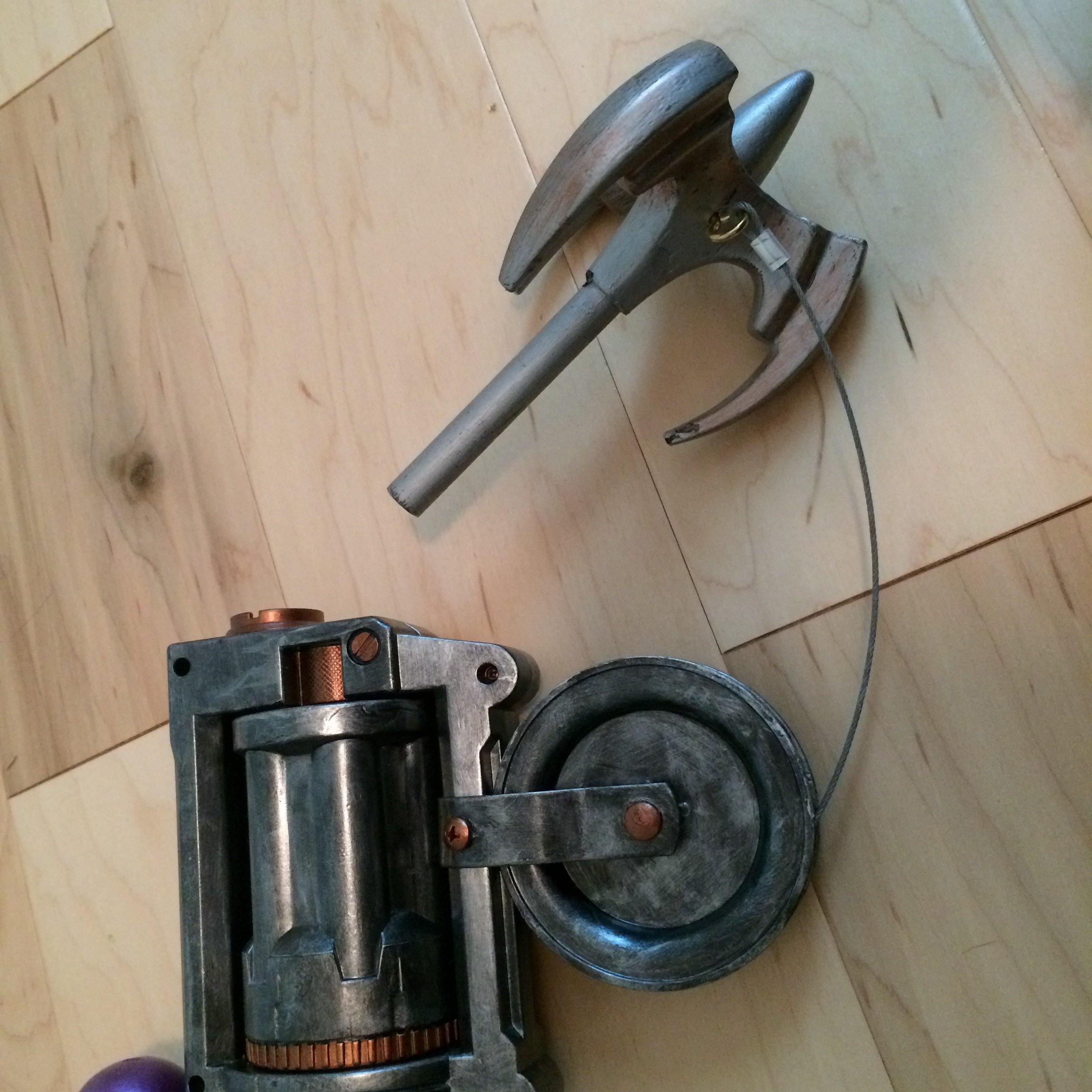

Here is Rorschach's Grappling Gun (comic version) that I made after seeing someone have a go at it on pinterest. Real leather grips, copper tubing, pressure gauge, pressure knob. Was for a costume that I am not going to get around to remaking.
Super cool! Now I have an idea for some old copper tubing I have. :D
You HAVE to get a bending tool or you will be a long time fighting it and crushing the pipe as it bends. Harbor Freight sells a 'tubing bender' for $7.99. Worked like a champ.
Thanks for the tip! Now I just have to find my copper tubing...:confused

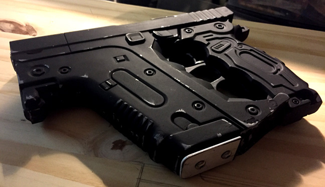

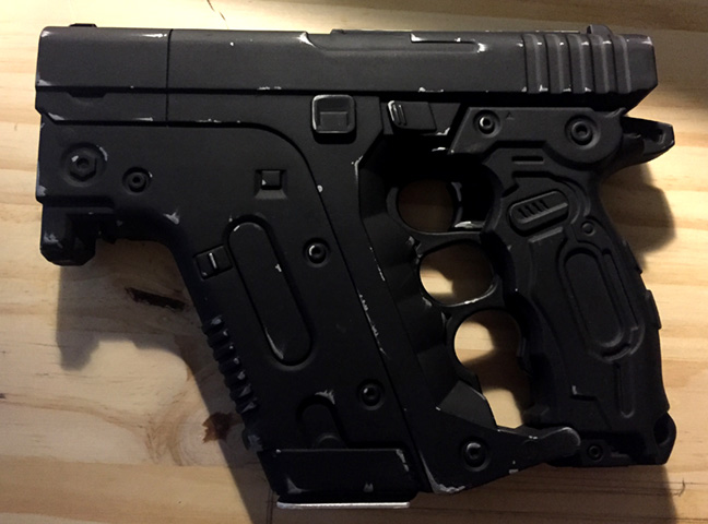

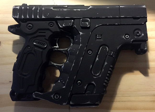

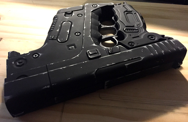

I recently did a quick and simple mod to a Kata blaster from GI Joe. I removed the charging handle and filled in the gaps where it was used.
I also added an aluminum magazine plate to give it a little metal.
This was a two day build, and was just an easy, fun mod.
This build is intended to be used in a cyberpunk short film. Here is the concept art I created for that scene.
