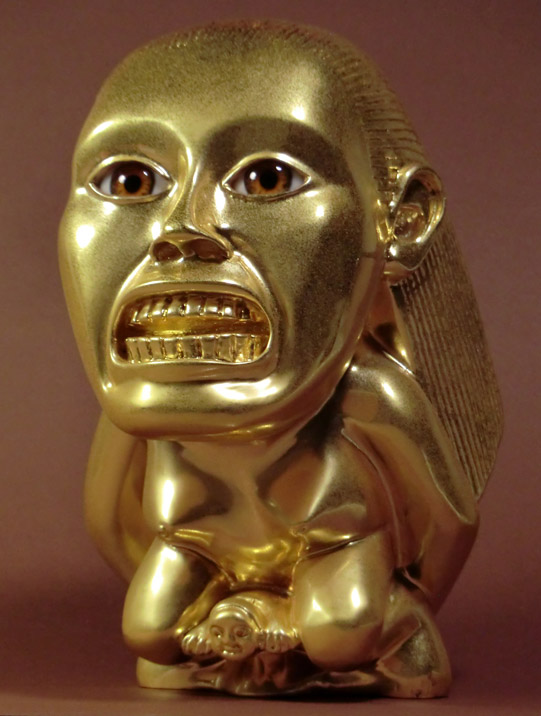

Been meaning to weather my gold plated Idol but wanted to do some research and get some tips on the process.
The idol is just too shiny and too bright right now.
I want to dull down the shine and darken the gold color a bit and add darkened areas in the crevasses and maybe some verdigrass.
Any tips or techniques for accomplishing this?
Thanks!
Light, light wait sanding with 2000 or 3000 sand paper to dull down the shine and a black wash for adding darkening in some areas....
Well, if you're going for realism, and you're going along with the general consensus that the idol is indeed gold, you have to decide for yourself what you think the purity of the gold would be. Lower karat gold that has been alloyed with other base metals will oxidize and tarnish (brown/black). Pure 24 karat gold cannot tarnish since it doesn't combine with oxygen very easily.
Verdigris only occurs with copper and copper alloys (brass, bronze).
I believe Relicmaker uses Testors Dullcote on his weathered idols - only a dusting:
I've always preferred to use artist's oil paints thinned with turpenoid for weathering - obviously they don't dry as quickly as acrylics, so that means you have a lot more working time and can blend them out much more easily and get some more subtle effects (wiping them off, building up layers, etc.)
