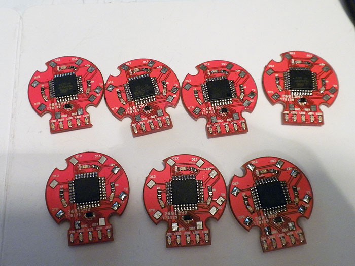

I made fully functioning Arduino compatible circuit, designed to fit in the face of a watch for the TASM webshooters: (thread is here somewhere)
ie:
These were minimized to ensure they would fit in the prop.. (also had SD card sockets on the bottom for audio playback)..
You would have other obstacles here.. such as voltage regulation. (Neopixels require +5v.. but more current than an Arduino can provide.. so needs to be powered directly from a stable +5v power source)..
You would still need to create a custom PCB.. (unless the watch is big enough to fit a Pro-Mini or something inside of it?)
