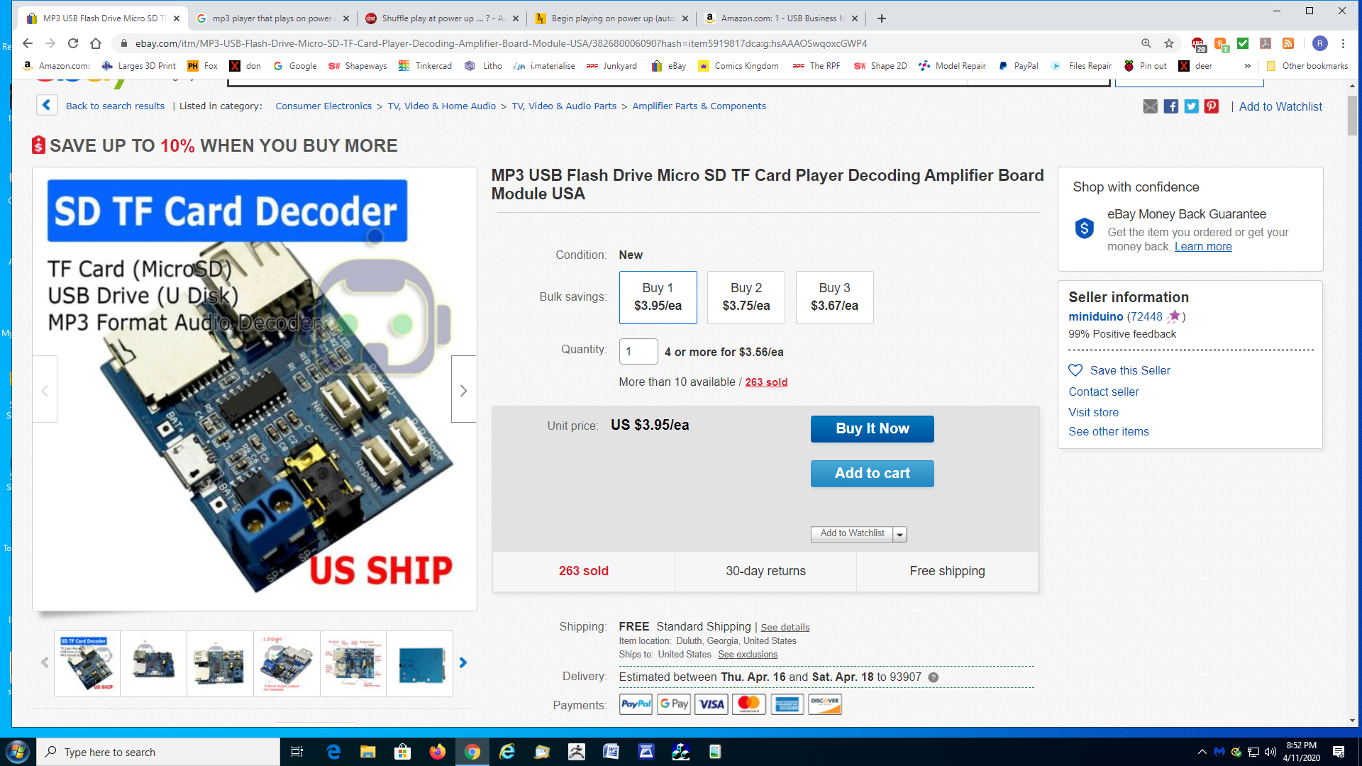

This says play on micro-sd card insertion. I would wonder, if the card is already inserted, if it would play when powered on. Not sure. :unsure:
It's also powered by a standard wall micro-usb power cord without modification.
Substantially cheaper. I'm going to order a few and test it if you want to wait. They're through eBay.

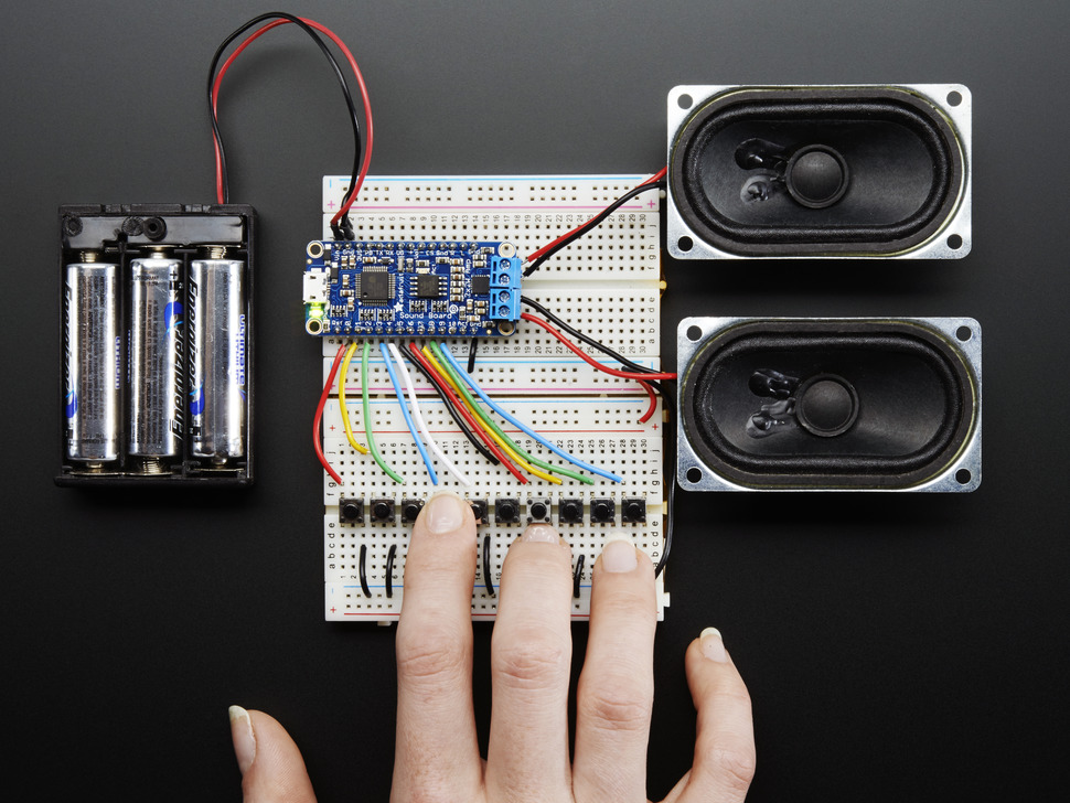

I have to say an adafruit audiofx board w amp plugged into a usb charger and triggered to start when powered on would do the trick nicely. Super easy to do.
Okay, I got my board and it works great. It takes a micro-sd card and you power it with a standard micro-usb power cord. You can hook up a speaker up to 2w. As soon as you provide power, it starts playing the first mp3 audio on the card. I had it hooked up to my desktop computer speakers and it played great sound.
This is a low cost option that requires no programming to play automatically when powering on.

It does not loop. However, it will play all songs on the card. You could put One-hour-blocks of fireplace sounds on it. You should get 10 to 12 hours of audio on a 1gb micro-sd card. So, really, that's as good as looping. If you need more than 12 hours of sound, simply use a bigger card and more recordings. It always starts over on track 1 when power is cut and restored, so you just have to flip the wall switch off and back on again to reset if you really do hit the end of the card.
