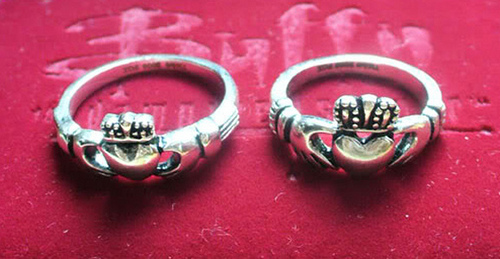

I purchased this set of licensed Buffy rings about 2 years ago. These have never been worn, only handled a little bit and then put back in the box they came in. This is what they looked like when I bought them:
I opened them up for the first time in 2 years today and took these 2 photos, one with the camera flash on, one with it off:
The manufacturer information states that these were 'silver plated' when new. I assume this is just very cheap plating that the oils from my fingers ate through?

Seems like it's not the plating coming off but it's just tarnishing which can be removed with a jewelry polishing cloth easily. All silver and silver plated jewelry tarnishes except for that new Argentium silver or when it's plated with Rhodium.
If you want them resized, which seems possible from what I can tell from the pics, then most likely they have to be re-plated.
I agree with Heisenbeg above. They just look tarnished to me. For removing the tarnish, you can use a polishing cloth or a chemical silver polish and a regular rag, but this can take a lot of time rubbing to polish. There's another way I tried once on some solid silver pieces. I don't remember the particulars, but you made a solution of baking soda and water (and maybe some other stuff - all regular kitchen ingredients), and boiled it with a piece of aluminum foil. Probably best to do your research before you try it and make sure if it works on plate. Your best bet is to take them to a jeweler to get them professionally polished. This will cost a little, but not that much, as it's only about 10 minutes of work for someone with professional equipment. If you do, be sure to tell them it's plated so that they will go gently with the buffer.

As to the question of sizing .... sorry, but plated rings can't really be re-sized. Resizing a ring usually involves cutting a piece out and soldering the ends back together; or alternatively cutting it open and soldering in a new piece if you're upsizing. Either way, there's a good deal of filing involved to smooth out the solder joint and make it invisible. This filing will quickly cut through the plating and leave a rough edge where the base metal is exposed. Yes, it's technically possible to resize and then replate, but it will be difficult to find a shop that has the equipment for this. Considering it's silver, and not gold, my guess is that you would end up paying more than the ring is worth to have it sized and replated - even if you can find someone who can do the work.
If you want to keep the Buffy/Angel rings nice, but also want to wear a claddagh, I'd recommend getting the Buffy ones polished, and buying yourself a set of solid silver ones to wear. Plated jewelry doesn't stand up to continuous use very well. The plate often begins to wear down in the parts where it gets bumped all the time, and again will leave a rough edge where the base metal is exposed.

As a jeweler I see this stuff all the time. Polishing anything that is plated (to remove deep scratches) will usually require re plating as the polishing process will remove or damage the plating. As to whether or not it can be sized depends on the base metal. Rings that are cast or die struck in low cost alloys that contain Zinc cannot be sized. Most jewelry items that are made using Zinc alloys are given a thick plating and cannot be polished or modified in any way and if the plating is damaged you will have to send it to someone that specializes in plating these alloys. Plated copper, brass and silver and all other precious metals can be sized but most jewelers will not touch anything that is not made from a precious metal alloy. After sizing it will need to plated using Rhodium or silver plate. Rhodium plating is far more common.
