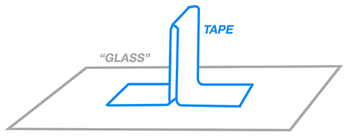

I can't help you with window material, but as far as gluing them in, have tried making tape handles?
This way the tape doesn't touch the glue and comes right off after the glue dries.
