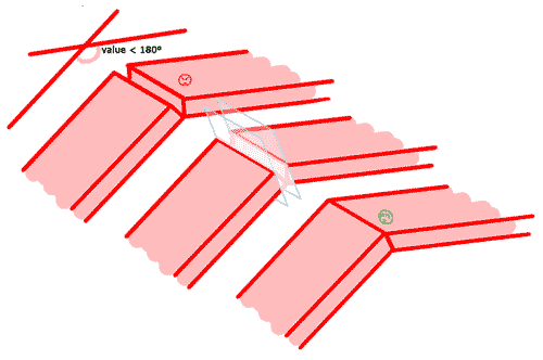

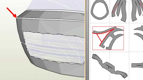

It's simple as possible : each time the surface of the helmet makes an angular outward inflection (not a simple curve, but an real palpable angle), you must make the angled cuts. Always refer to the 3D view of pepakura viewer.
