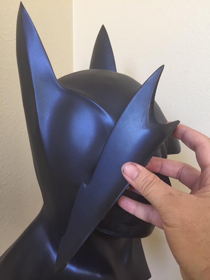

I can paint it for you but it wouldnt be for a month or two once I am in the new studio.
Examples of my work. The fin was the studio made fin, the cowl is mine that I painted that is now on display at BJB enterprises.
