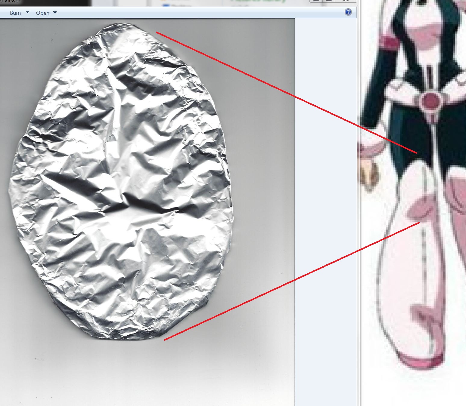

get a bunch of aluminum foil. Fold it over until you have a piece slightly larger than you need. Then start bending the edges until you have a piece out of foil that you like. It is very maleable, and it holds it's shape. foiledtemplate.jpg
