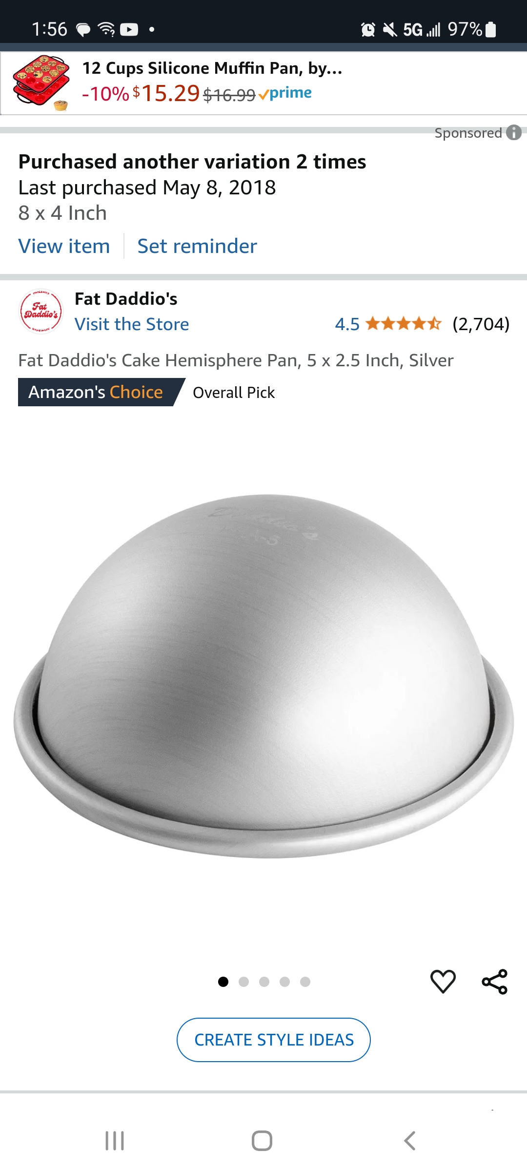

To eat out of?
Vacuform out of Petg
Amazon. Paint the outside or coat with epoxy
