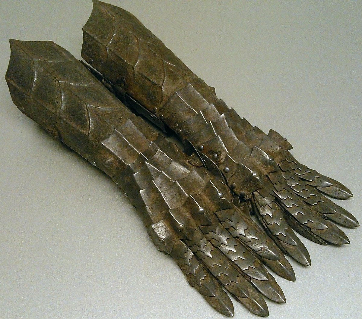

Limited Run Nazgul Gauntlets - comfortable for long convention-days
Looks amazing! Deposit sent!
.. aaaand received :) Thanks!

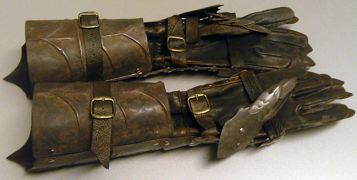

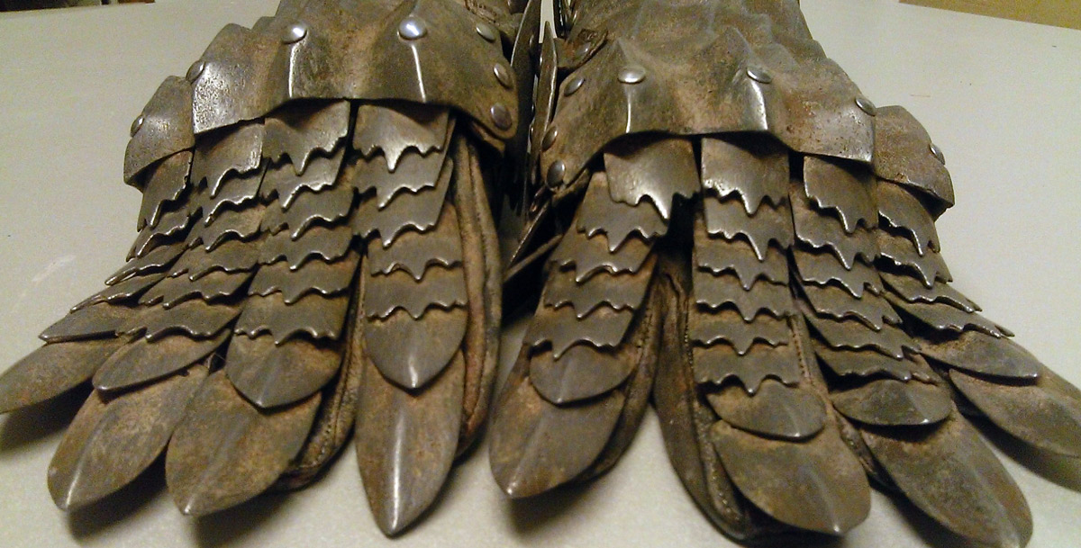

Tadaaaaa, first pair COMPLETELY FINISHED :-D

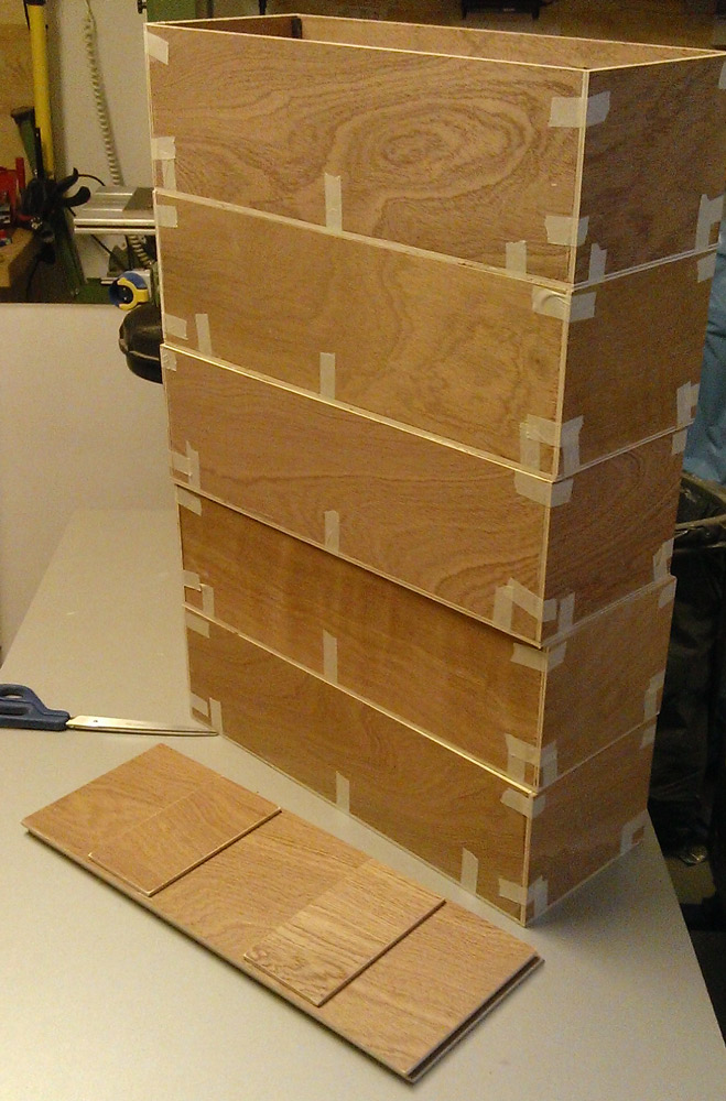

I had some plywood lying around, which someone gave me for free, and it's perfect for making little boxes for shipping these. While I was at it, I already cut some more for all pairs/sets.

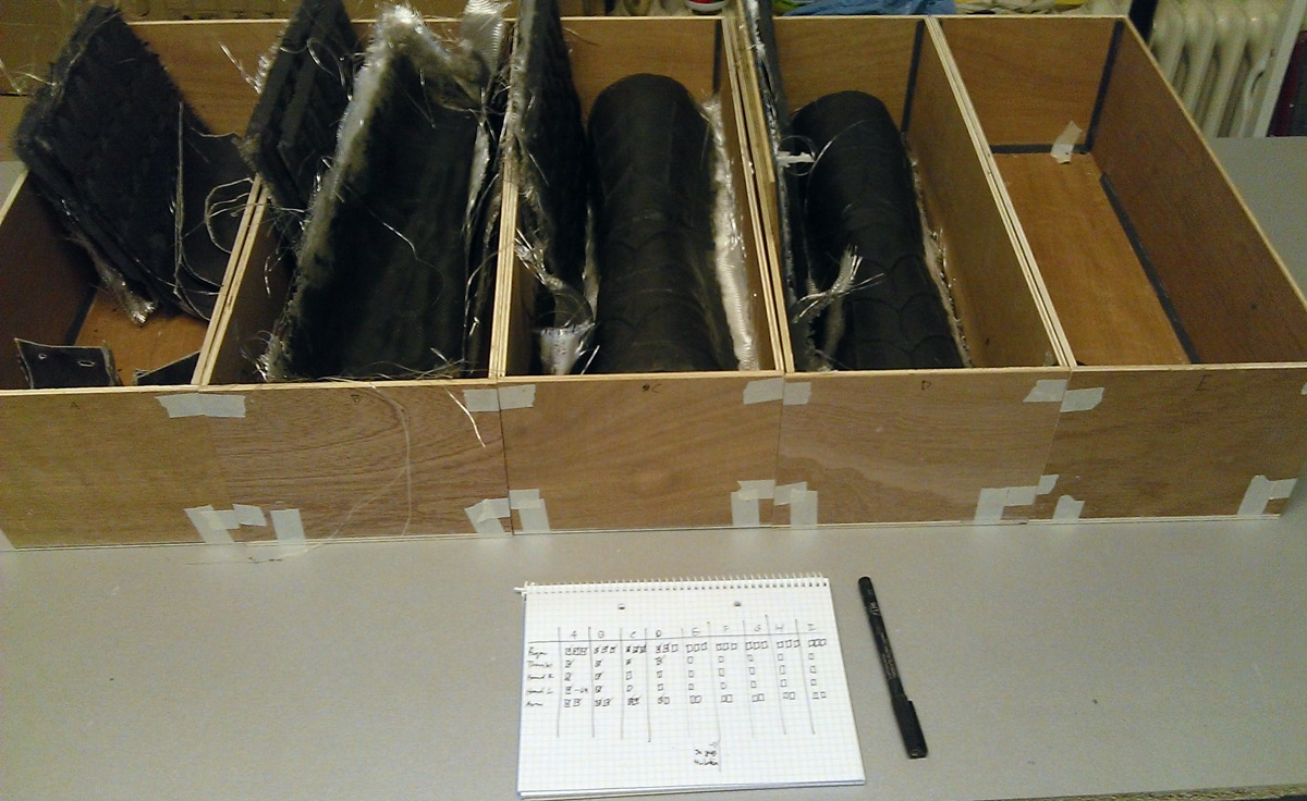

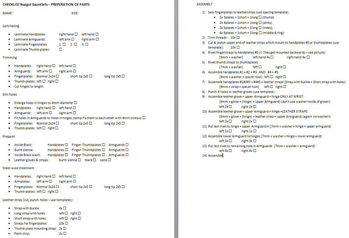

I'm working on getting more organized with my projects so starting with this one I'm currently working on a checklist. This way I hope not to get confused with these several sets which probably will all be in different stages simultaneously.
...it's also almost a complete set of instructions for the two of you, who have to assemble these themselves ;-)

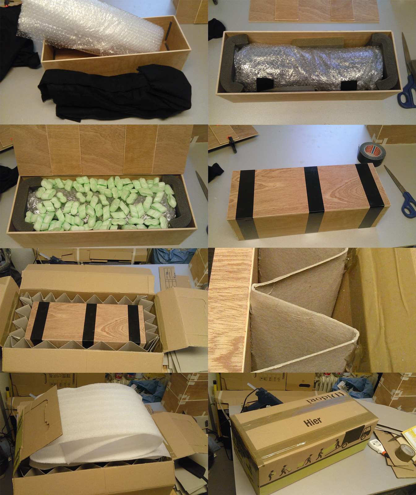

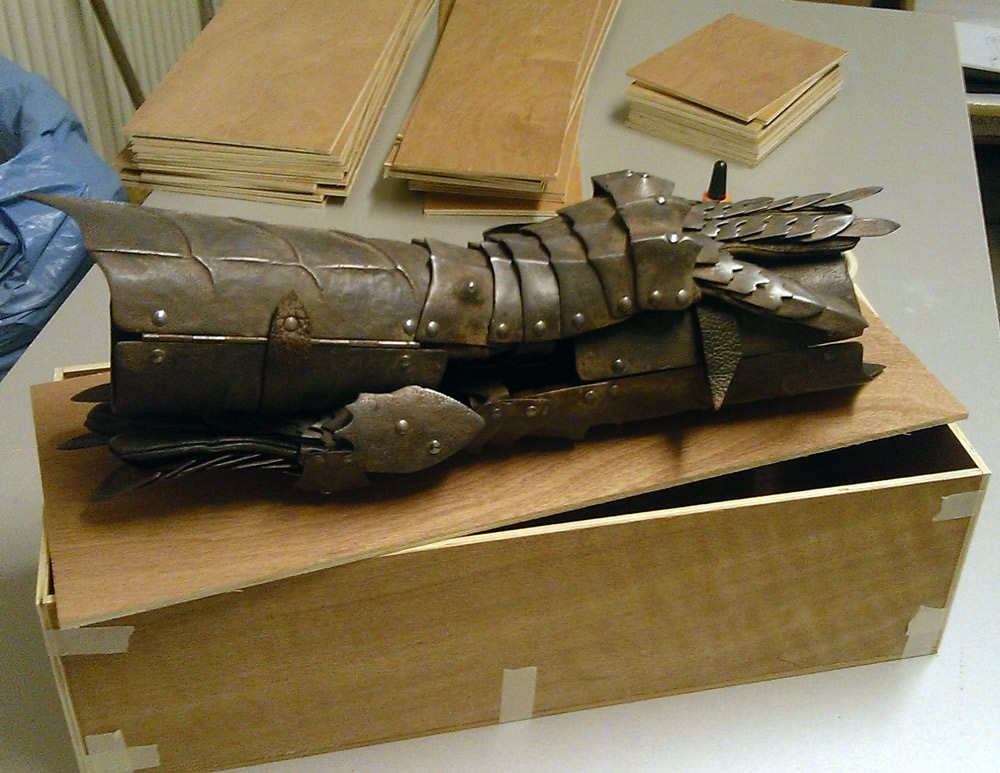

anyway, I hope these images of how I packed the first pair renders your worries redundant :eek ;)
Each glove is wrapped in cloth, then both together in bubble-wrap, then put into the box with more soft foam. The box is then taped shut with duct-tape and put into a accordingly re-sized cardboard box (luckily I have plenty of those left over from moving...)
The zig-zag cardboard is really tough and glued in place so it can't loose its shape, which makes for an excellent crash-zone if the package should have some kind of accident.

:eek That's about the best packaging job I've seen here, mate! You should take a patent on the zig-zag cardboard method ;).

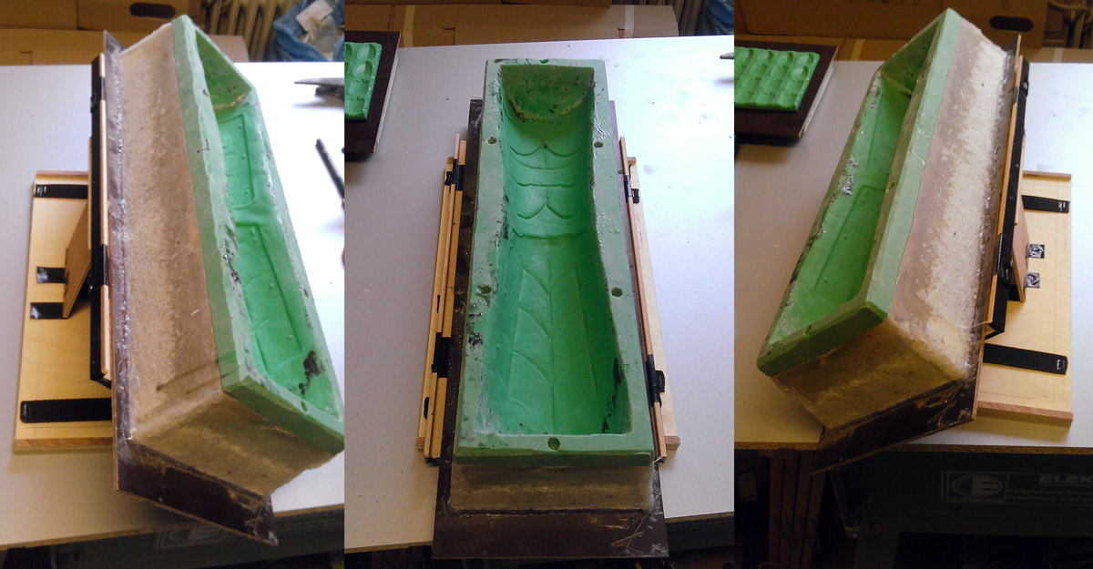

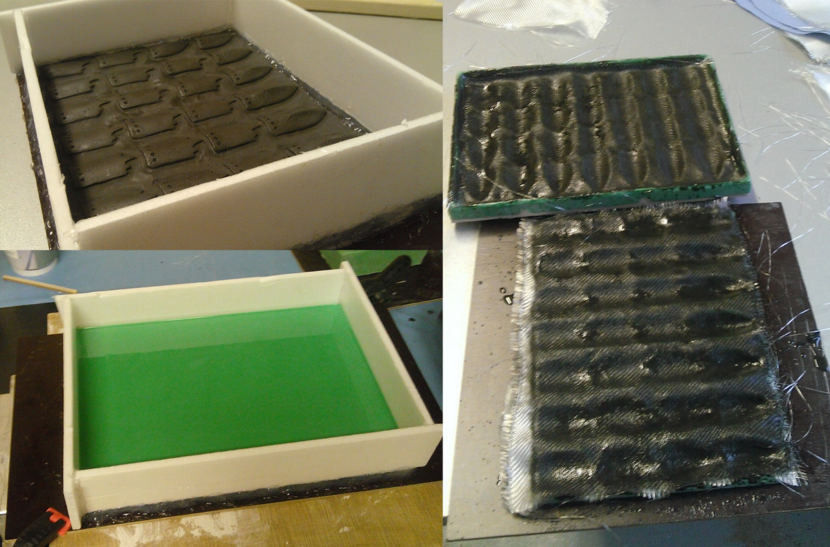

I just started the **echo mode on** "WEEK OF LAMINATION!!!" **echo mode off** ...at least the plan is to laminate at least once, but hopefully twice every day, until I have all the parts needed for all your gauntlets, plus a few extra:rolleyes
Because I have to laminate the fingerplate-mold three times for every pair of gauntlets, I figured, that I would end up only making 1 mold of fingerplates, 2 times a day, after all other parts are already done...which seemed a bit annoying ...so I made a second mold :ninja
Another annoying thing is..I mean WAS that I could not really see the upper edges inside of the U-shaped molds, so that was the most likely place of bubbles to form...because i just didn't see them while laminating.
If, so far, you got the impression, that I like to build contraptions to help with my work...you're absolutely right :D
This is a quite simple platform which can tilt to both sides. It doesn't even have hinges..just a few straps (of which some are just duck-tape ;))
Today I laminated twice, so in theory, I could make the parts for 1 pair every day...wish me luck :wacko

keeping a checklist always helps :)

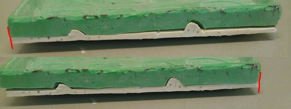

Molding two times a day gets to the molds somehow...they are expanding, probably because of the styrol that diffuses into them. Will give them this evening off so they can recover :facepalm
