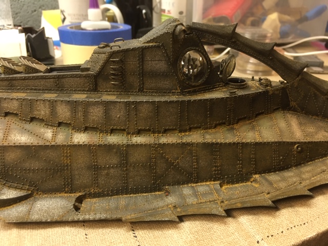

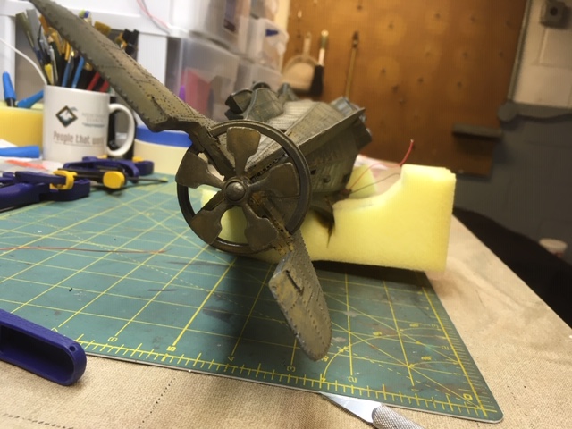

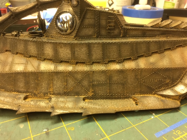

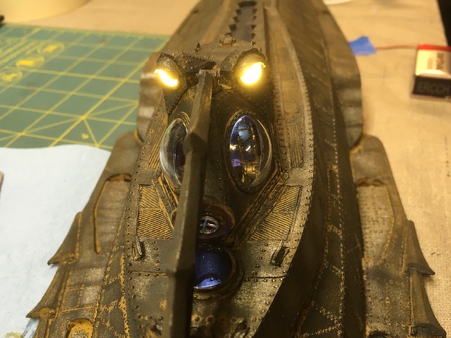

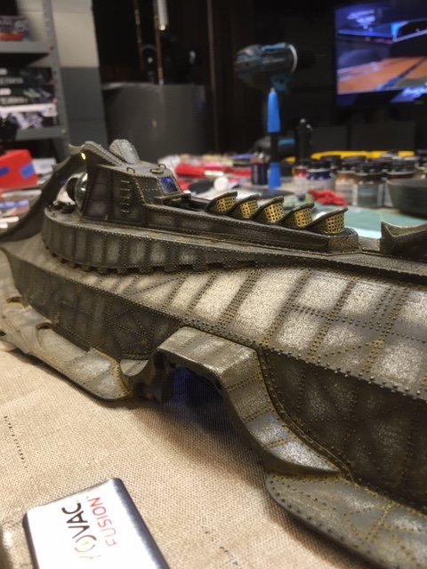

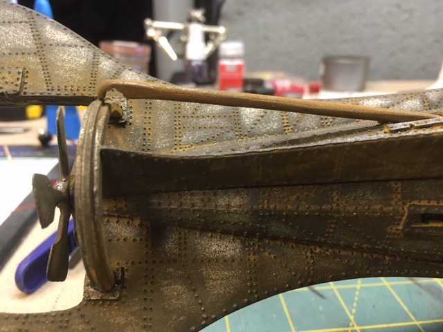

Had to cut the wire back but I fixed to dragon eye on the port side, wheeew!! bummer though the railing right behind the wheel and dive levers broke loose but that's not worth the risk of trying to pry it apart to fix. I did the green and rusty color pastel on the scupper drains and I'm satisfied, very subtle but you can see it. Coming along nicely

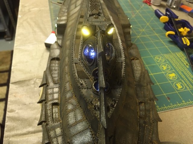

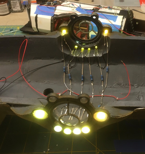

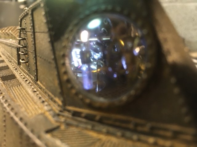

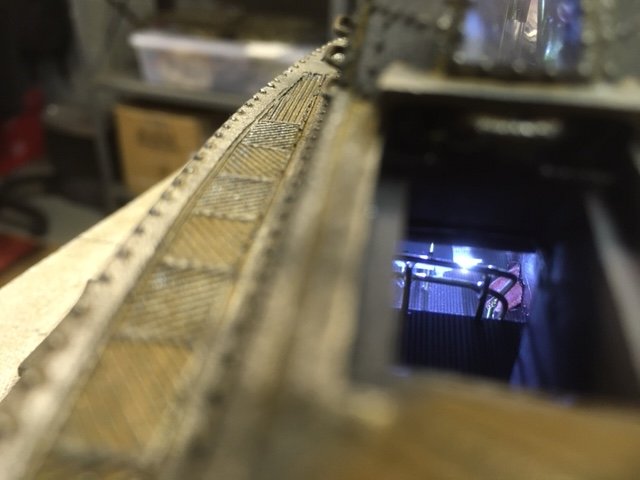

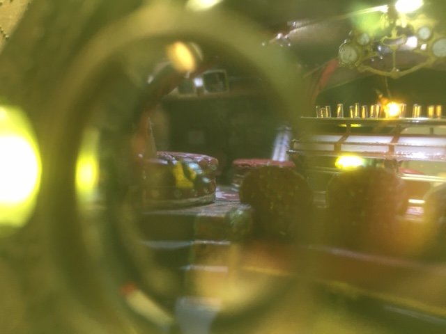

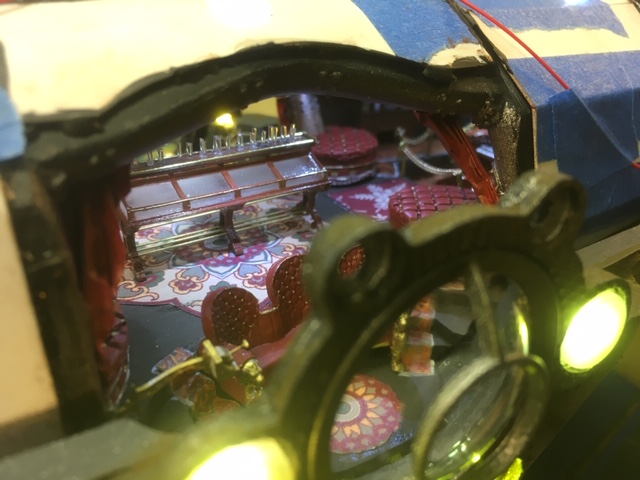

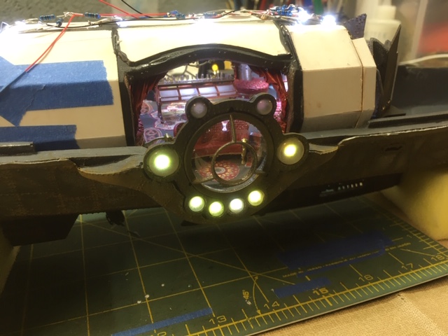

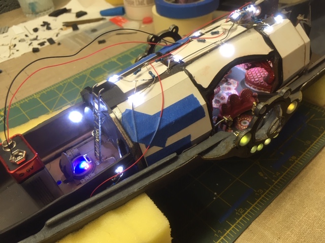

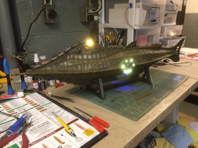

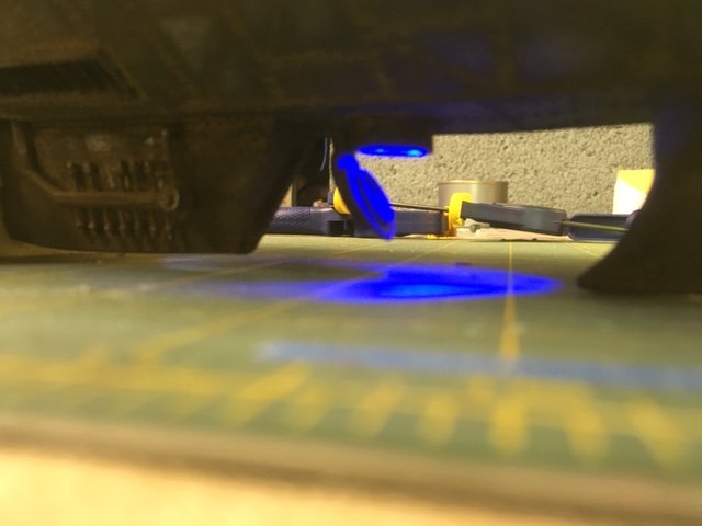

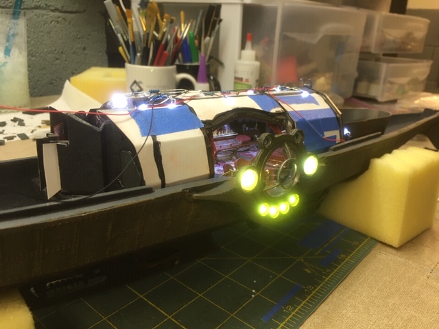

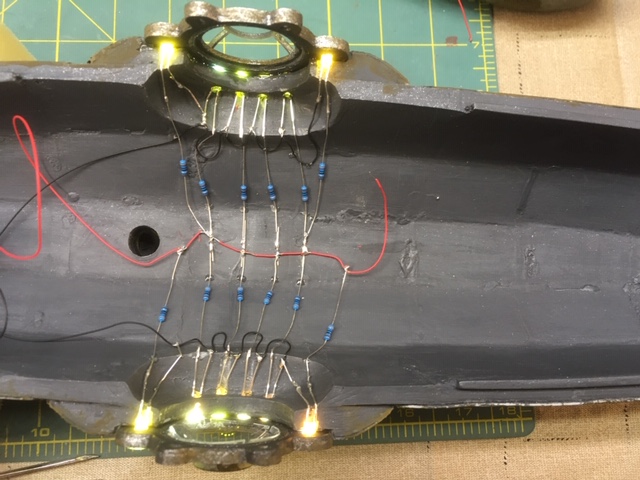

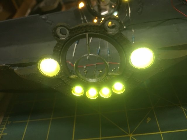

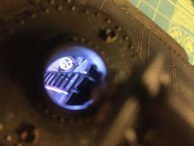

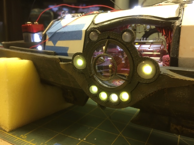

I'm in the home stretch...as long as all the lights keep working lol I also think an additional resistor on the iris lights to drag down the brightness might be a good idea. Opinions?
It's hard to tell. I like them as is, especially the level in the "daytime" pics.
Although they are spotlights so they should be bright but at the same time, you don't want to blind someone trying to get a closer look in the Iris.
Can they be turned on or off separately from the interior lights?
As far as the LEDs working, I have read from different sources that a good test is leave them running for several hours or so. If any are going to fail, they supposedly tend to do so early on and this helps weed out those defective ones

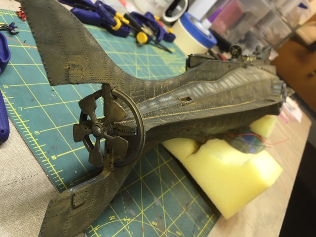

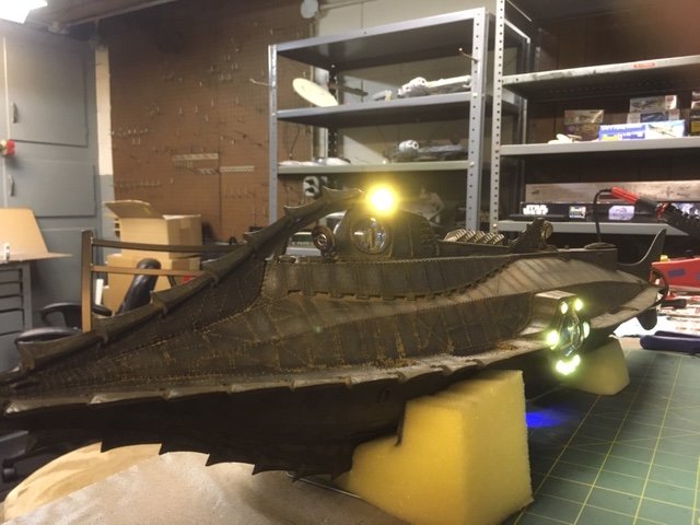

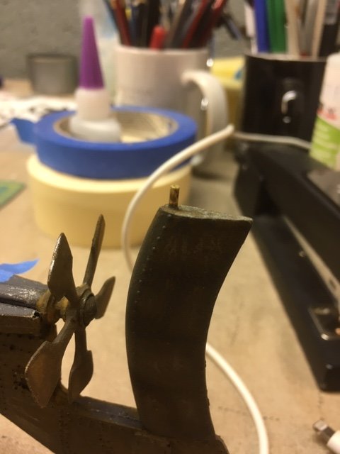

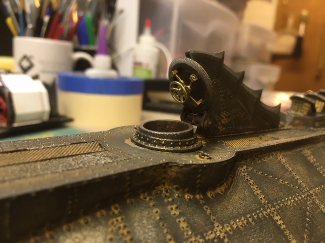

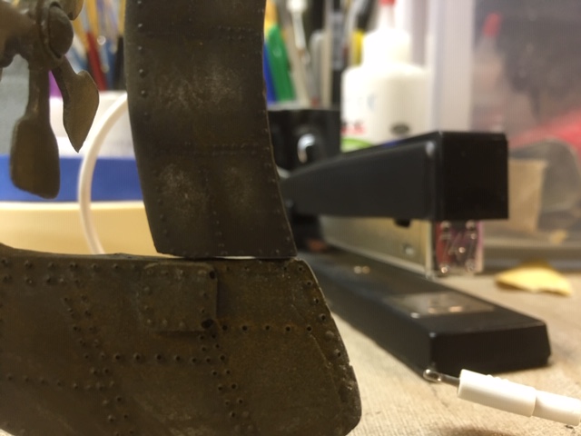

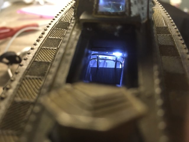

this evening I fit the prop, didn't bother to mod it to spin because it doesn't need to. I fit the rudder and chopped the plastic locator pins and drilled it for brass rod. I drilled the locator holes just deep enough so it wouldn't bottom out and have a realistic gap. I ran some wire extensions to the top so there will be a place to attach a connector to the upper hull wiring in the even it ever needs to come apart for light repair or replacement. I'm going to drill and tap strategically placed holes for tiny screws to join the upper and lower hulls which will allow disassembly. I did glue the interior assembly to the lower hull though. Another week or so and this fish is finished.

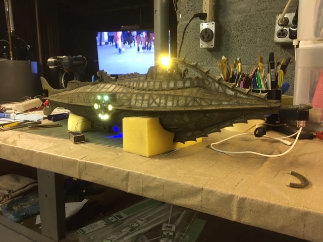

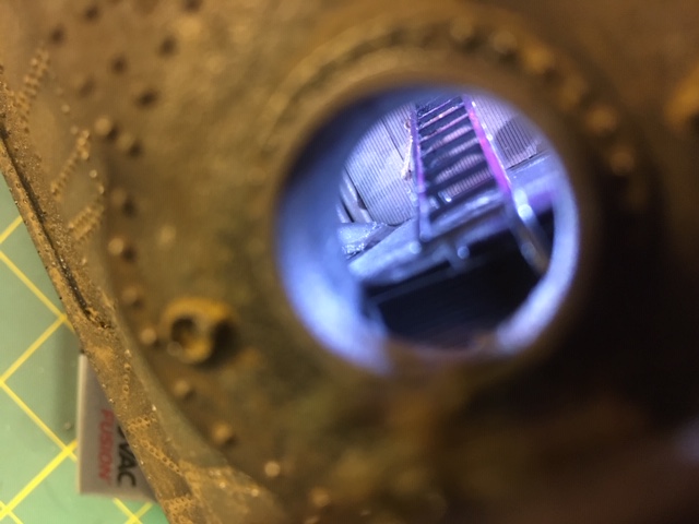

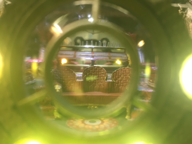

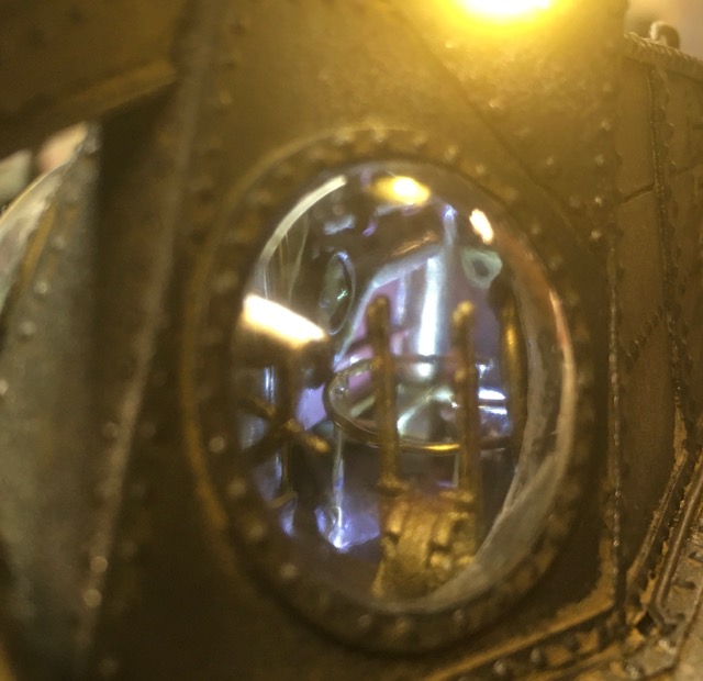

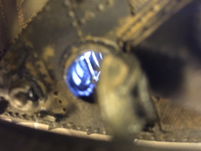

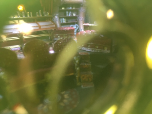

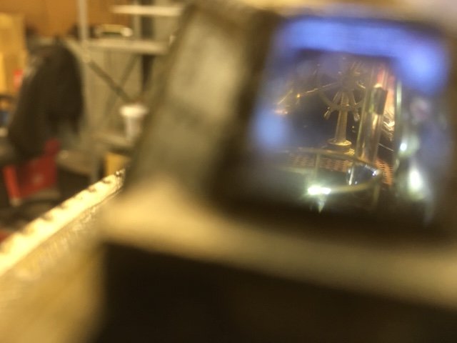

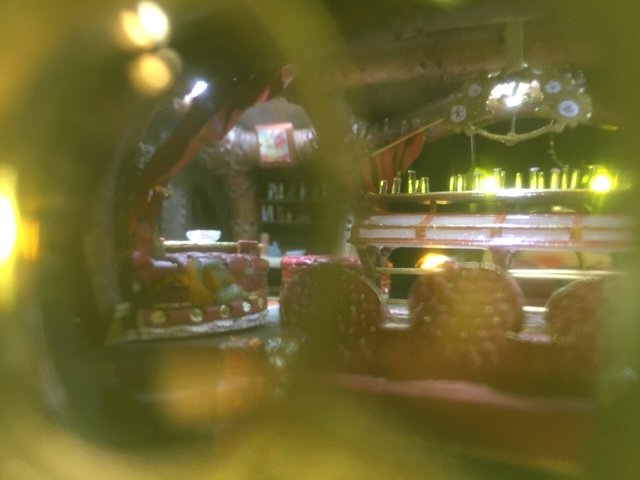

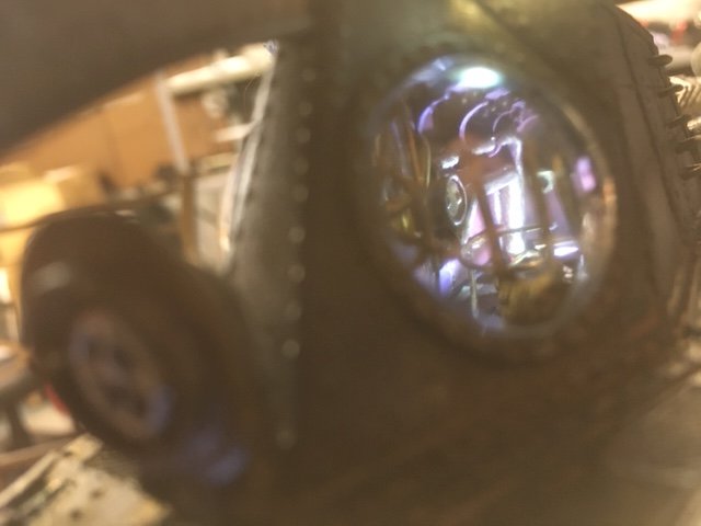

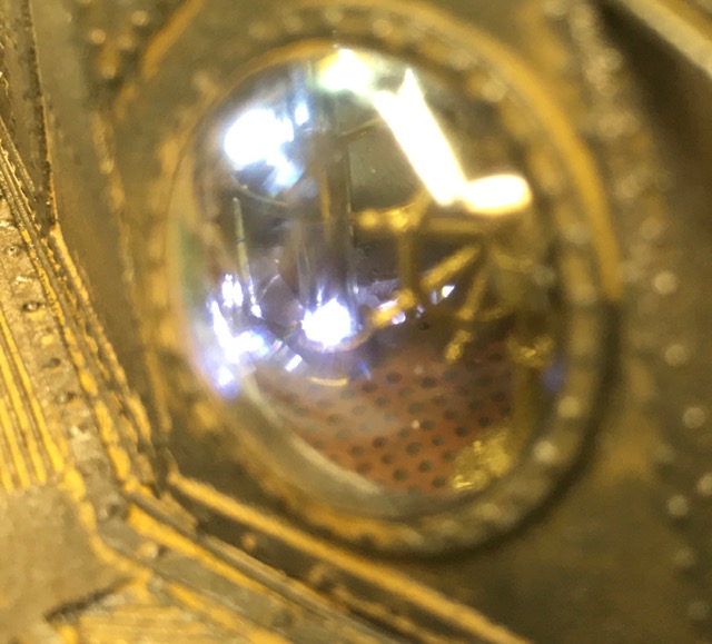

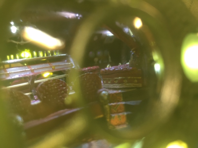

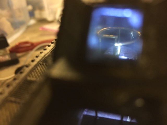

So I got it buttoned up today, as usual the prop shroud struts are too F-ing short. Last time was the same, had to scratch some from evergreen, no big deal just annoying. The field of vision through the iris windows is more narrow than I thought, but I sort of expected it. All that's left is the stand and the sound module.

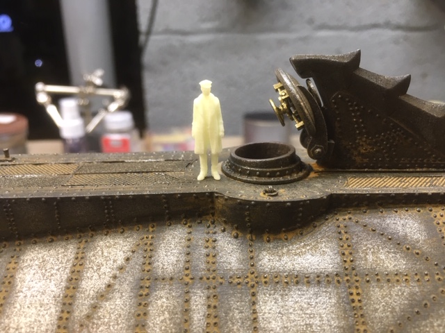

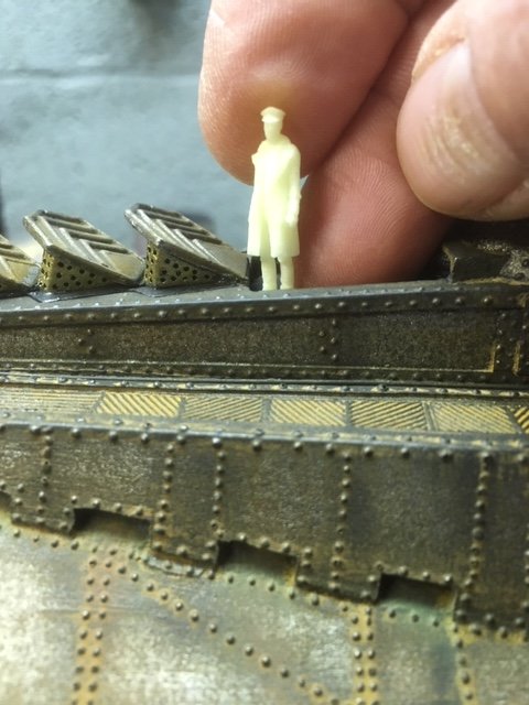

the sub is essentially done, I put the stock stand together and was working out how incorporate the sound module. I found the left over "in flight" stand for the Bandai PG Falcon and there's room for it underneath. I got one of the designers from Shapeways to modify a sailor figure for Captain Nemo and was looking at placement options, then realized I had best let my buddy put it where he wants it.
