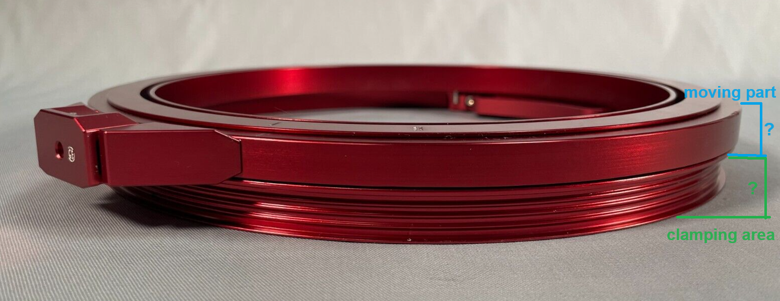

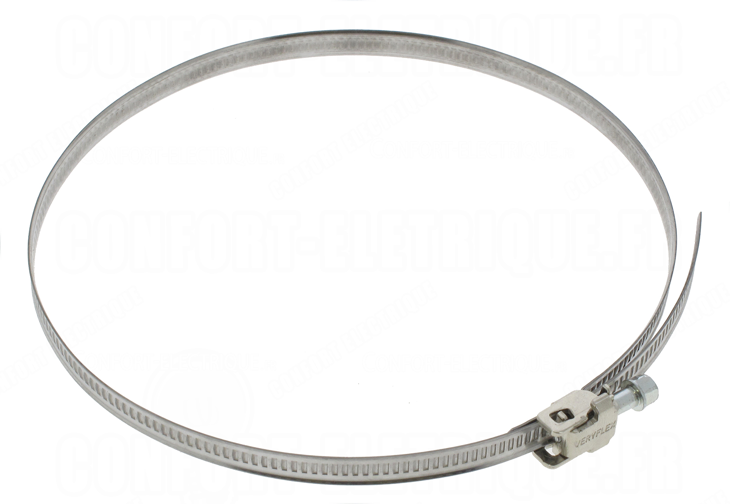

In the simplest terms, the compression band clamp is a bit like this:
(I was given a height of 1.10 in including the ribbed part (lower part) and the upper part (mobil) of the neck ring, is this correct, can you confirm ? thank in advance)
Yes, that is basically what the clamp is. 1/2" is the widest clamp that would fit a real ring

Could you please tell me the different measures.. I can't figure out visually if the whole thing is "high" (everything is relative) or not?

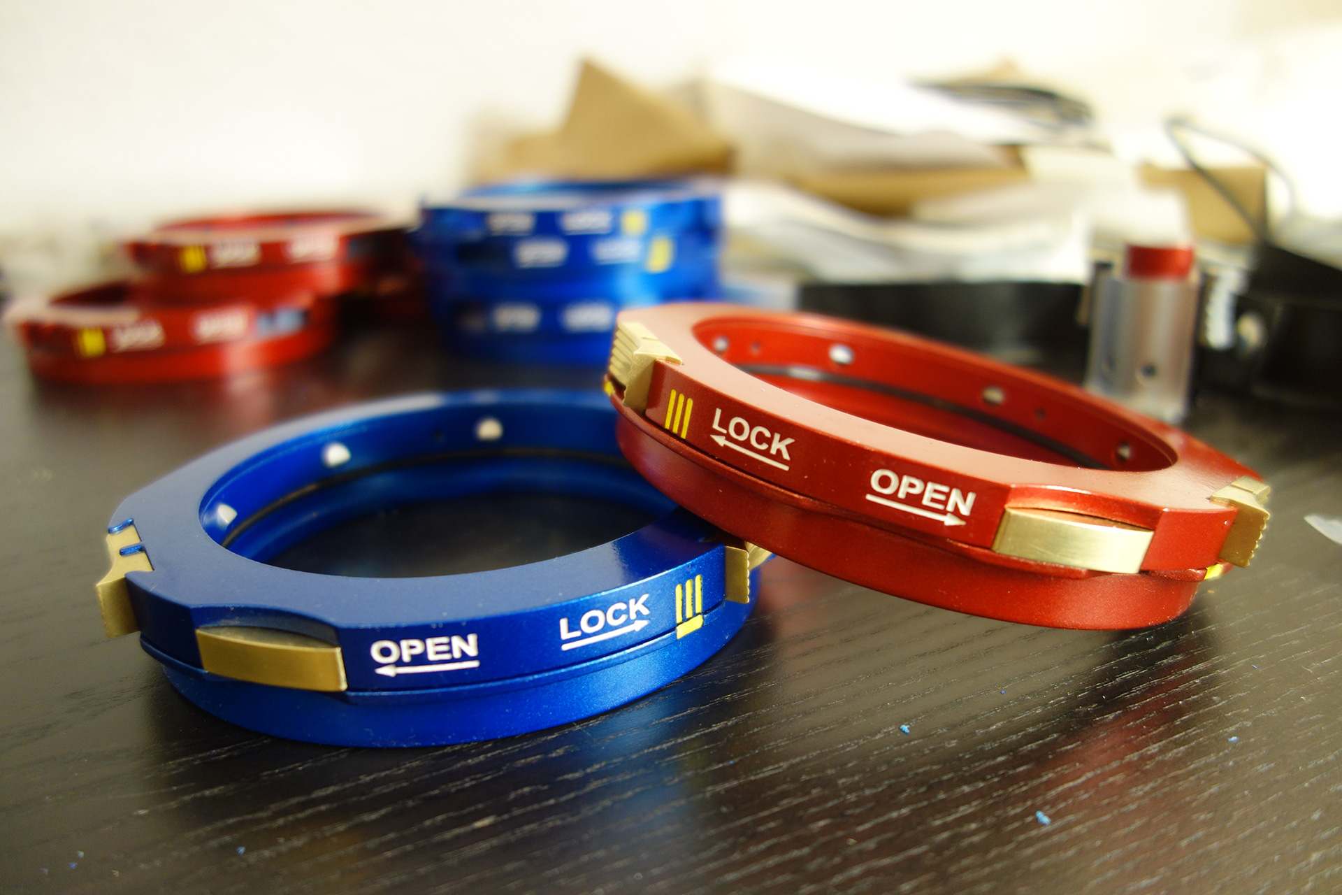

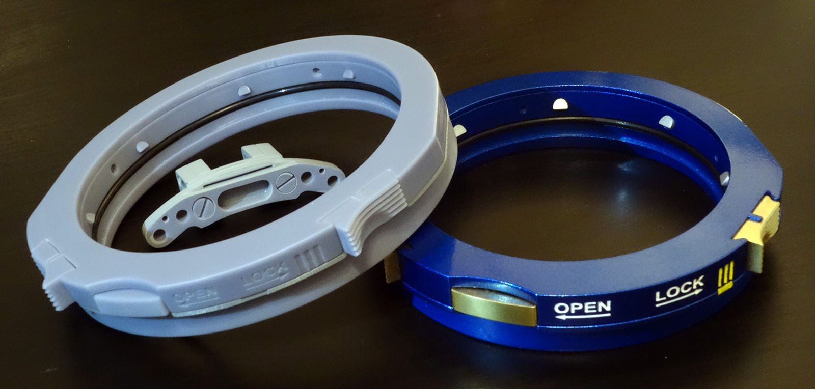

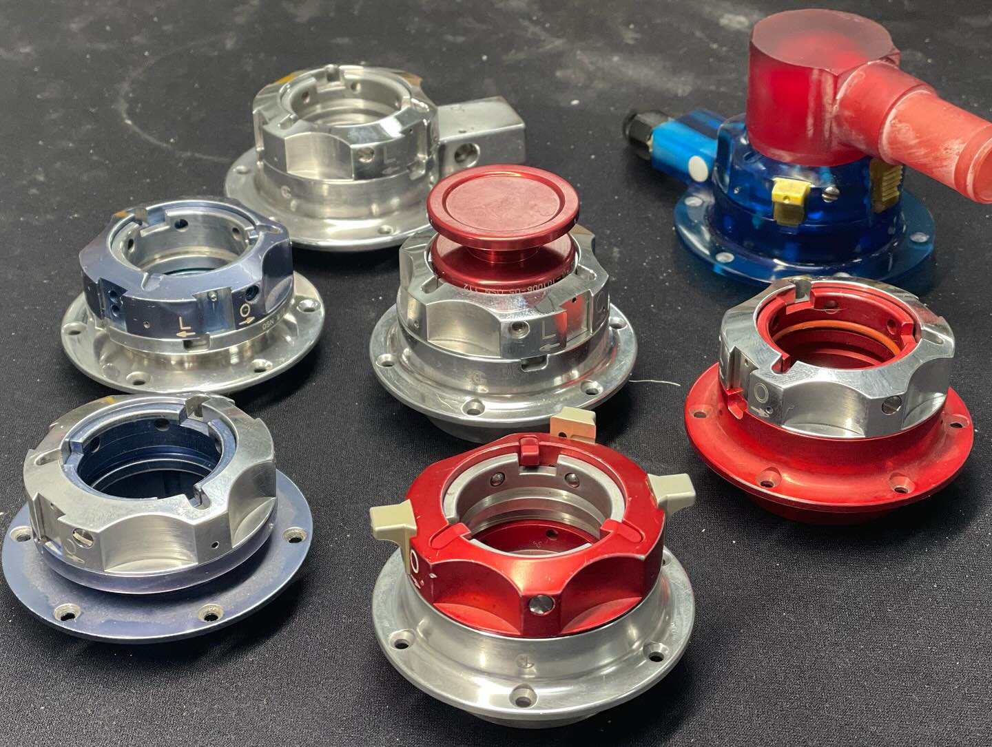

The ACES connects look great! (so does the 3d model of the AL7B connect)
Will you be offering them with the correct OPEN - LOCK and LOCK - OPEN markings?

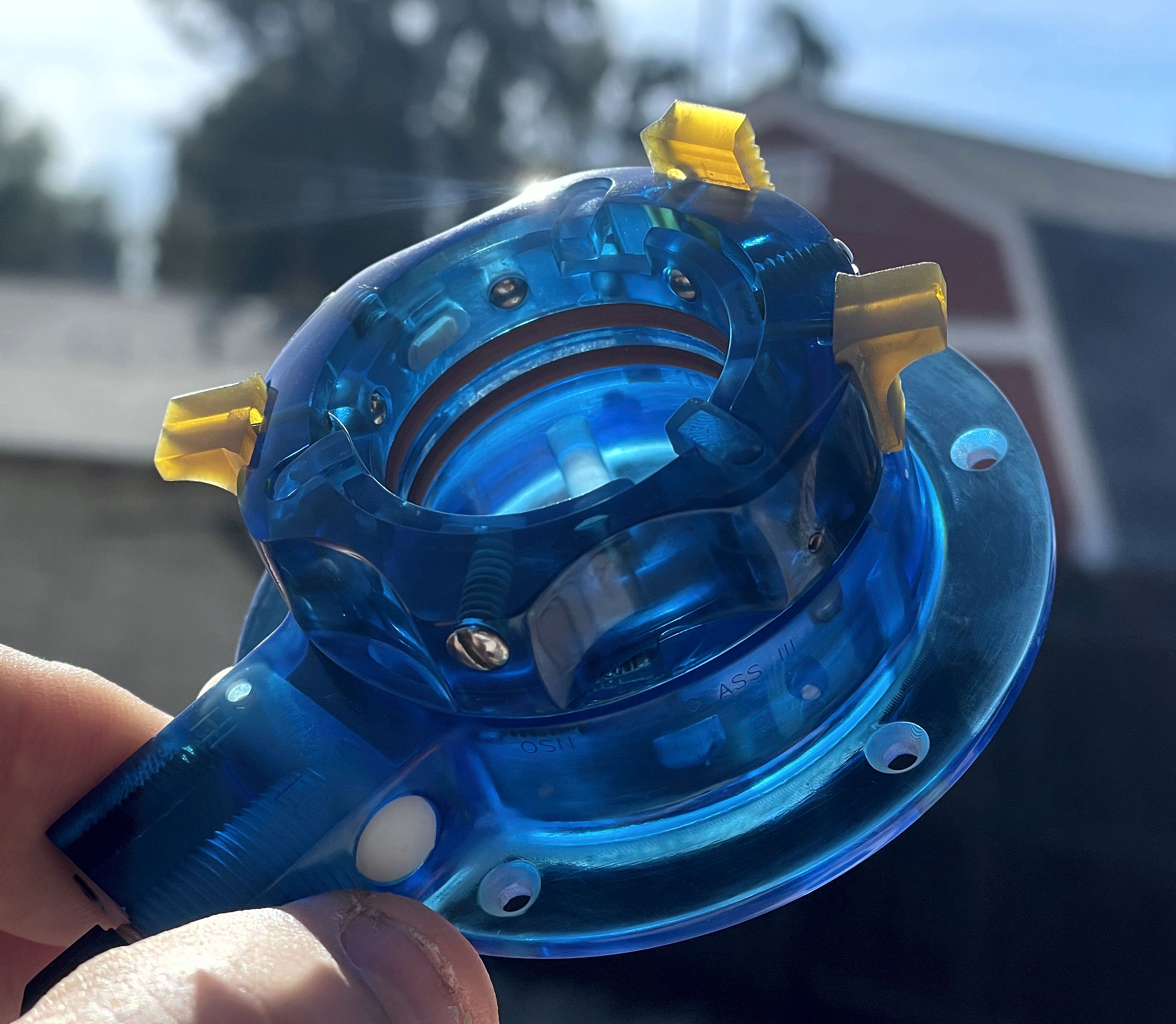

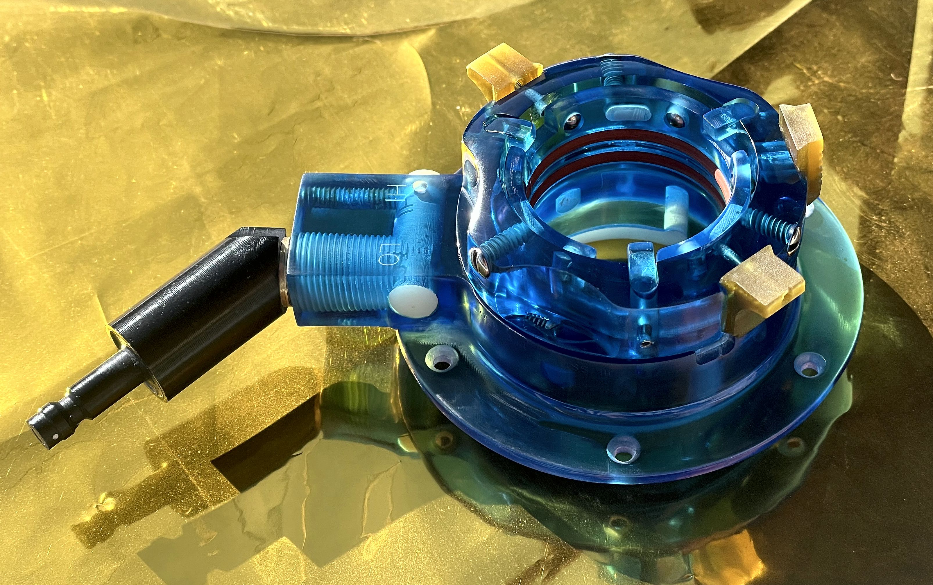

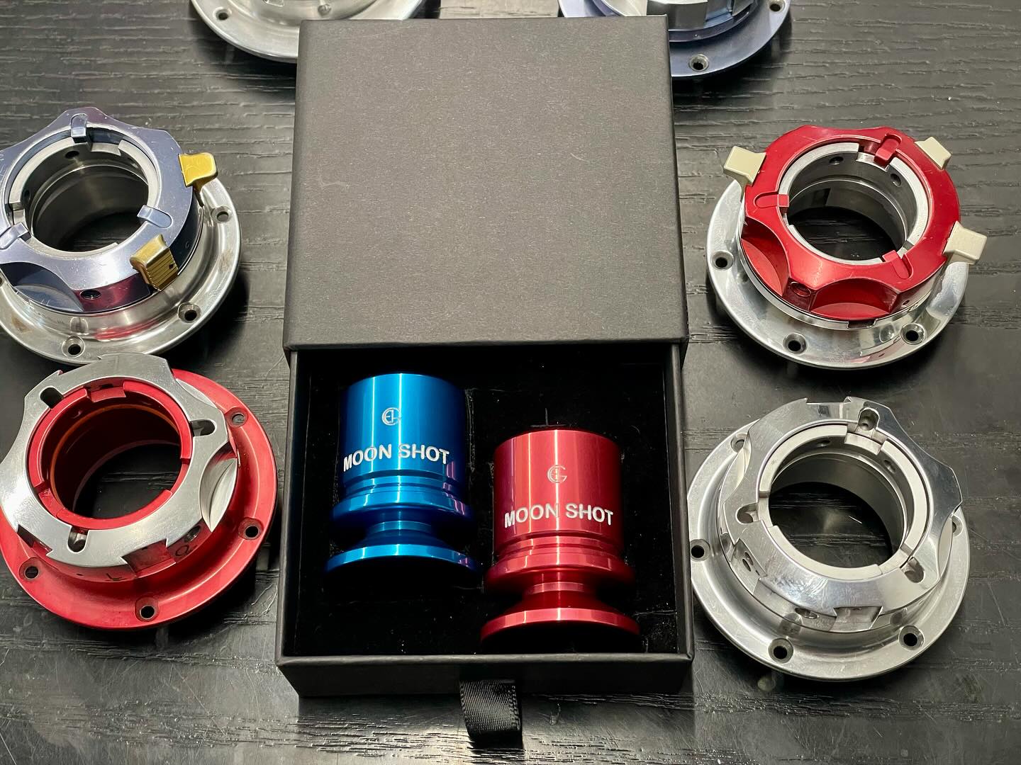

Here's a picture of my functional EMU glove connects. I constructed and printed them in ABS-like resin.
The golden parts are brass.

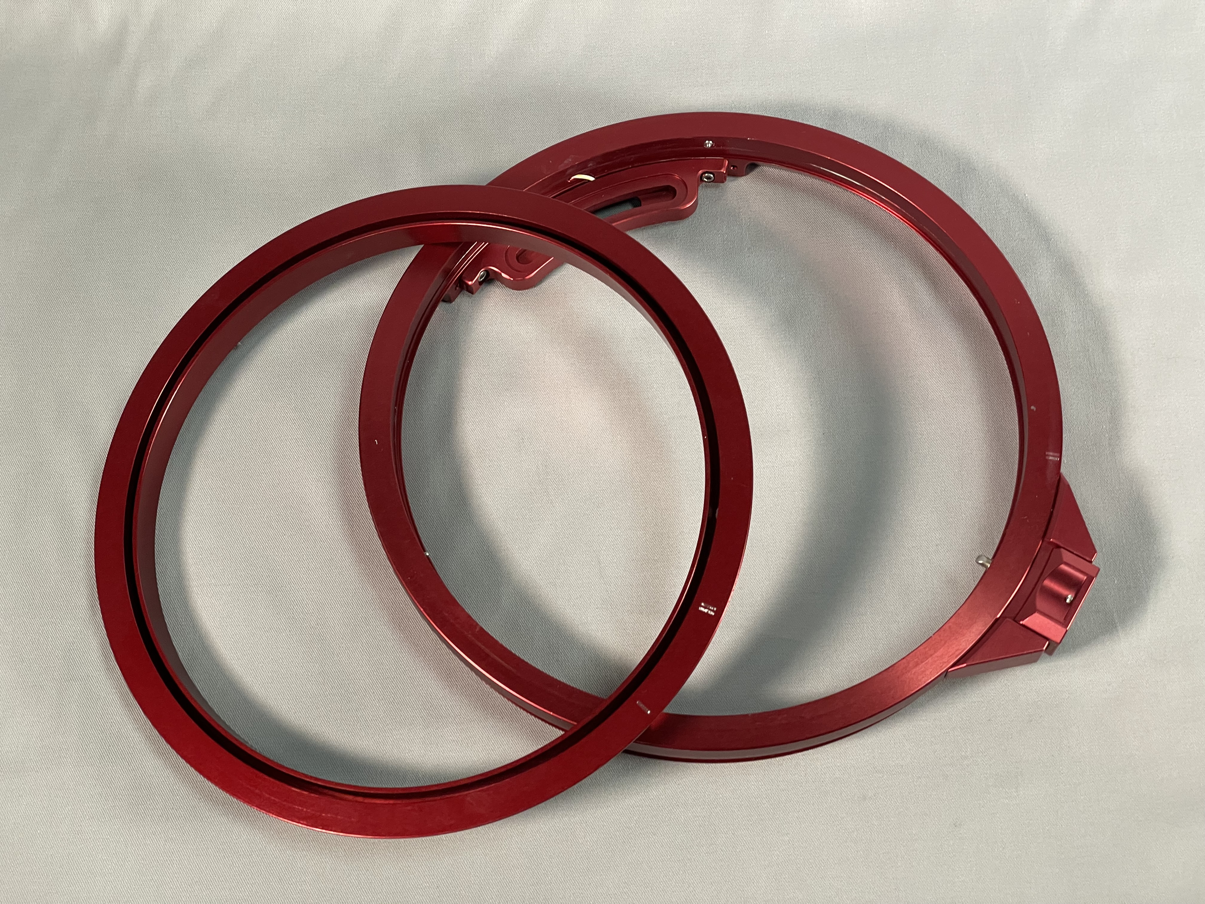

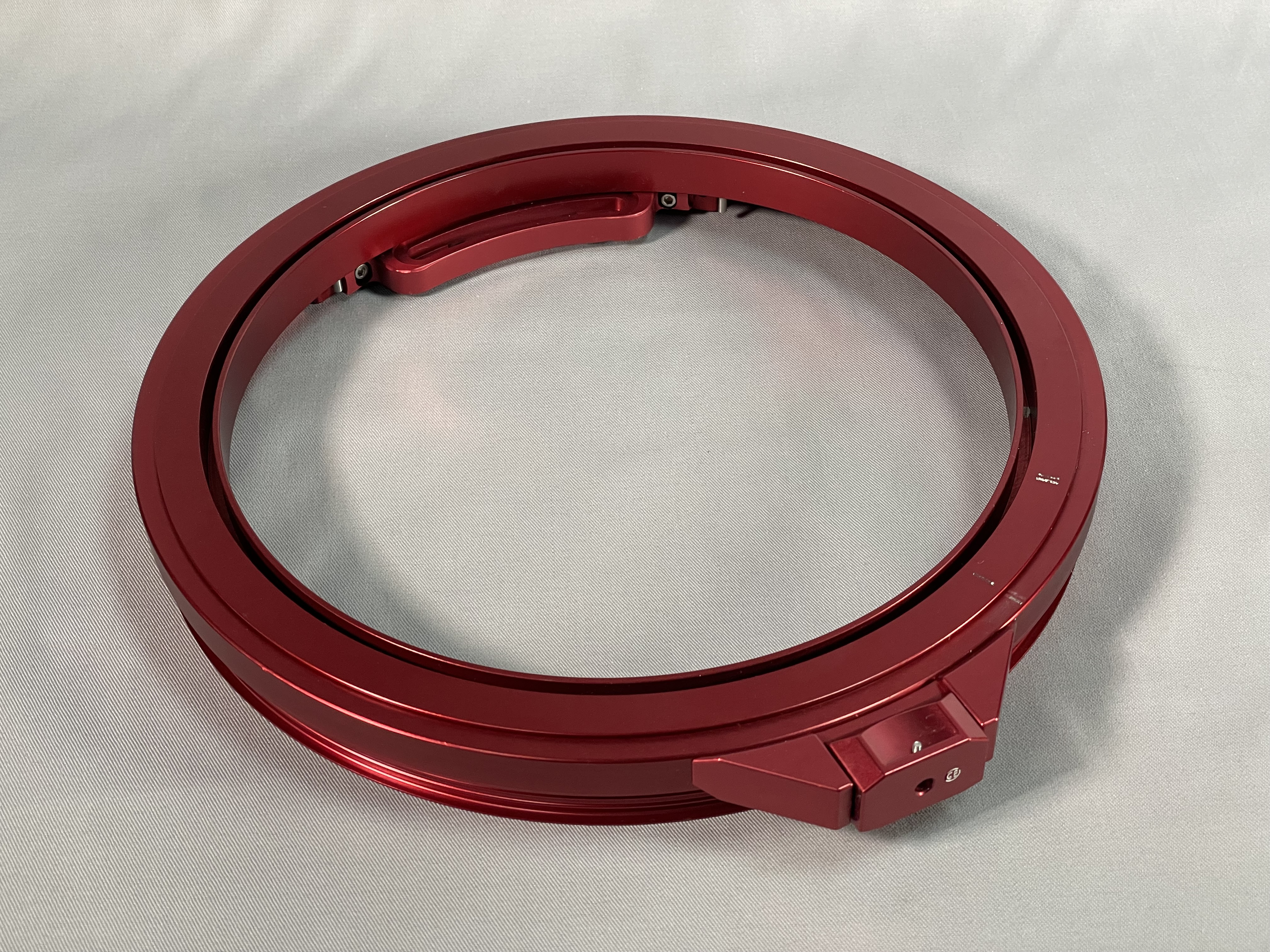

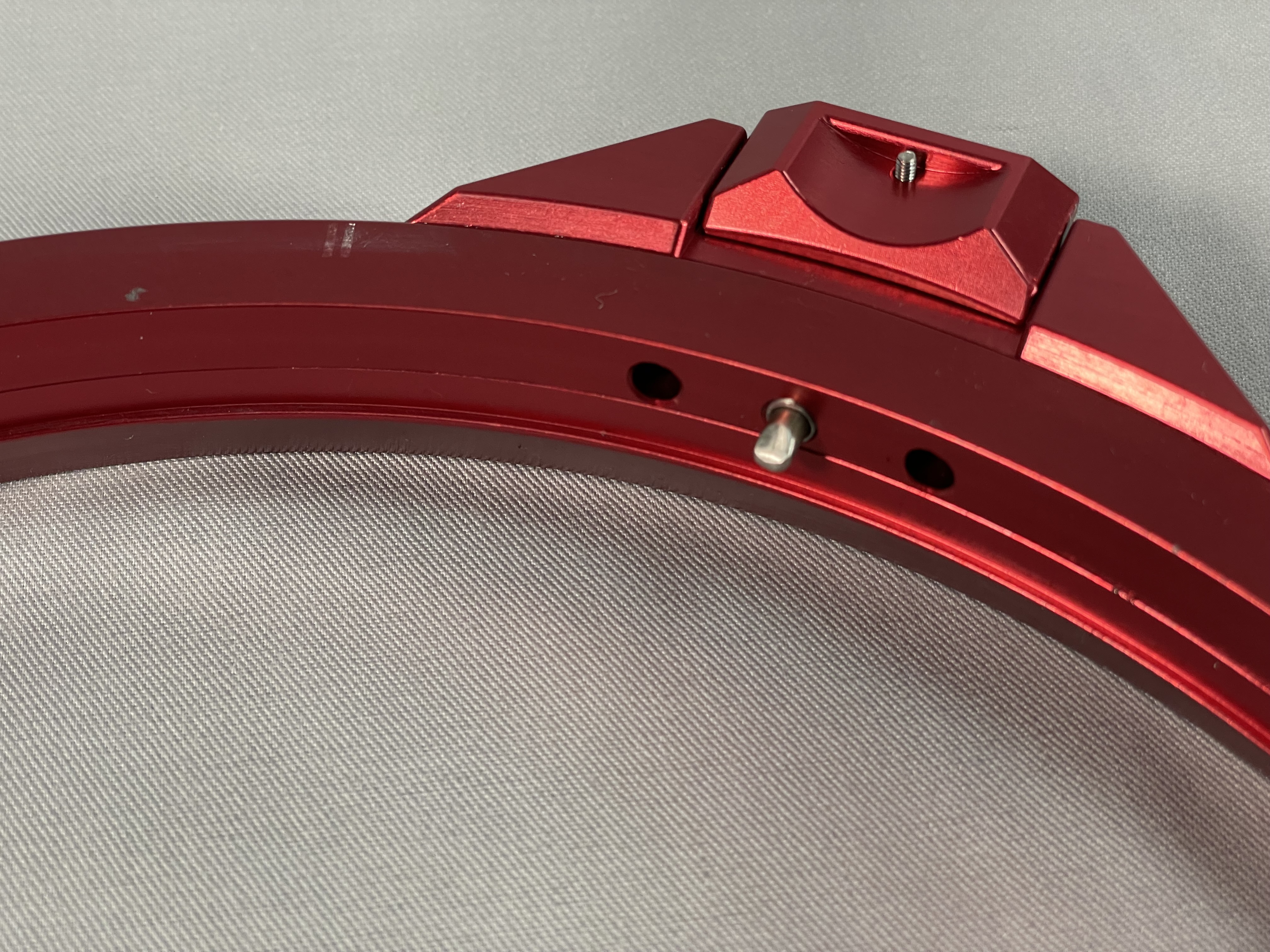

Another piece of hardware, is a "Low detail" Apollo helmet disconnect ring. I have made a number of matching Apollo rings in the past, with fully functional lock pin system, but wanted a less expensive option, but still metal.
This is also machined aluminum, and the same dimensions as a Apollo A7L ring, but with a simplified spring plunger locking system.

do you know where any exact measurements of the neck rings and wrist rings are

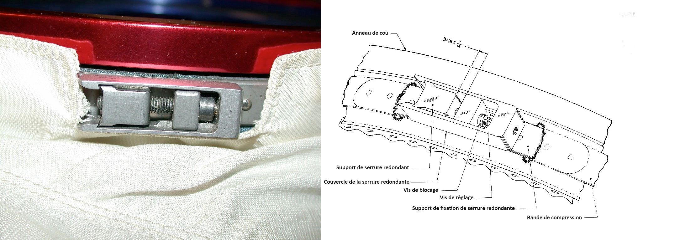

I have one question for you Imgill...
On the Apollo helmet disconnect ring (I'm talking about an original piece) the immobile lower part, attached to the TLSA was fastened with a compression band clamp..
My question is : what material was this compression band made of??
In the photo (sorry it's in French from my website), you can see the clamping system (steel), but as for the rest, I don't know..
By the way, one last one for the road..
- The area of the immobile lower part of helmet disconnect ring where the compression band rests and secures the TLSA is it smooth or grooved your replica seems to be grooved, and if so, why the grooves (on the original)???
(I couldn't find any photos)
