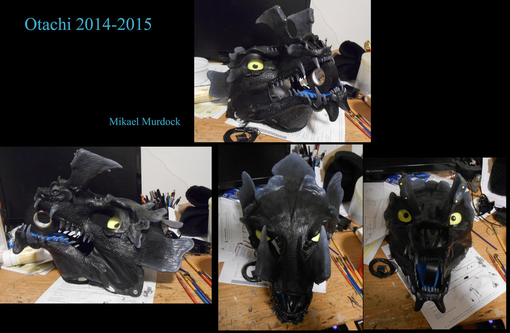

Here is her head nearly completed (just need to add the battery pack to the LEDs and fan in the nose)

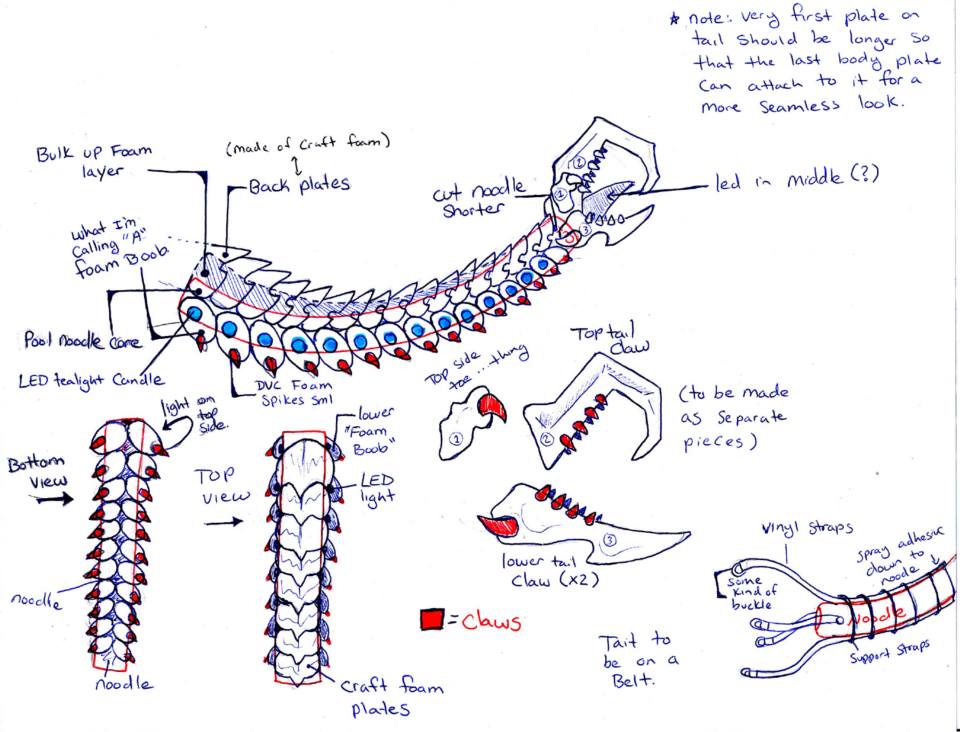

That image is me getting ideas down, so things are not 100% or to scale.
I plan to have a pool-noodle tail which has been bulked up with foam. I have some stretch fabric I'll be using to cover all that before I start to put on the plates and the... underside of the tail (those round things that have the spike and light on each; I've taken to calling them "foam Boobs" because I have no idea what else to call them). So it's the foam boobs I'm worried about. They are sound-ish and bulbus, and the back side of them curve to hug the curve of the tail and there are LOTS of them (a set for each side of the tail) I cannot possibly fathom trying to hand cut foam into these shapes: are they all uniform, how long would that take to make 30, and HOW in the heck am I going to cover the colour of the foam up and still have it look good.
What on earth can I make these things out of that will look good?! I'm so lost. I've only just started making costumes and I think I've maybe bitten off more than I can chew! (won't stop me, but still, Dang!). I've taken to the idea of maybe I'll have to cast my own "foam boobs" using flexfoam probably from Smooth-on. Problem? Cash and NO experience casting ANYTHING. There are so many ways, so many products, so much STUFF it's making my head spin. I'd actually prefer NOT to have to cast stuff and find another way around it. The "foam boobs" need an indent where I can insert the circular LEDs and a slot where I can slip a spike in each. Another issue is these foam boobs are round, there is no flat edge, it would be along the lines of casting a sphere. It might be possible to do two halves and glue them together but I'd prefer not having a seem.
Here is a very nice view of the upcoming otachi toy which I've been trying to roughly reference (I don't think it has to be 100%. I'm an amateur trying to do my best, and I have to work with what I've got or else I'd have made Otachi more of the correct colour. I'm trying).
Otachi Toy----------------------------------> http://i2.wp.com/thefwoosh.com/wp-content/uploads/2014/09/NECA-Pacific-Rim-Kaiju-Otachi-1.jpg
I need to brainstorm with some artistic-type folks to maybe get some more ideas out there as to what I can do. I'm really not keen on the idea of the casting.

If you don't want to cast anything you'll have to make each "bulb". This is what I would do:
First off: principle. People will go " Awesome! Kaiju from Pacific rim!" What they are not doing is lying on the ground 8 inches from the tail expecting to see the underside of each bulb to be perfectly sculpted.
I would take the pool noodle and cut it into thirds lengthwise about one third down the tail from the butt. Then glue in long triangular tapered cuts of foam to put it back together. This will make the tail nice and wide at the base and narrow at the tip / claw.
For the bulbs, start with the largest bulb at the base of the tail. Cut it out of 1/2" or thicker EVA foam. Cut the shape out. When you're happy with finessing the shape make a cardboard template of it. Then resize the template on a photo copier to make 3 more templates, each one about 15% smaller. So you will have 4 templates for the bulbs getting progressively smaller. Make additional templates if you need a more gradual transition. The templates should also have a circle for each glowing spot (for an led I assume) which will also scale smaller.
When you have your first bulb cut out, heat it with a heat gun to dome the shape a bit and round / sand all the edges to give it a rounder shape. Again, no one is looking for a perfect sphere on the underside, if each one looks "roundish" it will be good enough.
Hot glue each one to the pool noodle and space them out a bit to let the tail have some flex. Finish and paint maybe with PVA glue and acrylics. Don't bother with the fabric.
The tail will be dragging on the ground, get stepped on etc. So foam is a good choice to keep it flexible, easy to repair and the costs down.

I still think you're worrying about something that no one will really notice. Part of costume design on a budget or timeframe is putting the "money where it counts". Concentrating on the head and wings / hands is a great idea, but the underside of the tail, not so much. People will be looking for "a tail with segmented parts, glowing dots and the claw at the end". They won't see the underside.
I can tell you now that a tension strip on the back of the tail won't really work. I built an Aliens warrior years ago in similar fashion and I built essentially a "strap on butt harness" for the tail, to attach to my butt which supported the weight of the tail. Even in foam, your tail will way several pounds at that scale and with the claw at the end. You'll need some strapping around your waist / abdomen to support the weight.
Make some kind of harness, and have a curved section of PVC pipe securely attached to the base. Heat the pipe with a heat gun and bend it to the angle you want and then some (as the weight will cause it to droop slightly) then build your tail on top. You "could" also have the last half of the tail have wound aluminum armature wire as a core to allow for some posability.

Sorry I think you misunderstood what I meant about the strap. The one strap is simply to cause a curve which does work as I have it implemented in my draconian costume. That strap is simply for the curve, not for attaching to my body, the butt end of the tail will feature four straps, one attached to a section of the back via buckle to ensure no slippage, two for side support and one under-crotch all held on via belt inside the costume.
I need to try and ween myself off from the fear of the imperfection. The "bulbs" are a huge stress on me and the wings are also, but the wings are a whole'nother kettle of fish. I think I need to sit down and test your theory (once I can read it in full, proper detail) and test out a few things.

Holy Marbles, you're rather amazingly good at this, aren't you?
That head is insanely good, and the draconian is beyond belief. wish I was doing that kind of stuff, I'm far better with soft foam and fabric!

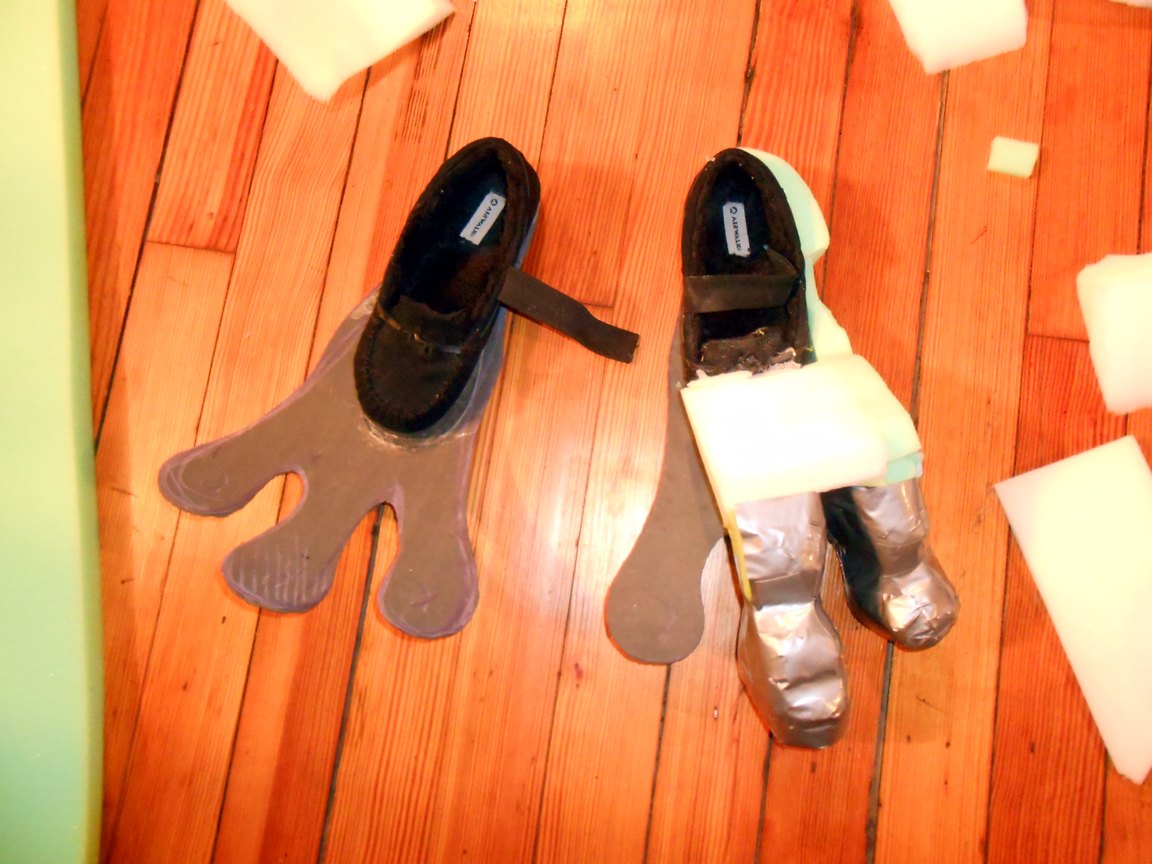

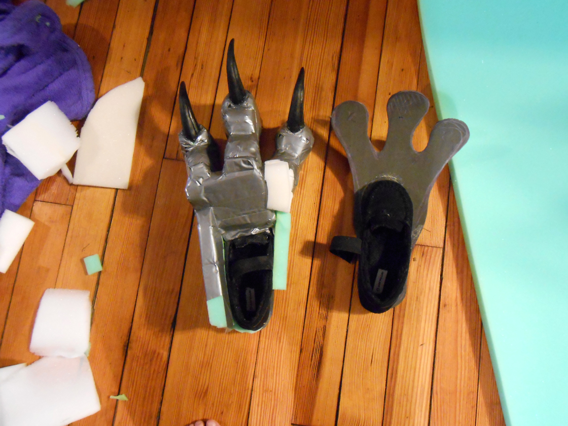

Building Otachi's feet. These are HUGE feet. If you're wondering why I duct taped the foam job it's to add massive amounts of durability, these will be near indestructible by the end. The feet are actually backwards in the picture, the nearly complete foot is the left, and the slipper glued to a frog foot...thing is the right, the second image has the lft foot on the left as that smaller toe is supposed to be on the outside. I normally add the claws in AFTER I get the final outer layer on the feet (I just slice a line into the tip of the toe going into the foam then shove the claw with some hot glue on into the hole). These claws were SO big, I had to add them in before the outer layer.
When I say BIG feet, I mean BIG. The feet are about double the size of my own.

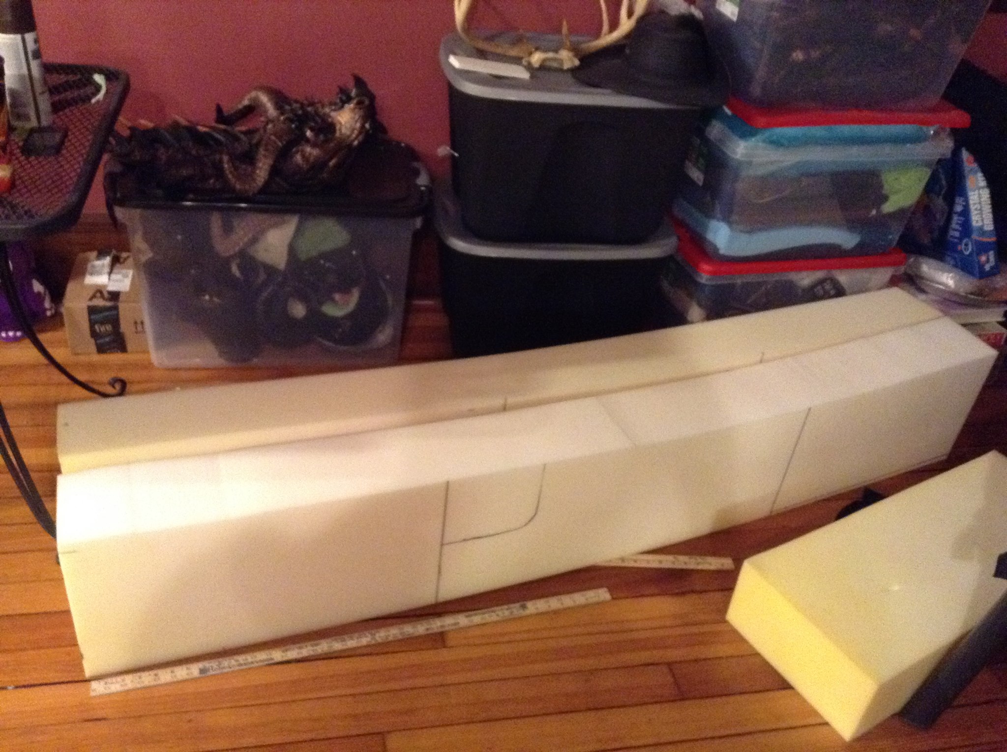

I also purchased the foam for the tail. I finally decided to just roll with foam -sigh- we'll see how this turns out *fingers crossed*

Here is the foam I got for the tail. Massive 6 inch foam placed side by side to hit 12 inches across, meter stick there for scale.

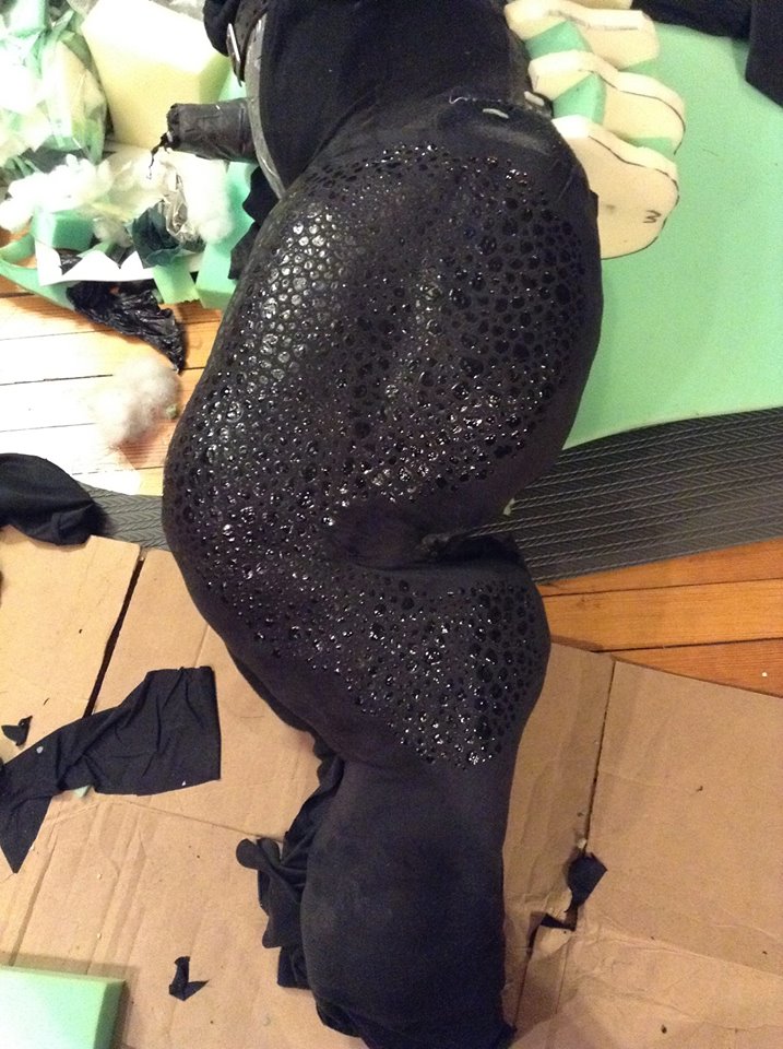

annnnnd I got one measly leg covered in her final fabric skin and started to work on her scales. Each one is individually hand painted on. My wrist hurts.
